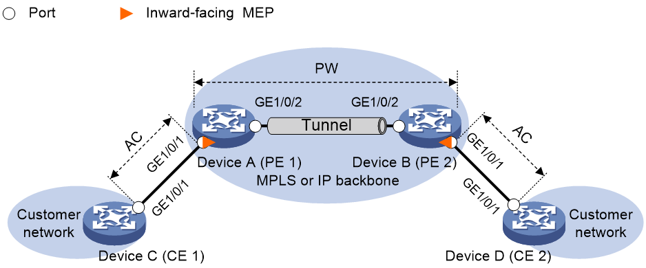

Example: Configuring CFD in a Layer 2 VPN (L2VPN networking)
As shown in Figure 3:
·     Configure a static PW between PE 1 and PE 2 to enable CE 1 and CE 2 to communicate with each other. Assume that the MAC addresses of Device A through Device D are 0010-FC01-6511, 0010-FC02-6512, 0010-FC03-6513, and 0010-FC04-6514, respectively.
·     Configure HundredGigE 1/0/1.1 on Device A and Device B as AC interfaces, and associate them with cross-connect svc of cross-connect group vpna.
·     Assign the network to MD_A (level 5). MD_A has two edge interfaces: HundredGigE 1/0/1.1 on Device A and HundredGigE 1/0/1.1 on Device B. They are both inward-facing MEPs.
·     Configure CC to monitor the connectivity between the inward-facing MEPs. Configure LB to locate link faults.
·     After the status information of the entire network is obtained, use LT, LM, and DM to detect link faults.
Figure 3 Network diagram
1.     Configure a static PW. (Details not shown.)
For information about configuring a static PW, see MPLS L2VPN in MPLS Configuration Guide.
2.     Enable CFD:
# Enable CFD on Device A.
<DeviceA> system-view
[DeviceA] cfd enable
# Configure Device B in the same way Device A is configured. (Details not shown.)
3.     Configure service instances:
# Create MD_A (level 5) on Device A, and create service instance 1 (in which the MA is identified by vpnma and serves cross-connect svc of cross-connect group vpna).
[DeviceA] cfd md MD_A level 5
[DeviceA] cfd service-instance 1 ma-id string vpnma md MD_A xconnect-group vpna connection svc
4.     Configure MEPs:
# On Device A, configure a MEP list in service instance 1, and create inward-facing MEP 1001 in service instance 1 on HundredGigE 1/0/1.1.
[DeviceA] cfd meplist 1001 2001 service-instance 1
[DeviceA] interface hundredgige 1/0/1.1
[DeviceA-HundredGigE1/0/1.1] cfd mep 1001 service-instance 1 inbound
[DeviceA-HundredGigE1/0/1.1] quit
# On Device B, configure a MEP list in service instance 1, and create inward-facing MEP 2001 in service instance 1 on HundredGigE 1/0/1.1.
[DeviceB] cfd meplist 1001 2001 service-instance 1
[DeviceB] interface hundredgige 1/0/1.1
[DeviceB-HundredGigE1/0/1.1] cfd mep 2001 service-instance 1 inbound
[DeviceB-HundredGigE1/0/1.1] quit
5.     Configure CC:
# On Device A, enable the sending of CCM frames for MEP 1001 in service instance 1 on HundredGigE 1/0/1.1.
[DeviceA-HundredGigE1/0/1.1] cfd cc service-instance 1 mep 1001 enable
# On Device B, enable the sending of CCM frames for MEP 2001 in service instance 1 on HundredGigE 1/0/1.1.
[DeviceB-HundredGigE1/0/1.1] cfd cc service-instance 1 mep 2001 enable
6.     Configure the frame counting mode:
# Configure the frame counting mode as port-based for HundredGigE 1/0/1.1 on Device A.
[DeviceA-HundredGigE1/0/1.1] cfd frame-count mode port-based
# Configure the frame counting mode as port-based for HundredGigE 1/0/1.1 on Device B.
[DeviceB-HundredGigE1/0/1.1] cfd frame-count mode port-based
