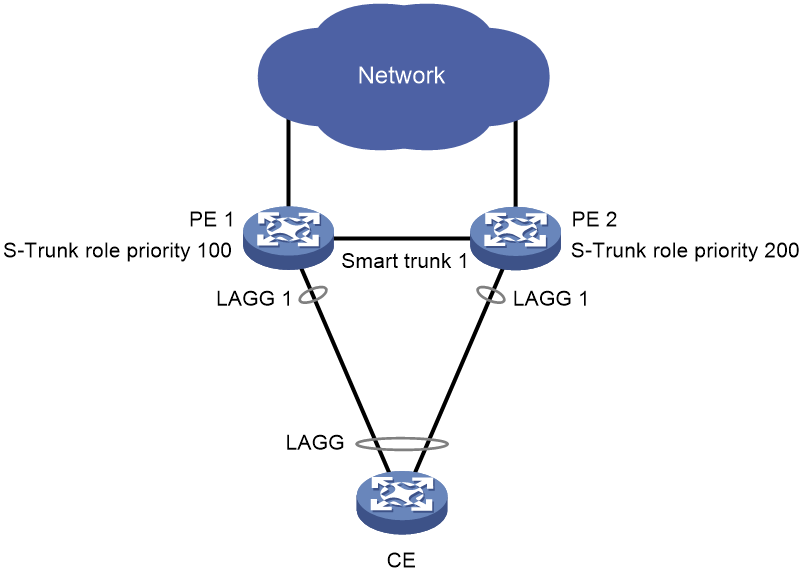

Application scenario

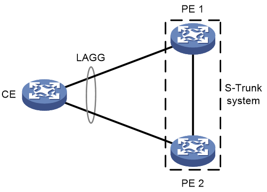

S-Trunk is used in the dual-homing scenario shown in Figure 1 to ensure service continuity upon failure of one PE. S-Trunk virtualizes the PEs into an S-Trunk system. To the CE, the S-Trunk system is one device. A smart trunk is configured on the PEs to aggregate the links between the CE and PEs. When a link or PE fails, its traffic is automatically switched to the other available links or PE.
Figure 1 S-Trunk application scenario

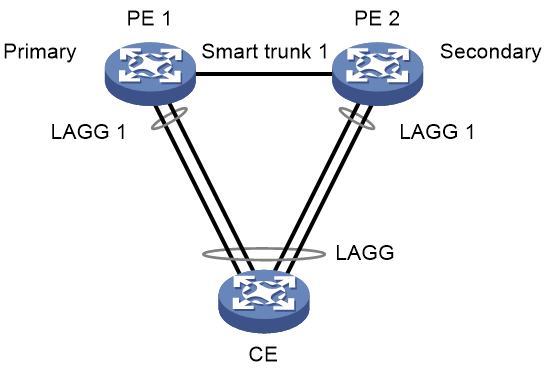

S-Trunk network model
As shown in Figure 2, each member device in the S-Trunk system is assigned the primary or secondary role based on its S-Trunk role priority. When both devices are operating correctly, only the primary S-Trunk member device forwards traffic. When the primary S-Trunk member device fails, the secondary S-Trunk member device takes over to forward all traffic.
A smart trunk contains two CE-facing aggregate interfaces as its member interfaces. S-Trunk also defines the primary and secondary roles for the member interfaces in a smart trunk. For the same smart trunk, typically the role of a smart trunk member interface is the same as the role of the S-Trunk member device that hosts that interface.
Figure 2 S-Trunk network model

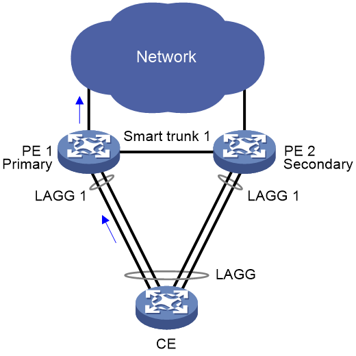

Typical traffic forwarding process
When both S-Trunk member devices are operating correctly, the smart trunk member interface on the primary member device forwards traffic. As shown in Figure 4, interface LAGG 1 on primary member device PE 1 is forwarding the traffic of CE 1. Interface LAGG 1 on PE 2 is the secondary member interface and is placed in down state.

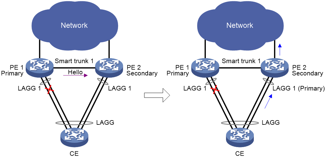

Primary member interface failure handling mechanism
When the primary member interface in a smart trunk fails, the smart trunk forwards traffic through the other member interface.
As shown in Figure 5, when the link between the CE and PE 1 fails, PE 1 notifies PE 2 of the failure of LAGG 1 through S-Trunk hello packets. After receiving the S-Trunk hello packets, PE 2 assigns the primary role to its LAGG 1 and brings the interface up to forward the traffic of the CE.

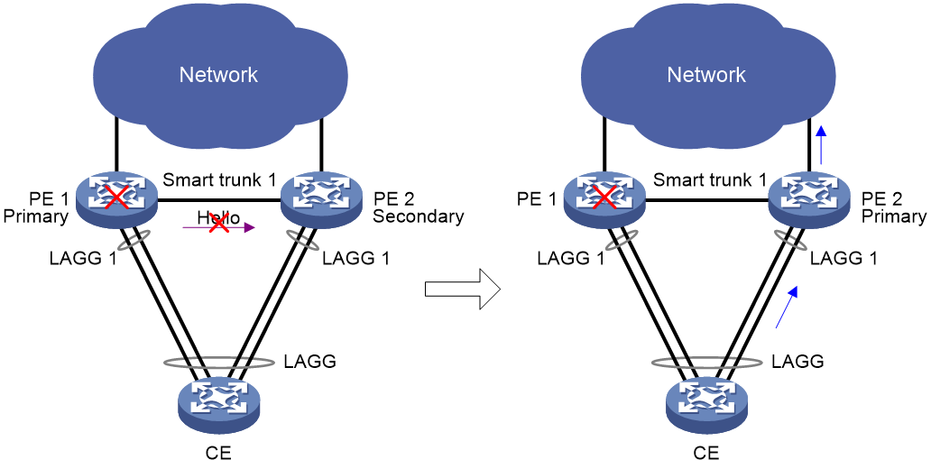

Primary member device failure handling mechanism
When the primary member device fails, the secondary member device takes over the primary role to forward all traffic.
As shown in Figure 6, if PE 1 fails, PE 2 cannot receive S-Trunk hello packets and determines that PE 1 is down upon expiration of the S-Trunk protocol packet timeout. Then, PE 2 becomes the primary member device and brings up LAGG 1 to forward the traffic of the CE.
