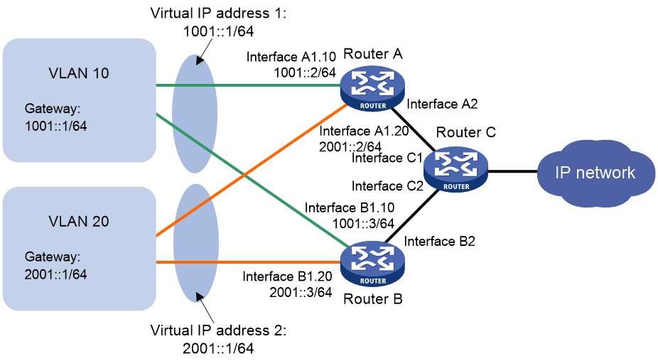

Load sharing
A router can join multiple VRRP groups. With different priorities in different VRRP groups, the router can act as the master in one VRRP group and a backup in another.
In load sharing mode, multiple VRRP groups provide gateway services. This mode requires a minimum of two VRRP groups, and each group has one master and multiple backups. The master roles in the VRRP groups are assumed by different routers, as shown in Figure 4.
A router can be in multiple VRRP groups and have a different priority in each group.
As shown in Figure 4, the following VRRP groups exist:
· VRRP group 1—Router A is the master. Router B and Router C are the backups.
· VRRP group 2—Router B is the master. Router A and Router C are the backups.
· VRRP group 3—Router C is the master. Router A and Router B are the backups.
To implement load sharing among Router A, Router B, and Router C, perform the following tasks:
· Configure the virtual IP addresses of VRRP group 1, 2, and 3 as default gateway IP addresses for hosts on the subnet.
· Assign the highest priority to Router A, B, and C in VRRP group 1, 2, and 3, respectively.

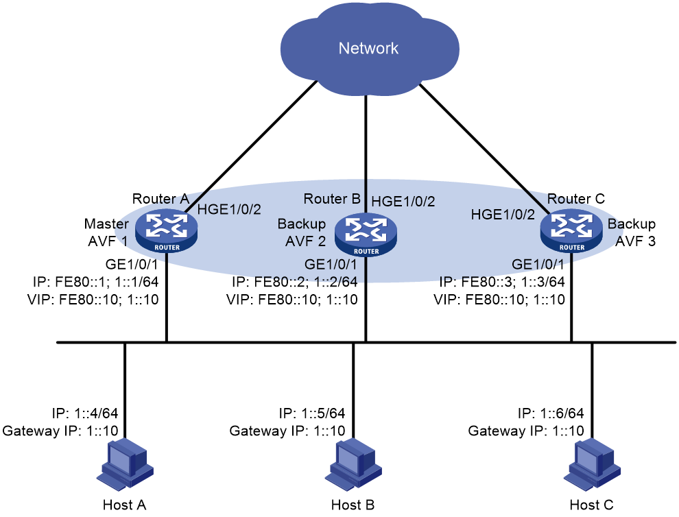

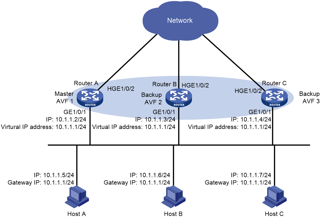

VRRP load balancing mode
In a standard-mode VRRP group, only the master can forward packets and backups are in listening state. You can create multiple VRRP groups to share traffic, but you must configure different gateways for hosts on the subnet.
In load balancing mode, a VRRP group maps its virtual IP address to multiple virtual MAC addresses, assigning one virtual MAC address to each member router. Every router in this VRRP group can forward traffic and respond to IPv4 ARP requests or IPv6 ND requests from hosts. Because their virtual MAC addresses are different, traffic from hosts is distributed across the VRRP group members. Load balancing mode simplifies configuration and improves forwarding efficiency.
VRRP load balancing mode uses the same master election, preemption, and tracking mechanisms as the standard mode. New mechanisms have been introduced to VRRP load balancing mode, as described in the following sections.
Virtual MAC address assignment
In load balancing mode, the master assigns virtual MAC addresses to routers in the VRRP group. The master uses different MAC addresses to respond to ARP requests or ND requests from different hosts. The backup routers, however, do not answer ARP requests or ND requests from hosts.
In an IPv4 network, a load balanced VRRP group works as follows:
1. The master assigns virtual MAC addresses to all member routers, including itself. This example assumes that the virtual IP address of the VRRP group is 10.1.1.1/24, Router A is the master, and Router B is the backup. Router A assigns 000f-e2ff-0011 for itself and 000f-e2ff-0012 for Router B. See Figure 5.
Figure 5 Virtual MAC address assignment
2. When an ARP request arrives, the master (Router A) selects a virtual MAC address based on the load balancing algorithm to answer the ARP request. In this example, Router A returns the virtual MAC address of itself in response to the ARP request from Host A. Router A returns the virtual MAC address of Router B in response to the ARP request from Host B. See Figure 6.
Figure 6 Answering ARP requests
3. Each host sends packets to the returned MAC address. As shown in Figure 7, Host A sends packets to Router A and Host B sends packets to Router B.
Figure 7 Sending packets to different routers for forwarding
In the ARP reply sent by the master, the source MAC address in the Ethernet header is different from the sender MAC address in the message body. For the Layer 2 device to forward the ARP packet, follow these configuration guidelines on the Layer 2 device:
· Do not enable ARP packet source MAC address consistency check.
· Do not specify the src-mac keyword when you enable ARP packet validity check for ARP detection.
For more information about ARP packet source MAC address consistency check and ARP detection, see Security Configuration Guide.
Virtual forwarder
Virtual forwarder creation
Virtual MAC addresses enable traffic distribution across routers in a VRRP group. To enable routers in the VRRP group to forward packets, VFs must be created on them. Each VF is associated with a virtual MAC address in the VRRP group and forwards packets that are sent to this virtual MAC address.
VFs are created on routers in a VRRP group, as follows:
1. The master assigns virtual MAC addresses to all routers in the VRRP group. Each member router creates a VF for this MAC address and becomes the owner of this VF.
2. Each VF owner advertises its VF information to the other member routers.
3. After receiving the VF advertisement, each of the other routers creates the advertised VF.
Eventually, every member router maintains one VF for each virtual MAC address in the VRRP group.
VF weight and priority
The weight of a VF indicates the forwarding capability of a VF. A higher weight means higher forwarding capability. When the weight is lower than the lower limit of failure, the VF cannot forward packets.
The priority of a VF determines the VF state. Among the VFs created on different member routers for the same virtual MAC address, the VF with the highest priority is in active state. This VF, known as the active virtual forwarder (AVF), forwards packets. All other VFs listen to the state of the AVF and are known as the listening virtual forwarders (LVFs). VF priority is in the range of 0 to 255, where 255 is reserved for the VF owner. When the weight of a VF owner is higher than or equal to the lower limit of failure, the priority of the VF owner is 255.
The priority of a VF is calculated based on its weight.
· If the VF weight is higher than or equal to the lower limit of failure, the following VF priorities apply:
¡ On a VF owner, the VF priority is 255.
¡ On a non-VF owner, the VF priority is calculated as weight/(number of local AVFs + 1).
· If the VF weight is lower than the lower limit of failure, the VF priority is 0.
VF backup
Figure 8 shows the VF table on each router in the VRRP group and how the VFs back up one another. The master, Router A, assigns virtual MAC addresses 000f-e2ff-0011, 000f-e2ff-0012, and 000f-e2ff-0013 to itself, Router B, and Router C, respectively. Each router creates VF 1, VF 2, and VF 3 for virtual MAC addresses 000f-e2ff-0011, 000f-e2ff-0012, and 000f-e2ff-0013, respectively. The VFs for the same virtual MAC address on different routers back up one another. For example, the VF 1 instances on Router A, Router B, and Router C back up one another.
· The VF 1 instances on Router B and Router C have a priority of 255/(1 + 1), or 127. Because their priorities are lower than the priority of the VF 1 instance on Router A, they act as LVFs. These LVFs listen to the state of the VF 1 instance on Router A.
· When the VF 1 instance on Router A fails, the VF 1 instances on Router B and Router C elect the one with higher priority as the new AVF. This AVF forwards packets destined for virtual MAC address 000f-e2ff-0011. If the two LVFs' priorities are the same, the LVF with a greater device MAC address becomes the new AVF.
A VF always operates in preemptive mode. When an LVF finds its priority value higher than the one advertised by the AVF, the LVF declares itself as the AVF.
VF timers
When the AVF on a router fails, the new AVF on another router creates the following timers for the failed AVF:
· Redirect timer—Before this timer expires, the master still uses the virtual MAC address corresponding to the failed AVF to respond to ARP/ND requests from hosts. The VF owner can share traffic load if the VF owner resumes normal operation within this time. When this timer expires, the master stops using the virtual MAC address corresponding to the failed AVF to respond to ARP/ND requests from hosts.
· Timeout timer—The duration after which the new AVF takes over responsibilities of the failed VF owner. Before this timer expires, all routers in the VRRP group keep the VFs that correspond to the failed AVF. The new AVF forwards packets destined for the virtual MAC address of the failed AVF. When this timer expires, all routers in the VRRP group remove the VFs that correspond to the failed AVF, including the new AVF. Packets destined for the virtual MAC address of the failed AVF are not forwarded any longer.
VF tracking
An AVF forwards packets destined for the MAC address of the AVF. If the AVF's upstream link fails but no LVF takes over, the hosts that use the AVF's MAC address as their gateway MAC address cannot access the external network.
The VF tracking function can solve this problem. You can use NQA or BFD to monitor the upstream link state of the VF owner, and associate the VFs with NQA or BFD through the tracking function. This enables the collaboration between VRRP and NQA or BFD through the Track module. When the upstream link fails, the state of the track entry changes to Negative. The weights of the VFs (including the AVF) on the router decrease by a specific value. The corresponding LVF with a higher priority on another router becomes the AVF and forwards packets.

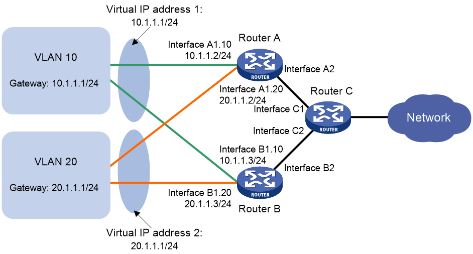

Specifying an IPv4 VRRP control VLAN
As shown in Figure 9, ambiguous VLAN termination is configured for VLAN 10 and VLAN 20 on the Layer 3 Ethernet subinterfaces on routers. To allow the master to regularly send VRRP advertisements in multicast to the backups, enable the VLAN termination-enabled subinterfaces to transmit broadcast packets and multicast packets. Then, the master can send VRRP advertisements within all VLANs whose VLAN packets are configured to be terminated by the subinterfaces. If ambiguous VLAN termination is configured on the Layer 3 Ethernet subinterfaces for a large range of VLANs, the VRRP advertisements might overload the subinterfaces. This adversely affects the performance of the routers.
To resolve this problem, you can disable the VLAN termination-enabled subinterfaces from transmitting broadcast packets and multicast packets and configure a VRRP control VLAN. The master sends VRRP advertisements only within the control VLAN.
Specify VRRP control VLANs according to the VLAN termination type.
· For ambiguous Dot1q termination, specify one control VLAN by the outermost layer of VLAN tag.
· For ambiguous QinQ termination, specify two control VLANs by the outermost two layers of VLAN tags.
For more information about VLAN termination, see Layer 2—LAN Switching Configuration Guide.
· When VRRP is operating in load balancing mode, you cannot specify the VRRP control VLAN.
· As a best practice, configure the arp send-gratuitous-arp command on the routers in a VRRP group after you specify a VRRP control VLAN. This command enables the routers to periodically send gratuitous ARP packets. The devices in the VLAN terminated ambiguously can then update MAC address entries after a master switchover. For more information about the arp send-gratuitous-arp command, see Layer 3—IP Services Command Reference.
1. Enter system view.
2. Enter Layer 3 Ethernet subinterface view or Layer 3 RPR logical interface view.
3. Specify VRRP control VLANs.
¡ Specify a VRRP control VLAN for the ambiguous Dot1q termination-enabled subinterface.
vrrp dot1q vid vlan-id
¡ Specify VRRP control VLANs for the ambiguous QinQ termination-enabled subinterface.
vrrp dot1q vid vlan-id secondary-dot1q secondary-vlan-id
By default, no VRRP control VLAN is specified. The master sends VRRP advertisements within all VLANs whose VLAN packets are configured to be terminated by the subinterface.

Specifying an IPv6 VRRP control VLAN
As shown in Figure 11, ambiguous VLAN termination is configured for VLAN 10 and VLAN 20 on the Layer 3 Ethernet subinterfaces on routers. To allow the master to regularly send IPv6 VRRP advertisements in multicast to the backups, enable the VLAN termination-enabled subinterfaces to transmit broadcast packets and multicast packets. Then, the master can send IPv6 VRRP advertisements within all VLANs whose VLAN packets are configured to be terminated by the subinterfaces. If ambiguous VLAN termination is configured on the Layer 3 Ethernet subinterfaces for a large range of VLANs, the IPv6 VRRP advertisements might overload the subinterfaces. This adversely affects the performance of the routers.
To resolve this problem, you can disable the VLAN termination-enabled subinterfaces from transmitting broadcast packets and multicast packets and configure an IPv6 VRRP control VLAN. The master sends IPv6 VRRP advertisements only within the control VLAN.
Figure 11 IPv6 VRRP control VLAN
Specify IPv6 VRRP control VLANs according to the VLAN termination type.
When IPv6 VRRP is operating in load balancing mode, you cannot specify the IPv6 VRRP control VLAN.
3. Specify IPv6 VRRP control VLANs.
¡ Specify an IPv6 VRRP control VLAN for the ambiguous Dot1q termination-enabled subinterface.
vrrp ipv6 dot1q vid vlan-id
¡ Specify IPv6 VRRP control VLANs for the ambiguous QinQ termination-enabled subinterface.
vrrp ipv6 dot1q vid vlan-id secondary-dot1q secondary-vlan-id
By default, no IPv6 VRRP control VLAN is specified. The master sends IPv6 VRRP advertisements within all VLANs whose VLAN packets are configured to be terminated by the subinterface.

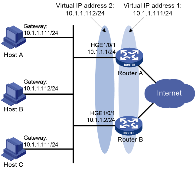

IPv4 VRRP configuration examples
Example: Configuring a single VRRP group
As shown in Figure 13, Router A and Router B form a VRRP group. They use the virtual IP address 10.1.1.111/24 to provide gateway service for the subnet where Host A resides.
Router A operates as the master to forward packets from Host A to Host B. When Router A fails, Router B takes over to forward packets for Host A.
Configure Router A to operate in preempt mode so Router A can forward traffic as long as Router A operates correctly. Set the preemption delay to 5000 centiseconds to avoid frequent status change.
By default, interfaces on the device are disabled (in ADM or Administratively Down state). To have an interface operate, you must use the undo shutdown command to enable that interface.
1. Configure Router A:
# Specify an IP address for Router A.
<RouterA> system-view
[RouterA] interface hundredgige 1/0/1
[RouterA-HundredGigE1/0/1] ip address 10.1.1.1 255.255.255.0
# Create VRRP group 1 on GigabitEthernet 1/0/1 and set its virtual IP address to 10.1.1.111.
[RouterA-HundredGigE1/0/1] vrrp vrid 1 virtual-ip 10.1.1.111
# Assign Router A a higher priority than Router B in VRRP group 1, so Router A can become the master.
[RouterA-HundredGigE1/0/1] vrrp vrid 1 priority 110
# Configure Router A to operate in preemptive mode, so it can become the master whenever it operates correctly. Set the preemption delay to 5000 centiseconds to avoid frequent status switchover.
[RouterA-HundredGigE1/0/1] vrrp vrid 1 preempt-mode delay 5000
2. Configure Router B:
<RouterB> system-view
[RouterB] interface hundredgige 1/0/1
[RouterB-HundredGigE1/0/1] ip address 10.1.1.2 255.255.255.0
[RouterB-HundredGigE1/0/1] vrrp vrid 1 virtual-ip 10.1.1.111
# Set the priority of Router B to 100 in VRRP group 1.
[RouterB-HundredGigE1/0/1] vrrp vrid 1 priority 100
# Configure Router B to operate in preemptive mode, and set the preemption delay to 5000 centiseconds.
[RouterB-HundredGigE1/0/1] vrrp vrid 1 preempt-mode delay 5000
# Ping Host B from Host A. (Details not shown.)
# Display detailed information about VRRP group 1 on Router A.
[RouterA-HundredGigE1/0/1] display vrrp verbose
IPv4 virtual router information:

Example: Configuring multiple VRRP groups
As shown in Figure 14, Router A and Router B form two VRRP groups to implement load sharing and mutual backup. VRRP group 1 uses the virtual IP address 10.1.1.111/24 to provide gateway service for some hosts on the subnet 10.1.1.0/24. VRRP group 2 uses the virtual IP address 10.1.1.112/24 to provide gateway service for the other hosts on the subnet.
To implement load sharing between the VRRP groups, manually configure the default gateway 10.1.1.111 or 10.1.1.112 for the hosts on the subnet 10.1.1.0/24.

Example: Configuring VRRP load balancing
As shown in Figure 15, Router A, Router B, and Router C form a load-balanced VRRP group. They use the virtual IP address 10.1.1.1/24 to provide gateway service for subnet 10.1.1.0/24.
Configure VFs on Router A, Router B, and Router C to monitor their respective HundredGigE 1/0/2. When the interface on any one of them fails, the weights of the VFs on the problematic router decrease so another AVF can take over.
# Configure VRRP to operate in load balancing mode.
[RouterA] vrrp mode load-balance
# Create VRRP group 1, and set its virtual IP address to 10.1.1.1.
[RouterA-HundredGigE1/0/1] ip address 10.1.1.2 24
# Assign Router A the highest priority in VRRP group 1, so Router A can become the master.
[RouterA-HundredGigE1/0/1] vrrp vrid 1 priority 120
[RouterA-HundredGigE1/0/1] quit
# Create track entry 1 to monitor the upstream link status of HundredGigE 1/0/2. When the upstream link fails, the track entry transits to Negative.
[RouterA] track 1 interface hundredgige 1/0/2
# Associate the VFs in VRRP group 1 with track entry 1, and decrease their weights by 250 when the track entry transits to Negative.
[RouterA-HundredGigE1/0/1] vrrp vrid 1 track 1 weight reduced 250
[RouterB] vrrp mode load-balance
[RouterB-HundredGigE1/0/1] ip address 10.1.1.3 24
# Assign Router B a higher priority than Router C in VRRP group 1, so Router B can become the master when Router A fails.
[RouterB-HundredGigE1/0/1] vrrp vrid 1 priority 110
[RouterB-HundredGigE1/0/1] quit
[RouterB] track 1 interface hundredgige 1/0/2
[RouterB-HundredGigE1/0/1] vrrp vrid 1 track 1 weight reduced 250
3. Configure Router C:
<RouterC> system-view
[RouterC] vrrp mode load-balance
# Create VRRP group 1, and set its virtual IP address as 10.1.1.1.
[RouterC] interface hundredgige 1/0/1
[RouterC-HundredGigE1/0/1] ip address 10.1.1.4 24
[RouterC-HundredGigE1/0/1] vrrp vrid 1 virtual-ip 10.1.1.1
# Configure Router C to operate in preemptive mode, and set the preemption delay to 5000 centiseconds.
[RouterC-HundredGigE1/0/1] vrrp vrid 1 preempt-mode delay 5000
[RouterC-HundredGigE1/0/1] quit
[RouterC] track 1 interface hundredgige 1/0/2
[RouterC-HundredGigE1/0/1] vrrp vrid 1 track 1 weight reduced 250
# Verify that Host A can ping the external network. (Details not shown.)
Running mode : Load balance
Total number of virtual routers : 1
Interface HundredGigE1/0/1
VRID : 1 Adver timer : 100 centiseconds
Admin status : Up State : Master
Config pri : 120 Running pri : 120
Preempt mode : Yes Delay time : 5000 centiseconds
Auth type : Not supported
Version : 3
Virtual IP : 10.1.1.1
Member IP list : 10.1.1.2 (Local, Master)
10.1.1.3 (Backup)
10.1.1.4 (Backup)
Forwarder information: 3 Forwarders 1 Active
Config weight : 255
Running weight : 255
Forwarder 01
State : Active
Virtual MAC : 000f-e2ff-0011 (Owner)
Owner ID : 0000-5e01-1101
Priority : 255
Active : local
Forwarder 02
State : Listening
Virtual MAC : 000f-e2ff-0012 (Learnt)
Owner ID : 0000-5e01-1103
Priority : 127
Active : 10.1.1.3
Forwarder 03
State : Listening
Virtual MAC : 000f-e2ff-0013 (Learnt)
Owner ID : 0000-5e01-1105
Priority : 127
Active : 10.1.1.4
Forwarder weight track information:
Track object : 1 State : Positive Weight reduced : 250
# Display detailed information about VRRP group 1 on Router B.
[RouterB-HundredGigE1/0/1] display vrrp verbose
Admin status : Up State : Backup
Config pri : 110 Running pri : 110
Become master : 426ms milliseconds left
Version : 3
Member IP list : 10.1.1.3 (Local, Backup)
10.1.1.2 (Master)
10.1.1.4 (Backup)
Config weight : 255
Forwarder 01
State : Listening
Virtual MAC : 000f-e2ff-0011 (Learnt)
Priority : 127
Active : 10.1.1.2
Forwarder 02
State : Active
Virtual MAC : 000f-e2ff-0012 (Owner)
Priority : 255
Active : local
Forwarder 03
State : Listening
Priority : 127
Active : 10.1.1.4
# Display detailed information about VRRP group 1 on Router C.
[RouterC-HundredGigE1/0/1] display vrrp verbose
Config pri : 100 Running pri : 100 centiseconds
Become master : 417 milliseconds left
Version : 3
Member IP list : 10.1.1.4 (Local, Backup)
10.1.1.2 (Master)
10.1.1.3 (Backup)
Config weight : 255
Forwarder 01
State : Listening
Priority : 127
Active : 10.1.1.2
Forwarder 02
State : Listening
Priority : 127
Active : 10.1.1.3
Forwarder 03
State : Active
Virtual MAC : 000f-e2ff-0013 (Owner)
Priority : 255
Active : local
Become master : 412 milliseconds left
Version : 3
10.1.1.2 (Master)
10.1.1.3 (Backup)
Forwarder information: 3 Forwarders 2 Active
Config weight : 255
Forwarder 01
State : Active
Virtual MAC : 000f-e2ff-0011 (Take Over)
Priority : 85
Active : local
Forwarder 02
State : Listening
Priority : 85
Active : 10.1.1.3
Forwarder 03
State : Active
Priority : 255
Active : local
The output shows that when HundredGigE 1/0/2 on Router A fails, the weights of the VFs on Router A drop below the lower limit of failure. All VFs on Router A transit to the Initialize state and cannot forward traffic. The VF for MAC address 000f-e2ff-0011 on Router C becomes the AVF to forward traffic.
# When the timeout timer (about 1800 seconds) expires, display detailed information about VRRP group 1 on Router C.
Version : 3
10.1.1.2 (Master)
10.1.1.3 (Backup)
Forwarder information: 2 Forwarders 1 Active
Config weight : 255
Forwarder 02
State : Listening
Priority : 127
Active : 10.1.1.3
Forwarder 03
State : Active
Priority : 255
Active : local
The output shows that when the timeout timer expires, the VF for virtual MAC address 000f-e2ff-0011 is removed. The VF no longer forwards the packets destined for the MAC address.
# When Router A fails, display detailed information about VRRP group 1 on Router B.
Version : 3
Member IP list : 10.1.1.3 (Local, Master)
10.1.1.4 (Backup)
Config weight : 255
Forwarder 02
State : Active
Priority : 255
Active : local
Forwarder 03
State : Listening
Priority : 127
Active : 10.1.1.4
The output shows the following information:
· When Router A fails, Router B becomes the master because it has a higher priority than Router C.
· The VF for virtual MAC address 000f-e2ff-0011 is removed.

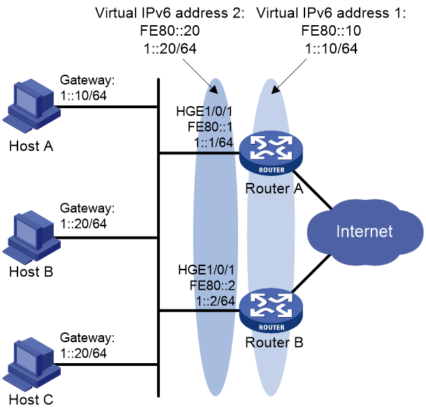

IPv6 VRRP configuration examples
As shown in Figure 16, Router A and Router B form a VRRP group. They use the virtual IP addresses 1::10/64 and FE80::10 to provide gateway service for the subnet where Host A resides.
Host A learns 1::10/64 as its default gateway from RA messages sent by the routers.
[RouterA-HundredGigE1/0/1] display vrrp ipv6 verbose
IPv6 virtual router information:
Running mode : Standard
Virtual IP : FE80::10
1::10
Virtual MAC : 0000-5e00-0201
Master IP : FE80::1
[RouterB-HundredGigE1/0/1] display vrrp ipv6 verbose
Become master : 411 milliseconds left
1::10
Master IP : FE80::1
The output shows that Router A is operating as the master in VRRP group 1 to forward packets from Host A to Host B.
# Disconnect the link between Host A and Router A, and verify that Host A can still ping Host B. (Details not shown.)
1::10
Master IP : FE80::2
The output shows that when Router A fails, Router B takes over to forward packets from Host A to Host B.
# Recover the link between Host A and Router A, and display detailed information about VRRP group 1 on Router A.
1::10
Master IP : FE80::1
The output shows that after Router A resumes normal operation, it becomes the master to forward packets from Host A to Host B.
As shown in Figure 18, Router A, Router B, and Router C form a load balanced VRRP group and use the virtual IPv6 addresses FE80::10 and 1::10 to provide gateway service for the subnet 1::/64.
Hosts on subnet 1::/64 learn 1::10 as their default gateway from RA messages sent by the routers.
Configure VFs on Router A, Router B, or Router C to monitor their respective HundredGigE 1/0/2. When the interface on any of them fails, the weights of the VFs on the problematic router decrease so another AVF can take over.
[RouterA] vrrp ipv6 mode load-balance
# Create VRRP group 1, and set its virtual IPv6 addresses to FE80::10 and 1::10.
[RouterA-HundredGigE1/0/1] ipv6 address fe80::1 link-local
[RouterA-HundredGigE1/0/1] ipv6 address 1::1 64
[RouterA-HundredGigE1/0/1] vrrp ipv6 vrid 1 virtual-ip fe80::10 link-local
[RouterA-HundredGigE1/0/1] vrrp ipv6 vrid 1 virtual-ip 1::10
[RouterA-HundredGigE1/0/1] vrrp ipv6 vrid 1 priority 120
[RouterA-HundredGigE1/0/1] vrrp ipv6 vrid 1 preempt-mode delay 5000
# Enable Router A to send RA messages, so hosts on subnet 1::/64 can learn the default gateway address.
[RouterA-HundredGigE1/0/1] undo ipv6 nd ra halt
[RouterA-HundredGigE1/0/1] vrrp ipv6 vrid 1 track 1 weight reduced 250
[RouterB] vrrp ipv6 mode load-balance
[RouterB-HundredGigE1/0/1] ipv6 address fe80::2 link-local
[RouterB-HundredGigE1/0/1] ipv6 address 1::2 64
[RouterB-HundredGigE1/0/1] vrrp ipv6 vrid 1 virtual-ip fe80::10 link-local
[RouterB-HundredGigE1/0/1] vrrp ipv6 vrid 1 virtual-ip 1::10
[RouterB-HundredGigE1/0/1] vrrp ipv6 vrid 1 priority 110
# Configure Router B to operate in preemptive mode and set the preemption delay to 5000 centiseconds.
[RouterB-HundredGigE1/0/1] vrrp ipv6 vrid 1 preempt-mode delay 5000
# Enable Router B to send RA messages, so hosts on subnet 1::/64 can learn the default gateway address.
[RouterB-HundredGigE1/0/1] undo ipv6 nd ra halt
[RouterB-HundredGigE1/0/1] vrrp ipv6 vrid 1 track 1 weight reduced 250
[RouterC] vrrp ipv6 mode load-balance
# Create VRRP group 1 and set its virtual IPv6 addresses to FE80::10 and 1::10.
[RouterC-HundredGigE1/0/1] ipv6 address fe80::3 link-local
[RouterC-HundredGigE1/0/1] ipv6 address 1::3 64
[RouterC-HundredGigE1/0/1] vrrp ipv6 vrid 1 virtual-ip fe80::10 link-local
[RouterC-HundredGigE1/0/1] vrrp ipv6 vrid 1 virtual-ip 1::10
# Configure Router C to operate in preemptive mode and set the preemption delay to 5000 centiseconds.
[RouterC-HundredGigE1/0/1] vrrp ipv6 vrid 1 preempt-mode delay 5000
# Enable Router C to send RA messages, so hosts on subnet 1::/64 can learn the default gateway address.
[RouterC-HundredGigE1/0/1] undo ipv6 nd ra halt
[RouterC-HundredGigE1/0/1] vrrp ipv6 vrid 1 track 1 weight reduced 250
1::10
Member IP list : FE80::1 (Local, Master)
FE80::2 (Backup)
FE80::3 (Backup)
Config weight : 255
Forwarder 01
State : Active
Virtual MAC : 000f-e2ff-4011 (Owner)
Priority : 255
Active : local
Forwarder 02
State : Listening
Virtual MAC : 000f-e2ff-4012 (Learnt)
Priority : 127
Active : FE80::2
Forwarder 03
State : Listening
Virtual MAC : 000f-e2ff-4013 (Learnt)
Priority : 127
Active : FE80::3
Become master : 400 milliseconds left
1::10
Member IP list : FE80::2 (Local, Backup)
FE80::1 (Master)
FE80::3 (Backup)
Config weight : 255
Forwarder 01
State : Listening
Virtual MAC : 000f-e2ff-4011 (Learnt)
Priority : 127
Active : FE80::1
Forwarder 02
State : Active
Virtual MAC : 000f-e2ff-4012 (Owner)
Priority : 255
Active : local
Forwarder 03
State : Listening
Priority : 127
Active : FE80::3
[RouterC-HundredGigE1/0/1] display vrrp ipv6 verbose
Become master : 402 milliseconds left
1::10
Member IP list : FE80::3 (Local, Backup)
FE80::1 (Master)
FE80::2 (Backup)
Config weight : 255
Forwarder 01
State : Listening
Priority : 127
Active : FE80::1
Forwarder 02
State : Listening
Priority : 127
Active : FE80::2
Forwarder 03
State : Active
Virtual MAC : 000f-e2ff-4013 (Owner)
Priority : 255
Active : local
The output shows that Router A is the master in VRRP group 1, and each of the three routers has one AVF and two LVFs.
# Disconnect the link of HundredGigE 1/0/2 on Router A, and display detailed information about VRRP group 1 on Router A.
· The VF for virtual MAC address 000f-e2ff-4011 is removed.
