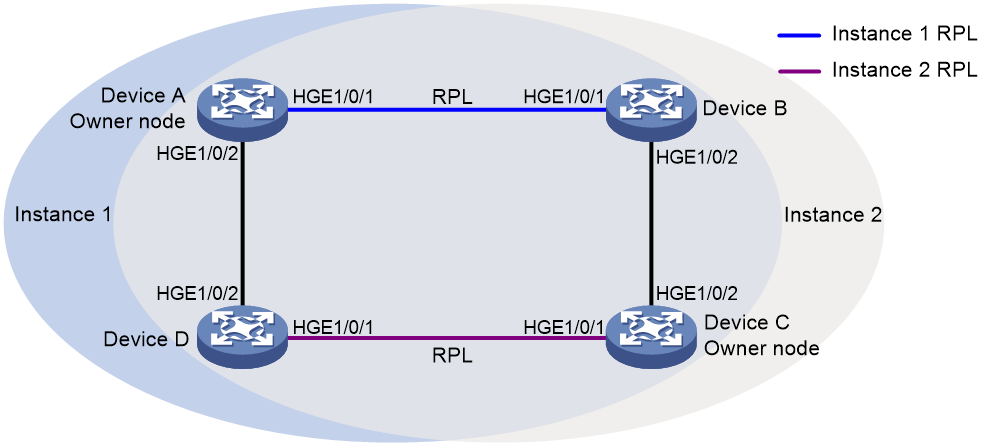

Multi-instance load balancing mechanism
Figure 4 Multi-instance load balancing mechanism
An ERPS ring topology might carry traffic from multiple VLANs. Traffic from different VLANs can be load balanced among different ERPS instances.
ERPS uses the following types of VLANs:
·     Control VLAN—Carries ERPS protocol packets. Each ERPS instance has its own control VLAN.
·     Protected VLAN—Carries data packets. Each ERPS instance has its own protected VLAN. Protected VLANs are configured by using the mappings between VLANs and MSTIs.
As shown in Figure 4, the ERPS ring is configured with instance 1 and instance 2. For instance 1, the owner node is Device A, and the RPL is the link between Device A and Device B. For instance 2, the owner node is Device C, and the RPL is the link between Device C and Device D. Traffic from different VLANs can be load balanced among different links.

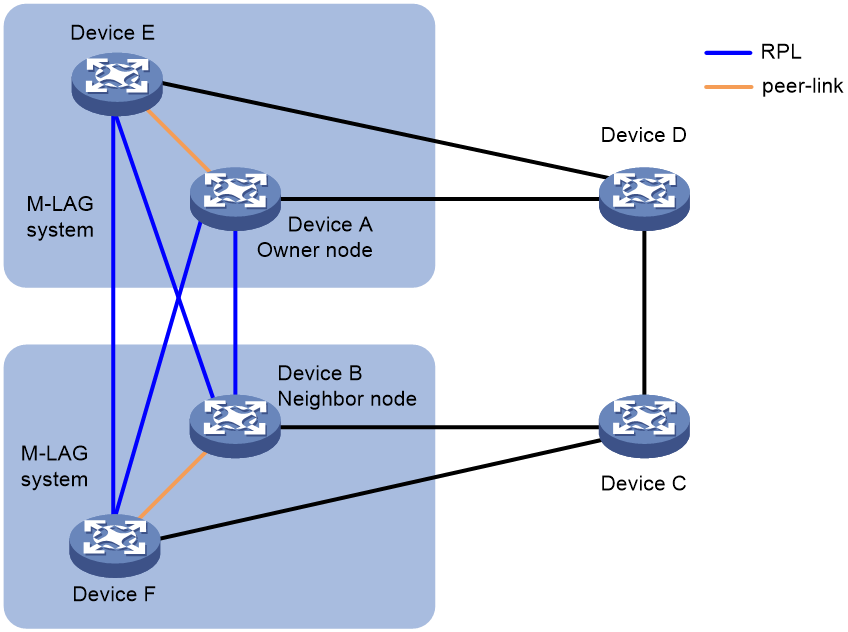

ERPS with M-LAG
M-LAG allows you to virtualize the devices in an ERPS ring into one system through multichassis link, thereby achieving device-level redundancy and load balancing.
You can use the display erps detail ring command to determine whether ERPS works correctly in an M-LAG network. For more information about M-LAG, see Layer 2—LAN Switching Configuration Guide.
Figure 11 ERPS with M-LAG

[DeviceA] interface hundredgige 1/0/1
[DeviceA-HundredGigE1/0/1] link-delay up 0
[DeviceA-HundredGigE1/0/1] link-delay down 0
# Disable the spanning tree feature on the port.
[DeviceA-HundredGigE1/0/1] undo stp enable
# Configure the port as a trunk port and assign it to VLANs 1 to 30.
[DeviceA-HundredGigE1/0/1] port link-type trunk
[DeviceA-HundredGigE1/0/1] port trunk permit vlan 1 to 30
[DeviceA-HundredGigE1/0/1] quit
# Configure HundredGigE 1/0/2 in the same way HundredGigE 1/0/1 is configured.
[DeviceA] interface hundredgige 1/0/2
[DeviceA-HundredGigE1/0/2] link-delay up 0
[DeviceA-HundredGigE1/0/2] link-delay down 0
[DeviceA-HundredGigE1/0/2] undo stp enable
[DeviceA-HundredGigE1/0/2] port link-type trunk
[DeviceA-HundredGigE1/0/2] port trunk permit vlan 1 to 30
[DeviceA-HundredGigE1/0/2] quit
# Create ERPS ring 1.
[DeviceA] erps ring 1
# Configure ERPS ring member ports.
[DeviceA-erps-ring1] port0 interface hundredgige 1/0/1
[DeviceA-erps-ring1] port1 interface hundredgige 1/0/2
# Create ERPS instance 1.
[DeviceA-erps-ring1] instance 1
# Configure the node role.
[DeviceA-erps-ring1-inst1] node-role owner rpl port0
# Configure the control VLAN.
[DeviceA-erps-ring1-inst1] control-vlan 100
# Configure the protected VLANs.
[DeviceA-erps-ring1-inst1] protected-vlan reference-instance 1
# Enable ERPS for instance 1.
[DeviceA-erps-ring1-inst1] instance enable
[DeviceA-erps-ring1-inst1] quit
[DeviceA-erps-ring1] quit
# Enable CFD, and create a level-5 MD named MD_A.
[DeviceA] cfd enable
[DeviceA] cfd md MD_A level 5
# Create Ethernet service instance 1, in which the MA is identified by a VLAN and serves VLAN 1.
[DeviceA] cfd service-instance 1 ma-id vlan-based md MD_A vlan 1
# Configure a MEP list in Ethernet service instance 1, create outward-facing MEP 1001 in Ethernet service instance 1, and enable CCM sending on HundredGigE 1/0/1.
[DeviceA] cfd meplist 1001 1002 service-instance 1
[DeviceA-HundredGigE1/0/1] cfd mep 1001 service-instance 1 outbound
[DeviceA-HundredGigE1/0/1] cfd cc service-instance 1 mep 1001 enable
# Create Ethernet service instance 2, in which the MA is identified by a VLAN and serves VLAN 2.
[DeviceA] cfd service-instance 2 ma-id vlan-based md MD_A vlan 2
# Configure a MEP list in Ethernet service instance 2, create outward-facing MEP 2001 in Ethernet service instance 1, and enable CCM sending on HundredGigE 1/0/2.
[DeviceA] cfd meplist 2001 2002 service-instance 2
[DeviceA-HundredGigE1/0/2] cfd mep 2001 service-instance 2 outbound
[DeviceA-HundredGigE1/0/2] cfd cc service-instance 2 mep 2001 enable
# Create track entry 1 and associate it with the CC function of CFD for MEP 1001 in Ethernet service instance 1.
[DeviceA] track 1 cfd cc service-instance 1 mep 1001
# Associate HundredGigE 1/0/1 with track entry 1 and bring up the port.
[DeviceA-HundredGigE1/0/1] port erps ring 1 instance 1 track 1
[DeviceA-HundredGigE1/0/1] undo shutdown
# Create track entry 2 and associate it with the CC function of CFD for MEP 2001 in Ethernet service instance 2.
[DeviceA] track 2 cfd cc service-instance 2 mep 2001
# Associate HundredGigE 1/0/2 with track entry 2 and bring up the port.
[DeviceA-HundredGigE1/0/2] port erps ring 1 instance 1 track 2
[DeviceA-HundredGigE1/0/2] undo shutdown
# Enable ERPS.
[DeviceA] erps enable

Example: Configuring one-ring multi-instance load balancing
As shown in Figure 14, perform the following tasks to improve network resource utilization and implement load balancing among links:
·     Configure ERPS instances 1 and 2 on the ERPS ring.
·     For ERPS instance 1, configure the following items:
¡     Configure Device A as the owner node.
¡     Configure the link between Devices A and Device B as the RPL.
¡     Configure VLAN 100 as the control VLAN.
¡     Configure VLANs 1 to 30 as the protected VLANs.
·     For ERPS instance 2, configure the following items:
¡     Configure the link between Devices C and Device D as the RPL.
¡     Configure VLANs 31 to 60 as the protected VLANs.
Figure 14 Network diagram
By default, interfaces on the device are disabled (in ADM or Administratively Down state). To have an interface operate, you must use the undo shutdown command to enable that interface.
1.     Configure Device A.
# Create VLANs 1 to 60, map VLANs 1 to 30 to MSTI 1, map VLANs 31 to 60 to MSTI 2, and activate the MST region configuration.
<DeviceA> system-view
[DeviceA] vlan 1 to 60
[DeviceA] stp region-configuration
[DeviceA-mst-region] instance 1 vlan 1 to 30
[DeviceA-mst-region] instance 2 vlan 31 to 60
[DeviceA-mst-region] active region-configuration
[DeviceA-mst-region] quit
# Set the link state change suppression interval to 0 seconds on HundredGigE 1/0/1.
# Configure the port as a trunk port and assign it to VLANs 1 to 60.
[DeviceA-HundredGigE1/0/1] port trunk permit vlan 1 to 60
[DeviceA-HundredGigE1/0/2] port trunk permit vlan 1 to 60
# Create ERPS instance 2.
[DeviceA-erps-ring1] instance 2
[DeviceA-erps-ring1-inst2] control-vlan 110
[DeviceA-erps-ring1-inst2] protected-vlan reference-instance 2
# Enable ERPS for instance 2.
[DeviceA-erps-ring1-inst2] instance enable
[DeviceA-erps-ring1-inst2] quit
# Associate HundredGigE 1/0/1 with track entry 1 and bring up the port for ERPS instances 1 and 2.
[DeviceA-HundredGigE1/0/1] port erps ring 1 instance 2 track 1
# Associate HundredGigE 1/0/2 with track entry 2 and bring up the port for ERPS instances 1 and 2.
[DeviceA-HundredGigE1/0/2] port erps ring 1 instance 2 track 2
# Enable ERPS.
[DeviceC-erps-ring1-inst1] instance enable
[DeviceC-erps-ring1-inst1] quit
[DeviceC-erps-ring1] quit
[DeviceC-erps-ring1] instance 2
[DeviceC-erps-ring1-inst2] node-role owner rpl port0
[DeviceC-erps-ring1-inst2] control-vlan 110
[DeviceC-erps-ring1-inst2] protected-vlan reference-instance 2
[DeviceC-erps-ring1-inst2] instance enable
[DeviceC-erps-ring1-inst2] quit
[DeviceC] cfd enable
[DeviceC] cfd md MD_A level 5
# Create Ethernet service instance 3, in which the MA is identified by a VLAN and serves VLAN 3.
[DeviceC] cfd service-instance 3 ma-id vlan-based md MD_A vlan 3
# Configure a MEP list in Ethernet service instance 3, create outward-facing MEP 3001 in Ethernet service instance 3, and enable CCM sending on HundredGigE 1/0/2.
[DeviceC] cfd meplist 3001 3002 service-instance 3
[DeviceC] interface hundredgige 1/0/2
[DeviceC-HundredGigE1/0/2] cfd mep 3001 service-instance 3 outbound
[DeviceC-HundredGigE1/0/2] cfd cc service-instance 3 mep 3001 enable
[DeviceC-HundredGigE1/0/2] quit
# Create Ethernet service instance 4, in which the MA is identified by a VLAN and serves VLAN 4.
[DeviceC] cfd service-instance 4 ma-id vlan-based md MD_A vlan 4
# Configure a MEP list in Ethernet service instance 4, create outward-facing MEP 4001 in Ethernet service instance 4, and enable CCM sending on HundredGigE 1/0/1.
[DeviceC] cfd meplist 4001 4002 service-instance 4
[DeviceC] interface hundredgige 1/0/1
[DeviceC-HundredGigE1/0/1] cfd mep 4001 service-instance 4 outbound
[DeviceC-HundredGigE1/0/1] cfd cc service-instance 4 mep 4001 enable
[DeviceC-HundredGigE1/0/1] quit
# Create track entry 1 and associate it with the CC function of CFD for MEP 3001 in Ethernet service instance 3.
[DeviceC] track 1 cfd cc service-instance 3 mep 3001
# Associate HundredGigE 1/0/2 with track entry 1 and bring up the port for ERPS instances 1 and 2.
[DeviceC-HundredGigE1/0/2] port erps ring 1 instance 1 track 1
[DeviceC-HundredGigE1/0/2] port erps ring 1 instance 2 track 1
[DeviceC-HundredGigE1/0/2] undo shutdown
# Create track entry 2 and associate it with the CC function of CFD for MEP 4001 in Ethernet service instance 4.
[DeviceC] track 2 cfd cc service-instance 4 mep 4001
# Associate HundredGigE 1/0/1 with track entry 2 and bring up the port for ERPS instances 1 and 2.
[DeviceC-HundredGigE1/0/1] port erps ring 1 instance 1 track 2
[DeviceC-HundredGigE1/0/1] port erps ring 1 instance 2 track 2
[DeviceC-HundredGigE1/0/1] undo shutdown
# Enable ERPS.
[DeviceC] erps enable
4.     Configure Device D.
<DeviceD> system-view
[DeviceD] vlan 1 to 60
[DeviceD] stp region-configuration
[DeviceD-mst-region] instance 1 vlan 1 to 30
[DeviceD-mst-region] instance 2 vlan 31 to 60
[DeviceD-mst-region] active region-configuration
[DeviceD-mst-region] quit
[DeviceD] interface hundredgige 1/0/1
[DeviceD-HundredGigE1/0/1] link-delay up 0
[DeviceD-HundredGigE1/0/1] link-delay down 0
[DeviceD-HundredGigE1/0/1] undo stp enable
[DeviceD-HundredGigE1/0/1] port link-type trunk
[DeviceD-HundredGigE1/0/1] port trunk permit vlan 1 to 60
[DeviceD-HundredGigE1/0/1] quit
[DeviceD] interface hundredgige 1/0/2
[DeviceD-HundredGigE1/0/2] link-delay up 0
[DeviceD-HundredGigE1/0/2] link-delay down 0
[DeviceD-HundredGigE1/0/2] undo stp enable
[DeviceD-HundredGigE1/0/2] port link-type trunk
[DeviceD-HundredGigE1/0/2] port trunk permit vlan 1 to 60
[DeviceD-HundredGigE1/0/2] quit
[DeviceD] erps ring 1
[DeviceD-erps-ring1] port0 interface hundredgige 1/0/1
[DeviceD-erps-ring1] port1 interface hundredgige 1/0/2
[DeviceD-erps-ring1] instance 1
[DeviceD-erps-ring1-inst1] control-vlan 100
[DeviceD-erps-ring1-inst1] protected-vlan reference-instance 1
[DeviceD-erps-ring1-inst1] instance enable
[DeviceD-erps-ring1] quit
[DeviceD-erps-ring1] instance 2
[DeviceD-erps-ring1-inst2] node-role neighbor rpl port0
[DeviceD-erps-ring1-inst2] control-vlan 110
[DeviceD-erps-ring1-inst2] protected-vlan reference-instance 2
[DeviceD-erps-ring1-inst2] instance enable
[DeviceD-erps-ring1-inst2] quit
[DeviceD] cfd enable
[DeviceD] cfd md MD_A level 5
[DeviceD] cfd service-instance 2 ma-id vlan-based md MD_A vlan 2
# Configure a MEP list in Ethernet service instance 2, create outward-facing MEP 2002 in Ethernet service instance 2, and enable CCM sending on HundredGigE 1/0/2.
[DeviceD] cfd meplist 2001 2002 service-instance 2
[DeviceD-HundredGigE1/0/2] cfd mep 2002 service-instance 2 outbound
[DeviceD-HundredGigE1/0/2] cfd cc service-instance 2 mep 2002 enable
[DeviceD] cfd service-instance 4 ma-id vlan-based md MD_A vlan 4
# Configure a MEP list in Ethernet service instance 4, create outward-facing MEP 4002 in Ethernet service instance 4, and enable CCM sending on HundredGigE 1/0/1.
[DeviceD] cfd meplist 4001 4002 service-instance 4
[DeviceD-HundredGigE1/0/1] cfd mep 4002 service-instance 4 outbound
[DeviceD-HundredGigE1/0/1] cfd cc service-instance 4 mep 4002 enable
# Create track entry 1 and associate it with the CC function of CFD for MEP 2002 in Ethernet service instance 2.
[DeviceD] track 1 cfd cc service-instance 2 mep 2002
[DeviceD-HundredGigE1/0/2] port erps ring 1 instance 1 track 1
[DeviceD-HundredGigE1/0/2] port erps ring 1 instance 2 track 1
[DeviceD-HundredGigE1/0/2] undo shutdown
# Create track entry 2 and associate it with the CC function of CFD for MEP 4002 in Ethernet service instance 4.
[DeviceD] track 2 cfd cc service-instance 4 mep 4002
[DeviceD-HundredGigE1/0/1] port erps ring 1 instance 1 track 2
[DeviceD-HundredGigE1/0/1] port erps ring 1 instance 2 track 2
[DeviceD-HundredGigE1/0/1] undo shutdown
# Enable ERPS.
[DeviceD] erps enable
# Display information about ERPS instance 1 for Device A.
[Device A] display erps detail ring 1
 Ring ID               : 1
 Port0                 : HundredGigE1/0/1
 Port1                 : HundredGigE1/0/2
 Subring               : No
 Default MAC           : No
 Instance ID           : 1
 Node role             : Owner
 Node state            : Idle
 Connect(ring/instance): -
 Control VLAN          : 100
 Protected VLAN        : Reference-instance 1
 Guard timer           : 500 ms
 Hold-off timer        : 0 ms
 WTR timer             : 5 min
 Revertive operation   : Revertive
 Enable status         : Yes
 Active status         : Yes
 R-APS level           : 7
 Port                  PortRole                PortStatus
 Port0                 RPL                     Block
 Port1                 Non-RPL                 Up
 Instance ID           : 2
 Node role             : Normal
 Node state            : Idle
 Control VLAN          : 100
 Protected VLAN        : Reference-instance 2
 WTR timer             : 5 min
 Enable status         : Yes
 Active status         : Yes
 R-APS level           : 7
 Port0                 Non-RPL                 Up
 Port1                 Non-RPL                 Up
The output shows the following information:
·     For ERPS instance 1:
¡     Device A is the owner node.
¡     The ERPS ring is in idle state.
¡     The RPL port is blocked.
¡     The non-RPL port is unblocked.
·     For ERPS instance 2:
¡     Device A is a normal node.
