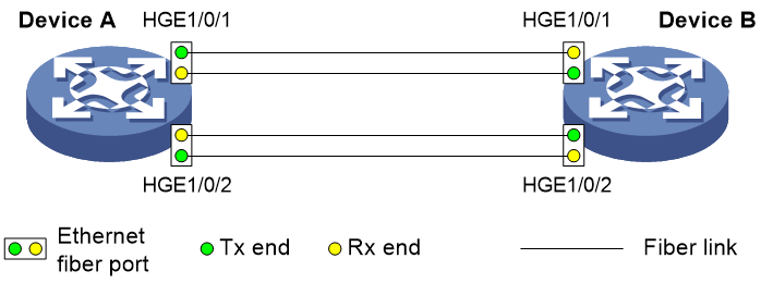

A link becomes unidirectional when only one end of the link can receive packets from the other end.
Unidirectional fiber links occur in the following cases:
· Fibers are cross-connected.
· A fiber is not connected at one end or one fiber of a fiber pair is broken.
Figure 1 shows a correct fiber connection and two types of unidirectional fiber connections.
When DLDP detects unidirectional links, it can automatically shut down the faulty port to avoid network problems. Alternatively, a user can manually shut down the faulty port.
Figure 1 Correct and incorrect fiber connections

When two devices are connected through an optical fiber or a network cable, enable DLDP to detect unidirectional links to the neighbor. The following illustrates the unidirectional link detection process in two cases:
· Unidirectional links occur before you enable DLDP.
Figure 2 Cross-connected fibers
As shown in Figure 2, before you enable DLDP, the optical fibers between Device A and Device B are cross-connected. After you enable DLDP, the four ports are all up and in unidirectional state, and they send RecoverProbe packets. Take Port A1 as an example to illustrate the unidirectional link detection process.
a. Port A1 receives the RecoverProbe packet from Port B2, and returns a RecoverEcho packet.
b. Port B2 cannot receive any RecoverEcho packet from Port A1, so Port B2 cannot become the neighbor of Port A1.
c. Port B1 can receive the RecoverEcho packet from Port A1, but Port B1 is not the intended destination, so Port B1 cannot become the neighbor of Port A1.
The same process occurs on the other three ports. The four ports are all in unidirectional state.

Example: Configuring the manual port shutdown mode
As shown in Figure 6, Device A and Device B are connected through two fiber pairs.
Configure DLDP to detect unidirectional links. When a unidirectional link is detected, the administrator must manually shut down the port.
By default, interfaces on the device are disabled (in ADM or Administratively Down state). To have an interface operate, you must use the undo shutdown command to enable that interface.

Example: Configuring the hybrid port shutdown mode
As shown in Figure 7, Device A and Device B are connected through two fiber pairs.
Configure DLDP to detect unidirectional links. When a unidirectional link is detected, DLDP automatically shuts down the unidirectional port. The administrator needs to bring up the port after clearing the fault.

# Display the DLDP configuration globally and on all the DLDP-enabled ports of Device A.
[DeviceA] display dldp
DLDP global status: Enabled
DLDP advertisement interval: 5s
DLDP authentication-mode: None
DLDP unidirectional-shutdown mode: Hybrid
DLDP delaydown-timer value: 1s
Number of enabled ports: 2
Interface HundredGigE1/0/1
DLDP port state: Bidirectional
DLDP port unidirectional-shutdown mode: None
DLDP initial-unidirectional-delay: 0s
Number of the port’s neighbors: 1
Neighbor MAC address: 0023-8956-3600
Neighbor port index: 1
Neighbor state: Confirmed
Neighbor aged time: 11s
Neighbor echo time: -
Interface HundredGigE1/0/2
Neighbor port index: 2
Neighbor aged time: 12s
The output shows that both HundredGigE 1/0/1 and HundredGigE 1/0/2 are in bidirectional state, which means both links are bidirectional.
# Enable the monitoring of logs on the current terminal on Device A. Set the lowest level of the logs that can be output to the current terminal to 6.
[DeviceA] quit
<DeviceA> terminal monitor
The current terminal is enabled to display logs.
<DeviceA> terminal logging level 6
The following log information is displayed on Device A:
<DeviceA>%Jan 4 07:16:06:556 2019 DeviceA DLDP/5/DLDP_NEIGHBOR_AGED: A neighbor on interface
HundredGigE1/0/1 was deleted because the neighbor was aged. The neighbor's system MAC is 0023-8956-3600, and the port index is 162.
%Jan 4 07:16:06:560 2019 DeviceA DLDP/5/DLDP_NEIGHBOR_AGED: A neighbor on interface
HundredGigE1/0/2 was deleted because the neighbor was aged. The neighbor's system MAC is 0023-8956-3600, and the port index is 165.
%Jan 4 07:16:06:724 2019 DeviceA IFNET/3/PHY_UPDOWN: Physical state on the interface HundredGigE1/0/1 changed to down.
%Jan 4 07:16:06:730 2019 DeviceA IFNET/3/PHY_UPDOWN: Physical state on the interface HundredGigE1/0/2 changed to down.
%Jan 4 07:16:06:736 2019 DeviceA IFNET/5/LINK_UPDOWN: Line protocol state on the interface HundredGigE1/0/1 changed to down.
%Jan 4 07:16:06:738 2019 DeviceA IFNET/5/LINK_UPDOWN: Line protocol state on the interface HundredGigE1/0/2 changed to down.
%Jan 4 07:16:07:152 2019 DeviceA DLDP/3/DLDP_LINK_UNIDIRECTIONAL: DLDP detected a unidirectional link on interface HundredGigE1/0/1. DLDP automatically shut down the interface. Please manually bring up the interface.
%Jan 4 07:16:07:156 2019 DeviceA DLDP/3/DLDP_LINK_UNIDIRECTIONAL: DLDP detected a unidirectional link on interface HundredGigE1/0/2. DLDP automatically shut down the interface. Please manually bring up the interface.
The output shows that the port status and link status of both HundredGigE 1/0/1 and HundredGigE 1/0/2 are down.
# Display the DLDP configuration globally and of all the DLDP-enabled ports.
<DeviceA> display dldp
DLDP port state: Inactive
Number of the port's neighbors: 0 (Maximum number ever detected: 1)
The output shows that DLDP detects a unidirectional link and shuts down HundredGigE 1/0/1 and HundredGigE 1/0/2.
The unidirectional links are caused by cross-connected fibers. Bring up the two ports after correcting the fiber connection:
# Bring up HundredGigE 1/0/1.
<DeviceA> system-view
[DeviceA] interface hundredgige 1/0/1
[DeviceA-HundredGigE1/0/1] undo shutdown
[DeviceA-HundredGigE1/0/1]%Jan 4 07:33:26:574 2019 DeviceA IFNET/3/PHY_UPDOWN: Physical state on the interface HundredGigE1/0/1 changed to up.
%Jan 4 07:33:57:562 2019 DeviceA DLDP/6/DLDP_NEIGHBOR_CONFIRMED: A neighbor was confirmed on interface HundredGigE1/0/1. The neighbor's system MAC is 0023-8956-3600, and the port index is 162.
%Jan 4 07:33:57:563 2019 DeviceA DLDP/6/DLDP_LINK_BIDIRECTIONAL: DLDP detected a bidirectional link on interface HundredGigE1/0/1.
%Jan 4 07:33:57:590 2019 DeviceA IFNET/5/LINK_UPDOWN: Line protocol state on the interface HundredGigE1/0/1 changed to up.
%Jan 4 07:33:57:609 2019 DeviceA STP/6/STP_DETECTED_TC: Instance 0's port HundredGigE1/0/1 detected a topology change.
The output shows that the port status and link status of HundredGigE 1/0/1 are now up and its DLDP neighbors are determined.
# Bring up HundredGigE 1/0/2.
[DeviceA-HundredGigE1/0/1] quit
[DeviceA] interface hundredgige 1/0/2
[DeviceA-HundredGigE1/0/2] undo shutdown
[DeviceA-HundredGigE1/0/2]%Jan 4 07:35:26:574 2019 DeviceA IFNET/3/PHY_UPDOWN: Physical state on the interface HundredGigE1/0/2 changed to up.
%Jan 4 07:35:57:562 2019 DeviceA DLDP/6/DLDP_NEIGHBOR_CONFIRMED: A neighbor was confirmed on interface HundredGigE1/0/2. The neighbor's system MAC is 0023-8956-3600, and the port index is 162.
%Jan 4 07:35:57:563 2019 DeviceA DLDP/6/DLDP_LINK_BIDIRECTIONAL: DLDP detected a bidirectional link on interface HundredGigE1/0/2.
%Jan 4 07:35:57:590 2019 DeviceA IFNET/5/LINK_UPDOWN: Line protocol state on the interface HundredGigE1/0/2 changed to up.
%Jan 4 07:35:57:609 2019 DeviceA STP/6/STP_DETECTED_TC: Instance 0's port HundredGigE1/0/2 detected a topology change.
The output shows that the port status and link status of HundredGigE 1/0/2 are now up and its DLDP neighbors are determined.
