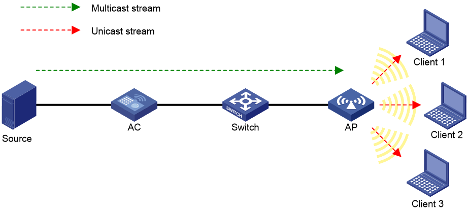

WLAN multicast optimization enables an AP to convert multicast packets to unicast packets.
Figure 1 Data transmission with WLAN multicast optimization enabled
