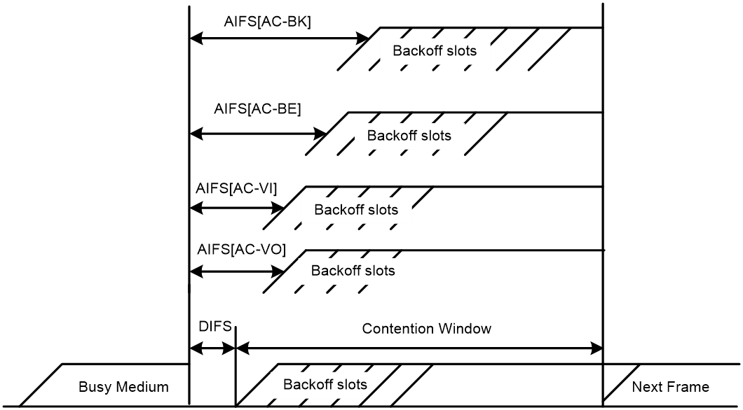

EDCA parameters
·     Arbitration inter-frame spacing number—In 802.11-based WLAN, each client has the same idle duration (DIFS), but WMM defines an idle duration for each AC. The idle duration increases as the AIFSN increases.
·     Exponent form of CWmin/Exponent form of CWmax—ECWmin/ECWmax determines the backoff slots, which increase as the two values increase.
·     Transmission opportunity limit—TXOP limit specifies the maximum time that a client can hold the channel after a successful contention. A larger value represents a longer time. If the value is 0, a client can send only one packet each time it holds the channel.
Figure 1 EDCA parameters

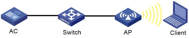

Example: Configuring basic WMM
As shown in Figure 2, enable WMM on the AC so that the AP and the client can prioritize the traffic.
Figure 2 Network diagram
# Create a service template named market, set the SSID to market, and enable the service template.
<AC> system-view
[AC] wlan service-template market
[AC-wlan-st-market] ssid market
[AC-wlan-st-market] service-template enable
[AC-wlan-st-market] quit

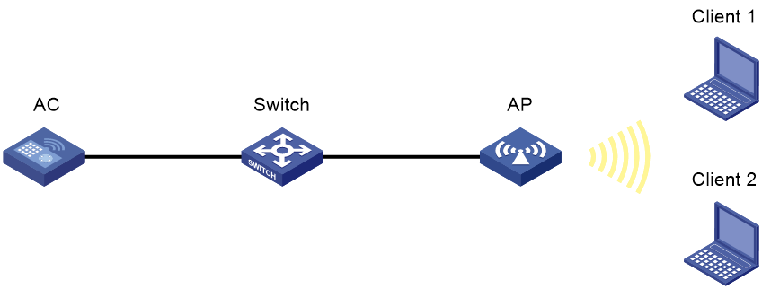

Example: Configuring CAC
As shown in Figure 3, configure CAC to allow a maximum of 10 clients to use AC-VO and AC-VI queues.
Figure 3 Network diagram
1.     Create a service template named market, set the SSID to market, and enable the service template.
<AC> system-view
2.     Create a manual AP named ap1, and specify the AP model and serial ID.
[AC] wlan ap ap1 model WA6320
[AC-wlan-ap-ap1] serial-id 219801A28N819CE0002T
3.     Configure WMM:
# Bind service template market to radio 1.
[AC-wlan-ap-ap1] radio 1
[AC-wlan-ap-ap1-radio-1] service-template market
# Enable WMM for AC-VO and AC-VI queues, and configure a CAC policy to limit the number of clients to 10.
[AC-wlan-ap-ap1-radio-1] wmm enable
[AC-wlan-ap-ap1-radio-1] edca client ac-vo cac enable
[AC-wlan-ap-ap1-radio-1] edca client ac-vi cac enable
[AC-wlan-ap-ap1-radio-1] cac policy client 10
# Enable radio 1.
[AC-wlan-ap-ap1-radio-1] radio enable
# Assume that a client requests to use a high-priority AC queue (AC-VO or AC-VI). Verify the following information:
·     If the number of clients using high-priority AC queues is smaller than the maximum number of high-priority AC clients (10 in this example), the request is accepted.
·     If the number of clients using high-priority AC queues is equal to the maximum number of high-priority AC clients (10 in this example), the request is rejected. The AP decreases the priority of packets from the client.
