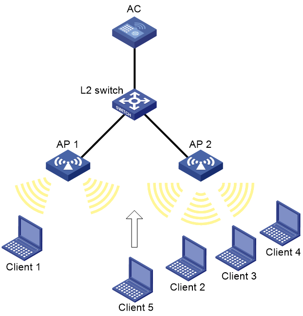

Session-mode load balancing
As shown in Figure 2, each AP has only one radio enabled. Client 1 associates with AP 1, and Client 2 through Client 4 associate with AP 2. The session threshold and session gap threshold are set to 3 and 2, respectively. When Client 5 tries to associate with AP 2, AP 2 rejects the request because both the session threshold and session gap threshold are reached.

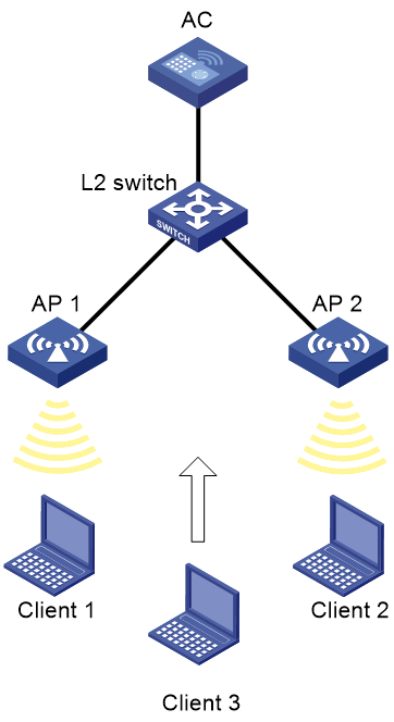

Traffic-mode load balancing
As shown in Figure 3, each AP has only one radio enabled. Client 1 associates with AP 1, and Client 2 associates with AP 2. When the traffic of AP 1 and the traffic gap between AP 1 and AP 2 reach their respective thresholds, AP 1 rejects the association request from Client 3.

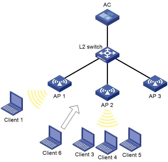

Bandwidth-mode load balancing
As shown in Figure 4, each AP has only one radio enabled. Client 1 associates with AP 1, and Client 2 associates with AP 2. When the bandwidth of AP 1 and the bandwidth gap between AP 1 and AP 2 reach their respective thresholds, AP 1 rejects the association request from Client 3.

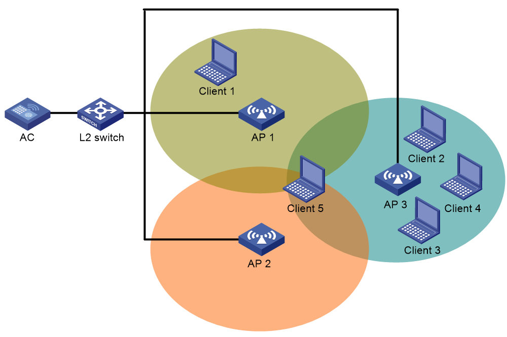

·     Radio basedThe device determines the radios that will participate in load balancing based on the received/collected neighbor reports. The neighbor report of a radio records the MAC address and RSSI value of each client that is detected by the radio. The device determines that a radio will participate in load balancing when either of the following conditions is met:
¡     A client requests to associate with the radio.
¡     The radio detects that a client's RSSI has reached the RSSI threshold but the client does not request to associate with the radio.
·     Load balancing group based—You add the radios of desired APs to a load balancing group. The device performs load balancing only on radios in this load balancing group.

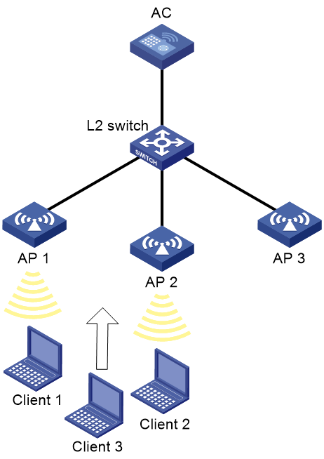

As shown in Figure 5, each AP has only one radio enabled. AP 1 and AP 2 are managed by the AC and the clients can discover the APs. Client 1 associates with AP 1, and Client 2 through Client 4 associate with AP 2.
Configure the AC to perform session-mode load balancing on AP 1 and AP 2 when the following conditions are met:
·     The number of sessions on one AP reaches 3.
·     The session gap between the APs reaches 2.

Load balancing group-based WLAN load balancing configuration examples
Example: Configuring session-mode load balancing
As shown in Figure 8, AP 1, AP 2, and AP 3 are managed by the AC and the clients can discover the APs. Client 1 associates with radio 2 of AP 1. Client 3 through Client 5 associate with radio 2 of AP 2.
Configure the AC to perform session-mode load balancing on radio 2 of AP 1 and radio 2 of AP 2 when the following conditions are met:
·     The number of sessions on one radio reaches 3.
·     The session gap between the radios reaches 2.
Figure 8 Network diagram
# Create wireless service template 1, and set its SSID to session-balance.
<AC> system-view
[AC] wlan service-template 1
[AC-wlan-st-1] ssid session-balance
[AC-wlan-st-1] service-template enable
[AC-wlan-st-1] quit
# Create AP template ap1, and specify the model and serial ID.
[AC] wlan ap ap1 model WA6320
[AC-wlan-ap-ap1] serial-id 219801A28N819CE0002T
# Bind service template 1 to radio 2 of AP 1.
[AC-wlan-ap-ap1] radio 2
[AC-wlan-ap-ap1-radio-2] service-template 1
[AC-wlan-ap-ap1-radio-2] radio enable
[AC-wlan-ap-ap1-radio-2] quit
[AC-wlan-ap-ap1] quit
# Create AP template ap2, and specify the model and serial ID.
[AC] wlan ap ap2 model WA6320
[AC-wlan-ap-ap2] serial-id 219801A28N819CE0003T
# Bind service template 1 to radio 2 of AP 2.
[AC-wlan-ap-ap2] radio 2
[AC-wlan-ap-ap2-radio-2] service-template 1
[AC-wlan-ap-ap2-radio-2] radio enable
[AC-wlan-ap-ap2-radio-2] quit
[AC-wlan-ap-ap2] quit
# Create AP template ap3, and specify the model and serial ID.
[AC] wlan ap ap3 model WA6320
[AC-wlan-ap-ap3] serial-id 219801A28N819CE0004T
# Bind service template 1 to radio 2 of AP 3.
[AC-wlan-ap-ap3] radio 2
[AC-wlan-ap-ap3-radio-2] service-template 1
[AC-wlan-ap-ap3-radio-2] radio enable
[AC-wlan-ap-ap3-radio-2] quit
[AC-wlan-ap-ap3] quit
# Set the load balancing mode to session mode, and set the session threshold and session gap threshold to 3 and 2, respectively.
[AC] wlan load-balance mode session 3 gap 2
# Create load balancing group 1.
[AC] wlan load-balance group 1
# Add radio 2 of AP 1 and radio 2 of AP 2 to load balancing group 1.
[AC-wlan-lb-group-1] ap name ap1 radio 2
[AC-wlan-lb-group-1] ap name ap2 radio 2
# Enable WLAN load balancing.
[AC] wlan load-balance enable
# Verify that the AC performs session-mode load balancing for radio 2 of AP 1 and radio 2 of AP 2 when the following conditions are met:
·     The number of sessions on either radio reaches 3.
·     The session gap between the radios reaches 2. (Details not shown.)
# Verify that AP 1 and AP 2 are load balanced by using the display wlan client command. (Details not shown.)
