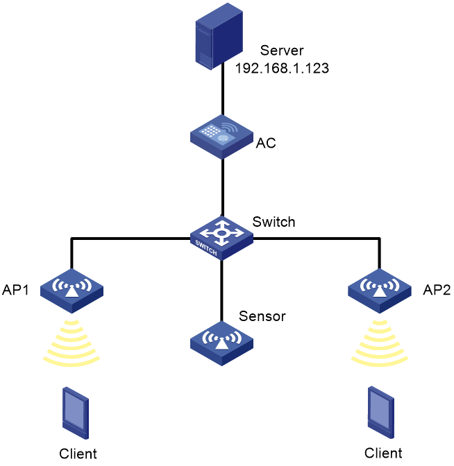

WLAN probe enables APs to monitor the WLAN and collect information about wireless devices in the WLAN. Then, the APs send the collected information to the specified server for further analysis.
WLAN probe system
As shown in Figure 1, a WLAN probe system contains the following devices:
· Sensors—APs enabled with WLAN probe. They scan the channels, collect wireless device information, and report the information to the server.
· AC—Manages sensors and reports information received from sensors to the server.
· Server—Analyzes the information received from sensors and the AC.
Operating mechanism
A WLAN probe system operates as follows:
1. Wireless devices send 802.11 packets.
2. Sensors collect wireless device information, such as MAC address, device type, RSSI, and time stamp from the packets.
3. Sensors send collected device information to the AC or server.
4. The server analyzes the received information.

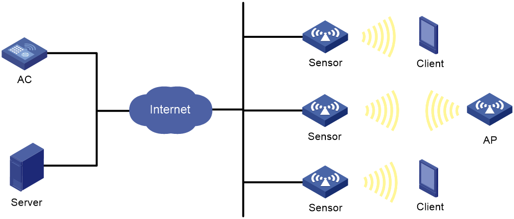

A sensor can report wireless device information to the UDP server directly or through the AC.
Specifying a UDP server for the AC
1. Enter system view.
2. Specify a UDP server to receive wireless device information from the AC.
client-proximity-sensor udp-server ip-address port port-number [ interval interval | preshared-key { cipher | simple } key-string ] *
By default, no UDP server is specified.
3. Enable sensors to report information about detected devices to the AC.
client-proximity-sensor report-ac enable
By default, sensors do not report information about detected devices to the AC.
4. (Optional.) Set the interval at which sensors report information about detected devices to the AC.
client-proximity-sensor report-ac-interval interval
By default, sensors report information about detected devices to the AC every 3 seconds.
5. (Optional.) Enable reporting of AP information to the UDP server.
client-proximity-sensor report-ap enable
By default, AP information is not reported to the UDP server.
Specifying a UDP server for a sensor
2. Enter AP view or AP group view.
¡ Enter AP view.
wlan ap ap-name
¡ Enter AP group view.
wlan ap-group group-name
3. Specify a UDP server to receive wireless device information from the sensor.
client-proximity-sensor ap-udp-server ip-address port port-number [ interval interval | preshared-key { cipher | simple } key-string ] *
4. (Optional.) Enable reporting of AP information to the UDP server.

WLAN probe configuration examples
Example: Configuring WLAN probe
As shown in Figure 2, AP 1 and AP 2 provide wireless services for clients through SSID abc.
Enable WLAN probe on the sensor, and configure the AC to report the received wireless device information to the server.
# Configure wireless service settings on the AC. (Details not shown.)
For more information, see "Configuring WLAN access."
# Create AP Sensor, and enable WLAN probe for the AP.
<AC> system-view
[AC] wlan ap Sensor model WA6320
[AC-wlan-ap-Sensor] serial-id 219801A28N819CE0002T
[AC-wlan-ap-Sensor] radio 1
[AC-wlan-ap-Sensor-radio-1] radio enable
[AC-wlan-ap-Sensor-radio-1] client-proximity-sensor enable
[AC-wlan-ap-Sensor-radio-1] quit
[AC-wlan-ap-Sensor] radio 2
[AC-wlan-ap-Sensor-radio-2] radio enable
[AC-wlan-ap-Sensor-radio-2] client-proximity-sensor enable
[AC-wlan-ap-Sensor] quit
# Configure the sensor to report wireless device information to the AC.
[AC] client-proximity-sensor report-ac enable
# Configure the AC to report wireless device information to the UDP server with IP address 192.168.1.123 and port number 1234, and set the report interval to 20 seconds.
[AC] client-proximity-sensor udp-server 192.168.1.123 port 1234 interval 20
# Display wireless device information detected by the sensor.
[AC] display client-proximity-sensor device
Total 3 detected devices
MAC address Type Duration Sensors Channel Status
0021-632F-E9E5 Client 00h 10m 46s 1 11 Active
0021-6330-148B Client 00h 10m 46s 1 6 Active
0212-34B8-A8E0 Client 00h 10m 46s 1 1 Active
# On the management console of the server, view the wireless device information received from the AC. (Details not shown.)
