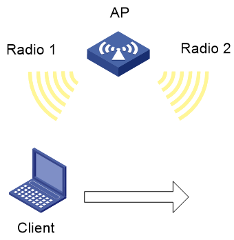

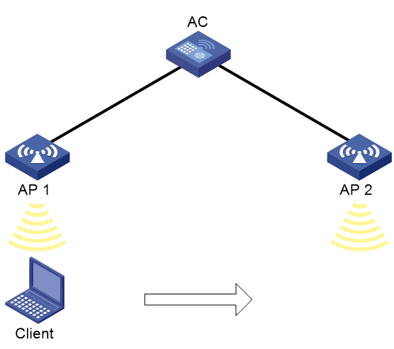

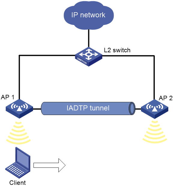

As shown in Figure 8, the client roams from AP 1 to AP 2 as follows:
1.     The client comes online from AP 1, and the AC creates a roaming entry for the client.
The entry records the initial SSID at association, PMKID, authentication method, security mode, and roaming VLAN.
2.     The client roams to AP 2. The AC examines the roaming entry.
3.     The client performs reauthentication and then comes online from AP 2.
Figure 1 WLAN roaming mechanism

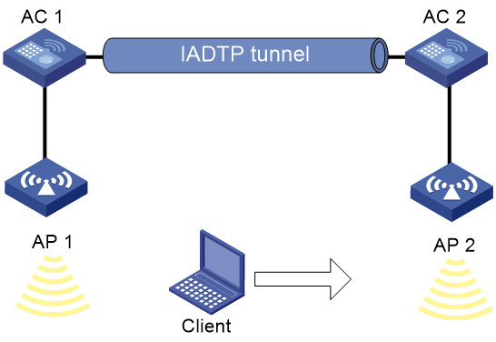

Layer 3 roaming

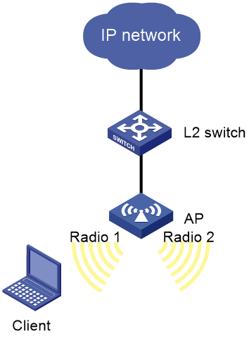

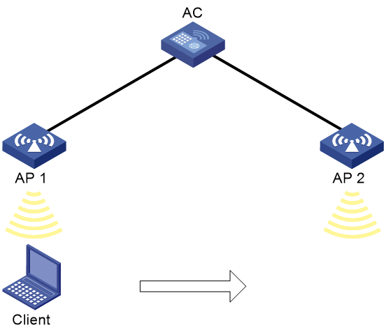

As shown in Figure 2, the client can roam between APs in different VLANs without special configuration. For the roaming procedure, see "WLAN roaming mechanism."
Figure 2 Layer 3 roaming

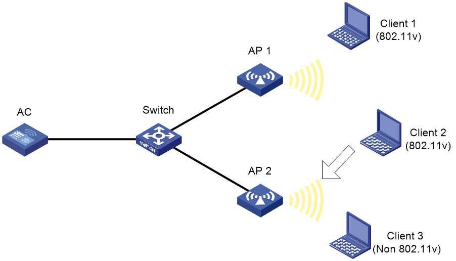

Example: Configuring intra-AC roaming

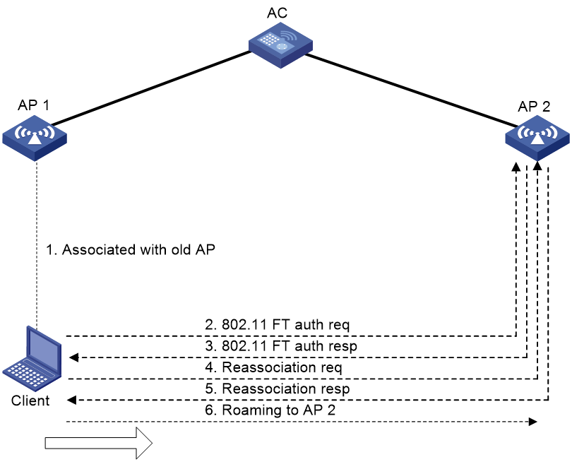

As shown in Figure 3, configure intra-AC roaming to enable the client to roam from AP 1 to AP 2. The two APs are managed by the same AC.
Figure 3 Network diagram

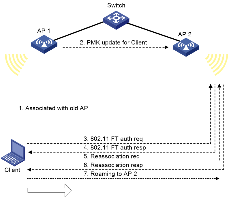

Intra-AC roaming
As shown in Figure 4, 802.1X fast intra-AC roaming operates as follows:
1.     The client comes online from AP 1 after passing RSN+802.1X authentication. AP 1 creates a roaming entry for the client.
For more information about 802.1X authentication, see "Configuring WLAN security."
2.     The client roams to AP 2. The AP examines the roaming entry for the client and triggers 802.1X fast forwarding if the client carries the same PMKID as the AP.
The system uses the cached PMK to perform key negotiation and the client can associate with AP 2 without reauthentication.

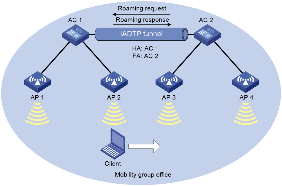

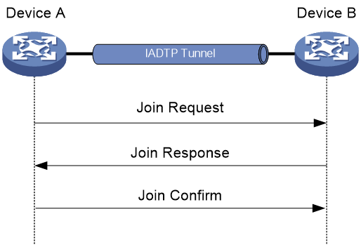

Inter-AC roaming
As shown in Figure 5, 802.1X fast inter-AC roaming operates as follows:
1.     AC 1 and AC 2 are in a mobility group. The client comes online from AC 1 after passing RSN+802.1X authentication. AC 1 creates a roaming entry for the client.
2.     AC 1 sends the roaming entry over the IADTP tunnel to AC 2.
3.     The client roams to AC 2. AC 2 examines the roaming entry for the client and triggers 802.1X fast forwarding if the client carries the same PMKID as the AC.
The system uses the cached PMK to perform key negotiation and the client can associate with AC 2 without reauthentication.
Figure 5 802.1X fast inter-AC roaming
802.1X fast roaming mechanism

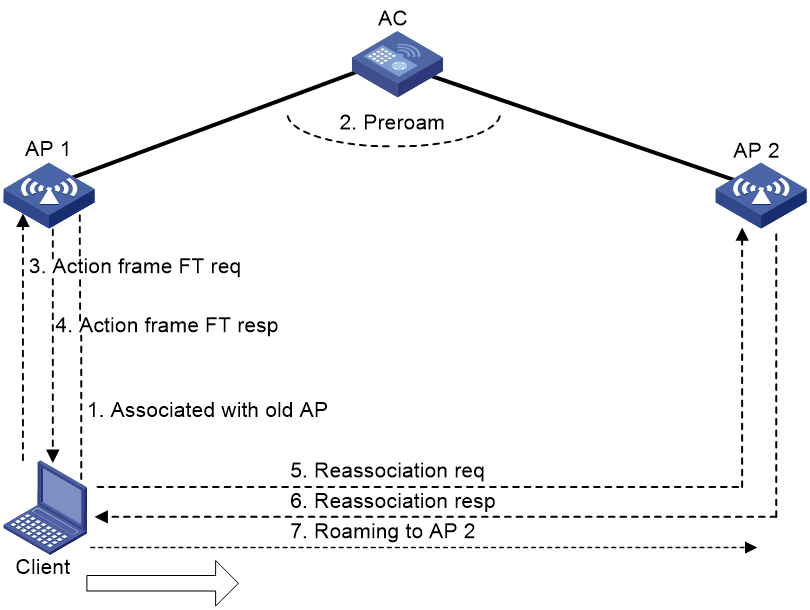

Intra-AP roaming
As shown in Figure 6, 802.1X fast intra-AP roaming operates as follows:
1.     The client comes online from radio 1 after passing RSN+802.1X authentication. The AP creates a roaming entry for the client.
2.     The client roams to radio 2. The AP examines the roaming entry for the client and triggers 802.1X fast forwarding if the client carries the same PMKID as the AP.
The system uses the cached PMK to perform key negotiation and the client can associate with radio 2 without reauthentication.
The system supports using the following methods to cache PMKID:
·     Sticky Key Caching (SKC)—Directly caches the PMKIDs generated during 802.1X authentication of clients.
·     Opportunistic Key Caching (OKC)—Uses the currently associated BSSID, client MAC address, and cached PMK to generate a PMKID.
Both methods support 802.1X fast roaming without manual intervention.
Figure 6 802.1X fast roaming

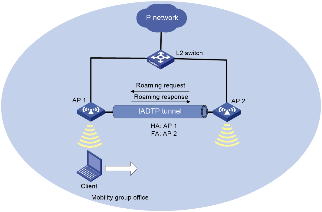

Inter-AP roaming
As shown in Figure 7, 802.1X fast inter-AP roaming operates as follows:
1.     AP 1 and AP 2 are in a mobility group. The client comes online from AP 1 after passing RSN+802.1X authentication. The AP creates a roaming entry for the client.
2.     AP 1 sends the roaming entry over the IADTP tunnel to AP 2.
3.     The client roams to AP 2. AP 2 examines the roaming entry for the client and triggers 802.1X fast forwarding if the client carries the same PMKID as the AP.
Figure 7 802.1X fast inter-AP roaming

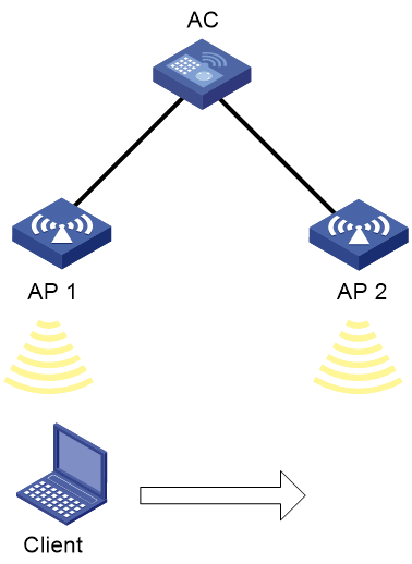

MAC fast roaming
Intra-AC roaming
Intra-AC roaming enables clients to roam among APs that are managed by the same AC.
Figure 8 Intra-AC roaming
As shown in Figure 8, intra-AC roaming uses the following procedure:
1.     The client comes online from AP 1, and the AC creates a roaming entry for the client. For more information about MAC authentication, see "Configuring WLAN authentication."
2.     The client roams to AP 2. The AC examines the roaming entry for the client and determines whether to perform fast roaming.
If the client uses RSN + 802.1X authentication and carries the same PMKID as the AC, fast roaming is used, and the client can associate with AP 2 without reauthentication. If it is not, the client must be reauthenticated before associating with AP 2.

Intra-AC roaming through over-the-air FT
As shown in Figure 9, the client is associated with AP 1. Intra-AC roaming through over-the-air FT uses the following process:
1.     The client sends an FT authentication request to AP 2.
2.     AP 2 sends an FT authentication response to the client.
3.     The client sends a reassociation request to AP 2.
4.     AP 2 sends a reassociation response to the client.
5.     The client roams to AP 2.
Figure 9 Over-the-air FT

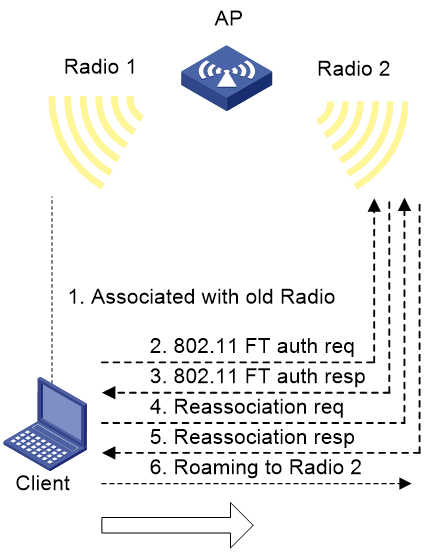

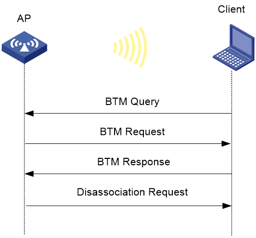

Intra-AP roaming through over-the-air FT
As shown in Figure 11, the client has been associated with radio 1. Intra-AP roaming through over-the-air FT uses the following process:
1.     The client sends an FT authentication request to radio 2.
2.     Radio 2 sends an FT authentication response to the client.
3.     The client sends a reassociation request to radio 2.
4.     Radio 2 sends a reassociation response to the client.
5.     The client roams to radio 2.
Figure 11 Intra-AP roaming through over-the-air FT

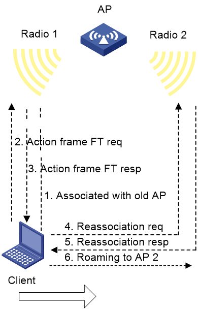

Intra-AP roaming through over-the-DS FT
As shown in Figure 13, intra-AP roaming through over-the-DS FT uses the following process:
1.     The client associates with radio 1.
2.     The client sends an FT authentication request to radio 1.
3.     Radio 1 sends an FT authentication response to the client.
4.     The client sends a reassociation request to radio 2.
5.     Radio 2 sends a reassociation response to the client.
6.     The client roams to AP 2.
Figure 13 Intra-AP roaming through over-the-DS FT

Example: Configuring over-the-DS FT (PSK authentication)
As shown in Figure 14, configure intra-AP roaming through over-the-DS FT to enable the client to roam between radio 1 and radio 2. Configure PSK as the authentication and key management mode.
Figure 15 Network diagram
# Create service template acstname.

Example: Configuring over-the-DS FT (802.1X authentication)
As shown in Figure 14, configure intra-AP roaming through over-the-DS FT to enable the client to roam between different radios. Configure 802.1X as the authentication and key management mode.

802.11v
About 802.11v
802.11v defines BSS transition management (BTM), which enables clients to roam to the optimal AP if the signal strength of the current AP is low or if a better AP is discovered.
As shown in Figure 16, BTM operates as follows:
1.     If the RSSI of the currently associated AP is too low or the client discovered a better AP, the client sends a BTM query to the associated AP. Upon receiving the query, the AP responds with a BTM request.
A BTM request contains information about recommended BSSs.
2.     Upon receiving the BTM request, the client determines whether to disconnect from the current AP and roam to a recommended AP.
3.     If the client determines to perform a roaming, it sends a BTM response to the AP. If the client fails to leave the current BSS before the disassociation timer expires, the AP sends a disassociation request to the client and logs off the client.
Figure 16 BSS transition
Restrictions and guidelines: 802.11v configuration
802.11v supports only intra-AC roaming in the current software version.
Enabling BTM

Example: Configuring 802.11v
As shown in Figure 17, configure 802.11v for the AP to guide the client to an optimal AP.
Figure 17 Network diagram
As shown in Figure 18, configure 802.11v for the AP to guide the client to an optimal AP.
Figure 18 Network diagram

Virtual BSS roaming
About virtual BSS roaming
Virtual BSS roaming enables multiple APs to provide the same virtual service for a client without service interruption when the client roams between the APs. When a client comes online from one AP, the other APs monitor the RSSI of the client. The AC switches the wireless service to a new AP if the AC detects that the new AP can provide higher-quality services.
As shown in Figure 19, virtual BSS roaming operates as follows:
1.     The AC generates a virtual service for the client when AP 1 or AP 2 receives a probe request from the client.
The BSSID of the virtual service contains the bridge MAC address of the AC, the AP's ID, and the client MAC address. The AP uses this virtual BSSID to communicate with the client.
2.     The AC notifies AP 2 of the virtual BSSID of AP 1 if the client comes online from AP 1. AP 2 replaces its local virtual BSSID with AP 1's virtual BSSID and monitors the RSSI of the client.
3.     The AC notifies AP 2 to provide wireless services to the client when the following conditions are met:
¡     The RSSI of the client frames received by AP 2 reaches or exceeds the specified RSSI threshold.
¡     The gap between the RSSIs of the client frames that AP 2 and AP 1 have received reaches or exceeds the RSSI gap threshold.
Figure 19 Virtual BSS roaming diagram

Example: Configuring cooperative roaming
As shown in Figure 17, most clients in the network support 802.11k and 802.11v. Configure cooperative roaming for clients to roam in the ESS seamlessly.
Figure 20 Network diagram
If most clients in the network do not support 802.11k or 802.11v, you can configure BTM, BTM disassociation, anti-sticky, and advanced data transmission holding for clients to perform virtual BSS roaming.
# Configure interface IP addresses and route settings. Make sure the devices can reach each other. (Details not shown.)

Mobility group mechanism
A mobility group enables clients to roam among APs that are managed by different ACs. These ACs must be in the same mobility group and have established an IADTP tunnel with each other.
Figure 21 Mobility group mechanism
As shown in Figure 21, inter-AC roaming uses the following procedure:
1.     The client comes online from AP 2. AC 1 creates a roaming entry for the client and sends the information to AC 2 through the IADTP tunnel.
2.     The client roams to AP 3. AC 2 examines the roaming entry for the client and determines whether to perform fast roaming.
If the client uses RSN + 802.1X authentication and carries the same PMKID as the AC, fast roaming is used, and the client can associate with AP 3 without reauthentication If it is not, the client must be reauthenticated before associating with AP 3.
3.     The client associates with AP 3. AC 2 sends a roaming request to AC 1.
4.     AC 1 verifies the roaming request and performs either of the following operations:
¡     Sends a roaming response that indicates roaming failure to AC 2 if the request is invalid. AC 2 logs off the client.
¡     Saves the roaming trace and roam-out information and sends a roaming response that indicates roaming success to AC 2 if the request is valid. AC 2 saves roaming-in information for the client.
A mobility group enables clients to roam among different APs. These APs must be in the same mobility group and have established an IADTP tunnel with each other.
Figure 22 Mobility group mechanism
As shown in Figure 22, inter-AP roaming uses the following procedure:
1.     The client comes online from AP 1. AP 1 creates a roaming entry for the client and sends the information to AP 2 through the IADTP tunnel.
2.     The client roams to AP 2. AP 2 examines the roaming entry for the client and determines whether to perform fast roaming.
If the client uses RSN + 802.1X authentication and carries the same PMKID as the AP, fast roaming is used, and the client can associate with AP 2 without reauthentication If it is not, the client must be reauthenticated before associating with AP 2.
3.     The client associates with AP 2. AP 2 sends a roaming request to AP 1.
4.     AP 1 verifies the roaming request and performs either of the following operations:
¡     Sends a roaming response that indicates roaming failure to AP 2 if the request is invalid. AP 2 logs off the client.
¡     Saves the roaming trace and roam-out information and sends a roaming response that indicates roaming success to AP 2 if the request is valid. AP 2 saves roaming-in information for the client.
IADTP tunnel establishment
A device in a mobility group can act as a client to initiate connection requests or act as a server to listen for and respond to the connection requests.
Figure 23 Establishing an IADTP tunnel
As shown in Figure 23, two devices establish an IADTP tunnel by using the following procedure:
1.     Device A sends a join request to Device B.
2.     Upon receiving the join request, Device B uses the local configuration and packet content to identify whether Device A is in the same mobility group.
¡     If they are in the same mobility group, Device B returns a join response with a result code representing success.
¡     If they are in different mobility groups, Device B returns a join response with a result code representing failure.
3.     Upon receiving the join response, Device A examines the result code in the response.
¡     If the result code represents failure, Device A does not return any packets.
¡     If the result code represents success, Device A sends a join confirm to Device B.
4.     Upon receiving the join confirm, Device B establishes an IADTP tunnel with Device A.

Example: Configuring inter-AC roaming
As shown in Figure 24, configure inter-AC roaming to enable the client to roam from AP 2 to AP 3 that are managed by different ACs.
Figure 24 Network diagram
1.     Configure AC 1:
# Create a service template named service, set the SSID to office, and enable the service template.
<AC1> system-view
[AC1] wlan service-template service
[AC1-wlan-st-test] ssid office
[AC1-wlan-st-test] service-template enable
[AC1-wlan-st-test] quit
# Create a manual AP named ap1, and specify the AP model and serial ID.
[AC1] wlan ap ap1 model WA6320
[AC1-wlan-ap-ap1] serial-id 219801A28N819CE0002T
# Bind the service template to radio 1 of AP 1.
[AC1-wlan-ap-ap1] radio 1
[AC1-wlan-ap-ap1-radio-1] radio enable
[AC1-wlan-ap-ap1-radio-1] service-template service
[AC1-wlan-ap-ap1-radio-1] quit
[AC1-wlan-ap-ap1] quit
# Create a manual AP named ap2, and specify the AP model and serial ID.
[AC1] wlan ap ap2 model WA6320
[AC1-wlan-ap-ap2] serial-id 219801A28N819CE0003T
# Bind the service template to radio 1 of AP 2.
[AC1-wlan-ap-ap2] radio 1
[AC1-wlan-ap-ap2-radio-1] radio enable
[AC1-wlan-ap-ap2-radio-1] service-template service
[AC1-wlan-ap-ap2-radio-1] quit
[AC1-wlan-ap-ap2] quit
# Create a mobility group named office.
[AC1] wlan mobility group office
# Specify the IP address type for IADTP tunnels as IPv4.
[AC1-wlan-mg-office] tunnel-type ipv4
# Specify the source IP address for establishing IADTP tunnels as 10.1.4.22.
[AC1-wlan-mg-office] source ip 10.1.4.22
# Add AC 2 to the mobility group.
[AC1-wlan-mg-office] member ip 10.1.4.23
# Enable the mobility group.
[AC1-wlan-mg-office] group enable
[AC1-wlan-mg-office] quit

Example: Configuring inter-AP roaming
As shown in Figure 25, configure inter-AP roaming to enable the client to roam from AP 1 to AP 2.
Figure 25 Network diagram
1.     Configure AP 1:
# Create a service template named service1, set the SSID to trade-off, and enable the service template.
<AP1> system-view
[AP1] wlan service-template service1
[AP1-wlan-st-service1] ssid trade-off
[AP1-wlan-st-service1] service-template enable
[AP1-wlan-st-service1] quit
# Bind the service template to interface WLAN-Radio 1/0/1.
[AP1] interface wlan-radio 1/0/1
[AP1-WLAN-Radio1/0/1] undo shutdown
[AP1-WLAN-Radio1/0/1] service-template service1
[AP1-WLAN-Radio1/0/1] quit
# Bind the service template to interface WLAN-Radio 1/0/2.
[AP1] interface wlan-radio 1/0/2
[AP1-WLAN-Radio1/0/2] undo shutdown
[AP1-WLAN-Radio1/0/2] service-template service1
[AP1-WLAN-Radio1/0/2] quit
[AP1] wlan mobility group office
[AP1-wlan-mg-office] tunnel-type ipv4
[AP1-wlan-mg-office] source ip 10.1.4.22
# Add AP 2 to the mobility group.
[AP1-wlan-mg-office] member ip 10.1.4.23
[AP1-wlan-mg-office] group enable
[AP1-wlan-mg-office] quit
2.     Configure AP 2:
# Create a service template named service1, specify the SSID as trade-off, and enable the service template.
<AP2> system-view
[AP2] wlan service-template service1
[AP2-wlan-st-service1] ssid trade-off
[AP2-wlan-st-service1] service-template enable
[AP2-wlan-st-service1] quit
[AP2] interface wlan-radio 1/0/1
[AP2-WLAN-Radio1/0/2] undo shutdown
[AP2-WLAN-Radio1/0/2] service-template service1
[AP2-WLAN-Radio1/0/2] quit
[AP2] interface wlan-radio 1/0/2
[AP2] wlan mobility group office
[AP2-wlan-mg-office] tunnel-type ipv4
# Specify the source IP address for establishing IADTP tunnels as 10.1.4.23.
[AP2-wlan-mg-office] source ip 10.1.4.23
# Add AP 1 to the mobility group.
[AP2-wlan-mg-office] member ip 10.1.4.22
[AP2-wlan-mg-office] group enable
[AP2-wlan-mg-office] quit
# Verify that a mobility group has been created on AP 1.
[AP1] display wlan mobility group
Mobility group name: office
 Tunnel type: IPv4
 Source IPv4: 10.1.4.22
 Source IPv6: Not configured
 Authentication method: Not configured
 Mobility group status: Enabled
 Member entries: 1
 IP address                              State          Online time
 10.1.4.23                               Up             00hr 00min 12sec
# Verify that a mobility group has been created on AP 2.
[AP2] display wlan mobility group
 Tunnel type: IPv4
 Source IPv4: 10.1.4.23
 Member entries: 1

# Get the client online on AP 1 and then make the client roam to AP 2. (Details not shown.)
# Display client roaming information on AP 1 to verify that the client has come online from AP 1 and roamed to AP 2.
[AP1] display wlan mobility roam-track mac-address bce2-659a-3232
Total entries  : 2
Current entries: 2
BSSID           Created at           Online time       AP IP address  RID  AP name
74ea-c8fd-c200  2016-06-14 11:12:28  00hr 06min 56sec  10.1.4.23      2    ap2
74ea-c8fd-c1e0  2016-06-14 11:11:28  00hr 03min 30sec  127.0.0.1      1    ap1
# On AP 1, verify that the client has roamed to AP 2.
[AP1] display wlan mobility roam-out
Total entries: 1
MAC address     BSSID           VLAN ID  Online time       FA IP address
bce2-659a-3232  74ea-c8fd-c200  1        00hr 01min 59sec  10.1.4.23
# On AP 2, verify that the client has associated with AP 2, and the roaming status is Inter-AP roam.
[AP2] display wlan client verbose
Total number of clients: 1
 MAC address                       : bce2-659a-3232
 IPv4 address                      : 192.168.0.5
 IPv6 address                      : N/A
 Username                          : N/A
 AID                               : 978
 Radio ID                          : 2
Channel                            : 36
 SSID                              : trade-off
 BSSID                             : 74ea-c8fd-c200
 VLAN ID                           : 1
 Sleep count                       : 49
 Wireless mode                     : 802.11gn
 Channel bandwidth                 : 20MHz
 20/40 BSS Coexistence Management  : Not supported
 SM power save                     : Disabled
 Short GI for 20MHz                : Supported
 Short GI for 40MHz                : Supported
 STBC RX capability                : Supported
 STBC TX capability                : Not supported
 LDPC RX capability                : Not supported
 Block Ack                         : TID 0  In
 Supported HT MCS set              : 0, 1, 2, 3, 4, 5, 6, 7
 Supported rates                   : 1, 2, 5.5, 6, 9, 11,
                                     12, 18, 24, 36, 48, 54 Mbps
 QoS mode                          : WMM
 Listen interval                   : 3
 RSSI                              : 40
 Rx/Tx rate                        : 6.5/6.5 Mbps
 Authentication method             : Open system
 Security mode                     : PRE-RSNA
 AKM mode                          : Not configured
 Cipher suite                      : N/A
 User authentication mode          : Bypass
 Authorization ACL ID              : N/A
 Authorization user profile        : N/A
 Authorization CAR                 : N/A
 Roam status                       : Inter-AP roam
 Key derivation                    : N/A
 PMF status                        : N/A
 Forwarding policy name            : Not configured
 Online time                       : 0days 0hours 0minutes 54seconds
 FT status                         : Inactive
# Verify that the client has roamed from AP 1 to AP 2.
[AP2] display wlan mobility roam-in
Total entries: 1
MAC address     BSSID           VLAN ID  HA IP address
bce2-659a-3232  74ea-c8fd-c200  1        10.1.4.22
