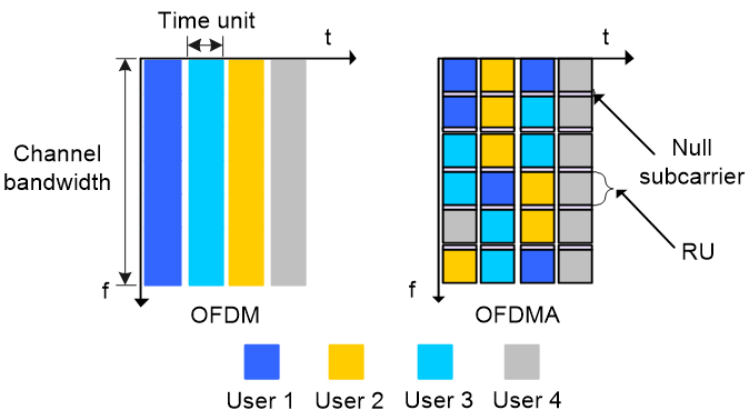

OFDMA
802.11a, 802.11g, 802.11n, and 802.11ac use Orthogonal Frequency Division Multiplexing (OFDM) in data transmission to enable a single user to transmit data on all subcarriers at a given period of time. Based on OFDM, Orthogonal Frequency Division Multiple Access (OFDMA) splits a channel into sub-channels, known as resource units (RUs), with specific subcarriers (tones), and assigns different RUs to different users for simultaneous transmission. This increases the data rate and reduces transmission latency.
802.11ax uses OFDMA and reserves some null subcarriers to reduce inter-subcarrier interference on RUs.
Figure 1 OFDM and OFDMA working modes

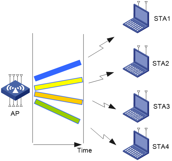

Multi-user multiple-input multiple-output (MU-MIMO) splits bandwidth into individual streams to enable simultaneous receiving and transmission of data for multiple users. 802.11ac supports only downlink MU-MIMO with a maximum of 4 streams, and 802.11ax supports both uplink and downlink MU-MIMO with a maximum of 8 streams. This greatly improves data transmission efficiency.
·     In downlink MU-MIMO, APs use beamforming to direct packets to wireless clients at different locations for the clients to receive data from an AP at the same time.
Figure 2 Downlink MU-MIMO

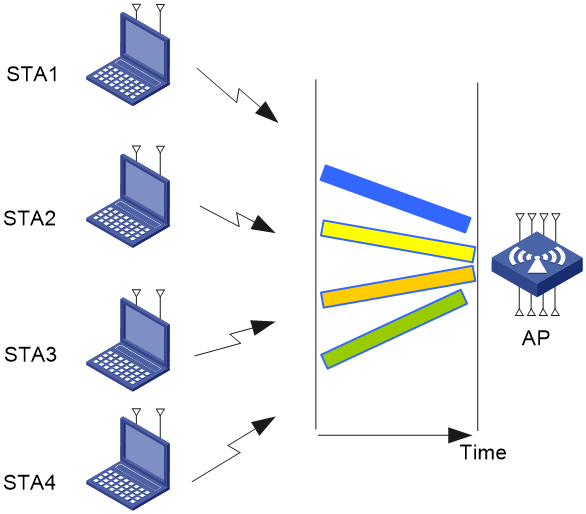

·     In uplink MU-MIMO, the system uses the orthogonality of different client locations to achieve spatial separation and beamforming exchanges are avoided.
Figure 3 Uplink MU-MIMO

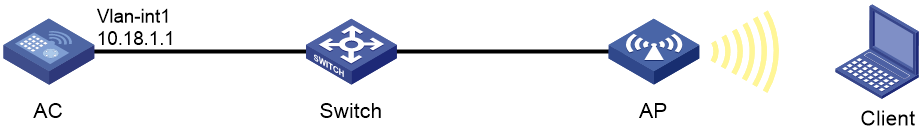

Radio management configuration examples
The parameters configured in this example are for reference only. To achieve the best performance, configure the parameters based on your actual network requirements.
Example: Configuring basic radio functions
As shown in Figure 6, create a manual AP and set the radio mode, working channel, and maximum transmit power to 802.11gn, channel 11, and 19 dBm, respectively.
Figure 6 Network diagram
