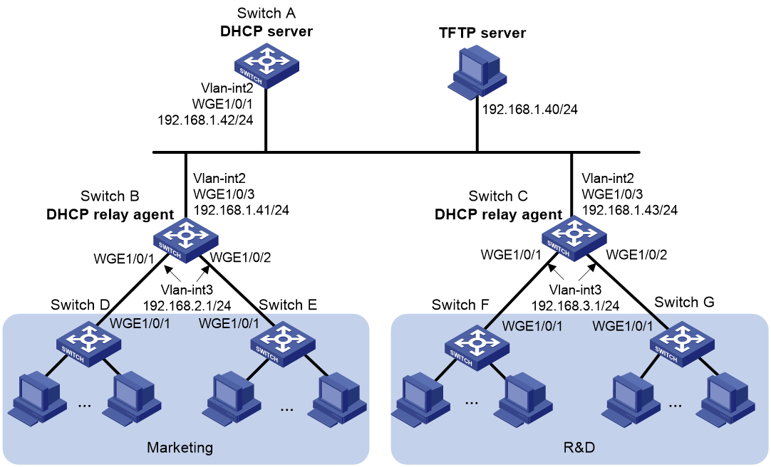

Typical server-based automatic configuration network
As shown in Figure 1, a typical server-based automatic configuration network consists of the following servers:
·     DHCP server—Allocates an IP address to the device that performs server-based automatic configuration and notifies the device of the method to obtain the configuration file or script file for automatic configuration.
·     File server—TFTP, HTTP, SFTP, or FTP server. The file server stores the configuration file or script file for automatic configuration.
·     (Optional.) DNS server—Obtains the configuration file name or the IP address of the file server for the device.
Figure 1 Server-based automatic configuration network diagram

Example: Using a TFTP server for automatic configuration
As shown in Figure 2, two departments of a company are connected to the network through gateways (Switch B and Switch C). Access devices Switch D, Switch E, Switch F, and Switch G do not have a configuration file.
Configure the servers and gateways so the access devices can obtain a configuration file to complete the following configuration tasks:
·     Enable administrators of access devices to Telnet to and manage their respective access devices.
·     Require administrators to enter their respective usernames and passwords at login.
Figure 2 Network diagram
1.     Configure the DHCP server:
# Create a VLAN interface and assign an IP address to the interface.
<SwitchA> system-view
[SwitchA] vlan 2
[SwitchA-vlan2] port twenty-fivegige 1/0/1
[SwitchA-vlan2] quit
[SwitchA-Vlan-interface2] ip address 192.168.1.42 24
# Enable DHCP.
[SwitchA] dhcp enable
# Enable the DHCP server on VLAN-interface 2.
[SwitchA-Vlan-interface2] dhcp select server
# Configure address pool market to assign IP addresses on the 192.168.2.0/24 subnet to clients in the Marketing department. Specify the TFTP server, gateway, and configuration file name for the clients.
[SwitchA] dhcp server ip-pool market
[SwitchA-dhcp-pool-market] network 192.168.2.0 24
[SwitchA-dhcp-pool-market] tftp-server ip-address 192.168.1.40
[SwitchA-dhcp-pool-market] gateway-list 192.168.2.1
[SwitchA-dhcp-pool-market] bootfile-name market.cfg
[SwitchA-dhcp-pool-market] quit
# Configure address pool rd to assign IP addresses on the 192.168.3.0/24 subnet to clients in the R&D department. Specify the TFTP server, gateway, and configuration file name for the clients.
[SwitchA] dhcp server ip-pool rd
[SwitchA-dhcp-pool-rd] network 192.168.3.0 24
[SwitchA-dhcp-pool-rd] tftp-server ip-address 192.168.1.40
[SwitchA-dhcp-pool-rd] gateway-list 192.168.3.1
[SwitchA-dhcp-pool-rd] bootfile-name rd.cfg
[SwitchA-dhcp-pool-rd] quit
# Configure static routes to the DHCP relay agents.
[SwitchA] ip route-static 192.168.2.0 24 192.168.1.41
[SwitchA] ip route-static 192.168.3.0 24 192.168.1.43
[SwitchA] quit
2.     Configure the gateway Switch B:
# Create VLAN interfaces and assign IP addresses to the interfaces.
<SwitchB> system-view
[SwitchB] vlan 2
[SwitchB-vlan2] port twenty-fivegige 1/0/3
[SwitchB-vlan2] quit
[SwitchB-Vlan-interface2] ip address 192.168.1.41 24
[SwitchB-Vlan-interface2] quit
[SwitchB] vlan 3
[SwitchB-vlan3] port twenty-fivegige 1/0/1
[SwitchB-vlan3] port twenty-fivegige 1/0/2
[SwitchB-vlan3] quit
[SwitchB] interface vlan-interface 3
[SwitchB-Vlan-interface3] ip address 192.168.2.1 24
[SwitchB-Vlan-interface3] quit
# Enable DHCP.
[SwitchB] dhcp enable
# Enable the DHCP relay agent on VLAN-interface 3.
[SwitchB-Vlan-interface3] dhcp select relay
# Specify the DHCP server address.
[SwitchB-Vlan-interface3] dhcp relay server-address 192.168.1.42
3.     Configure the gateway Switch C:
<SwitchC> system-view
[SwitchC] vlan 2
[SwitchC-vlan2] port twenty-fivegige 1/0/3
[SwitchC-vlan2] quit
[SwitchC] interface vlan-interface 2
[SwitchC-Vlan-interface2] ip address 192.168.1.43 24
[SwitchC-Vlan-interface2] quit
[SwitchC] vlan 3
[SwitchC-vlan3] port twenty-fivegige 1/0/1
[SwitchC-vlan3] port twenty-fivegige 1/0/2
[SwitchC-vlan3] quit
[SwitchC] interface vlan-interface 3
[SwitchC-Vlan-interface3] ip address 192.168.3.1 24
[SwitchC-Vlan-interface3] quit
# Enable DHCP.
[SwitchC] dhcp enable
[SwitchC-Vlan-interface3] dhcp select relay
[SwitchC-Vlan-interface3] dhcp relay server-address 192.168.1.42
4.     Configure the TFTP server:
# On the TFTP server, create a configuration file named market.cfg.
 sysname Market
 telnet server enable
vlan 3
local-user market
 password simple build22345
 service-type telnet
interface Vlan-interface3
 ip address dhcp-alloc
interface twenty-fivegige 1/0/1
 port access vlan 3
user-interface vty 0 63
 authentication-mode scheme
 user-role network-admin
return
# On the TFTP server, create a configuration file named rd.cfg.
 sysname RD
vlan 3
local-user rd
 password simple create22345
 service-type telnet
 port access vlan 3
return
# Start TFTP service software, and specify the folder where the two configuration files reside as the working directory. (Details not shown.)
# Verify that the TFTP server and DHCP relay agents can reach each other. (Details not shown.)

Example: Setting up an IRF fabric
As shown in Figure 7, Switch A and Switch B do not have a configuration file.
Configure the servers so the switches can obtain a Python script to complete their respective configurations and form an IRF fabric.
Figure 7 Network diagram
1.     Assign IP addresses to the interfaces. Make sure the devices can reach each other. (Details not shown.)
2.     Configure the following files on the HTTP server:
File
Content
Remarks
.cfg configuration file
Commands required for IRF setup.
You can create a configuration file by copying and modifying the configuration file of an existing IRF fabric.
sn.txt
Serial numbers of the member switches.
Each SN uniquely identifies a switch.
These SNs will be used for assigning a unique IRF member ID to each member switch.
(Optional.) .ipe or .bin software image file
Software images.
If the member switches are running different software versions, you must prepare the software image file used for software upgrade.
.py Python script file
Python commands that complete the following tasks:
a     (Optional.) Verify that the flash memory has sufficient space for the files to be downloaded.
b     Download the configuration file and sn.txt.
c     (Optional.) Download the software image file and specify it as the main startup image file.
d     Resolve sn.txt and assign a unique IRF member ID to each SN.
e     Specify the configuration file as the main next-startup configuration file.
f     Reboot the member switches.
For more information about Python script configuration, see "Using Python."
