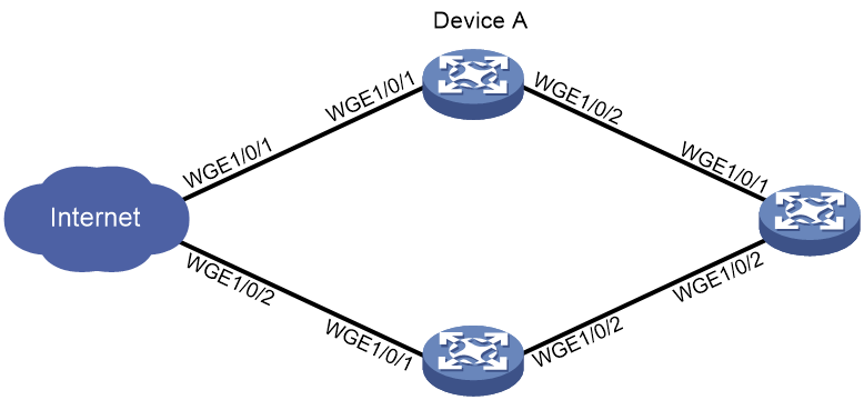

·     Isolate switching:
a.     When you place the device in maintenance mode, GIR executes the isolate enable command for OSPF to increase the link cost in the LSAs advertised by the device.
b.     Each OSPF neighbor of the device reselects an optimal route based on the LSAs and stops forwarding traffic to the device. After the device is fully isolated from the network, you can upgrade the device.
c.     When you revert the device back to normal mode, GIR executes the undo isolate enable command for OSPF to restore its original link cost and gracefully add the device back to the network.
·     Shutdown method:
d.     After a process is shut down by using the shutdown process command, it sends 1-way hello packets to its neighbors
e.     On receipt of the packets, the neighbors disconnect from the OSPF process and use the backup path to forward traffic.
f.     The process stops receiving and sending OSPF packets.
g.     The process clears its neighbor, LSDB, and OSPF route information.
Compared with the shutdown method, the isolate method uses more resources, but it can faster restore a protocol to the state before the isolation. For more information about the isolate enable and shutdown process commands for OSPF, see OSPF commands in Layer 3—IP Routing Command Reference.

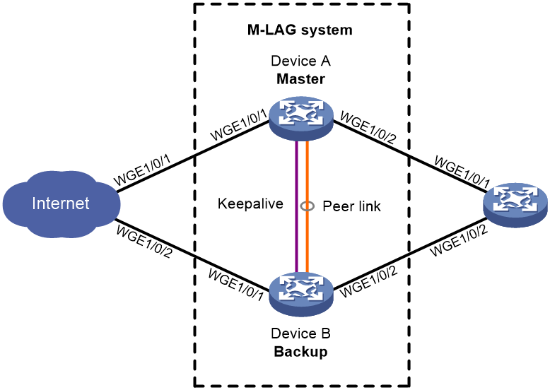

GIR mode switching
GIR supports the following methods for you to change the device from normal mode to maintenance mode:
·     Isolate switching—By default, GIR performs isolate switching to change the device from normal mode to maintenance mode if you do not specify shutdown or profile-based switching. With isolate switching, GIR uses the isolation commands for each GIR-capable protocol to isolate the device.
·     Shutdown switching—GIR uses the shutdown method for each GIR-aware protocol to isolate the device when it changes the device from normal mode to maintenance mode. With this method, GIR also shuts down all interfaces except the management port.
·     Profile-based switching—GIR executes the custom profile when it changes the system from normal mode to maintenance mode.
A custom profile contains a series of user-specified commands to be executed in sequence upon a mode switching. With GIR, you can configure one switch-to-maintenance profile and one switch-to-normal profile for changing to maintenance mode and normal mode, respectively.
When GIR performs an isolate or shutdown switching, it automatically writes the executed series of commands to the switch-to-maintenance custom profile if the profile is empty.
GIR supports the following methods for you to change the device from maintenance mode back to normal mode:
·     Profile-based switching—Configure GIR to execute a custom profile for mode switching.
·     Reverse switching—Configure GIR to perform operations in reverse to the operations performed when it changed from normal mode to maintenance mode.
When GIR performs a reverse switching, it automatically writes the executed series of commands to the switch-to-normal custom profile if the profile is empty.

Example: Configuring GIR in an ECMP-based node redundancy environment
As shown in Figure 1, Device A and Device B have ECMP routes for traffic between Internet and Device C. Before upgrading Device A, use GIR to place it in maintenance mode to prevent packet losses during upgrade. Then, change Device A back to normal mode after its software is upgraded.
Figure 1 Network diagram
1.     Configure IP addresses and a unicast routing protocol (for example, OSPF). Make sure ECMP routes are available for traffic between the Internet and Device C to traverse Device A or Device B to reach the destination. (Details not shown.)
2.     Isolate Device A from the network before you upgrade it.

Example: Configuring GIR on an M-LAG system
As shown in Figure 2, Device A and Device B form an M-LAG system.
Use the following method to upgrade the M-LAG system to prevent packet loss during the upgrade:
1.     Upgrade Device B.
2.     Perform a forward switching operation by using the isolate method on Device A.
3.     Upgrade Device A.
Figure 2 Network diagram
1.     Upgrade Device B. (Details not shown.)
2.     Isolate Device A from the network before upgrade it.
