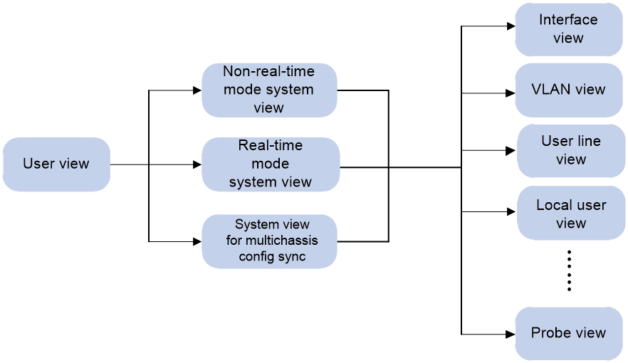

Commands are grouped in different views by feature. To use a command, you must enter its view.
CLI views are hierarchically organized, as shown in Figure 1. Each view has a unique prompt, from which you can identify where you are and what you can do. For example, the prompt [Sysname-vlan100] shows that you are in VLAN 100 view and can configure attributes for that VLAN.
Figure 1 CLI views
You are placed in user view immediately after you log in to the CLI.
In user view, you can perform the following tasks:
·     Perform basic operations including display, debug, file management, FTP, Telnet, clock setting, and reboot.
·     Enter system view. You can enter non-real-time-mode system view, real-time-mode system view, and system view for multichassis configuration sync.
In system view, you can perform the following tasks:
·     Configure settings that affect the device as a whole, such as the daylight saving time, banners, and hotkeys.
·     Enter feature views.
For example, you can perform the following tasks:
¡     Enter interface view to configure interface parameters.
¡     Enter VLAN view to add ports to the VLAN.
¡     Enter user line view to configure login user attributes.
A feature view might have child views. For example, NQA operation view has the child view HTTP operation view.
·     Enter probe view by using the probe command.
The probe view provides display, debugging, and maintenance commands, which are mainly used by developers and testers for system fault diagnosis and system operation monitoring.
