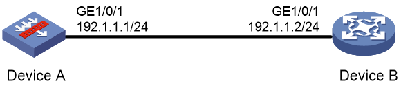

As shown in Figure 1, establish an OSPF neighbor relationship between Device A and Device B, and use a keychain to authenticate packets between the devices. Configure key 1 and key 2 for the keychain and make sure key 2 is used immediately when key 1 expires.
Figure 1 Network diagram
1.     Assign IP addresses to interfaces and configure routes, security zones, zone pairs, and interzone policies. Make sure the network connections are available. (Details not shown.)
2.     Configure Device A:
# Configure OSPF.
<DeviceA> system-view
[DeviceA] ospf 1 router-id 1.1.1.1
[DeviceA-ospf-1] area 0
[DeviceA-ospf-1-area-0.0.0.0] network 192.1.1.0 0.0.0.255
[DeviceA-ospf-1-area-0.0.0.0] quit
[DeviceA-ospf-1] quit
# Create a keychain named abc, and specify the absolute time mode for it.
[DeviceA] keychain abc mode absolute
# Create key 1 for keychain abc, specify an authentication algorithm, and configure a key string and the sending and receiving lifetimes for the key.
[DeviceA-keychain-abc] key 1
[DeviceA-keychain-abc-key-1] authentication-algorithm md5
[DeviceA-keychain-abc-key-1] key-string plain 123456
[DeviceA-keychain-abc-key-1] send-lifetime utc 10:00:00 2015/02/06 to 11:00:00 2015/02/06
[DeviceA-keychain-abc-key-1] accept-lifetime utc 10:00:00 2015/02/06 to 11:00:00 2015/02/06
[DeviceA-keychain-abc-key-1] quit
# Create key 2 for keychain abc, specify an authentication algorithm, and configure a key string and the sending and receiving lifetimes for the key.
[DeviceA-keychain-abc] key 2
[DeviceA-keychain-abc-key-2] authentication-algorithm hmac-md5
[DeviceA-keychain-abc-key-2] key-string plain pwd123
[DeviceA-keychain-abc-key-2] send-lifetime utc 11:00:00 2015/02/06 to 12:00:00 2015/02/06
[DeviceA-keychain-abc-key-2] accept-lifetime utc 11:00:00 2015/02/06 to 12:00:00 2015/02/06
[DeviceA-keychain-abc-key-2] quit
[DeviceA-keychain-abc] quit
# Configure GigabitEthernet 1/0/1 to use keychain abc for authentication.
[DeviceA-GigabitEthernet1/0/1] ospf authentication-mode keychain abc
[DeviceA-GigabitEthernet1/0/1] quit
3.     Configure Device B:
# Configure OSPF.
<DeviceB> system-view
[DeviceB] ospf 1 router-id 2.2.2.2
[DeviceB-ospf-1] area 0
[DeviceB-ospf-1-area-0.0.0.0] network 192.1.1.0 0.0.0.255
[DeviceB-ospf-1-area-0.0.0.0] quit
[DeviceB-ospf-1] quit
[DeviceB] keychain abc mode absolute
[DeviceB-keychain-abc] key 1
[DeviceB-keychain-abc-key-1] authentication-algorithm md5
[DeviceB-keychain-abc-key-1] key-string plain 123456
[DeviceB-keychain-abc-key-1] send-lifetime utc 10:00:00 2015/02/06 to 11:00:00 2015/02/06
[DeviceB-keychain-abc-key-1] accept-lifetime utc 10:00:00 2015/02/06 to 11:10:00 2015/02/06
[DeviceB-keychain-abc-key-1] quit
[DeviceB-keychain-abc] key 2
[DeviceB-keychain-abc-key-2] key-string plain pwd123
[DeviceB-keychain-abc-key-2] authentication-algorithm hmac-md5
[DeviceB-keychain-abc-key-2] send-lifetime utc 11:00:00 2015/02/06 to 12:00:00 2015/02/06
[DeviceB-keychain-abc-key-2] accept-lifetime utc 11:00:00 2015/02/06 to 12:00:00 2015/02/06
[DeviceB-keychain-abc-key-2] quit
[DeviceB-keychain-abc] quit
[DeviceB-GigabitEthernet1/0/1] ospf authentication-mode keychain abc
[DeviceB-GigabitEthernet1/0/1] quit
