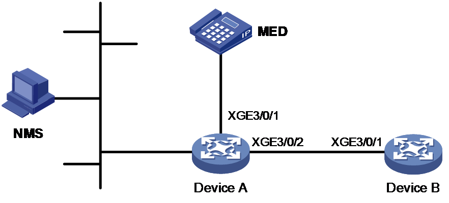

LLDP configuration examples
Example: Configuring basic LLDP functions
As shown in Figure 5, enable LLDP globally on Switch A and Switch B to perform the following tasks:
·     Monitor the link between Switch A and Switch B on the NMS.
·     Monitor the link between Switch A and the MED device on the NMS.
Figure 5 Network diagram
1.     Configure Switch A:

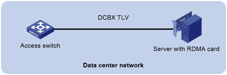

About DCBX
Data Center Ethernet (DCE), also known as Converged Enhanced Ethernet (CEE), is enhancement and expansion of traditional Ethernet local area networks for use in data centers. DCE uses the Data Center Bridging Exchange Protocol (DCBX) to negotiate and remotely configure the bridge capability of network elements.
DCBX versions
DCBX has the following self-adaptable versions:
·     DCB Capability Exchange Protocol Specification Rev 1.00.
·     DCB Capability Exchange Protocol Base Specification Rev 1.01.
·     IEEE Std 802.1Qaz-2011 (Media Access Control (MAC) Bridges and Virtual Bridged Local Area Networks-Amendment 18: Enhanced Transmission Selection for Bandwidth Sharing Between Traffic Classes).
DCBX functions
DCBX offers the following functions:
·     Discovers the peer devices' capabilities and determines whether devices at both ends support these capabilities.
·     Detects configuration errors on peer devices.
·     Remotely configures the peer device if the peer device accepts the configuration.
H3C devices support only the remote configuration feature.
DCBX application scenario
Figure 6 DCBX application scenario
DCBX enables lossless packet transmission on DCE networks.
As shown in Figure 6, DCBX applies to an RoCE-based data center network, and operates on an access switch. DCBX enables the switch to control the server or storage adapter, and simplifies the configuration and guarantees configuration consistency. DCBX extends LLDP by using the IEEE 802.1 organizationally specific TLVs (DCBX TLVs) to transmit DCBX data, including:
·     In DCBX Rev 1.00 and DCBX Rev 1.01:
¡     Enhanced Transmission Selection (ETS).
¡     Priority-based Flow Control (PFC).
·     In IEEE Std 802.1Qaz-2011:
¡     ETS Configuration.
¡     ETS Recommendation.
¡     PFC.
H3C devices can send these types of DCBX information to a server or storage adapter. However, H3C devices cannot accept these types of DCBX information.
Protocols and standards

Example: Configuring DCBX
As shown in Figure 7, Ten-GigabitEthernet 3/0/1 of the access switch (Switch A) connects to the RDMA adapter of the data center server (DC server).
Configure Switch A to implement lossless RoCE frame transmission to DC server.
In this example, both Switch A and the DC server support DCBX Rev 1.01.
Figure 7 Network diagram
1.     Enable LLDP and DCBX TLV advertising:
# Enable LLDP globally.
<SwitchA> system-view
[SwitchA] lldp global enable
# Enable LLDP and DCBX TLV advertising on Ten-GigabitEthernet 3/0/1.
[SwitchA] interface ten-gigabitethernet 3/0/1
[SwitchA-Ten-GigabitEthernet3/0/1] lldp enable
[SwitchA-Ten-GigabitEthernet3/0/1] lldp tlv-enable dot1-tlv dcbx
2.     Set the DCBX version to Rev. 1.01 on Ten-GigabitEthernet 3/0/1.
[SwitchA-Ten-GigabitEthernet3/0/1] dcbx version rev101
[SwitchA-Ten-GigabitEthernet3/0/1] quit
3.     Enable byte-count WRR queuing on Ten-GigabitEthernet 3/0/1, and configure queue 3 on the interface to use SP queuing.
[SwitchA-Ten-GigabitEthernet3/0/1] qos wrr byte-count
[SwitchA-Ten-GigabitEthernet3/0/1] qos wrr 3 group sp
4.     Configure PFC:
# Enable PFC in auto mode on Ten-GigabitEthernet 3/0/1.
[SwitchA-Ten-GigabitEthernet3/0/1] priority-flow-control auto
# Enable PFC for 802.1 priority 3.
[SwitchA-Ten-GigabitEthernet3/0/1] priority-flow-control no-drop dot1p 3
The DC server does not detect any packet loss during RoCE frame transmission.
