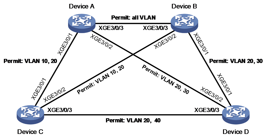

Figure 4 provides an example showing how the STP algorithm works.
Figure 4 The STP algorithm
As shown in Figure 4, the priority values of Device A, Device B, and Device C are 0, 1, and 2, respectively. The path costs of links among the three devices are 5, 10, and 4.
Device state initialization
In Table 3, each configuration BPDU contains the following fields: root bridge ID, root path cost, designated bridge ID, and designated port ID.
Table 3 Initial state of each device
Device
Port name
Configuration BPDU on the port
Device A
Port A1
{0, 0, 0, Port A1}
Port A2
{0, 0, 0, Port A2}
Device B
Port B1
{1, 0, 1, Port B1}
Port B2
{1, 0, 1, Port B2}
Device C
Port C1
{2, 0, 2, Port C1}
Port C2
{2, 0, 2, Port C2}
Configuration BPDUs comparison on each device
In Table 4, each configuration BPDU contains the following fields: root bridge ID, root path cost, designated bridge ID, and designated port ID.
Table 4 Comparison process and result on each device
Device
Comparison process
Configuration BPDU on ports after comparison
Device A
Port A1 performs the following operations:
1.     Receives the configuration BPDU of Port B1 {1, 0, 1, Port B1}.
2.     Determines that its existing configuration BPDU {0, 0, 0, Port A1} is superior to the received configuration BPDU.
3.     Discards the received one.
Port A2 performs the following operations:
1.     Receives the configuration BPDU of Port C1 {2, 0, 2, Port C1}.
2.     Determines that its existing configuration BPDU {0, 0, 0, Port A2} is superior to the received configuration BPDU.
Device A determines that it is both the root bridge and designated bridge in the configuration BPDUs of all its ports. It considers itself as the root bridge. It does not change the configuration BPDU of any port and starts to periodically send configuration BPDUs.
·     Port A1: {0, 0, 0, Port A1}
·     Port A2: {0, 0, 0, Port A2}
Device B
Port B1 performs the following operations:
4.     Receives the configuration BPDU of Port A1 {0, 0, 0, Port A1}.
5.     Determines that the received configuration BPDU is superior to its existing configuration BPDU {1, 0, 1, Port B1}.
6.     Updates its configuration BPDU.
Port B2 performs the following operations:
1.     Receives the configuration BPDU of Port C2 {2, 0, 2, Port C2}.
2.     Determines that its existing configuration BPDU {1, 0, 1, Port B2} is superior to the received configuration BPDU.
3.     Discards the received BPDU.
·     Port B1: {0, 0, 0, Port A1}
·     Port B2: {1, 0, 1, Port B2}
Device B performs the following operations:
1.     Compares the configuration BPDUs of all its ports.
2.     Decides that the configuration BPDU of Port B1 is the optimum.
3.     Selects Port B1 as the root port with the configuration BPDU unchanged.
Based on the configuration BPDU and path cost of the root port, Device B calculates a designated port configuration BPDU for Port B2 {0, 5, 1, Port B2}. Device B compares it with the existing configuration BPDU of Port B2 {1, 0, 1, Port B2}. Device B determines that the calculated one is superior, and determines that Port B2 is the designated port. It replaces the configuration BPDU on Port B2 with the calculated one, and periodically sends the calculated configuration BPDU.
·     Root port (Port B1): {0, 0, 0, Port A1}
·     Designated port (Port B2): {0, 5, 1, Port B2}
Device C
Port C1 performs the following operations:
1.     Receives the configuration BPDU of Port A2 {0, 0, 0, Port A2}.
2.     Determines that the received configuration BPDU is superior to its existing configuration BPDU {2, 0, 2, Port C1}.
3.     Updates its configuration BPDU.
Port C2 performs the following operations:
1.     Receives the original configuration BPDU of Port B2 {1, 0, 1, Port B2}.
2.     Determines that the received configuration BPDU is superior to the existing configuration BPDU {2, 0, 2, Port C2}.
·     Port C1: {0, 0, 0, Port A2}
·     Port C2: {1, 0, 1, Port B2}
Device C performs the following operations:
2.     Decides that the configuration BPDU of Port C1 is the optimum.
3.     Selects Port C1 as the root port with the configuration BPDU unchanged.
Based on the configuration BPDU and path cost of the root port, Device C calculates the configuration BPDU of Port C2 {0, 10, 2, Port C2}. Device C compares it with the existing configuration BPDU of Port C2 {1, 0, 1, Port B2}. Device C determines that the calculated configuration BPDU is superior to the existing one, selects Port C2 as the designated port, and replaces the configuration BPDU of Port C2 with the calculated one.
·     Root port (Port C1): {0, 0, 0, Port A2}
·     Designated port (Port C2): {0, 10, 2, Port C2}
1.     Receives the updated configuration BPDU of Port B2 {0, 5, 1, Port B2}.
2.     Determines that the received configuration BPDU is superior to its existing configuration BPDU {0, 10, 2, Port C2}.
1.     Receives a periodic configuration BPDU {0, 0, 0, Port A2} from Port A2.
2.     Determines that it is the same as the existing configuration BPDU.
·     Port C2: {0, 5, 1, Port B2}
Device C determines that the root path cost of Port C1 is larger than that of Port C2. The root path cost of Port C1 is 10, root path cost of the received configuration BPDU (0) plus path cost of Port C1 (10). The root path cost of Port C2 is 9, root path cost of the received configuration BPDU (5) plus path cost of Port C2 (4). Device C determines that the configuration BPDU of Port C2 is the optimum, and selects Port C2 as the root port with the configuration BPDU unchanged.
Based on the configuration BPDU and path cost of the root port, Device C performs the following operations:
1.     Calculates a designated port configuration BPDU for Port C1 {0, 9, 2, Port C1}.
2.     Compares it with the existing configuration BPDU of Port C1 {0, 0, 0, Port A2}.
3.     Determines that the existing configuration BPDU is superior to the calculated one and blocks Port C1 with the configuration BPDU unchanged.
Port C1 does not forward data until a new event triggers a spanning tree calculation process: for example, the link between Device B and Device C is down.
·     Blocked port (Port C1): {0, 0, 0, Port A2}
·     Root port (Port C2): {0, 5, 1, Port B2}
Final calculated spanning tree
After the comparison processes described in Table 4, a spanning tree with Device A as the root bridge is established, as shown in Figure 5.
Figure 5 The final calculated spanning tree

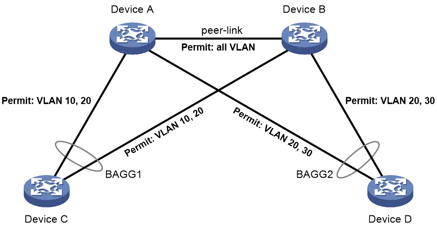

As shown in Figure 6, Device A is the root bridge. The priority of Device B is higher than the priority of Device C. Port C2 on Device C is blocked.
When the link between Device A and Device B fails, the following events occur:
1.     Device B sends an RSTP BPDU with itself as the root bridge to Device C.
2.     Device C compares the RSTP BPDU with its own BPDU.
3.     Because the RSTP BPDU from Device B has a lower priority, Device C sends its own BPDU to Device B.
4.     Device B considers that Port B2 is the root port and stops sending RSTP BPDUs to Device C.
Figure 6 BPDU processing in RSTP

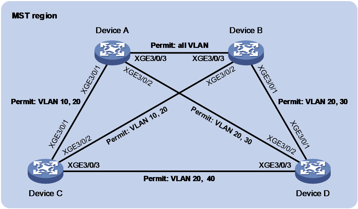

Figure 9 shows a switched network that contains four MST regions, each MST region containing four MSTP devices. Figure 10 shows the networking topology of MST region 3.
Figure 9 Basic concepts in MSTP
Figure 10 Network diagram and topology of MST region 3

Ignoring the specified VLANs
Traffic of a VLAN on a complex network might be blocked by the spanning tree, as shown in Figure 16.
·     Port A1 on Device A allows the traffic of VLAN 1 to pass through.
·     Port A2 on Device A allows the traffic of VLAN 2 to pass through.
·     Port B1 on Device B allows the traffic of VLAN 1 to pass through.
·     Port B2 on Device B allows the traffic of VLAN 2 to pass through.
·     Device A and Device B run a spanning tree protocol. Device A is the root bridge, and Port A1 and Port A2 are designated ports. On Device B, Port B1 is the root port, and Port B2 is the blocked port. Traffic of VLAN 2 is blocked.
Figure 16 VLAN connectivity blocked by MSTP
Ignoring a VLAN can make ports of the VLAN forward frames correctly rather than comply with the spanning tree calculation result.
2.     Ignore the specified VLANs.
stp ignored vlan vlan-id-list
By default, no VLAN is ignored.

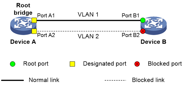

Configuring No Agreement Check
In RSTP and MSTP, the following types of messages are used for rapid state transition on designated ports:
·     Proposal—Sent by designated ports to request rapid transition
·     Agreement—Used to acknowledge rapid transition requests
Both RSTP and MSTP devices can perform rapid transition on a designated port only when the port receives an agreement packet from the downstream device. RSTP and MSTP devices have the following differences:
·     For MSTP, the root port of the downstream device sends an agreement packet only after it receives an agreement packet from the upstream device.
·     For RSTP, the downstream device sends an agreement packet whether or not an agreement packet from the upstream device is received.
Figure 17 Rapid state transition of an MSTP designated port
Figure 18 Rapid state transition of an RSTP designated port
If the upstream device is a third-party device, the rapid state transition implementation might be limited as follows:
·     The upstream device uses a rapid transition mechanism similar to that of RSTP.
·     The downstream device runs MSTP and does not operate in RSTP mode.
In this case, the following occurs:
1.     The root port on the downstream device receives no agreement from the upstream device.
2.     It sends no agreement to the upstream device.
As a result, the designated port of the upstream device can transit to the forwarding state only after a period twice the forward delay.
To enable the designated port of the upstream device to transit its state rapidly, enable No Agreement Check on the downstream device's port.
Configure No Agreement Check on the root port of your device, because this feature takes effect only if it's configured on root ports.
Before you configure the No Agreement Check feature, complete the following tasks:
·     Connect a device to a third-party upstream device that supports spanning tree protocols through a point-to-point link.
·     Configure the same region name, revision level, and VLAN-to-instance mappings on the two devices.

As shown in Figure 19, an IRF fabric connects to two user networks through double links.
·     Device A and Device B form the IRF fabric.
·     The spanning tree feature is disabled on Device A and Device B and enabled on all devices in user network 1 and user network 2.
·     The IRF fabric transparently transmits BPDUs for both user networks and is not involved in the calculation of spanning trees.
When the network topology changes, it takes time for the IRF fabric to update its MAC address table and ARP table. During this period, traffic in the network might be interrupted.
Figure 19 TC Snooping application scenario
image14.emf
To avoid traffic interruption, you can enable TC Snooping on the IRF fabric. After receiving a TC-BPDU through a port, the IRF fabric updates MAC address table and ARP table entries associated with the port's VLAN. In this way, TC Snooping prevents topology change from interrupting traffic forwarding in the network. For more information about the MAC address table and the ARP table, see "Configuring the MAC address table" and Layer 3—IP Services Configuration Guide.

Dispute guard can be triggered by unidirectional link failures. If an upstream port receives inferior BPDUs from a downstream designated port in forwarding or learning state because of a unidirectional link failure, a loop appears. Dispute guard blocks the upstream designated port to prevent the loop.
As shown in Figure 20, in normal conditions, the spanning tree calculation result is as follows:
·     Device A is the root bridge, and Port A1 is a designated port.
·     Port B1 is blocked.
When the link between Port A1 and Port B1 fails in the direction of Port A1 to Port B1 and becomes unidirectional, the following events occur:
1.     Port A1 can only receive BPDUs and cannot send BPDUs to Port B1.
2.     Port B1 does not receive BPDUs from Port A1 for a certain period of time.
3.     Device B determines itself as the root bridge.
4.     Port B1 sends its BPDUs to Port A1.
5.     Port A1 determines the received BPDUs are inferior to its own BPDUs. A dispute is detected.
6.     Dispute guard is triggered and blocks Port A1 to prevent a loop.

However, dispute guard might disrupt the network connectivity. You can disable dispute guard to avoid connectivity loss in VLAN networks. As shown in Figure 22, the spanning tree feature is disabled on Device B and enabled on Device A and device C. Device B transparently transmits BPDUs.
Device C cannot receive superior BPDUs of VLAN 1 from Device A because Port B1 of Device B is configured to deny packets of VLAN 1. Device C determines itself as the root bridge after a certain period of time. Then, Port C1 sends an inferior BPDU of VLAN 100 to Device A.
When Device A receives the inferior BPDU, dispute guard blocks Port A1, which causes traffic interruption. To ensure service continuity, you can disable dispute guard on Device A to prevent the link from being blocked.
Figure 22 Disabling dispute guard application scenario
You can disable dispute guard if the network does not have unidirectional link failures.

Example: Configuring MSTP
As shown in Figure 23, all devices on the network are in the same MST region. Device A and Device B work at the distribution layer. Device C and Device D work at the access layer.
Configure MSTP so that frames of different VLANs are forwarded along different spanning trees.
·     VLAN 10 frames are forwarded along MSTI 1.
·     VLAN 30 frames are forwarded along MSTI 3.
·     VLAN 40 frames are forwarded along MSTI 4.
·     VLAN 20 frames are forwarded along MSTI 0.
VLAN 10 and VLAN 30 are terminated on the distribution layer devices, and VLAN 40 is terminated on the access layer devices. The root bridges of MSTI 1 and MSTI 3 are Device A and Device B, respectively, and the root bridge of MSTI 4 is Device C.
Figure 23 Network diagram

Based on the output, you can draw each MSTI mapped to each VLAN, as shown in Figure 24.
Figure 24 MSTIs mapped to different VLANs
Example: Configuring PVST
As shown in Figure 25, Device A and Device B work at the distribution layer, and Device C and Device D work at the access layer.
Configure PVST to meet the following requirements:
·     Frames of a VLAN are forwarded along the spanning trees of the VLAN.
·     VLAN 10, VLAN 20, and VLAN 30 are terminated on the distribution layer devices, and VLAN 40 is terminated on the access layer devices.
·     The root bridge of VLAN 10 and VLAN 20 is Device A.
·     The root bridge of VLAN 30 is Device B.
·     The root bridge of VLAN 40 is Device C.
Figure 25 Network diagram

Example: Configuring M-LAG with PVST
As shown in Figure 27, Device A and Device B work at the distribution layer, and Device C and Device D work at the access layer.
Configure M-LAG on Device A and Device B. In the M-LAG system, Device A is the primary M-LAG device, and Device B is the secondary M-LAG device.
Configure PVST on the devices to meet the following requirements:
·     VLAN 10, VLAN 20, and VLAN 30 are terminated on the distribution layer devices.
·     The root bridge of VLAN 10, VLAN 20, and VLAN 30 is the M-LAG system formed by Device A and Device B.
·     As a best practice, do not connect ports on Device A and Device B that have the same port ID with each other, for example Layer 2 aggregate ports. Otherwise, when Device A and Device B communicate through the link, the spanning tree protocol determines that the device receives its own BPDUs. Loop guard will block the link, though spanning tree features are not affected.
·     You can view port IDs of interfaces on the device by using the display stp interface command.
·     The preceding restrictions do not apply to peer-link interfaces and their member ports.
Figure 27 Network diagram

3.     Configure Device A:
# Set the spanning tree mode to PVST.
<DeviceA> system-view
[DeviceA] stp mode pvst
# Configure the device as the root bridge of VLAN 10 and VLAN 20.
[DeviceA] stp vlan 10 20 root primary
# Enable the spanning tree feature globally and in VLAN 10, VLAN 20, and VLAN 30.
[DeviceA] stp global enable
[DeviceA] stp vlan 10 20 30 enable
4.     Configure Device B in the same way Device A is configured. (Details not shown.)
5.     Configure Device C:
<DeviceC> system-view
[DeviceC] stp mode pvst
# Enable the spanning tree feature globally and in VLAN 10, and VLAN 20.
[DeviceC] stp global enable
[DeviceC] stp vlan 10 20 enable
6.     Configure Device D:
<DeviceD> system-view
[DeviceD] stp mode pvst
# Enable the spanning tree feature globally and in VLAN 20, and VLAN 30.
[DeviceD] stp global enable
[DeviceD] stp vlan 20 30 enable
When the network is stable, you can use the display stp brief command to display brief spanning tree information on each device.
# Display brief spanning tree information of the M-LAG system on the primary M-LAG device, Device A.
[DeviceA] display stp brief
VLAN ID     Port                         Role  STP State     Protection
 10         Bridge-Aggregation1 (M-LAG)     DESI  FORWARDING    NONE
 20         Bridge-Aggregation1 (M-LAG)     DESI  FORWARDING    NONE
 20         Bridge-Aggregation2 (M-LAG)     DESI  FORWARDING    NONE
 30         Bridge-Aggregation2 (M-LAG)     DESI  FORWARDING    NONE
# Display brief spanning tree information on Device C.
[DeviceC] display stp brief
 10         Bridge-Aggregation1          ROOT  FORWARDING    NONE
 20         Bridge-Aggregation1          ROOT  FORWARDING    NONE
# Display brief spanning tree information on Device D.
[DeviceD] display stp brief
 20         Bridge-Aggregation2          ROOT  FORWARDING    NONE
 30         Bridge-Aggregation2          ROOT  FORWARDING    NONE
