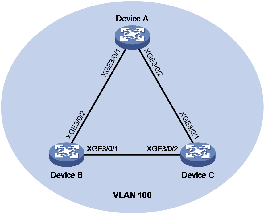

Example: Configuring basic loop detection functions
As shown in Figure 3, configure loop detection on Device A to meet the following requirements:
·     Device A generates a log as a notification.
·     Device A automatically shuts down the interface on which a loop is detected.
Figure 3 Network diagram
1.     Configure Device A:
# Create VLAN 100, and globally enable loop detection for the VLAN.
<DeviceA> system-view
[DeviceA] vlan 100
[DeviceA-vlan100] quit
[DeviceA] loopback-detection global enable vlan 100
# Configure Ten-GigabitEthernet 3/0/1 and Ten-GigabitEthernet 3/0/2 as trunk ports, and assign them to VLAN 100.
[DeviceA] interface Ten-GigabitEthernet 3/0/1
[DeviceA-Ten-GigabitEthernet3/0/1] port link-type trunk
[DeviceA-Ten-GigabitEthernet3/0/1] port trunk permit vlan 100
[DeviceA-Ten-GigabitEthernet3/0/1] quit
[DeviceA] interface ten-gigabitethernet 3/0/2
[DeviceA-Ten-GigabitEthernet3/0/2] port link-type trunk
[DeviceA-Ten-GigabitEthernet3/0/2] port trunk permit vlan 100
[DeviceA-Ten-GigabitEthernet3/0/2] quit
# Set the global loop protection action to shutdown.
[DeviceA] loopback-detection global action shutdown
# Set the loop detection interval to 35 seconds.
[DeviceA] loopback-detection interval-time 35
2.     Configure Device B:
# Create VLAN 100.
<DeviceB> system-view
[DeviceB] vlan 100
[DeviceB–vlan100] quit
[DeviceB] interface ten-gigabitethernet 3/0/1
[DeviceB-Ten-GigabitEthernet3/0/1] port link-type trunk
[DeviceB-Ten-GigabitEthernet3/0/1] port trunk permit vlan 100
[DeviceB-Ten-GigabitEthernet3/0/1] quit
[DeviceB] interface ten-gigabitethernet 3/0/2
[DeviceB-Ten-GigabitEthernet3/0/2] port link-type trunk
[DeviceB-Ten-GigabitEthernet3/0/2] port trunk permit vlan 100
[DeviceB-Ten-GigabitEthernet3/0/2] quit
3.     Configure Device C:
# Create VLAN 100.
<DeviceC> system-view
[DeviceC] vlan 100
[DeviceC–vlan100] quit
[DeviceC] interface ten-gigabitethernet 3/0/1
[DeviceC-Ten-GigabitEthernet3/0/1] port link-type trunk
[DeviceC-Ten-GigabitEthernet3/0/1] port trunk permit vlan 100
[DeviceC-Ten-GigabitEthernet3/0/1] quit
[DeviceC] interface ten-gigabitethernet 3/0/2
[DeviceC-Ten-GigabitEthernet3/0/2] port link-type trunk
[DeviceC-Ten-GigabitEthernet3/0/2] port trunk permit vlan 100
[DeviceC-Ten-GigabitEthernet3/0/2] quit
# View the system logs on devices, for example, Device A.
[DeviceA]
%Feb 24 15:04:29:663 2019 DeviceA LPDT/4/LPDT_LOOPED:  A loop was detected on Ten-GigabitEthernet3/0/1.
%Feb 24 15:04:29:664 2019 DeviceA LPDT/4/LPDT_VLAN_LOOPED: A loop was detected on Ten-GigabitEthernet3/0/1 in VLAN 100.
%Feb 24 15:04:29:667 2019 DeviceA LPDT/4/LPDT_LOOPED: A loop was detected on Ten-GigabitEthernet3/0/2.
%Feb 24 15:04:29:668 2019 DeviceA LPDT/4/LPDT_VLAN_LOOPED: A loop was detected on Ten-GigabitEthernet3/0/2 in VLAN 100.
%Feb 24 15:04:44:243 2019 DeviceA LPDT/5/LPDT_VLAN_RECOVERED: A loop was removed on Ten-GigabitEthernet3/0/1 in VLAN 100.
%Feb 24 15:04:44:243 2019 DeviceA LPDT/5/LPDT_RECOVERED: All loops were removed on Ten-GigabitEthernet3/0/1.
%Feb 24 15:04:44:248 2019 DeviceA LPDT/5/LPDT_VLAN_RECOVERED: A loop was removed on Ten-GigabitEthernet3/0/2 in VLAN 100.
%Feb 24 15:04:44:248 2019 DeviceA LPDT/5/LPDT_RECOVERED: All loops were removed on Ten-GigabitEthernet3/0/2.
The output shows the following information:
·     Device A detected loops on Ten-GigabitEthernet 3/0/1 and Ten-GigabitEthernet 3/0/2 within a loop detection interval.
·     Loops on Ten-GigabitEthernet 3/0/1 and Ten-GigabitEthernet 3/0/2 were removed.
# Use the display loopback-detection command to display the loop detection configuration and status on devices, for example, Device A.
[DeviceA] display loopback-detection
Loop detection is enabled.
Global loop detection interval is 35 second(s).
Loop is detected on following interfaces:
  Interface                      Action mode     VLANs/VSI
 Ten-GigabitEthernet3/0/1       Shutdown        100
 Ten-GigabitEthernet3/0/2       Shutdown        100
The output shows that the device has removed the loops from Ten-GigabitEthernet 3/0/1 and Ten-GigabitEthernet 3/0/2 according to the shutdown action.
# Display the status of Ten-GigabitEthernet 3/0/1 on devices, for example, Device A.
[DeviceA] display interface ten-gigabitethernet 3/0/1
Ten-GigabitEthernet3/0/1 current state: DOWN (Loop detection down)
The output shows that Ten-GigabitEthernet 3/0/1 is already shut down by the loop detection module.
# Display the status of Ten-GigabitEthernet 3/0/2 on devices, for example, Device A.
[DeviceA] display interface ten-gigabitethernet 3/0/2
Ten-GigabitEthernet3/0/2 current state: DOWN (Loop detection down)
The output shows that Ten-GigabitEthernet 3/0/2 is already shut down by the loop detection module.

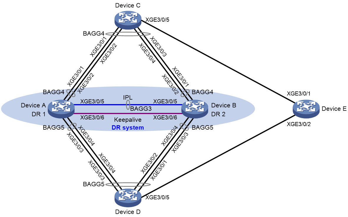

Example: Configuring loop detection on a M-LAG system
As shown in Figure 4, configure loop detection on the M-LAG system formed by Device A and Device B to meet the following requirements:
·     Generates a log as a notification.
·     Automatically shuts down the interface on which a loop is detected.
Figure 4 Network diagram
# Create VLAN 100.
[DeviceA] vlan 100
# Configure M-LAG system settings.
[DeviceA] m-lag system-mac 1-1-1
[DeviceA] m-lag system-number 1
[DeviceA] m-lag system-priority 123
# Configure M-LAG keepalive packet parameters.
[DeviceA] m-lag keepalive ip destination 1.1.1.1 source 1.1.1.2
# Set the link mode of Ten-GigabitEthernet 3/0/6 to Layer 3, and assign the interface an IP address. The IP address will be used as the source IP address of keepalive packets.
[DeviceA] interface ten-gigabitethernet 3/0/6
[DeviceA-Ten-GigabitEthernet3/0/6] port link-mode route
[DeviceA-Ten-GigabitEthernet3/0/6] ip address 1.1.1.2 24
[DeviceA-Ten-GigabitEthernet3/0/6] quit
# Exclude the interface used for M-LAG keepalive detection (Ten-GigabitEthernet 3/0/6) from the shutdown action by M-LAG MAD.
[DeviceA] m-lag mad exclude interface ten-gigabitethernet 3/0/6
# Create Layer 2 dynamic aggregate interface Bridge-Aggregation 3, and specify it as the M-LAG peer-link interface.
[DeviceA] interface bridge-aggregation 3
[DeviceA-Bridge-Aggregation3] link-aggregation mode dynamic
[DeviceA-Bridge-Aggregation3] port m-lag peer-link 1
[DeviceA-Bridge-Aggregation3] quit
# Assign Ten-GigabitEthernet 3/0/5 to aggregation group 3.
[DeviceA] interface ten-gigabitethernet 3/0/5
[DeviceA-Ten-GigabitEthernet3/0/5] port link-aggregation group 3
[DeviceA-Ten-GigabitEthernet3/0/5] quit
# Set the link type of Bridge-Aggregation 3 to trunk, and assign it to VLAN 100.
[DeviceA-Bridge-Aggregation3] port link-type trunk
[DeviceA-Bridge-Aggregation3] port trunk permit vlan 100
# Create Layer 2 dynamic aggregate interface Bridge-Aggregation 4, and assign it to M-LAG group 4.
[DeviceA] interface bridge-aggregation 4
[DeviceA-Bridge-Aggregation4] link-aggregation mode dynamic
[DeviceA-Bridge-Aggregation4] port m-lag group 4
[DeviceA-Bridge-Aggregation4] quit
# Assign Ten-GigabitEthernet 3/0/1 and Ten-GigabitEthernet 3/0/2 to aggregation group 4.
[DeviceA] interface ten-gigabitethernet 3/0/1
[DeviceA-Ten-GigabitEthernet3/0/1] port link-aggregation group 4
[DeviceA-Ten-GigabitEthernet3/0/2] port link-aggregation group 4
# Set the link type of Bridge-Aggregation 4 to trunk, and assign it to VLAN 100.
[DeviceA-Bridge-Aggregation4] port link-type trunk
[DeviceA-Bridge-Aggregation4] port trunk permit vlan 100
# Create Layer 2 dynamic aggregate interface Bridge-Aggregation 5, and assign it to M-LAG group 5.
[DeviceA] interface bridge-aggregation 5
[DeviceA-Bridge-Aggregation5] link-aggregation mode dynamic
[DeviceA-Bridge-Aggregation5] port m-lag group 5
[DeviceA-Bridge-Aggregation5] quit
# Assign Ten-GigabitEthernet 3/0/3 and Ten-GigabitEthernet 3/0/4 to aggregation group 5.
[DeviceA] interface ten-gigabitethernet 3/0/3
[DeviceA-Ten-GigabitEthernet3/0/3] port link-aggregation group 5
[DeviceA-Ten-GigabitEthernet3/0/3] quit
[DeviceA] interface ten-gigabitethernet 3/0/4
[DeviceA-Ten-GigabitEthernet3/0/4] port link-aggregation group 5
[DeviceA-Ten-GigabitEthernet3/0/4] quit
# Set the link type of Bridge-Aggregation 5 to trunk, and assign it to VLAN 100.
[DeviceA-Bridge-Aggregation5] port link-type trunk
[DeviceA-Bridge-Aggregation5] port trunk permit vlan 100
# Disable the spanning tree feature.
[DeviceA] undo stp global enable
# Enable loop detection for VLAN 100 globally, set the global loop protection action to shutdown, and set the loop detection interval to 35 seconds.
2.     Configure Device B in the same way Device A is configured. Set the M-LAG system number to 2, and set the source and destination IP addresses of keepalive packets to 1.1.1.1 and 1.1.1.2, respectively. (Details not shown.)
[DeviceC] undo stp global enable
# Create VLAN 100.
[DeviceC] vlan 100
[DeviceC-vlan100] quit
# Create Layer 2 dynamic aggregate interface Bridge-Aggregation 4.
[DeviceC] interface bridge-aggregation 4
[DeviceC-Bridge-Aggregation4] link-aggregation mode dynamic
[DeviceC-Bridge-Aggregation4] quit
# Assign Ten-GigabitEthernet 3/0/1 through Ten-GigabitEthernet 3/0/4 to aggregation group 4.
[DeviceC] interface range ten-gigabitethernet 3/0/1 to ten-gigabitethernet 3/0/4
[DeviceC-if-range] port link-aggregation group 4
[DeviceC-if-range] quit
[DeviceC-Bridge-Aggregation4] port link-type trunk
[DeviceC-Bridge-Aggregation4] port trunk permit vlan 100
# Set the link type of Ten-GigabitEthernet 3/0/5 to trunk, and assign it to VLAN 100.
[DeviceC] interface ten-gigabitethernet 3/0/5
[DeviceC-Ten-GigabitEthernet3/0/5] port link-type trunk
[DeviceC-Ten-GigabitEthernet3/0/5] port trunk permit vlan 100
[DeviceC-Ten-GigabitEthernet3/0/5] quit
4.     Configure Device D:
<DeviceD> system-view
[DeviceD] undo stp global enable
# Create VLAN 100.
[DeviceD] vlan 100
[DeviceD-vlan100] quit
# Create Layer 2 dynamic aggregate interface Bridge-Aggregation 5.
[DeviceD] interface bridge-aggregation 5
[DeviceD-Bridge-Aggregation5] link-aggregation mode dynamic
[DeviceD-Bridge-Aggregation5] quit
# Assign Ten-GigabitEthernet 3/0/1 through Ten-GigabitEthernet 3/0/4 to aggregation group 5.
[DeviceD] interface range ten-gigabitethernet 3/0/1 to ten-gigabitethernet 3/0/4
[DeviceD-if-range] port link-aggregation group 5
[DeviceD-if-range] quit
[DeviceD-Bridge-Aggregation5] port link-type trunk
[DeviceD-Bridge-Aggregation5] port trunk permit vlan 100
[DeviceD] interface ten-gigabitethernet 3/0/5
[DeviceD-Ten-GigabitEthernet3/0/5] port link-type trunk
[DeviceD-Ten-GigabitEthernet3/0/5] port trunk permit vlan 100
[DeviceD-Ten-GigabitEthernet3/0/5] quit
5.     Configure Device E:
<DeviceE> system-view
[DeviceE] undo stp global enable
# Create VLAN 100.
[DeviceE] vlan 100
[DeviceE-vlan100] quit
# Set the link type of Ten-GigabitEthernet 3/0/1 and Ten-GigabitEthernet 3/0/2 to trunk, and assign them to VLAN 100.
[DeviceE] interface ten-gigabitethernet 3/0/1
[DeviceE-Ten-GigabitEthernet3/0/1] port link-type trunk
[DeviceE-Ten-GigabitEthernet3/0/1] port trunk permit vlan 100
[DeviceE-Ten-GigabitEthernet3/0/1] quit
[DeviceE] interface ten-gigabitethernet 3/0/2
[DeviceE-Ten-GigabitEthernet3/0/2] port link-type trunk
[DeviceE-Ten-GigabitEthernet3/0/2] port trunk permit vlan 100
[DeviceE-Ten-GigabitEthernet3/0/2] quit
# View the system logs on Device A.
[DeviceA]
%Aug  1 03:28:48:110 2019 DeviceA LPDT/4/LPDT_LOOPED: A loop was detected on
 Bridge-Aggregation4.
%Aug  1 03:28:48:191 2019 DeviceA LPDT/4/LPDT_VLAN_LOOPED: A loop was detect
ed on Bridge-Aggregation4 in VLAN 100.
%Aug  1 03:28:48:194 2019 DeviceA LPDT/4/LPDT_LOOPED: A loop was detected on
 Bridge-Aggregation5.
%Aug  1 03:28:48:288 2019 DeviceA LPDT/4/LPDT_VLAN_LOOPED: A loop was detect
ed on Bridge-Aggregation5 in VLAN 100.
%Aug  1 03:28:48:290 2019 DeviceA LPDT/5/LPDT_VLAN_RECOVERED: A loop was rem
oved on Bridge-Aggregation4 in VLAN 100.
%Aug  1 03:28:48:291 2019 DeviceA LPDT/5/LPDT_RECOVERED: All loops were remo
ved on Bridge-Aggregation4.
%Aug  1 03:28:48:302 2019 DeviceA LPDT/5/LPDT_VLAN_RECOVERED: A loop was rem
oved on Bridge-Aggregation5 in VLAN 100.
%Aug  1 03:28:48:304 2019 DeviceA LPDT/5/LPDT_RECOVERED: All loops were remo
ved on Bridge-Aggregation5.
·     Device A detected loops on Bridge-Aggregation 4 and Bridge-Aggregation 5 within a loop detection interval.
·     Loops on Bridge-Aggregation 4 and Bridge-Aggregation 5 were removed.
# Use the display loopback-detection command to display the loop detection configuration and status on Device A.
  Bridge-Aggregation4             Shutdown        100
  Bridge-Aggregation5             Shutdown        100
The output shows that the device has removed the loops from Bridge-Aggregation 4 and Bridge-Aggregation 5 according to the shutdown action.
# Verify that Bridge-Aggregation 4 has been shut down by loop detection.
[DeviceA] display interface Bridge-Aggregation 4
Bridge-Aggregation4
Current state: DOWN (Loopback detection down)
# Verify that Bridge-Aggregation 5 has been shut down by loop detection.
[DeviceA] display interface Bridge-Aggregation 5
Bridge-Aggregation5
# Verify that loops have been removed on Device B. (Details not shown.)
