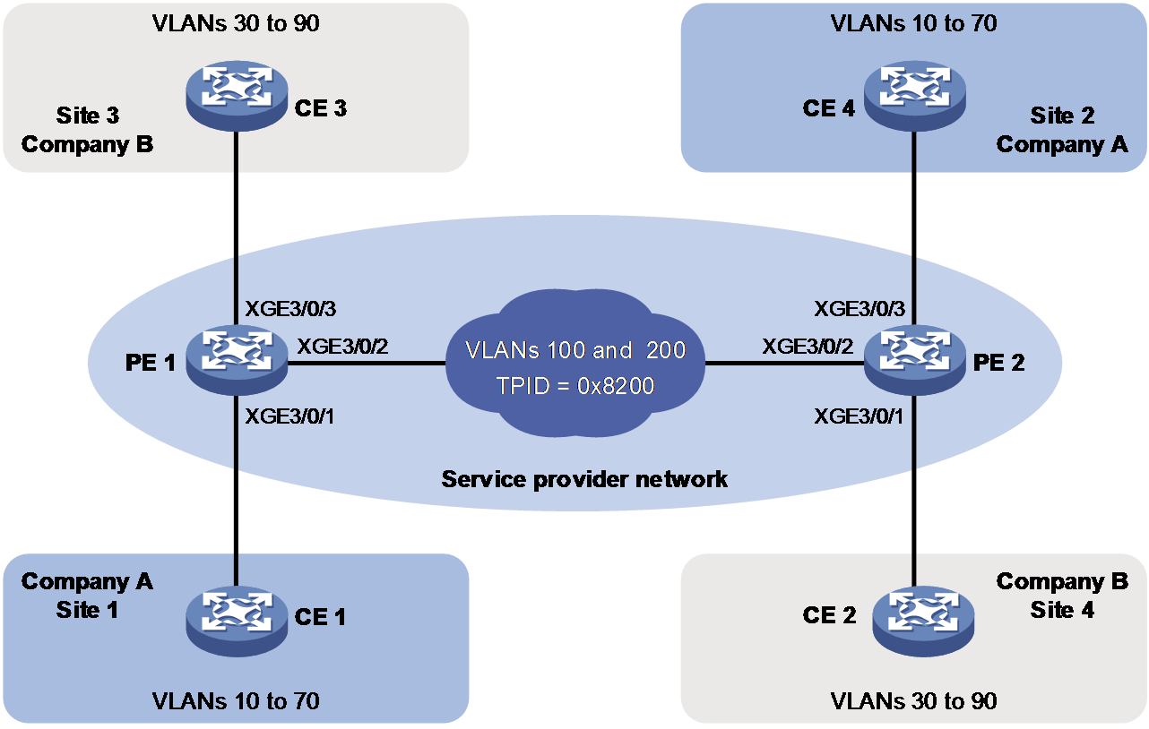

Example: Configuring basic QinQ
As shown in Figure 3:
·     The service provider assigns VLAN 100 to Company A's VLANs 10 through 70.
·     The service provider assigns VLAN 200 to Company B's VLANs 30 through 90.
·     The devices between PE 1 and PE 2 in the service provider network use a TPID value of 0x8200.
Configure QinQ on PE 1 and PE 2 to transmit traffic in VLANs 100 and 200 for Company A and Company B, respectively.
For the QinQ frames to be identified correctly, set the SVLAN TPID to 0x8200 on the service provider-side ports of PE 1 and PE 2.
Figure 3 Network diagram
1.     Configure PE 1:
# Configure Ten-GigabitEthernet 3/0/1 as a trunk port, and assign it to VLAN 100 and VLANs 10 through 70.
<PE1> system-view
[PE1] interface ten-gigabitethernet 3/0/1
[PE1-Ten-GigabitEthernet3/0/1] port link-type trunk
[PE1-Ten-GigabitEthernet3/0/1] port trunk permit vlan 100 10 to 70
# Set the PVID of Ten-GigabitEthernet 3/0/1 to VLAN 100.
[PE1-Ten-GigabitEthernet3/0/1] port trunk pvid vlan 100
# Enable QinQ on Ten-GigabitEthernet 3/0/1.
[PE1-Ten-GigabitEthernet3/0/1] qinq enable
[PE1-Ten-GigabitEthernet3/0/1] quit
# Configure Ten-GigabitEthernet 3/0/2 as a trunk port, and assign it to VLANs 100 and 200.
[PE1] interface ten-gigabitethernet 3/0/2
[PE1-Ten-GigabitEthernet3/0/2] port link-type trunk
[PE1-Ten-GigabitEthernet3/0/2] port trunk permit vlan 100 200
# Set the TPID value in the SVLAN tags to 0x8200 on Ten-GigabitEthernet 3/0/2.
[PE1-Ten-GigabitEthernet3/0/2] qinq ethernet-type service-tag 8200
[PE1-Ten-GigabitEthernet3/0/2] quit
# Configure Ten-GigabitEthernet 3/0/3 as a trunk port, and assign it to VLAN 200 and VLANs 30 through 90.
[PE1] interface ten-gigabitethernet 3/0/3
[PE1-Ten-GigabitEthernet3/0/3] port link-type trunk
[PE1-Ten-GigabitEthernet3/0/3] port trunk permit vlan 200 30 to 90
# Set the PVID of Ten-GigabitEthernet 3/0/3 to VLAN 200.
[PE1-Ten-GigabitEthernet3/0/3] port trunk pvid vlan 200
# Enable QinQ on Ten-GigabitEthernet 3/0/3.
[PE1-Ten-GigabitEthernet3/0/3] qinq enable
[PE1-Ten-GigabitEthernet3/0/3] quit
2.     Configure PE 2:
# Configure Ten-GigabitEthernet 3/0/1 as a trunk port, and assign it to VLAN 200 and VLANs 30 through 90.
<PE2> system-view
[PE2] interface ten-gigabitethernet 3/0/1
[PE2-Ten-GigabitEthernet3/0/1] port link-type trunk
[PE2-Ten-GigabitEthernet3/0/1] port trunk permit vlan 200 30 to 90
# Set the PVID of Ten-GigabitEthernet 3/0/1 to VLAN 200.
[PE2-Ten-GigabitEthernet3/0/1] port trunk pvid vlan 200
[PE2-Ten-GigabitEthernet3/0/1] qinq enable
[PE2-Ten-GigabitEthernet3/0/1] quit
[PE2] interface ten-gigabitethernet 3/0/2
[PE2-Ten-GigabitEthernet3/0/2] port link-type trunk
[PE2-Ten-GigabitEthernet3/0/2] port trunk permit vlan 100 200
[PE2-Ten-GigabitEthernet3/0/2] qinq ethernet-type service-tag 8200
[PE2-Ten-GigabitEthernet3/0/2] quit
# Configure Ten-GigabitEthernet 3/0/3 as a trunk port, and assign it to VLAN 100 and VLANs 10 through 70.
[PE2] interface ten-gigabitethernet 3/0/3
[PE2-Ten-GigabitEthernet3/0/3] port link-type trunk
[PE2-Ten-GigabitEthernet3/0/3] port trunk permit vlan 100 10 to 70
# Set the PVID of Ten-GigabitEthernet 3/0/3 to VLAN 100.
[PE2-Ten-GigabitEthernet3/0/3] port trunk pvid vlan 100
[PE2-Ten-GigabitEthernet3/0/3] qinq enable
[PE2-Ten-GigabitEthernet3/0/3] quit
3.     Configure the devices between PE 1 and PE 2:
# Set the MTU to a minimum of 1504 bytes for each port on the path of QinQ frames. (Details not shown.)
# Configure all ports on the forwarding path to allow frames from VLANs 100 and 200 to pass through without removing the VLAN tag. (Details not shown.)
