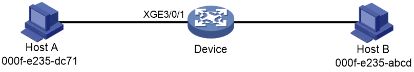

Manually configuring MAC address entries
Dynamic MAC address learning does not distinguish between illegitimate and legitimate frames, which can invite security hazards. When Host A is connected to Port A, a MAC address entry will be learned for the MAC address of Host A (for example, MAC A). When an illegal user sends frames with MAC A as the source MAC address to Port B, the device performs the following operations:
1.     Learns a new MAC address entry with Port B as the outgoing interface and overwrites the old entry for MAC A.
2.     Forwards frames destined for MAC A out of Port B to the illegal user.
As a result, the illegal user obtains the data of Host A. To improve the security for Host A, manually configure a static entry to bind Host A to Port A. Then, the frames destined for Host A are always sent out of Port A. Other hosts using the forged MAC address of Host A cannot obtain the frames destined for Host A.

MAC address table configuration examples
Example: Configuring the MAC address table
As shown in Figure 2:
·     Host A at MAC address 000f-e235-dc71 is connected to Ten-GigabitEthernet 3/0/1 of Device and belongs to VLAN 1.
·     Host B at MAC address 000f-e235-abcd, which behaved suspiciously on the network, also belongs to VLAN 1.
Configure the MAC address table as follows:
·     To prevent MAC address spoofing, add a static entry for Host A in the MAC address table of Device.
·     To drop all frames destined for Host B, add a blackhole MAC address entry for Host B.
·     Set the aging timer to 500 seconds for dynamic MAC address entries.
Figure 2 Network diagram
# Add a static MAC address entry for MAC address 000f-e235-dc71 on Ten-GigabitEthernet 3/0/1 that belongs to VLAN 1.
<Device> system-view
[Device] mac-address static 000f-e235-dc71 interface ten-gigabitethernet 3/0/1 vlan 1
# Add a blackhole MAC address entry for MAC address 000f-e235-abcd that belongs to VLAN 1.
[Device] mac-address blackhole 000f-e235-abcd vlan 1
# Set the aging timer to 500 seconds for dynamic MAC address entries.
[Device] mac-address timer aging 500
# Display the static MAC address entries for Ten-GigabitEthernet 3/0/1.
[Device] display mac-address static interface ten-gigabitethernet 3/0/1
MAC Address      VLAN ID    State            Port/Nickname            Aging
000f-e235-dc71   1          Static           XGE3/0/1                 N
# Display the blackhole MAC address entries.
[Device] display mac-address blackhole
000f-e235-abcd   1          Blackhole        N/A                      N
# Display the aging time of dynamic MAC address entries.
[Device] display mac-address aging-time
MAC address aging time: 500s.
