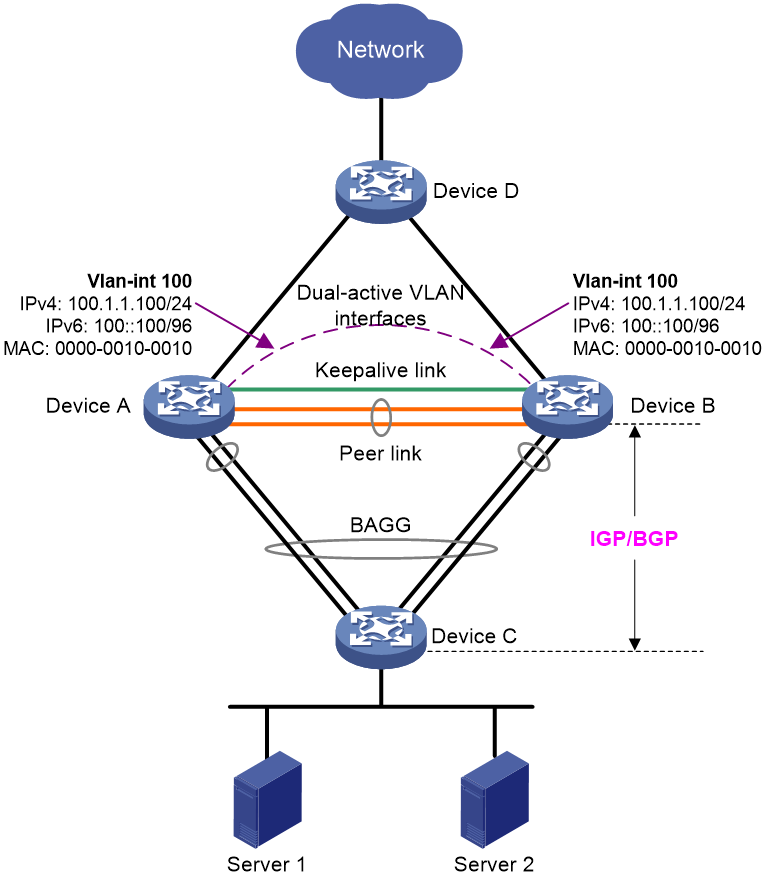

Dual-active gateways on an M-LAG system
When a Layer 3 network is dualhomed to an M-LAG system, each M-LAG member device uses a logical interface as the gateway interface for the Layer 3 network. Both logical interfaces are active to perform Layer 3 forwarding, and they use the same IP address and MAC address. When both links to the M-LAG system are operating correctly, the links load share traffic to balance bandwidth usage. When one of the links fails, the M-LAG system switches the traffic on the failed link to the other link to ensure high availability.
Typically, dual-active gateways are deployed if downstream devices run a dynamic routing protocol to communicate with the M-LAG system. As shown in Figure 4, IGP or BGP runs between Device C and the M-LAG system. To configure dual-active VLAN interfaces, perform the following tasks on Device A and Device B:
1.     Create VLAN interfaces for the same VLAN, VLAN-interface 100 for example, assign the same IPv4, IPv6, and MAC addresses to the VLAN interfaces, and assign the M-LAG interfaces to that VLAN.
2.     Assign different M-LAG virtual IP addresses to the VLAN interfaces.
Device A and Device B use their M-LAG virtual IP addresses to set up IGP or BGP peer relationships with Device C and with each other.
Figure 4 Layer 3 access to an M-LAG system through dynamic routing protocols

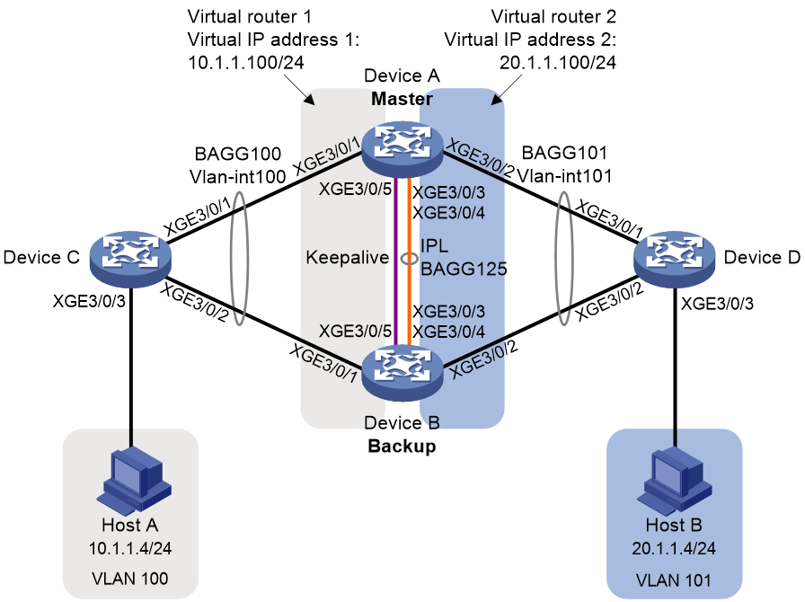

M-LAG configuration examples
Example: Configuring basic M-LAG functions
As shown in Figure 13, configure M-LAG on Device A and Device B to establish a multichassis aggregate link with Device C.
Figure 13 Network diagram
1.     Configure Device A:
# Configure M-LAG system settings.
<DeviceA> system-view
[DeviceA] m-lag system-mac 1-1-1
[DeviceA] m-lag system-number 1
[DeviceA] m-lag system-priority 123
# Configure M-LAG keepalive packet parameters.
[DeviceA] m-lag keepalive ip destination 1.1.1.1 source 1.1.1.2
# Set the link mode of Ten-GigabitEthernet 3/0/5 to Layer 3, and assign the interface an IP address. The IP address will be used as the source IP address of keepalive packets.
[DeviceA] interface ten-gigabitethernet 3/0/5
[DeviceA-Ten-GigabitEthernet3/0/5] port link-mode route
[DeviceA-Ten-GigabitEthernet3/0/5] ip address 1.1.1.2 24
[DeviceA-Ten-GigabitEthernet3/0/5] quit
# Exclude the interface used for M-LAG keepalive detection (Ten-GigabitEthernet 3/0/5) from the shutdown action by M-LAG MAD.

Example: Configuring Layer 3 gateways on an M-LAG system
As shown in Figure 14:
·     Configure Device A and Device B as an M-LAG system to establish one multichassis aggregate link with Device C and one with Device D.
·     Set up a keepalive link between Ten-GigabitEthernet 3/0/5 of Device A and Ten-GigabitEthernet 3/0/5 of Device B, and exclude the interfaces from the shutdown action by M-LAG MAD.
·     Configure two VRRP groups on Device A and Device B to provide gateway services for VLAN 100 and VLAN 200. Configure Device A as the master of the VRRP groups.
Figure 14 Network diagram
# Configure M-LAG keepalive parameters.
[DeviceA] m-lag keepalive ip destination 1.1.1.2 source 1.1.1.1
[DeviceA-Ten-GigabitEthernet3/0/5] ip address 1.1.1.1 24
[DeviceA] m-lag mad exclude interface ten-gigabitethernet 3/0/5
# Create Layer 2 dynamic aggregate interface Bridge-Aggregation 125.
[DeviceA] interface bridge-aggregation 125
[DeviceA-Bridge-Aggregation125] link-aggregation mode dynamic
[DeviceA-Bridge-Aggregation125] quit
# Assign Ten-GigabitEthernet 3/0/3 and Ten-GigabitEthernet 3/0/4 to aggregation group 125.
[DeviceA] interface ten-gigabitethernet 3/0/3
[DeviceA-Ten-GigabitEthernet3/0/3] port link-aggregation group 125
[DeviceA-Ten-GigabitEthernet3/0/3] quit
[DeviceA] interface Ten-GigabitEthernet 3/0/4
[DeviceA-Ten-GigabitEthernet3/0/4] port link-aggregation group 125
[DeviceA-Ten-GigabitEthernet3/0/4] quit
# Specify Bridge-Aggregation 125 as the peer-link interface.
[DeviceA-Bridge-Aggregation125] port m-lag peer-link 1
# Create Layer 2 dynamic aggregate interface Bridge-Aggregation 100, and assign it to M-LAG group 1.
[DeviceA] interface bridge-aggregation 100
[DeviceA-Bridge-Aggregation100] link-aggregation mode dynamic
[DeviceA-Bridge-Aggregation100] port m-lag group 1
[DeviceA-Bridge-Aggregation100] quit
# Assign Ten-GigabitEthernet 3/0/1 to aggregation group 100.
[DeviceA] interface ten-gigabitethernet 3/0/1
[DeviceA-Ten-GigabitEthernet3/0/1] port link-aggregation group 100
[DeviceA-Ten-GigabitEthernet3/0/1] quit
# Create Layer 2 dynamic aggregate interface Bridge-Aggregation 101, and assign it to M-LAG group 2.
[DeviceA] interface bridge-aggregation 101
[DeviceA-Bridge-Aggregation101] link-aggregation mode dynamic
[DeviceA-Bridge-Aggregation101] port m-lag group 2
[DeviceA-Bridge-Aggregation101] quit
# Assign Ten-GigabitEthernet 3/0/2 to aggregation group 101.
[DeviceA] interface ten-gigabitethernet 3/0/2
[DeviceA-Ten-GigabitEthernet3/0/2] port link-aggregation group 101
[DeviceA-Ten-GigabitEthernet3/0/2] quit
# Create VLAN 100 and VLAN 101.
[DeviceA] vlan 100
[DeviceA-vlan100] quit
[DeviceA] vlan 101
[DeviceA-vlan101] quit
# Set the link type of Bridge-Aggregation 100 to trunk, and assign it to VLAN 100.
[DeviceA-Bridge-Aggregation100] port link-type trunk
[DeviceA-Bridge-Aggregation100] port trunk permit vlan 100
# Set the link type of Bridge-Aggregation 101 to trunk, and assign it to VLAN 101.
[DeviceA-Bridge-Aggregation101] port link-type trunk
[DeviceA-Bridge-Aggregation101] port trunk permit vlan 101
# Create VLAN-interface 100 and VLAN-interface 101, and assign IP addresses to them.
[DeviceA] interface vlan-interface 100
[DeviceA-vlan-interface100] ip address 10.1.1.1 24
[DeviceA-vlan-interface100] quit
[DeviceA] interface vlan-interface 101
[DeviceA-vlan-interface101] ip address 20.1.1.1 24
[DeviceA-vlan-interface101] quit
# Exclude VLAN-interface 100 and VLAN-interface 101 from the shutdown action by M-LAG MAD.
[DeviceA] m-lag mad exclude interface vlan-interface 100
[DeviceA] m-lag mad exclude interface vlan-interface 101
# Configure OSPF.
[DeviceA] ospf
[DeviceA-ospf-1] import-route direct
[DeviceA-ospf-1] area 0
[DeviceA-ospf-1-area-0.0.0.0] network 10.1.1.0 0.0.0.255
[DeviceA-ospf-1-area-0.0.0.0] network 20.1.1.0 0.0.0.255
[DeviceA-ospf-1-area-0.0.0.0] quit
[DeviceA-ospf-1] quit
# Create VRRP group 1 on VLAN-interface 100 and set its virtual IP address to 10.1.1.100.
[DeviceA-Vlan-interface100] vrrp vrid 1 virtual-ip 10.1.1.100
# Set the priority of Device A (primary M-LAG member device) to 200 for it to become the master in VRRP group 1.
[DeviceA-Vlan-interface100] vrrp vrid 1 priority 200
[DeviceA-Vlan-interface100] quit
# Create VRRP group 2 on VLAN-interface 101 and set its virtual IP address to 20.1.1.100.
[DeviceA-Vlan-interface101] vrrp vrid 2 virtual-ip 20.1.1.100
# Set the priority of Device A (primary M-LAG member device) to 200 for it to become the master in VRRP group 2.

2.     Configure Device B:
<DeviceB> system-view
[DeviceB] m-lag system-mac 1-1-1
[DeviceB] m-lag system-number 2
[DeviceB] m-lag system-priority 123
[DeviceB] m-lag keepalive ip destination 1.1.1.1 source 1.1.1.2
[DeviceB] interface ten-gigabitethernet 3/0/5
[DeviceB-Ten-GigabitEthernet3/0/5] port link-mode route
[DeviceB-Ten-GigabitEthernet3/0/5] ip address 1.1.1.2 24
[DeviceB-Ten-GigabitEthernet3/0/5] quit
[DeviceB] m-lag mad exclude interface ten-gigabitethernet 3/0/5
[DeviceB] interface bridge-aggregation 125
[DeviceB-Bridge-Aggregation125] link-aggregation mode dynamic
[DeviceB-Bridge-Aggregation125] quit
[DeviceB] interface ten-gigabitethernet 3/0/3
[DeviceB-Ten-GigabitEthernet3/0/3] port link-aggregation group 125
[DeviceB-Ten-GigabitEthernet3/0/3] quit
[DeviceB] interface ten-gigabitethernet 3/0/4
[DeviceB-Ten-GigabitEthernet3/0/4] port link-aggregation group 125
[DeviceB-Ten-GigabitEthernet3/0/4] quit
[DeviceB-Bridge-Aggregation125] port m-lag peer-link 1
[DeviceB] interface bridge-aggregation 100
[DeviceB-Bridge-Aggregation100] link-aggregation mode dynamic
[DeviceB-Bridge-Aggregation100] port m-lag group 1
[DeviceB-Bridge-Aggregation100] quit
[DeviceB] interface ten-gigabitethernet 3/0/1
[DeviceB-Ten-GigabitEthernet3/0/1] port link-aggregation group 100
[DeviceB-Ten-GigabitEthernet3/0/1] quit
[DeviceB] interface bridge-aggregation 101
[DeviceB-Bridge-Aggregation101] link-aggregation mode dynamic
[DeviceB-Bridge-Aggregation101] port m-lag group 2
[DeviceB-Bridge-Aggregation101] quit
[DeviceB] interface ten-gigabitethernet 3/0/2
[DeviceB-Ten-GigabitEthernet3/0/2] port link-aggregation group 101
[DeviceB-Ten-GigabitEthernet3/0/2] quit
[DeviceB] vlan 100
[DeviceB-vlan100] quit
[DeviceB] vlan 101
[DeviceB-vlan101] quit
[DeviceB-Bridge-Aggregation100] port link-type trunk
[DeviceB-Bridge-Aggregation100] port trunk permit vlan 100
[DeviceB-Bridge-Aggregation101] port link-type trunk
[DeviceB-Bridge-Aggregation101] port trunk permit vlan 101
[DeviceB] interface vlan-interface 100
[DeviceB-vlan-interface100] ip address 10.1.1.2 24
[DeviceB-vlan-interface100] quit
[DeviceB] interface vlan-interface 101
[DeviceB-vlan-interface101] ip address 20.1.1.2 24
[DeviceB-vlan-interface101] quit
[DeviceB] m-lag mad exclude interface vlan-interface 100
[DeviceB] m-lag mad exclude interface vlan-interface 101
# Configure OSPF.
[DeviceB] ospf
[DeviceB-ospf-1] import-route direct
[DeviceB-ospf-1] area 0
[DeviceB-ospf-1-area-0.0.0.0] network 10.1.1.0 0.0.0.255
[DeviceB-ospf-1-area-0.0.0.0] network 20.1.1.0 0.0.0.255
[DeviceB-ospf-1-area-0.0.0.0] quit
[DeviceB-ospf-1] quit
[DeviceB-Vlan-interface100] vrrp vrid 1 virtual-ip 10.1.1.100
[DeviceB-Vlan-interface100] quit
[DeviceB-Vlan-interface101] vrrp vrid 2 virtual-ip 20.1.1.100
[DeviceB-Vlan-interface101] quit

# Verify that Device A has formed an M-LAG system with Device B.
[DeviceA] display m-lag summary
Flags: A -- Aggregate interface down, B -- No peer M-LAG interface configured
       C -- Configuration consistency check failed
Peer-link interface: BAGG125
Peer-link interface state (cause): UP
Keepalive link state (cause): UP
                     M-LAG interface information
M-LAG IF      M-LAG group  Local state (cause)  Peer state  Remaining down time(s)
BAGG100       1            UP                   UP          -
BAGG101       2            UP                   UP          -
[DeviceA] display m-lag verbose
Flags: A -- Home_Gateway, B -- Neighbor_Gateway, C -- Other_Gateway,
       D -- PeerLink_Activity, E -- DRCP_Timeout, F -- Gateway_Sync,
       G -- Port_Sync, H -- Expired
Peer-link interface/Peer-link interface ID: BAGG125/1
State: UP
Cause: -
Local DRCP flags/Peer DRCP flags: ABDFG/ABDFG
Local Selected ports (index): XGE3/0/3 (260), XGE3/0/4 (261)
Peer Selected ports indexes: 260, 261
M-LAG interface/M-LAG group ID: BAGG100/1
Local M-LAG interface state: UP
Peer M-LAG interface state: UP
M-LAG group state: UP
Local M-LAG interface down cause: -
Remaining M-LAG DOWN time: -
Local M-LAG interface LACP MAC: Config=N/A, Effective=0001-0001-0001
Peer M-LAG interface LACP MAC: Config=N/A, Effective=0001-0001-0001
Local M-LAG interface LACP priority: Config=32768, Effective=123
Peer M-LAG interface LACP priority: Config=32768, Effective=123
Local Selected ports (index): XGE3/0/1 (258)
Peer Selected ports indexes: 258
M-LAG interface/M-LAG group ID: BAGG101/2
Local Selected ports (index): XGE3/0/2 (259)
Peer Selected ports indexes: 259

[DeviceC] display ospf peer
         OSPF Process 1 with Router ID 10.1.1.3
               Neighbor Brief Information
 Area: 0.0.0.0
 Router ID       Address         Pri Dead-Time  State             Interface
 20.1.1.1        10.1.1.1        1   37         Full/DR           Vlan100
 20.1.1.2        10.1.1.2        1   32         Full/BDR          Vlan100
[DeviceD] display ospf peer
         OSPF Process 1 with Router ID 20.1.1.3
 Area: 0.0.0.0
 20.1.1.1        20.1.1.1        1   38         Full/DR           Vlan101
 20.1.1.2        20.1.1.2        1   37         Full/BDR          Vlan101
# Verify that Host A and Host B can ping each other. (Details not shown.)
Example: Configure dual-active gateways on an M-LAG system
As shown in Figure 15, set up an M-LAG system with Device A and Device B and configure dual-active gateways for the servers on Device A and Device B.
Figure 15 Network diagram
In this example, all devices use the factory default settings. When you apply this configuration example to a live environment, make sure the existing configurations do not conflict with the configurations in this example.
You must configure the same M-LAG system MAC address on the M-LAG member devices in the same M-LAG system. You must assign unique M-LAG system MAC addresses to different M-LAG systems.
To avoid loops, do not configure local proxy ARP or ND on the downstream VLAN interfaces of the M-LAG member devices. For more information about local proxy ARP or ND, see proxy ARP configuration and IPv6 neighbor discovery in Layer 3—IP Services Configuration Guide.
[DeviceA] m-lag system-mac 2-2-2
[DeviceA] m-lag keepalive ip destination 21.1.1.2 source 21.1.1.1
# Set the link mode of Ten-GigabitEthernet 3/0/5 to Layer 3, and assign the interface IPv4 and IPv6 addresses. The IPv4 address will be used as the source IP address of keepalive packets.
[DeviceA-Ten-GigabitEthernet3/0/5] ip address 21.1.1.1 24
[DeviceA-Ten-GigabitEthernet3/0/5] ipv6 address 21::1 64
# Create Layer 2 dynamic aggregate interface Bridge-Aggregation 1.
[DeviceA-Bridge-Aggregation1] link-aggregation mode dynamic
[DeviceA-Bridge-Aggregation1] quit
# Assign Ten-GigabitEthernet 3/0/3 and Ten-GigabitEthernet 3/0/4 to aggregation group 1.
[DeviceA] interface ten-gigabitethernet 3/0/4
# Configure Bridge-Aggregation 1 as the peer-link interface.
[DeviceA-Bridge-Aggregation1] port m-lag peer-link 1
# Create Layer 2 dynamic aggregate interface Bridge-Aggregation 3, and assign it to M-LAG group 1.
[DeviceA] interface bridge-aggregation 3
[DeviceA-Bridge-Aggregation3] link-aggregation mode dynamic
[DeviceA-Bridge-Aggregation3] port m-lag group 1
[DeviceA-Bridge-Aggregation3] quit
# Assign Ten-GigabitEthernet 3/0/1 and Ten-GigabitEthernet 3/0/2 to aggregation group 3.
[DeviceA-Ten-GigabitEthernet3/0/1] port link-aggregation group 3
[DeviceA-Ten-GigabitEthernet3/0/2] port link-aggregation group 3
# Create VLAN 102 and VLAN 103.
[DeviceA] vlan 102 103
# Set the link type of Bridge-Aggregation 3 to trunk, and assign it to VLAN 102 and VLAN 103.
[DeviceA-Bridge-Aggregation3] port link-type trunk
[DeviceA-Bridge-Aggregation3] port trunk permit vlan 102 103
# Create VLAN-interface 102 and assign it an IPv4 address and an IPv6 address for the interface to act as an IPv4 and IPv6 gateway.
[DeviceA] interface vlan-interface 102
[DeviceA-Vlan-interface102] ip address 10.102.0.1 255.255.255.0
[DeviceA-Vlan-interface102] ipv6 address 10:102::1 64
# Assign M-LAG virtual IPv4 and IPv6 addresses to VLAN-interface 102 for Device A to establish OSPF and OSPFv3 neighbor relationships with Device D.
[DeviceA-Vlan-interface102] port m-lag virtual-ip 10.102.0.3 24 active
[DeviceA-Vlan-interface102] port m-lag ipv6 virtual-ip FE80::2 link-local
# Assign a MAC address to VLAN-interface 102.
[DeviceA-Vlan-interface102] mac-address 3-3-3
[DeviceA-Vlan-interface102] quit
# Exclude VLAN-interface 102 from the shutdown action by M-LAG MAD.
[DeviceA] m-lag mad exclude interface vlan-interface 102
# Create VLAN-interface 103 and assign it an IPv4 address and an IPv6 address for the interface to act as an IPv4 and IPv6 gateway.
[DeviceA] interface vlan-interface 103
[DeviceA-Vlan-interface103] ip address 10.103.0.1 24
[DeviceA-Vlan-interface103] ipv6 address 10:103::1 64
# Assign M-LAG virtual IPv4 and IPv6 addresses to VLAN-interface 103 for Device A to establish BGP and BGP4+ peer relationships with Device D.
[DeviceA-Vlan-interface103] port m-lag virtual-ip 10.103.0.3 24 active
[DeviceA-Vlan-interface103] port m-lag ipv6 virtual-ip 10:103::3 64 active
# Assign a MAC address to VLAN-interface 103.
[DeviceA-Vlan-interface103] mac-address 4-4-4
[DeviceA-Vlan-interface103] quit
# Exclude VLAN-interface 103 from the shutdown action by M-LAG MAD.
[DeviceA] m-lag mad exclude interface vlan-interface 103
# Assign an IPv4 address and an IPv6 address to uplink interface Ten-GigabitEthernet 3/0/6.
[DeviceA] interface ten-gigabitethernet 3/0/6
[DeviceA-Ten-GigabitEthernet3/0/6] port link-mode route
[DeviceA-Ten-GigabitEthernet3/0/6] ip address 32.1.1.1 24
[DeviceA-Ten-GigabitEthernet3/0/6] ipv6 address 32:1::1 64
[DeviceA-Ten-GigabitEthernet3/0/6] quit
# Configure OSPF.
[DeviceA] ospf 1 router-id 11.1.1.1
[DeviceA-Vlan-interface102] ospf 1 area 0
[DeviceA-Vlan-interface102] ospf peer sub-address enable 10.102.0.3
[DeviceA-Ten-GigabitEthernet3/0/6] ospf 1 area 0
# Configure OSPFv3.
[DeviceA] ospfv3 1
[DeviceA-ospfv3-1] router-id 10.1.1.1
[DeviceA-ospfv3-1] area 0
[DeviceA-ospfv3-1-area-0.0.0.0] quit
[DeviceA-ospfv3-1] quit
[DeviceA-Vlan-interface102] ospfv3 1 area 0
[DeviceA-Ten-GigabitEthernet3/0/6] ospfv3 1 area 0
# Configure BGP.
[DeviceA] bgp 100
[DeviceA-bgp-default] router-id 12.1.1.1
[DeviceA-bgp-default] peer 32.1.1.2 as-number 100
[DeviceA-bgp-default] peer 10.103.0.2 as-number 100
[DeviceA-bgp-default] peer 10.103.0.2 source-address 10.103.0.3
[DeviceA-bgp-default] address-family ipv4
[DeviceA-bgp-default-ipv4] peer 10.103.0.2 enable
[DeviceA-bgp-default-ipv4] network 10.103.0.0  255.255.255.0
[DeviceA-bgp-default-ipv4] peer 32.1.1.2 enable
[DeviceA-bgp-default-ipv4] network 32.1.1.0 255.255.255.0
[DeviceA-bgp-default-ipv4] quit
# Configure BGP4+.
[DeviceA-bgp-default] peer 32:1::2 as-number 100
[DeviceA-bgp-default] peer 10:103::2 as-number 100
[DeviceA-bgp-default] peer 10:103::2 source-address 10:103::3
[DeviceA-bgp-default] address-family ipv6
[DeviceA-bgp-default-ipv6] peer 10:103::2 enable
[DeviceA-bgp-default-ipv6] network 10:103::2  64
[DeviceA-bgp-default-ipv6] peer 32:1::2 enable
[DeviceA-bgp-default-ipv6] network  32:1::2 64
[DeviceA-bgp-default-ipv6] quit
[DeviceA-bgp-default] quit
[DeviceB] m-lag system-mac 2-2-2
[DeviceB] m-lag keepalive ip destination 21.1.1.1 source 21.1.1.2
[DeviceB-Ten-GigabitEthernet3/0/5] ip address 21.1.1.2 255.255.255.0
[DeviceB-Ten-GigabitEthernet3/0/5] ipv6 address 21::2 64
[DeviceB-Bridge-Aggregation1] link-aggregation mode dynamic
[DeviceB-Bridge-Aggregation1] quit
[DeviceB-Bridge-Aggregation1] port m-lag peer-link 1
[DeviceB] interface bridge-aggregation 3
[DeviceB-Bridge-Aggregation3] link-aggregation mode dynamic
[DeviceB-Bridge-Aggregation3] port m-lag group 1
[DeviceB-Bridge-Aggregation3] quit
[DeviceB-Ten-GigabitEthernet3/0/1] port link-aggregation group 3
[DeviceB-Ten-GigabitEthernet3/0/2] port link-aggregation group 3
[DeviceB] vlan 102 103
[DeviceB-Bridge-Aggregation3] port link-type trunk
[DeviceB-Bridge-Aggregation3] port trunk permit vlan 102 103
[DeviceB] interface vlan-interface 102
[DeviceB-Vlan-interface102] ip address 10.102.0.1 24
[DeviceB-Vlan-interface102] ipv6 address 10:102::1 64
[DeviceB-Vlan-interface102] port m-lag virtual-ip 10.102.0.4 24 active
[DeviceB-Vlan-interface102] port m-lag ipv6 virtual-ip FE80::4 link-local
[DeviceB-Vlan-interface102] mac-address 3-3-3
[DeviceB-Vlan-interface102] quit
[DeviceB] m-lag mad exclude interface vlan-interface 102
[DeviceB] interface vlan-interface 103
[DeviceB-Vlan-interface103] ip address 10.103.0.1 24
[DeviceB-Vlan-interface103] ipv6 address 10:103::1 64
[DeviceB-Vlan-interface103] port m-lag virtual-ip 10.103.0.4 24 active
[DeviceB-Vlan-interface103] port m-lag ipv6 virtual-ip 10:103::4 64 active
[DeviceB-Vlan-interface103] mac-address 4-4-4
[DeviceB-Vlan-interface103] quit
[DeviceB] m-lag mad exclude interface vlan-interface 103
[DeviceB] interface ten-gigabitethernet 3/0/6
[DeviceB-Ten-GigabitEthernet3/0/6] port link-mode route
[DeviceB-Ten-GigabitEthernet3/0/6] ip address 33.1.1.1 24
[DeviceB-Ten-GigabitEthernet3/0/6] ipv6 address 33:1::1 64
[DeviceB-Ten-GigabitEthernet3/0/6] quit
# Configure OSPF.
[DeviceB] ospf 1 router-id 11.1.1.2
[DeviceB-Vlan-interface102] ospf 1 area 0
[DeviceB-Vlan-interface102] ospf peer sub-address enable 10.102.0.4
[DeviceB-Ten-GigabitEthernet3/0/6] ospf 1 area 0
# Configure OSPFv3.
[DeviceB] ospfv3 1
[DeviceB-ospfv3-1] router-id 10.1.1.2
[DeviceB-ospfv3-1] area 0
[DeviceB-ospfv3-1-area-0.0.0.0] quit
[DeviceB-ospfv3-1] quit
[DeviceB-Vlan-interface102] ospfv3 1 area 0
[DeviceB-Ten-GigabitEthernet3/0/6] ospfv3 1 area 0
# Configure BGP.
[DeviceB] bgp 100

The following tasks use Device A as an example.
BAGG3         1            UP                   UP          -
Peer-link interface/Peer-link interface ID: BAGG1/1
State: UP
Cause: -
M-LAG interface/M-LAG group ID: BAGG3/1
Local M-LAG interface LACP MAC: Config=N/A, Effective=0002-0002-0002
Peer M-LAG interface LACP MAC: Config=N/A, Effective=0002-0002-0002
Local Selected ports (index): XGE3/0/1 (258), XGE3/0/2 (259)
Peer Selected ports indexes: 258, 259
# Verify that Device A have established OSPF neighbor relationships.
[DeviceA] display ospf peer
         OSPF Process 1 with Router ID 11.1.1.1
 Area: 0.0.0.0
 11.1.1.3        32.1.1.2        1   39         Full/BDR          XGE3/0/6
 11.1.1.4        10.102.0.2      1   31         Full/DROther      Vlan102
 11.1.1.2        10.102.0.4      1   37         Full/DR           Vlan102
# Verify that Device A have established OSPFv3 neighbor relationships.
[DeviceA] display ospfv3 peer
               OSPFv3 Process 1 with Router ID 10.1.1.1
 Area: 0.0.0.0
 Router ID       Pri State             Dead-Time InstID Interface
 10.1.1.3        1   Full/BDR          00:00:34  0      XGE3/0/6
 10.1.1.2        1   Full/BDR          00:00:32  0      Vlan102
 10.1.1.4        1   Full/DROther      00:00:39  0      Vlan102
# Verify that Device A have established BGP peer relationships.
[DeviceA] display bgp peer ipv4
 BGP local router ID: 12.1.1.1
 Local AS number: 100
 Total number of peers: 2                 Peers in established state: 2
  * - Dynamically created peer
  ^ - Peer created through link-local address
  Peer                    AS  MsgRcvd  MsgSent OutQ PrefRcv Up/Down  State
  10.103.0.2             100        6        6    0       1 00:01:50 Established
  32.1.1.2               100        5        5    0       2 00:00:01 Established
# Verify that Device A have established BGP4+ peer relationships.
[DeviceA] display bgp peer ipv6
  10:103::2              100        9        9    0       1 00:04:26 Established
  32:1::2                100        6        6    0       2 00:02:13 Established
