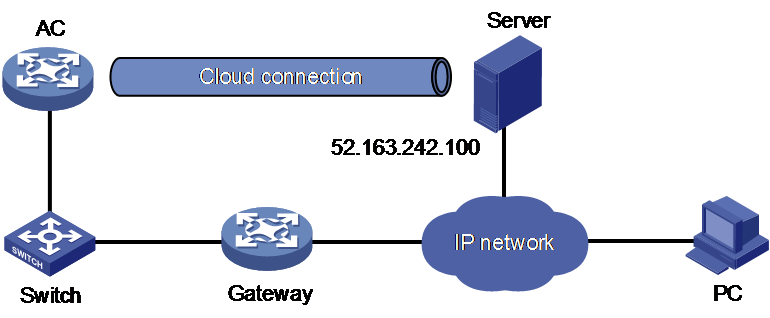

About cloud connections
A cloud connection is a management tunnel established between a local device and the cloud server. It enables you to manage the local device from the cloud server without accessing the network where the device resides.
Multiple subconnections
After a local device establishes a connection with the cloud server, service modules on the local device can establish multiple subconnections with the microservices on the cloud server. These subconnections are independent from each other and provide separate communication channels for different services. This mechanism avoids interference among different services.
Cloud connection establishment
As shown in Figure 1, the cloud connection between the device and the cloud server is established as follows:
1. The device sends an authentication request to the cloud server.
2. The cloud server sends an authentication success packet to the device.
The device passes the authentication only if the serial number of the device has been added to the cloud server. If the authentication fails, the cloud server sends an authentication failure packet to the device.
3. The device sends a registration request to the cloud server.
4. The cloud server sends a registration response to the device.
The registration response contains the uniform resource locator (URL) used to establish a cloud connection.
5. The device uses the URL to send a handshake request (changing the protocol from HTTP to WebSocket) to the cloud server.
6. The cloud server sends a handshake response to the device to finish establishing the cloud connection.
7. After the cloud connection is established, the device automatically obtains the subconnection URLs and establishes subconnections with the cloud server based on the service needs.
Figure 1 Establishing a cloud connection

Example: Configuring a cloud connection
As shown in Figure 2, configure the device to establish a cloud connection with the cloud server.
1. Configure IP addresses for interfaces as shown in Figure 2, and configure a routing protocol to make sure the devices can reach each other. (Details not shown.)
2. Log in to the cloud server to add the serial number of the device to the server. (Details not shown.)
3. Configure the domain name of the cloud server as oasiscloud.h3c.com.
<Device> system-view
[Device] cloud-management server domain oasiscloud.h3c.com
NOTE: · The DNS service is provided by the ISP DNS server. · The domain name and IP address used here are for illustration only. |

As shown in Figure 3, configure the AC to establish a cloud connection with the cloud server.
1. Configure IP addresses for interfaces as shown in Figure 3, and configure a routing protocol to make sure the devices can reach each other. (Details not shown.)
2. Log in to the cloud server to add the serial number of the AC to the server. (Details not shown.)
<AC> system-view
[AC] cloud-management server domain oasiscloud.h3c.com

As shown in Figure 4, configure the AP to establish a cloud connection with the cloud server.
1. Configure IP addresses for interfaces as shown in Figure 4, and configure a routing protocol to ensure that the devices can reach each other. (Details not shown.)
2. Log in to the cloud server to add the serial number of the AP to the server. (Details not shown.)
<AP> system-view
[AP] cloud-management server domain oasiscloud.h3c.com
