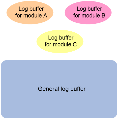

Outputting logs to the log buffer
This feature enables log output to log buffers based on the log source modules. As shown in Figure 2, log buffers include separate module-specific log buffers and the general log buffer.
Figure 2 Genratal log buffer and separate module-specific log buffers
· Separate module-specific log buffers—Logs generated by modules that have separate log buffers are saved to their respective log buffers.
For example, logs generated by the CFGLOG module are saved to the CFGLOG log buffer. With separate buffers, you can manage and view the module-specific logs and general logs conveniently.
The modules that have separate log buffers are determined by factory settings. To view the names of supported modules, use the display logbuffer module ? command. You can use the display logbuffer module module-name command to view buffered logs of the specified module.
· General log buffer—Logs generated by the system and the modules other than the modules that have separate log buffers are saved to the general log buffer.
You can use the display logbuffer command without the module keyword to view buffered logs in the general log buffer.
