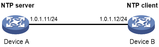

Figure 1 shows how NTP synchronizes the system time between two devices (Device A and Device B, in this example). Assume that:
· Prior to the time synchronization, the time is set to 10:00:00 am for Device A and 11:00:00 am for Device B.
· Device B is used as the NTP server. Device A is to be synchronized to Device B.
· It takes 1 second for an NTP message to travel from Device A to Device B, and from Device B to Device A.
· It takes 1 second for Device B to process the NTP message.
The synchronization process is as follows:
1. Device A sends Device B an NTP message, which is timestamped when it leaves Device A. The time stamp is 10:00:00 am (T1).
2. When this NTP message arrives at Device B, Device B adds a timestamp showing the time when the message arrived at Device B. The timestamp is 11:00:01 am (T2).
3. When the NTP message leaves Device B, Device B adds a timestamp showing the time when the message left Device B. The timestamp is 11:00:02 am (T3).
4. When Device A receives the NTP message, the local time of Device A is 10:00:03 am (T4).
Up to now, Device A can calculate the following parameters based on the timestamps:
· The roundtrip delay of the NTP message: Delay = (T4 – T1) – (T3 – T2) = 2 seconds.
· Time difference between Device A and Device B: Offset = [ (T2 – T1) + (T3 – T4) ] /2 = 1 hour.
Based on these parameters, Device A can be synchronized to Device B.
This is only a rough description of the work mechanism of NTP. For more information, see the related protocols and standards.

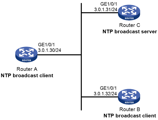

NTP architecture
NTP uses stratums 0 to 16 to define clock accuracy, as shown in Figure 2. A lower stratum value represents higher accuracy. Clocks at stratums 1 through 15 are in synchronized state, and clocks at stratum 16 are not synchronized.
A stratum 1 NTP server gets its time from an authoritative time source, such as an atomic clock. It provides time for other devices as the primary NTP server. A stratum 2 time server receives its time from a stratum 1 time server, and so on.
To ensure time accuracy and availability, you can specify multiple NTP servers for a device. The device selects an optimal NTP server as the clock source based on parameters such as stratum. The clock that the device selects is called the reference source. For more information about clock selection, see the related protocols and standards.
If the devices in a network cannot synchronize to an authoritative time source, you can perform the following tasks:
· Select a device that has a relatively accurate clock from the network.
· Use the local clock of the device as the reference clock to synchronize other devices in the network.

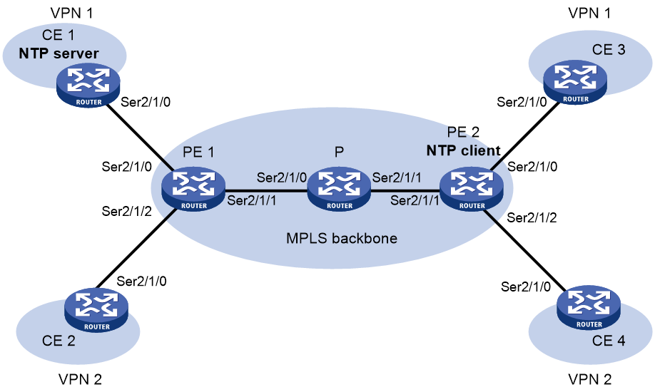

NTP for MPLS L3VPN instances
On an MPLS L3VPN network, a PE that acts as an NTP client or active peer can synchronize with the NTP server or passive peer in an MPLS L3VPN instance.
As shown in Figure 4, users in VPN 1 and VPN 2 are connected to the MPLS backbone network through provider edge (PE) devices. VPN instances vpn1 and vpn2 have been created for VPN 1 and VPN 2, respectively on the PEs. Services of the two VPN instances are isolated. Time synchronization between PEs and devices in the two VPN instances can be realized if you perform the following tasks:
· Configure the PEs to operate in NTP client or symmetric active mode.
· Specify the VPN instance to which the NTP server or NTP symmetric passive peer belongs.
For more information about MPLS L3VPN, VPN instance, and PE, see MPLS Configuration Guide.

Example: Configuring NTP client/server association mode
As shown in Figure 5, perform the following tasks:
· Configure Device A's local clock as its reference source, with stratum level 2.
· Configure Device B to operate in client mode and specify Device A as the NTP server of Device B.
1. Assign an IP address to each interface, and make sure Device A and Device B can reach each other, as shown in Figure 5. (Details not shown.)
2. Configure Device A:
# Enable the NTP service.
<DeviceA> system-view
[DeviceA] ntp-service enable
# Specify the local clock as the reference source, with stratum level 2.
[DeviceA] ntp-service refclock-master 2
3. Configure Device B:
<DeviceB> system-view
[DeviceB] ntp-service enable
# Specify NTP for obtaining the system time.
[DeviceB] clock protocol ntp
# Specify Device A as the NTP server of Device B.
[DeviceB] ntp-service unicast-server 1.0.1.11
# Verify that Device B has synchronized its time with Device A, and the clock stratum level of Device B is 3.
[DeviceB] display ntp-service status
Clock status: synchronized
Clock stratum: 3
System peer: 1.0.1.11
Local mode: client
Reference clock ID: 1.0.1.11
Leap indicator: 00
Clock jitter: 0.000977 s
Stability: 0.000 pps
Clock precision: 2^-10
Root delay: 0.00383 ms
Root dispersion: 16.26572 ms
Reference time: d0c6033f.b9923965 Wed, Dec 29 2010 18:58:07.724
# Verify that an IPv4 NTP association has been established between Device B and Device A.
[DeviceB] display ntp-service sessions
source reference stra reach poll now offset delay disper
[12345]1.0.1.11 127.127.1.0 2 1 64 15 -4.0 0.0038 16.262
Notes: 1 source(master), 2 source(peer), 3 selected, 4 candidate, 5 configured.
Total sessions: 1

Example: Configuring NTP broadcast association mode
As shown in Figure 9, configure Router C as the NTP server for multiple devices on a network segment to synchronize the time of the devices.
· Configure Router C's local clock as its reference source, with stratum level 2.
· Configure Router C to operate in broadcast server mode and send broadcast messages from GigabitEthernet 1/0/1.

Example: Configuring NTP multicast association mode
As shown in Figure 10, configure router C as the NTP server for multiple devices on different network segments to synchronizes the time of the devices.
· Configure Router C to operate in multicast server mode and send multicast messages from GigabitEthernet 1/0/1.
· Configure Router D and Router A to operate in multicast client mode and receive multicast messages on GigabitEthernet 1/0/1.
1. Assign an IP address to each interface, and make sure the routers can reach each other, as shown in Figure 10. (Details not shown.)
2. Configure Router C:
<RouterC> system-view
[RouterC] ntp-service enable
[RouterC] clock protocol ntp
[RouterC] ntp-service refclock-master 2
# Configure Router C to operate in multicast server mode and send multicast messages through GigabitEthernet 1/0/1.
[RouterC] interface gigabitethernet 1/0/1
[RouterC-GigabitEthernet1/0/1] ntp-service multicast-server
3. Configure Router D:
<RouterD> system-view
[RouterD] ntp-service enable
[RouterD] clock protocol ntp
# Configure Router D to operate in multicast client mode and receive multicast messages on GigabitEthernet 1/0/1.
[RouterD] interface gigabitethernet 1/0/1
[RouterD-GigabitEthernet1/0/1] ntp-service multicast-client
4. Verify the configuration:
# Verify that Router D has synchronized its time with Router C, and the clock stratum level of Router D is 3.
Router D and Router C are on the same subne. Router D can receive multicast messages from Router C without being enabled with the multicast function.
[RouterD-GigabitEthernet1/0/1] display ntp-service status
Clock stratum: 3
System peer: 3.0.1.31
Local mode: bclient
Reference clock ID: 3.0.1.31
Leap indicator: 00
Clock jitter: 0.044281 s
Root delay: 0.00229 ms
Root dispersion: 4.12572 ms
Reference time: d0d289fe.ec43c720 Sat, Jan 8 2011 7:00:14.922
# Verify that an IPv4 NTP association has been established between Router D and Router C.
[RouterD-GigabitEthernet1/0/1] display ntp-service sessions
[1245]3.0.1.31 127.127.1.0 2 1 64 519 -0.0 0.0022 4.1257
Notes: 1 source(master),2 source(peer),3 selected,4 candidate,5 configured.
Total sessions: 1
5. Configure Router B:
Because Router A and Router C are on different subnets, you must configure the multicast functions on Router B so that Router A can receive multicast messages from Router C.
# Configure the IP multicast function.
<RouterB> system-view
[RouterB] multicast routing
[RouterB-mrib] quit
[RouterB-GigabitEthernet1/0/1] igmp enable
[RouterB-GigabitEthernet1/0/1] igmp static-group 224.0.1.1
[RouterB-GigabitEthernet1/0/1] quit
[RouterB] interface gigabitethernet 1/0/2
[RouterB-GigabitEthernet1/0/2] pim dm
6. Configure Router A:
<RouterA> system-view
[RouterA] ntp-service enable
[RouterA] clock protocol ntp
# Configure Router A to operate in multicast client mode and receive multicast messages on GigabitEthernet 1/0/1.
[RouterA] interface gigabitethernet 1/0/1
[RouterA-GigabitEthernet1/0/1] ntp-service multicast-client
# Verify that Router A has synchronized its time with Router C, and the clock stratum level of Router A is 3.
[RouterA-GigabitEthernet1/0/1] display ntp-service status
Clock stratum: 3
Local mode: bclient
Leap indicator: 00
Clock jitter: 0.165741 s
Root delay: 0.00534 ms
Root dispersion: 4.51282 ms
Reference time: d0c61289.10b1193f Wed, Dec 29 2010 20:03:21.065
# Verify that an IPv4 NTP association has been established between Router A and Router C.
[RouterA-GigabitEthernet1/0/1] display ntp-service sessions
[1234]3.0.1.31 127.127.1.0 2 247 64 381 -0.0 0.0053 4.5128
Total sessions: 1

Example: Configuring NTP client/server association mode with authentication
As shown in Figure 12, perform the following tasks:
· Configure NTP authentication on both Device A and Device B.
1. Assign an IP address to each interface, and make sure Device A and Device B can reach each other, as shown in Figure 12. (Details not shown.)
# Enable NTP authentication on Device B.
[DeviceB] ntp-service authentication enable
# Create authentication key 42 and set the key value to aNiceKey in plain text.
[DeviceB] ntp-service authentication-keyid 42 authentication-mode md5 simple aNiceKey
# Specify key 42 as a trusted key.
[DeviceB] ntp-service reliable authentication-keyid 42
# Specify Device A as the NTP server of Device B, and associate the server with key 42.
[DeviceB] ntp-service unicast-server 1.0.1.11 authentication-keyid 42
To enable Device B synchronize its clock with Device A, enable NTP authentication on Device A.
4. Configure NTP authentication on Device A:
# Enable NTP authentication.
[DeviceA] ntp-service authentication enable
[DeviceA] ntp-service authentication-keyid 42 authentication-mode md5 simple aNiceKey
[DeviceA] ntp-service reliable authentication-keyid 42
Clock stratum: 3
Local mode: client
Leap indicator: 00
Clock jitter: 0.005096 s
Root delay: 0.00655 ms
Root dispersion: 1.15869 ms
Reference time: d0c62687.ab1bba7d Wed, Dec 29 2010 21:28:39.668

Example: Configuring NTP broadcast mode with authentication
As shown in Figure 13, configure Router C as the NTP server for multiple devices on the same network segment to synchronizes the time of the devices. Configure Router A and Router B to authenticate the NTP server.
· Configure Router C's local clock as its reference source, with stratum level 3.
· Configure Router A and Router B to operate in broadcast client mode and receive broadcast client on GigabitEthernet 1/0/1.
· Configure NTP authentication on Router A, Router B, and Router C.
1. Assign an IP address to each interface, and make sure Router A, Router B, and Router C can reach each other, as shown in Figure 13. (Details not shown.)
2. Configure Router A:
# Enable NTP authentication on Router A. Create a plaintext NTP authentication key, with the key ID of 88 and key value of 123456. Specify the key as a trusted key.
[RouterA] ntp-service authentication enable
[RouterA] ntp-service authentication-keyid 88 authentication-mode md5 simple 123456
[RouterA] ntp-service reliable authentication-keyid 88
# Configure Router A to operate in broadcast client mode and receive NTP broadcast messages on GigabitEthernet 1/0/1.
[RouterA-GigabitEthernet1/0/1] ntp-service broadcast-client
3. Configure Router B:
[RouterB] ntp-service enable
[RouterB] clock protocol ntp
# Enable NTP authentication on Router B. Create a plaintext NTP authentication key, with the key ID of 88 and key value of 123456. Specify the key as a trusted key.
[RouterB] ntp-service authentication enable
[RouterB] ntp-service authentication-keyid 88 authentication-mode md5 simple 123456
[RouterB] ntp-service reliable authentication-keyid 88
# Configure Router B to operate in broadcast client mode and receive NTP broadcast messages on GigabitEthernet 1/0/1.
[RouterB-GigabitEthernet1/0/1] ntp-service broadcast-client
4. Configure Router C:
# Specify the local clock as the reference source, with stratum level 3.
[RouterC] ntp-service refclock-master 3
# Configure Router C to operate in the NTP broadcast server mode and send NTP broadcast messages from GigabitEthernet 1/0/1.
[RouterC-GigabitEthernet1/0/1] ntp-service broadcast-server
[RouterC-GigabitEthernet1/0/1] quit
5. Verify the configuration:
NTP authentication is enabled on Router A and Router B, but not enabled on Router C, so Router A and Router B cannot synchronize their local clocks with Router C.
[RouterB-GigabitEthernet1/0/1] display ntp-service status
Clock status: unsynchronized
Clock stratum: 16
Reference clock ID: none
6. Configure NTP authentication on Router C:
# Enable NTP authentication on Router C. Create a plaintext NTP authentication key, with the key ID of 88 and key value of 123456. Specify the key as a trusted key.
[RouterC] ntp-service authentication enable
[RouterC] ntp-service authentication-keyid 88 authentication-mode md5 simple 123456
[RouterC] ntp-service reliable authentication-keyid 88
# Specify Router C as an NTP broadcast server, and associate key 88 with Router C.
[RouterC-GigabitEthernet1/0/1] ntp-service broadcast-server authentication-keyid 88
The following procedure uses Router B as an example to verify the configuration.
# Verify that Router B has synchronized its time with Router C, and the clock stratum level of Router B is 4.
Clock stratum: 4
Local mode: bclient
Leap indicator: 00
Clock jitter: 0.006683 s
Root delay: 0.00127 ms
Root dispersion: 2.89877 ms
Reference time: d0d287a7.3119666f Sat, Jan 8 2011 6:50:15.191
# Verify that an IPv4 NTP association has been established between Router B and Router C.
[RouterB-GigabitEthernet1/0/1] display ntp-service sessions
[1245]3.0.1.31 127.127.1.0 3 3 64 68 -0.0 0.0000 0.0
Total sessions: 1
Example: Configuring MPLS L3VPN network time synchronization in client/server mode
As shown in Figure 14, two MPLS L3VPN instances are present on PE 1 and PE 2: vpn1 and vpn2. CE 1 and CE 3 are devices in VPN 1.
To synchronize time between PE 2 and CE 1 in VPN 1, perform the following tasks:
· Configure CE 1's local clock as its reference source, with stratum level 2.
· Configure CE 1 in the VPN instance vpn1 as the NTP server of PE 2.
Device |
Interface |
IP address |
Device |
Interface |
IP address |
CE 1 |
Ser2/1/0 |
10.1.1.1/24 |
PE 1 |
Ser2/1/0 |
10.1.1.2/24 |
CE 2 CE 3 |
Ser2/1/0 Ser2/1/0 |
10.2.1.1/24 10.3.1.1/24 |
Ser2/1/1 Ser2/1/2 |
172.1.1.1/24 10.2.1.2/24 |
CE 4 |
Ser2/1/0 |
10.4.1.1/24 |
PE 2 |
Ser2/1/0 |
10.3.1.2/24 |
P |
Ser2/1/0 |
172.1.1.2/24 |
Ser2/1/1 |
172.2.1.2/24 |
Ser2/1/1 |
172.2.1.1/24 |
Ser2/1/2 |
10.4.1.2/24 |
Before you perform the following configuration, be sure you have completed MPLS L3VPN-related configurations. For information about configuring MPLS L3VPN, see MPLS Configuration Guide.
1. Assign an IP address to each interface, as shown in Figure 14. Make sure CE 1 and PE 1, PE 1 and PE 2, and PE 2 and CE 3 can reach each other. (Details not shown.)
2. Configure CE 1:
<CE1> system-view
[CE1] ntp-service enable
[CE1] ntp-service refclock-master 2
3. Configure PE 2:
<PE2> system-view
[PE2] ntp-service enable
[PE2] clock protocol ntp
# Specify CE 1 in the VPN instance vpn1 as the NTP server of PE 2.
[PE2] ntp-service unicast-server 10.1.1.1 vpn-instance vpn1
# Verify that PE 2 has synchronized to CE 1, with stratum level 3.
[PE2] display ntp-service status
Clock stratum: 3
System peer: 10.1.1.1
Local mode: client
Reference clock ID: 10.1.1.1
Leap indicator: 00
# Verify that an IPv4 NTP association has been established between PE 2 and CE 1.
[PE2] display ntp-service sessions
[1245]10.1.1.1 127.127.1.0 2 1 64 519 -0.0 0.0065 0.0
Total sessions: 1
# Verify that server 127.0.0.1 has synchronized to server 10.1.1.1, and server 10.1.1.1 has synchronized to the local clock.
[PE2] display ntp-service trace
Server 127.0.0.1
Stratum 3 , jitter 0.000, synch distance 796.50.
Server 10.1.1.1
Stratum 2 , jitter 939.00, synch distance 0.0000.
RefID 127.127.1.0

SNTP configuration examples
Example: Configuring SNTP
As shown in Figure 16, perform the following tasks:
· Configure Device B to operate in SNTP client mode, and specify Device A as the NTP server.
· Configure NTP authentication on Device A and SNTP authentication on Device B.
1. Assign an IP address to each interface, and make sure Device A and Device B can reach each other, as shown in Figure 16. (Details not shown.)
[DeviceA] clock protocol ntp
# Configure the local clock as the reference source, with stratum level 2.
# Enable NTP authentication on Device A.
# Create authentication key 10 and set the key value of aNiceKey, in plain text.
[DeviceA] ntp-service authentication-keyid 10 authentication-mode md5 simple aNiceKey
# Specify key 10 as a trusted key.
[DeviceA] ntp-service reliable authentication-keyid 10
# Enable the SNTP service.
[DeviceB] sntp enable
# Enable SNTP authentication on Device B.
[DeviceB] sntp authentication enable
[DeviceB] sntp authentication-keyid 10 authentication-mode md5 simple aNiceKey
[DeviceB] sntp reliable authentication-keyid 10
# Specify Device A as the NTP server of Device B, and associate the server with key 10.
[DeviceB] sntp unicast-server 1.0.1.11 authentication-keyid 10
# Verify that an SNTP association has been established between Device B and Device A, and Device B has synchronized to Device A.
[DeviceB] display sntp sessions
NTP server Stratum Version Last receive time
1.0.1.11 2 4 Tue, May 17 2011 9:11:20.833 (Synced)
