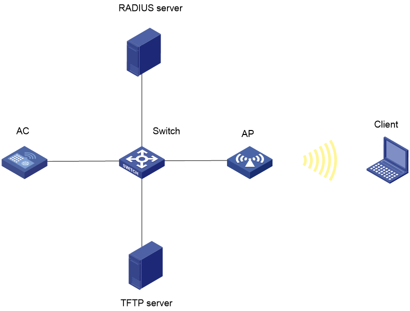

As shown in Figure 1, the client must pass 802.1X authentication to access the wireless network. The RADIUS server runs on IMC and provides AAA services for the client.
Configure RADIUS-based ACL assignment to deny the access of the client to the TFTP server.
Figure 1 Network diagram
Device
Interface
IP address
AC
VLAN-interface 100
138.100.1.101/16
VLAN-interface 200
138.200.1.101/16
RADIUS server
8.1.1.50/16
TFTP server
8.1.1.5/16
Switch
VLAN-interface 100
138.100.1.100/16
VLAN-interface 200
138.200.1.100/16
VLAN-interface 8
8.1.1.100/16

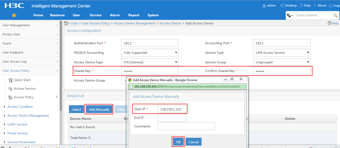

1.     Add an access device:
a.     Log in to IMC and click the User tab.
b.     From the navigation tree, select User Access Policy > Access Device Management > Access Device.
c.     Click Add.
The Add Access Device page opens.
d.     In the Access Configuration area, configure the following parameters, as shown in Figure 2:
-     Enter 12345678 in the Shared Key and Confirm Shared Key fields.
-     Use the default values for other parameters.
e.     In the Device List area, click Add Manually to add the device at 138.100.1.101 as an access device.
f.     Click OK.
Figure 2 Adding an access device

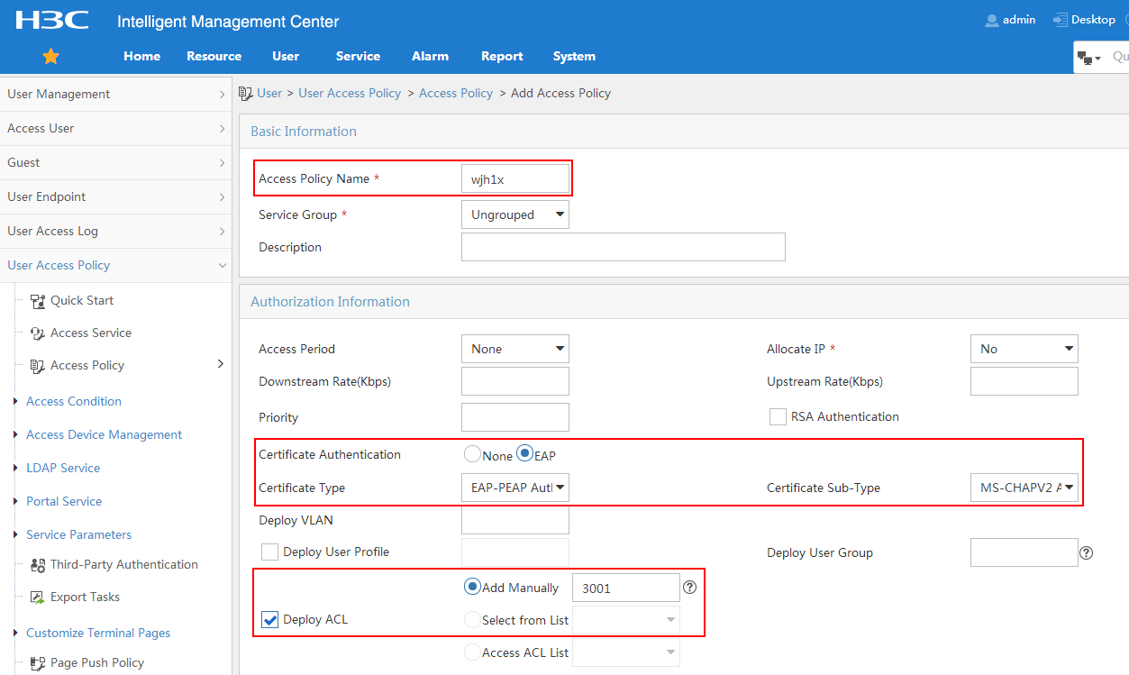

2.     Add an access policy:
a.     Click the User tab.
b.     From the navigation tree, select User Access Policy > Access Policy.
c.     Click Add.
d.     On the Add Access Policy page, configure the following parameters, as shown in Figure 3:
-     Enter wjh1x in the Access Policy Name field.
-     Select EAP for the Certificate Authentication field.
-     Select EAP-PEAP Auth from the Certificate Type list, and select MS-CHAPV2 Auth from the Certificate Sub-Type list.
-     Select Deploy ACL and Add Manually, and enter an ACL number that is the same as the ACL configured on the AC.
e.     Click OK.
Figure 3 Adding an access policy

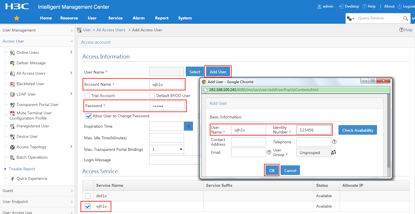

4.     Add an access user:
b.     From the navigation tree, select Access User > All Access Users.
The access user list opens.
c.     Click Add.
The Add Access User page opens.
d.     In the Access Information area, configure the following parameters, as shown in Figure 5:
-     Click Add User. On the dialog box that opens, enter wjh1x and 123456 in the User Name and Identity Number fields, respectively. Click Check Availability to verify the validity of the username and identity number, and then click OK.
-     Enter wjh1x in the Account Name field.
-     Enter 12345678 in the Password and Confirm Password fields.
e.     In the Access Service area, select wjh1x from the list.
f.     Click OK.
Figure 5 Adding an access user account
