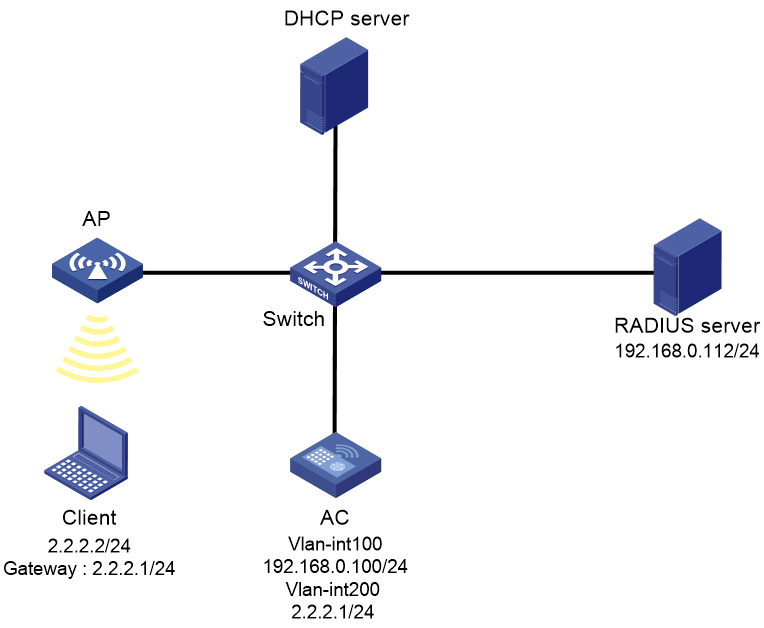

As shown in Figure 1, the AP and the client obtain IP addresses from the DHCP server.
· Configure the access device AC to also act as the portal Web server and the portal authentication server.
· Use the RADIUS server as both the authentication server and the authorization server.
· Configure direct portal authentication on the AC.
Analysis
To allow an authenticated user to access network resources on any Layer 2 ports in its access VLAN without re-authentication, you must enable the portal roaming feature.
To avoid possible authentication failure caused by frequent logins and logouts of portal clients in a short time, disable the Rule ARP entry feature.
To allow the RADIUS server to modify user authorization information and log out users, enable the RADIUS session-control feature.
Use the serial ID labeled on the AP's rear panel to specify an AP.
The portal authentication server type and portal Web server type configured on the AC must be the same as the types of the servers actually used. In this example, the server type is CMCC.
By default, the portal Web server URL redirected to users does carry parameters. You can configure the parameters to be carried in the redirection URL as needed.
To enable portal authentication on a VLAN interface, you must use the centralized forwarding mode. To enable portal authentication on a service template, you can use the centralized forwarding mode or the local forwarding mode. In this example, portal authentication is enabled on a service template.
Edit portal authentication pages, compress them to a .zip file (this example uses abc.zip), and then upload the file to the root directory of the storage medium of the AC. On the AC, you must specify this file as the default authentication page file.
To change the default authentication page file, you must first execute the undo default-logon-page command, and then specify a new default authentication page file.

1. Add an access device:
a. Log in to IMC and click the User tab.
b. From the navigation tree, select User Access Policy > Access Device Management > Access Device.
c. Click Add to open the Add Access Device page.
d. Configure the shared key as radius.
The shared key must be the same as that configured for the RADIUS server on the AC.
e. In the Device List area, click Add Manually to open the Add Access Device Manually page. Enter the start IP address 2.2.2.1 and click OK.
f. Use the default settings for other parameters on the Add Access Device page.
g. Click OK.
Figure 2 Adding an access device
2. Add an access policy:
a. From the navigation tree, select User Access Policy > Access Policy.
b. Click Add to open the Add Access Policy page.
c. Enter the policy name, select the service group, and use the default settings for other parameters.
d. Click OK.
Figure 3 Adding an access policy
3. Add an access service:
a. From the navigation tree, select User Access Policy > Access Service.
b. Click Add to open the Add Access Service page.
c. Enter the service name.
d. Select the access policy configured in the previous step as the default access policy.
e. Use the default settings for other parameters.
f. Click OK.
Figure 4 Adding an access service
4. Add an access user:
a. From the navigation tree, select Access User > All Access Users.
b. Click Add to open the Add Access User page.
c. Click Select to select an existing user or click Add User to add a new user.
d. Enter the account name.
e. Enter and confirm the password.
f. In the Access Service area, select the access service configured in the previous step.
g. Use the default settings for other parameters.
h. Click OK.
Figure 5 Adding an access user
# Use the configured username and password to perform portal authentication through a Web browser on the client. Before passing authentication, all Web accesses are redirected to the portal authentication page (http://2.2.2.1/portal). After passing authentication, you can access other network resources.
# Display the online portal user information on the AC.
[AC] display portal user all
Total portal users: 1
Username: Client
AP name: office
Radio ID: 2
SSID: service
Portal server:newpt
State: Online
VPN instance: N/A
MAC IP VLAN Interface
0024-d705-c686 2.2.2.2 200 WLAN-BSS1/0/2
Authorization information:
DHCP IP pool: N/A
User profile: N/A
Session group profile: N/A
ACL number: N/A
Inbound CAR: N/A
Outbound CAR: N/A
Configuration files
· AC:
vlan 100
vlan 200
wlan service-template st1
ssid service
vlan 200
client forwarding-location ac
akm mode psk
preshared-key pass-phrase cipher $c$3$9tIUHSkAUVqCH9/EPrL26ldkcEQnngexUEFj
cipher-suite ccmp
security-ie rsn
portal enable method direct
portal domain dm1
portal apply web-server newpt
service-template enable
interface Vlan-interface100
ip address 192.168.0.100 255.255.255.0
interface Vlan-interface200
ip address 2.2.2.1 255.255.255.0
port link-type trunk
port trunk permit vlan 1 100 200
radius session-control enable
radius scheme rs1
primary authentication 192.168.0.112
primary accounting 192.168.0.112
key authentication cipher $c$3$Sqgqz7lDs4XPnethmAgyAKVlke7qwEkYbQ==
key accounting cipher $c$3$4J/JBRGwqB4F213furJMkB6JWYXBFjWE6g==
user-name-format without-domain
nas-ip 2.2.2.1
domain dm1
authorization-attribute idle-cut 15 1024
authentication portal radius-scheme rs1
authorization portal radius-scheme rs1
accounting portal radius-scheme rs1
portal host-check enable
portal free-rule 1 destination ip any udp 53
portal free-rule 2 destination ip any tcp 53
portal roaming enable
undo portal refresh arp enable
portal web-server newpt
url http://2.2.2.1/portal
server-type cmcc
url-parameter wlanuserip source-address
portal local-web-server http
default-logon-page abc.zip
wlan ap-group group1
ap office
ap-model WA6320
radio 1
radio 2
radio enable
wlan ap office model WA6320
serial-id 219801A28N819CE0002T
· Switch:
vlan 100
vlan 200
port link-type access
port access vlan 100
poe enable
