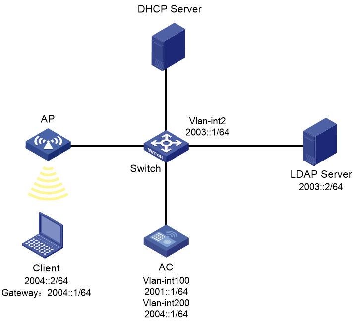

As shown in Figure 1, the AP and the client obtain IPv6 addresses from the DHCPv6 server.
Configure the local portal service on the AC to provide authentication pages for clients. Use the LDAP server to authenticate the clients.

1. Configuring VLANs and interfaces:
# Create VLAN 100 and VLAN-interface 100. Assign the VLAN interface an IPv6 address. This VLAN will be used to establish a CAPWAP tunnel with the AP.
<AC> system-view
[AC] vlan 100
[AC-vlan100] quit
[AC] interface vlan-interface 100
[AC-Vlan-interface100] ipv6 address 2001::1 64
# Disable RA message suppression.
[AC-Vlan-interface100] undo ipv6 nd ra halt
# Set the managed address configuration flag (M) to 1 in RA advertisements to be sent.
[AC-Vlan-interface100] ipv6 nd autoconfig managed-address-flag
# Set the other stateful configuration flag (O) to 1 in RA advertisements to be sent.
[AC-Vlan-interface100] ipv6 nd autoconfig other-flag
[AC-Vlan-interface100] quit
# Create VLAN 200 and VLAN-interface 200. Assign the VLAN interface an IPv6 address. This VLAN will be used for wireless client access.
[AC] vlan 200
[AC-vlan200] quit
[AC] interface vlan-interface 200
[AC-Vlan-interface200] ipv6 address 2004::1 64
[AC-Vlan-interface200] undo ipv6 nd ra halt
[AC-Vlan-interface200] ipv6 nd autoconfig managed-address-flag
[AC-Vlan-interface200] ipv6 nd autoconfig other-flag
[AC-Vlan-interface200] quit
# Configure GigabitEthernet 1/0/1 (the port connected to the switch) as a trunk port. Assign the port to VLAN 100 and VLAN 200.
[AC] interface gigabitethernet 1/0/1
[AC-GigabitEthernet1/0/1] port link-type trunk
[AC-GigabitEthernet1/0/1] port trunk permit vlan 100 200
[AC-GigabitEthernet1/0/1] quit

# Create VLAN 100. The switch will use this VLAN to forward traffic on the CAPWAP tunnel between the AC and AP.
<Switch> system-view
[Switch] vlan 100
[Switch-vlan100] quit
# Create VLAN 200. The switch will use this VLAN to forward traffic of wireless clients.
[Switch] vlan 200
[Switch-vlan200] quit
# Create VLAN 2. The switch will use this VLAN to connect to the LDAP server。
[Switch] vlan 2
[Switch-vlan2] quit
# Configure the interface between the switch and LDAP to join VLAN 2(Omitted here)
# Assign the VLAN interface an IPv6 address。
[Switch-Vlan-interface2] ip address 2003::1/64
[Switch-Vlan-interface2] quit
# Configure GigabitEthernet 1/0/1 (the port connected to the AC) as a trunk port. Assign the trunk port to VLAN 100 and VLAN 200.
[Switch] interface gigabitethernet1/0/1
[Switch-GigabitEthernet1/0/1] port link-type trunk
[Switch-GigabitEthernet1/0/1] port trunk permit vlan 100 200
[Switch-GigabitEthernet1/0/1] quit
# Configure GigabitEthernet 1/0/2 (the port connected to the AP) as an access port. Assign the access port to VLAN 100.
[Switch] interface gigabitethernet1/0/2
[Switch-GigabitEthernet1/0/2] port link-type access
[Switch-GigabitEthernet1/0/2] port access vlan 100
# Enable PoE on the access port.
[Switch-GigabitEthernet1/0/2] poe enable
[Switch-GigabitEthernet1/0/2] quit

The Active Directory Users and Computers window opens.
c. From the navigation tree, click Users under the ldap.com node.
d. Select Action > New > User from the menu to open the dialog box for adding a user.
e. Enter logon name aaa and click Next.
Figure 2 Adding user aaa
f. In the dialog box, enter password 123456, select options as needed, and click Next.
Figure 3 Setting the user's password
g. Click OK.
2. Add user aaa to user group Users:
a. From the navigation tree, click Users under the ldap.com node.
b. In the right pane, right-click user aaa and select Properties.
c. In the dialog box, click the Member Of tab and click Add.
Figure 4 Modifying user properties
d. In the Select Groups dialog box, enter Users in the Enter the object names to select field, and click OK.
User aaa is added to group Users.
Figure 5 Adding user aaa to group Users
3. Configure the administrator password:
a. In the right pane, right-click user Administrator and select Set Password.
b. In the dialog box, enter the administrator password. (Details not shown.)
# Open a Web browser such as IE on the wireless client. Type an IPv6 address in the address bar and press Enter. The portal authentication page opens. Enter username aaa and password 123456 and then click Logon. User aaa passes authentication successfully.
# Display online portal users on the AC.
<AC> display portal user all
Total portal users: 1
Username: aa
AP name: ap1
Radio ID: 2
SSID: service
Portal server: N/A
State:Online
VPN instance: N/A
MAC IP Vlan Interface
2477-0341-f118 2004::2 200 WLAN-BSS1/0/19
Authorization information:
DHCP IP pool: N/A
User profile: N/A
Session group profile: N/A
ACL number: N/A
Inbound CAR: N/A
Outbound CAR: N/A
Configuration files
· AC:
vlan 100
vlan 200
wlan service-template st1
ssid service
client forwarding-location ac
akm mode psk
preshared-key pass-phrase simple 12345678
cipher-suite ccmp
security-ie rsn
vlan 200
portal ipv6 enable method direct
portal ipv6 domain ldap
portal ipv6 apply web-server newpt
portal dual-stack enable
service-template enable
interface Vlan-interface100
ipv6 address 2001::1/64
interface Vlan-interface200
ipv6 address 2004::1/64
ldap server ldap
login-dn cn=administrator,cn=users,dc=ldap,dc=com
search-base-dn dc=ldap,dc=com
ipv6 2003::2
login-password cipher $c$3$CEz2vKCnA2/51D8rFc/+nTNtOx8Gan+81Q==
ldap scheme ldap
authentication-server ldap
domain ldap
authorization-attribute idle-cut 15 1024
authentication portal ldap-scheme ldap
authorization portal none
accounting portal none
portal host-check enable
portal free-rule 1 destination ip any udp 53
portal free-rule 2 destination ip any tcp 53
portal web-server newpt
url http://[2004::1]/portal
portal local-web-server http
default-logon-page abc.zip
wlan ap ap1 model WA6320
serial-id 219801A28N819CE0002T
wlan ap-group group1
ap ap1
ap-model WA6320
radio 2
radio enable
vlan 100
vlan 200
vlan 2
ipv6 address 2003::1/64
port link-mode bridge
poe enable
