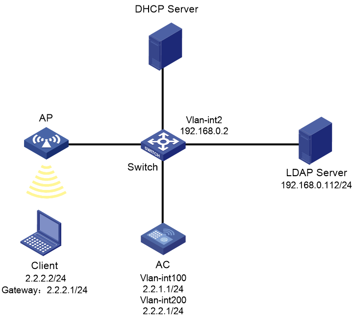

As shown in Figure 1, the AP and the client obtain IP addresses from the DHCP server.
Configuration requirements are as follows:
· Configure the local portal service on the AC to provide authentication pages for clients.
· Use the LDAP server to authenticate the clients.
Configure routing to make sure the devices can reach one another.
Use the serial ID labeled on the AP's rear panel to specify an AP.
