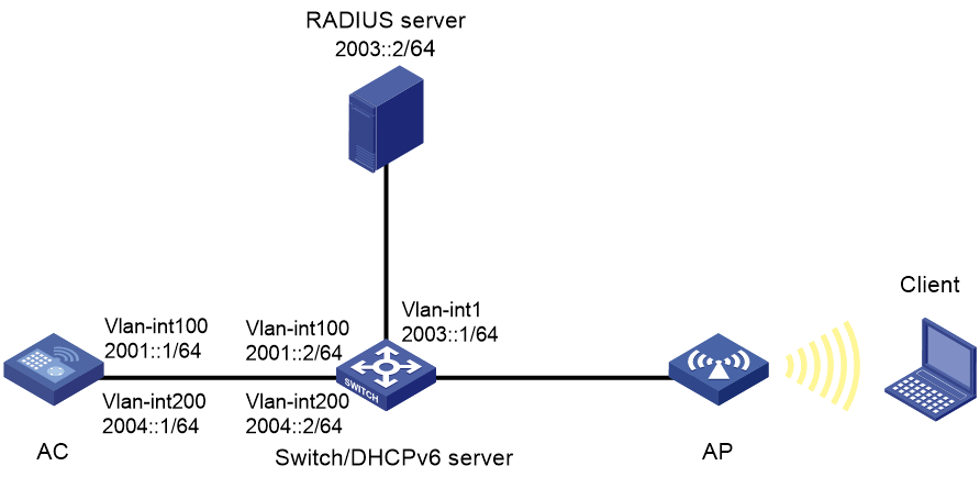

As shown in Figure 1, the switch acts as a DHCPv6 server to assign IPv6 addresses to the AP and the client. IMC acts as the RADIUS server.
Configure the AC, the client, the switch, and the RADIUS server to meet the following requirements:
·     The AC uses the RADIUS server to perform 802.1X authentication for the wireless client.
·     The AC uses the open system authentication for the client at the data link layer. This is the default authentication method.
·     The AC uses the 802.1X AKM mode to secure data transmission between the client and the AP.
·     The cipher suite is CCMP.
Figure 1 Network diagram

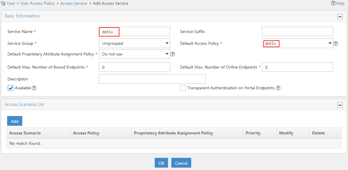

2.     Add an access policy:
a.     Click the User tab.
b.     From the navigation tree, select User Access Policy > Access Policy.
c.     Click Add.
d.     On the Add Access Policy page, configure the following parameters, as shown in Figure 3:
-     Enter dot1x in the Access Policy Name field.
-     Select EAP for the Certificate Authentication field.

3.     Add an access service:
b.     From the navigation tree, select User Access Policy > Access Service.
c.     Click Add.
d.     On the Add Access Service page, configure the following parameters, as shown in Figure 4:
-     Enter dot1x in the Service Name field.
-     Select dot1x from the Default Access Policy list.
e.     Click OK.
Figure 4 Adding an access service
