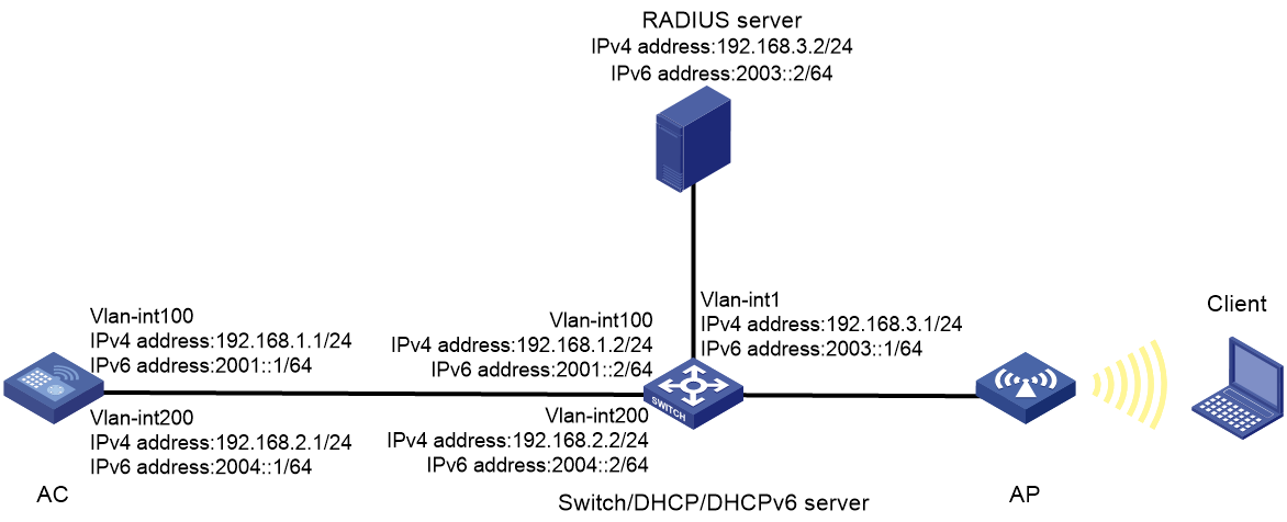

Example: Configuring local IPv6 portal authentication
As shown in Figure 1, the switch acts as the DHCP server and the DHCPv6 server. The AP and the client obtain IPv4 addresses and IPv6 addresses from the switch.
· Configure the access device AC to also act as the portal Web server and the portal authentication server.
· Use the RADIUS server as both the authentication server and the authorization server.
· Configure direct portal authentication on the AC.

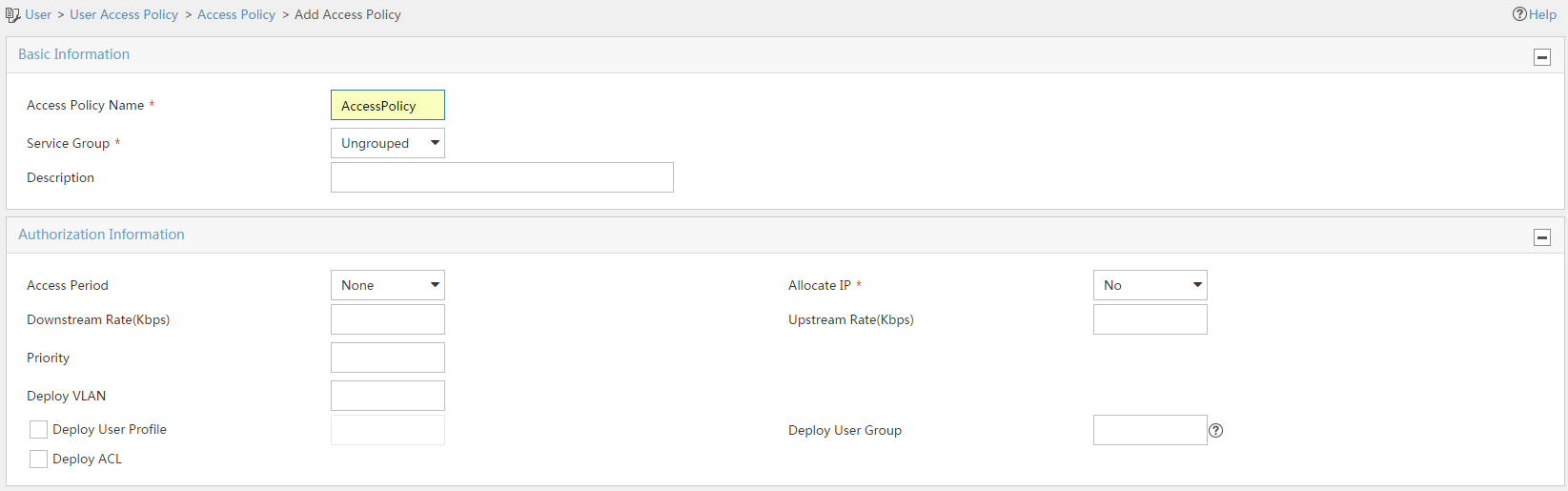

2. Add an access policy:
a. From the navigation tree, select User Access Policy > Access Policy.
b. Click Add.
The Add Access Policy page opens.
c. Enter the policy name.
d. Select a service group.
e. Use the default settings for other parameters.
f. Click OK.
Figure 3 Adding an access policy

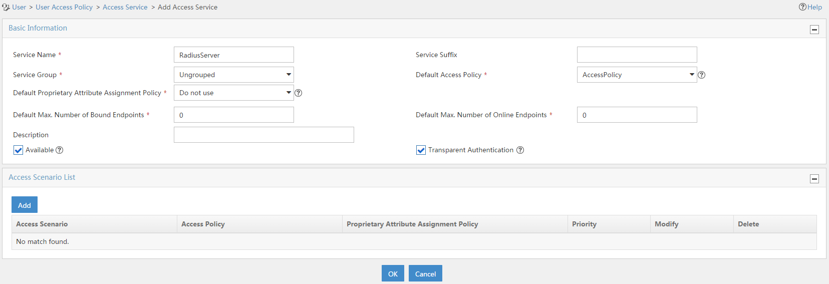

3. Add an access service:
a. From the navigation tree, select User Access Policy > Access Service.
b. Click Add.
The Add Access Service page opens.
c. Enter the service name.
d. Select the access policy configured in the previous step as the default access policy.
f. Click OK.
Figure 4 Adding an access service
