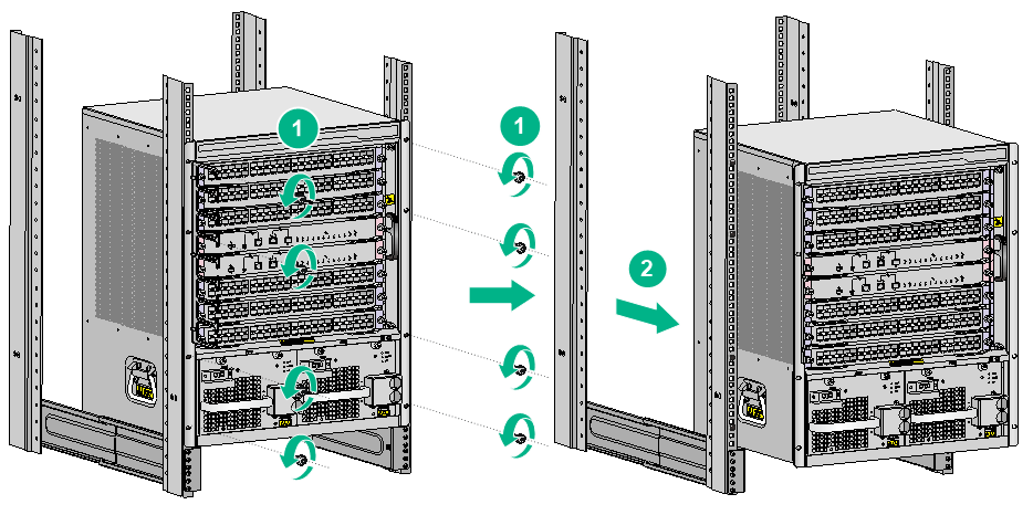

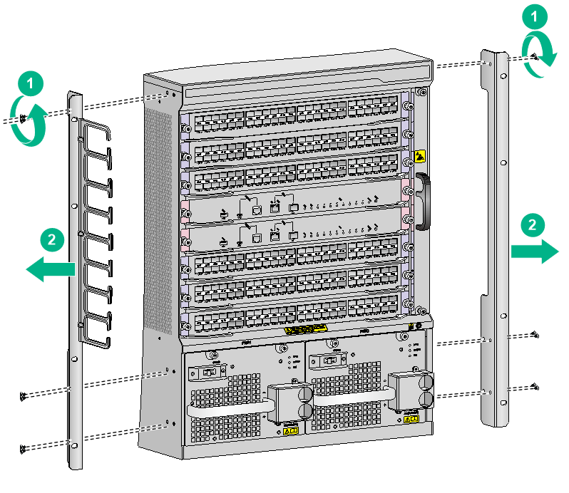

Replacing mounting brackets
1. Remove the screws that secure the chassis to the rack.
2. Cooperate with one or more people to lift the chassis by holding chassis handles or by supporting the chassis bottom. Pull out the chassis along the guide rails until the space is enough for replacing the mounting brackets.
Figure 5-1 Pulling out the chassis (S7506X-G switch)
3. Remove the mounting brackets, as shown in Figure 5-2.
Figure 5-2 Removing mounting brackets (S7506X-G switch)
4. Install the new mounting brackets. For more information about how to install mounting brackets, see "Installing mounting brackets and cable management bracket."
5. Cooperate with one or more people to push the chassis back to the rack, and fasten the screws to secure the chassis to the rack. For more information, see "Mounting the switch in the rack."

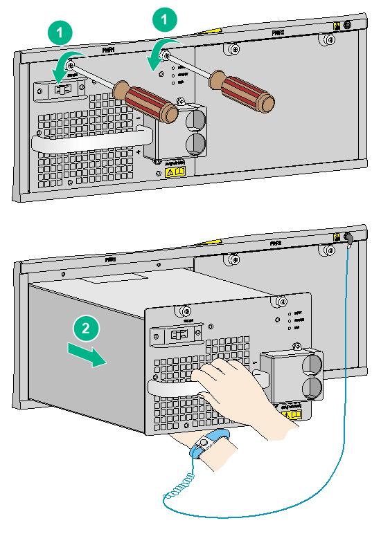

Replacing a power module adapter
1. Prepare an antistatic mat to place the removed power module adapter.
2. Wear an ESD wrist strap and make sure it makes good skin contact and is reliably grounded. For more information, see "Attaching an ESD wrist strap."
3. Use a Phillips screwdriver to loosen the captive screws on the power module adapter.
4. Holding the power module adapter handle with one hand, pull it part way out of the slot. Supporting the adapter bottom with the other, pull it slowly out of the slot.
5. Place the power module adapter on the antistatic mat.
6. Install a new power module adapter in the slot. For the installation procedure, see "Installing a power module adapter."
Figure 5-3 Removing a power module adapter

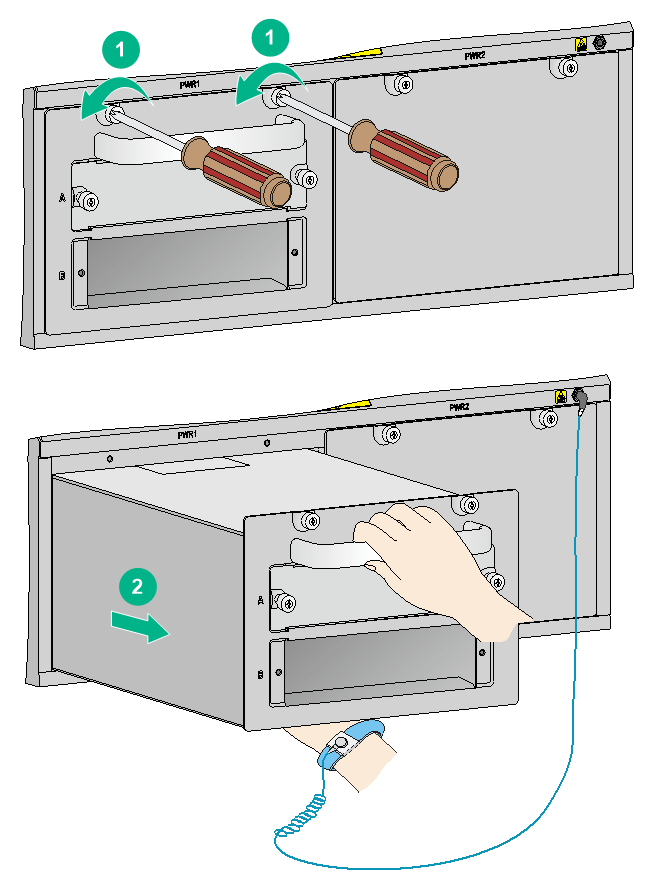

WARNING! · Do not install AC and DC power modules on the same switch. Do not install power modules of different models on the same switch. To avoid damage to the switch, power off the switch before you replace the two power modules with a different model. · When you use two power modules to supply power to the switch, make sure each power module has a separate circuit breaker. Before replacing a power module, turn off the circuit breaker on the power module. · To avoid device damage and bodily injury, strictly follow the procedure in Figure 5-4 and Figure 5-5 to remove and install a power module, respectively. |
Figure 5-4 Power module removal flow
Figure 5-5 Power module installation flow
To replace a power module:
1. Prepare an antistatic mat to place the removed power module.
2. Wear an ESD wrist strap and make sure it has a good skin contact and is reliably grounded. For more information, see "Attaching an ESD wrist strap."
3. Turn off the switch on the power module.
4. Remove the cable from the power module.
5. Use a Phillips screwdriver to loosen the captive screw on the power module, as shown by callout 1 in Figure 5-6.
6. Holding the power module handle with one hand and supporting the bottom of the power module with the other, gently pull the power module out, as shown by callout 2 in Figure 5-6.
7. Put the removed power module on the antistatic mat.
8. Install a new power module. For the installation procedures, see "Installing a power module."
After removing the power module, if you do not install a new power module, install a filler panel. As shown by callout 3 in Figure 5-6, align the screws on the filler panel with the screw holes on the switch, and then use a screwdriver to fasten the screws on the filler panel.
Figure 5-6 Removing the power module

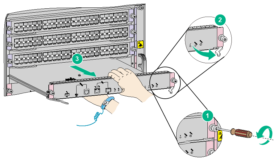

Replacing a card
IMPORTANT: Before removing a card, remove the cables from it. |
The replacement procedure is similar for the cards.
To replace a card:
1. Prepare an antistatic mat to place the removed card.
2. Wear an ESD wrist strap and make sure it has a good skin contact and is correctly grounded. For more information, see "Attaching an ESD wrist strap."
3. Use a Phillips screwdriver to remove the captive screw on the card, as shown by callout 1 in Figure 5-7.
4. Move the ejector levers outwards to separate the card from the backplane, as shown by callout 2 in Figure 5-7.
5. Use one hand to slowly move the card outwards. Supporting the bottom of the card with the other hand, pull the card out of the slot along slide rails, as shown by callout 3 in Figure 5-7.
6. Put the removed card on the antistatic mat.
7. Install a new card. For the installation procedures, see "Installing cards."
If you are not to install a new card, install a filler panel in the slot to ensure heat dissipation of the switch and prevent dust from entering the switch.

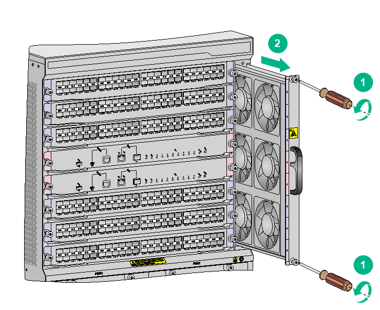

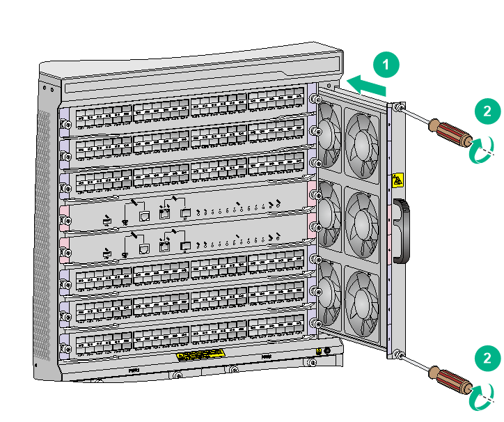

Replacing a fan tray
CAUTION: · When replacing a fan tray, do not touch the rotating fans to avoid bodily injury. · To ensure correct operation of the switch, install a new fan tray within five minutes after the fan tray is removed. |
NOTE: To examine fan status, use the display fan command. For more information, see H3C S7500X-G Switch Series Fundamentals Command Reference. |
Removing a fan tray
1. Prepare an antistatic mat to place the removed fan tray.
3. Use a screwdriver to remove the captive screw on the fan tray, as shown by callout 1 in Figure 5-8.
4. As shown by callout 2 in Figure 5-8, hold the handle of the fan tray to pull the fan tray out of the slot.
5. Put the removed fan tray on an antistatic mat or its original shipping materials.
Figure 5-8 Removing a fan tray

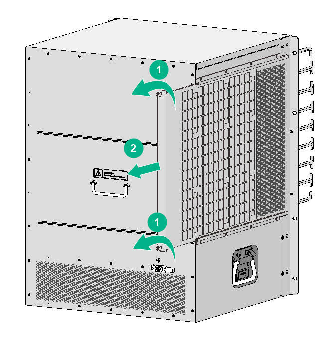

Replacing an air filter
CAUTION: Clean air filters every three months to guarantee adequate ventilation and avoid over-temperature. |
To replace an air filter:
1. Loosen the captive screw on the air filter, as shown by callout 1 in Figure 5-10.
2. Seize the captive screws on the air filter and slowly pull the air filter out of the chassis, as shown by callout 2 in Figure 5-10.
3. Install the cleaned air filter to the switch. For the installation procedures, see "(Optional) Installing an air filter."
Figure 5-10 Removing an air filter

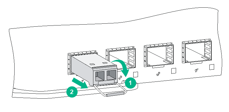

Replacing an SFP+/SFP/QSFP+/QSFP28 module
CAUTION: · Do not touch the golden plating on a transceiver module during the replacement process. · After removing a transceiver module, you must wait a minimum of 5 seconds before installing a new transceiver module. · Make sure the new transceiver module is the same model as the peer transceiver module at the other end of the optical fiber. |
The replacement procedure is similar for SFP+ modules, SFP modules, QSFP+ modules, and QSFP28 modules. The following procedure replaces an SFP+ module.
To replace an SFP+ module:
1. Wear an ESD wrist strap and make sure it has a good skin contact and is reliably grounded. For more information, see "Attaching an ESD wrist strap."
2. Remove the optical fibers from the module.
There is a latching mechanism between a fiber connector and transceiver module bore to prevent connector disengagement. Release the latching before removing the optical fiber. To avoid damages, do not use excessive force.
3. Pivot the bail latch down to the horizontal position.
For QSFP+ and QSFP28 modules that use a plastic pull latch, skip this step.
4. Hold the bail latch to pull the module out of the slot.
5. Insert the dust plugs into the removed module, and put the module into its packaging bag. Make sure you apply force in the direction parallel to the ground. To avoid damaging the bail latch, do not use excessive force.
If you apply force at an angle when pulling the module out, you can hardly pull the module out and the module or fiber port might be damaged.
6. Install a new module. For the installation procedure, see "Installing an SFP+/SFP/QSFP+/QSFP28 module."
Figure 5-11 Removing an SFP+ transceiver module
