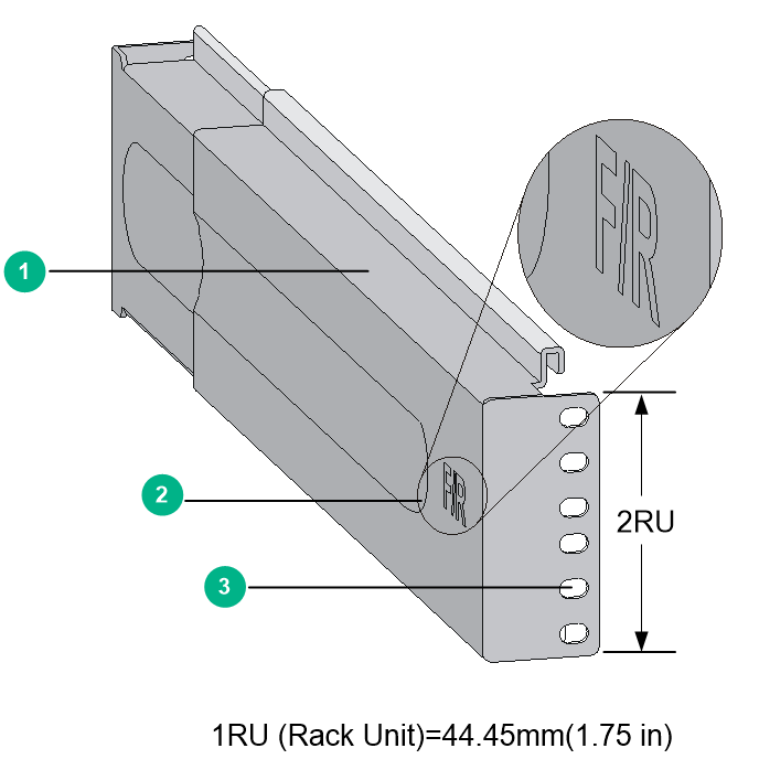

1. Read the signs on the slide rails (see Table 2-2) to avoid installation mistakes.
Figure 2-2 Right slide rail
(1) Guide rail |
(2) Sign |
(3) Installation hole |
Table 2-2 Description for signs on the slide rails
Sign |
Meaning |
Remarks |
F/L |
Front end of the left slide rail |
Mount this end to the front left rack post. |
F/R |
Front end of the right slide rail |
Mount this end to the front right rack post. |

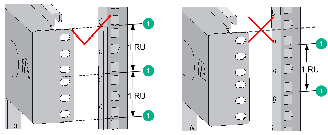

2. Mark the position on the rack for installing the slide rail.
¡ Make sure the bottom edge of the slide rail aligns with the middle of the narrower metal area between holes on a rack post, as shown in Figure 2-3.
¡ Each rack post requires six screws to secure the slide rail. You only need to mark the uppermost square hole and lowermost square hole for installation.
¡ Mark the square holes at the same height on the other three rack posts.
NOTE: One rack unit has three holes, the middle of which is an auxiliary installation hole, and the other two are standard installation holes. You can distinguish them by the space between each two holes. The space between a standard installation hole and an auxiliary installation hole is larger than the space between two adjacent standard installation holes. |
Figure 2-3 Locating the position on the rack for installing the slide rail
(1) Middle of the narrower metal area between holes |

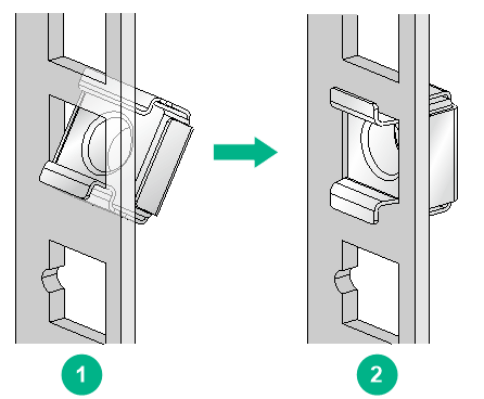

3. Install six cage nuts on the square holes in each rack post, as shown in Figure 2-4.
Figure 2-4 Installing a cage nut

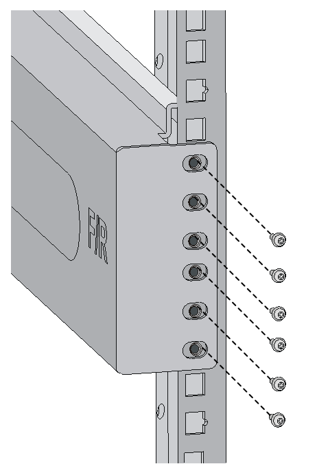

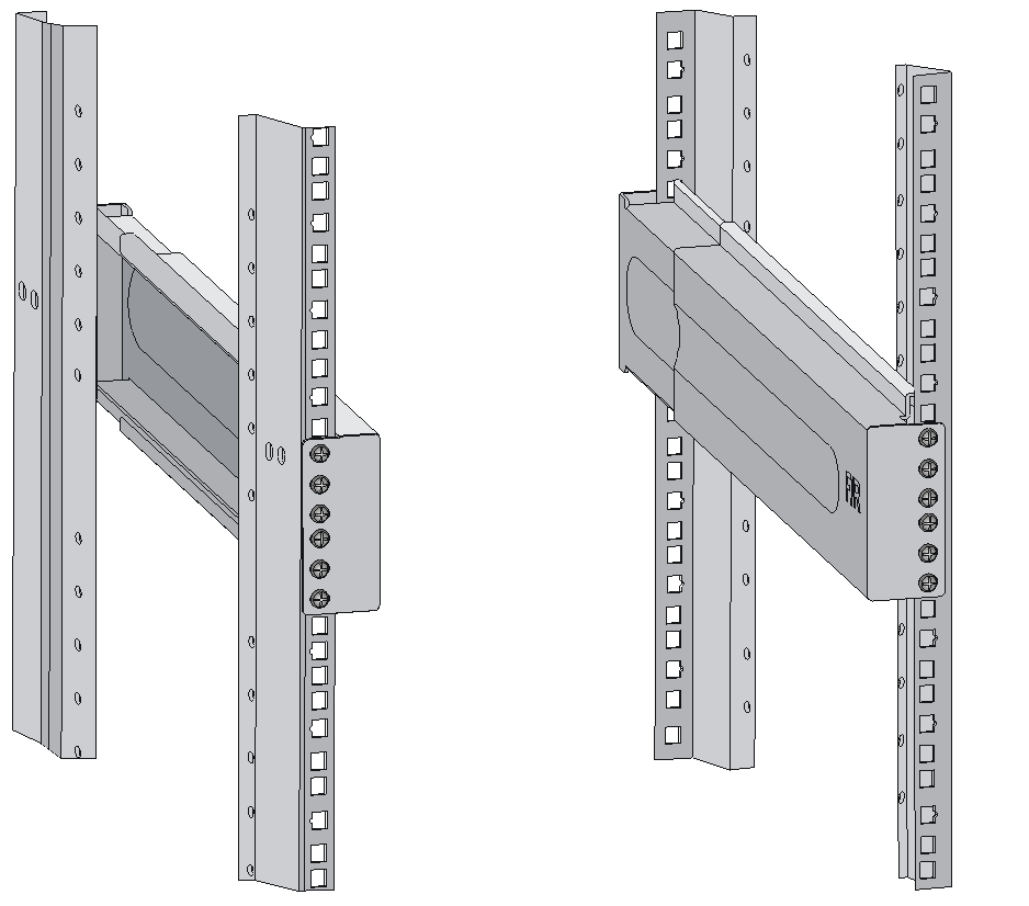

4. Align the installation holes on the front end of a slide rail with the cage nuts on the front rack post, and secure them with screws, as shown in Figure 2-5.
Figure 2-5 Attaching a slide rail to a front rack post
5. Keep the slide rail horizontally and adjust its length until the installation holes on the rear end of the slide rail touch the cage nuts on the rear rack post. Then fasten the screws.
TIP: Install a screw in each mounting hole of the slide rail to ensure its weight bearing capacity. |
6. Repeat step 4 and step 5 to install the other slide rail. Make sure the two slide rails are at the same height so the device can be placed on them horizontally.
Figure 2-6 Installed slide rails
Installing cage nuts for attaching mounting brackets

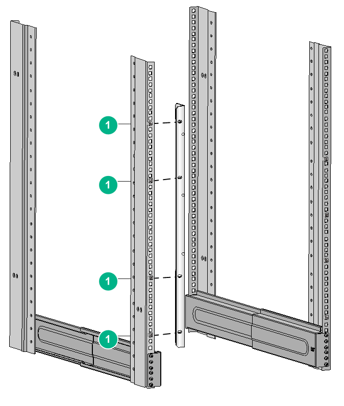

1. Determine and mark the cage nut installation holes on the front rack posts ,as shown in Figure 2-7.
2. Install cage nuts, as shown in Figure 2-4.
Figure 2-7 Installing cage nuts (S7506X-G switch)

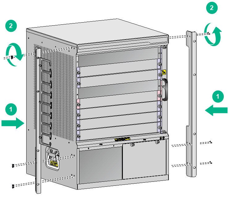

Installing mounting brackets and cable management bracket
Before installing the switch in the rack, attach the mounting brackets and cable management bracket (shipped with the chassis) to the switch. The mounting brackets are used for attaching the chassis to the rack, and the cable management bracket is used for cabling the switch.
To attach the mounting brackets and cable management bracket to the switch:
1. Attach the cable management bracket to the left mounting bracket, as shown in Figure 2-9.
Figure 2-8 Attaching the cable management bracket to the left mounting bracket
2. Facing the front of the switch, mount the mounting bracket with the cable management bracket to the left of the switch, and mount the other mounting bracket to the right of the switch (where the fan tray is located).
Figure 2-9 Attaching the mounting brackets to the chassis (S7506X-G switch)

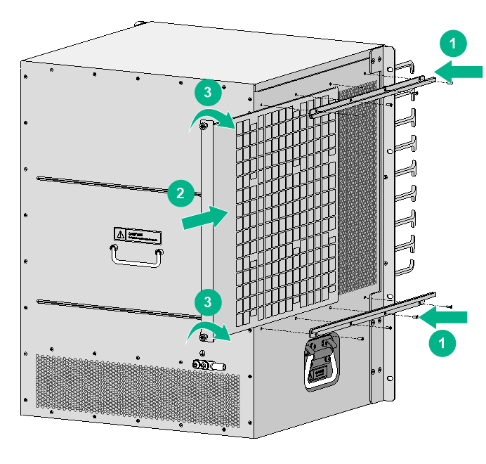

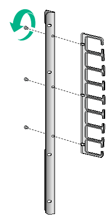

(Optional) Installing an air filter
Air filters are optional components for the switch. If you have ordered an air filter, attach it to the left of the chassis before mounting the switch in the rack.
1. Unpack the air filter and fastening strips.
2. Align the screw holes in the fastening strip with the screw holes in the chassis, insert the screws into the screw holes, and then fasten the screws clockwise with a screwdriver, as shown by callout 1 in Figure 2-10.
3. Push the air filter in between the fastening strips, as shown by callout 2 in Figure 2-10.
4. Fasten the captive screws, as shown by callout 3 in Figure 2-10.
Figure 2-10 Installing an air filter (S7506X-G switch)

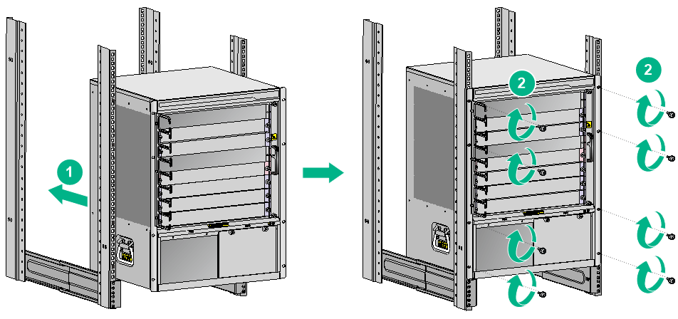

Mounting the switch in the rack
CAUTION: · Do not hold the handle of the fan tray, power module, or the back cover of the chassis, or the air vents of chassis to move the switch. Any attempt to carry the switch with these parts might cause equipment damage or even bodily injury. · Use a mechanical lift for switches of a high weight. · After placing the switch on the slide rails, do not leave go of your hands immediately because this might tip and damage the switch, and even cause bodily injury. |
To mount the switch in the rack:
1. Face the rear of the chassis towards the front of the rack.
2. Use a minimum of two people to lift the switch until the bottom of the switch is a little higher than the slide rails on the rack.
3. Place the switch on the slide rails and slide the switch along the slide rails until the mounting brackets on the switch touch the front rack posts.
4. Secure the chassis to the rack with mounting screws.
Figure 2-11 Installing the chassis in the rack (S7506X-G switch)
NOTE: If the screw holes in the mounting brackets cannot align with the cage nuts on the rack, verify that the bottom edge of the slide rail aligns with the middle of the narrowest metal area between holes and that the cage nuts are installed in the correct holes. |

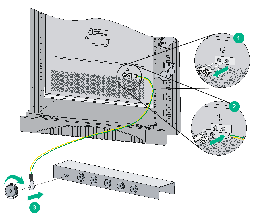

Connecting the grounding cable to a grounding strip
CAUTION: · Connect the grounding cable to the earthing system in the equipment room. Do not connect it to a fire main or lightning rod. · To guarantee the grounding effect, use the grounding cable provided with the switch. The grounding cable uses a two-hole lug for connecting the chassis and a ring terminal for connecting the grounding strip. It is compliant with the NEBS standard. |
When a grounding strip is available at the installation site, you can ground the switch by connecting the grounding cable to the grounding strip.
To connect the grounding cable to a grounding strip:
1. Unpack the grounding cable.
2. Remove the grounding screws from the grounding holes at the rear of the chassis.
3. Use grounding screws to attach the two-hole grounding lug of the grounding cable to the chassis.
Figure 2-12 Connecting the grounding cable to a grounding strip

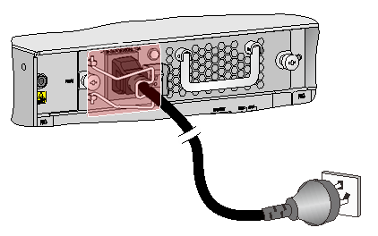

Grounding the switch through an AC power cord
CAUTION: · Make sure the AC power supply uses a three-wire cable with a protection wire, and the AC power cord is reliably grounded at the power distribution room or AC power supply transformer side. · Make sure the AC receptacle on the switch is correctly connected to the AC power supply. |
If the switch is AC powered and no grounding strip is available at the installation site, you can ground the switch through an AC power cord, as shown in Figure 2-13.
Figure 2-13 Grounding the switch through an AC power cord

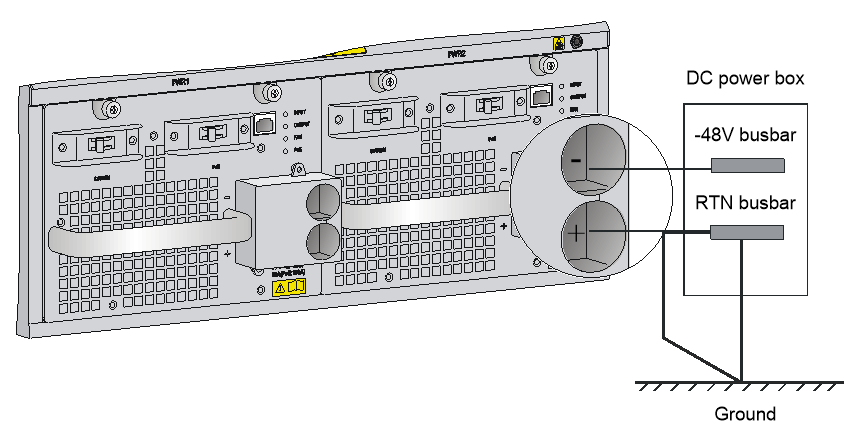

Grounding the switch through the RTN wire of a DC power cord
CAUTION: Make sure the RTN busbar in the equipment room is reliably grounded. |
If the switch is powered by a –48 VDC power supply and no grounding strip is available at the installation site, you can ground the switch through the return (RTN) wire of a DC power cord, as shown in Figure 2-14.
Figure 2-14 Grounding the switch through the RTN wire of a DC power cord
