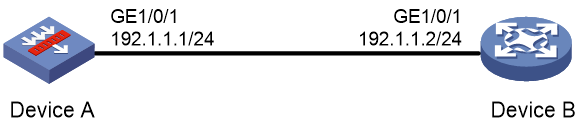

As shown in Figure 1, establish an OSPF neighbor relationship between Device A and Device B, and use a keychain to authenticate packets between the devices. Configure key 1 and key 2 for the keychain and make sure key 2 is used immediately when key 1 expires.
Figure 1 Network diagram

     MD5                : 3
     HMAC-SM3           : 52
     SM3                : 51
   Default send key ID  : None
   Active send key ID   : 1
   Active accept key IDs: 1
   Key ID               : 1
     Key string         : $c$3$/G/Shnh6heXWprlSQy/XDmftHa2JZJBSgg==
     Algorithm          : md5
     Send lifetime      : 10:00:00 2015/02/06 to 11:00:00 2015/02/06
     Send status        : Active
     Accept lifetime    : 10:00:00 2015/02/06 to 11:00:00 2015/02/06
     Accept status      : Active
   Key ID               : 2
     Key string         : $c$3$t4qHAw1hpZYN0JKIEpXPcMFMVT81u0hiOw==
     Algorithm          : hmac-md5
     Send lifetime      : 11:00:00 2015/02/06 to 12:00:00 2015/02/06
     Send status        : Inactive
     Accept lifetime    : 11:00:00 2015/02/06 to 12:00:00 2015/02/06
     Accept status      : Inactive
2.     When the system time is within the lifetime from 11:00:00 to 12:00:00 on the day 2015/02/06, verify the status of the keys in keychain abc.
# Display keychain information on Device A. The output shows that key 2 becomes the valid key.
[DeviceA]display keychain
 Keychain name          : abc
   Mode                 : absolute
   Accept tolerance     : 0
   TCP kind value       : 254
   TCP algorithm value
     HMAC-MD5           : 5
     HMAC-SHA-256       : 7
     MD5                : 3
     HMAC-SM3           : 52
     SM3                : 51
   Active send key ID   : 2
   Active accept key IDs: 2
   Key ID               : 1
     Key string         : $c$3$dYTC8QeOKJkwFwP2k/rWL+1p6uMTw3MqNg==
     Algorithm          : md5
   Key ID               : 2
     Key string         : $c$3$7TSPbUxoP1ytOqkdcJ3K3x0BnXEWl4mOEw==
# Display keychain information on Device B. The output shows that key 2 becomes the valid key.
[DeviceB]display keychain
Keychain name          : abc
   Mode                 : absolute
   TCP algorithm value
     HMAC-MD5           : 5
     HMAC-SHA-256       : 7
     MD5                : 3
     HMAC-SM3           : 52
     SM3                : 51
   Key ID               : 1
     Algorithm          : md5
   Key ID               : 2
