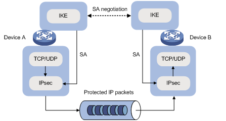

IPsec implementation
To implement IPsec protection for packets between two peers, complete the following tasks on each peer:
·     Configure an IPsec policy, which defines the range of packets to be protected by IPsec and the security parameters used for the protection.
·     Apply the IPsec policy to an interface or an application.
When you apply an IPsec policy to an interface, you implement IPsec based on the interface. Packets received and sent by the interface are protected according to the IPsec policy. When you apply an IPsec policy to an application, you implement IPsec based on the application. Packets of the application are protected according to the IPsec policy, regardless of the receiving and sending interface of the packets.
IPsec protects packets as follows:
·     When an IPsec peer identifies the packets to be protected according to the IPsec policy, it sets up an IPsec tunnel and sends the packet to the remote peer through the tunnel. The IPsec tunnel can be manually configured beforehand, or it can be set up through IKE negotiation triggered by the packet. The IPsec tunnels are actually the IPsec SAs. The inbound packets are protected by the inbound SA, and the outbound packets are protected by the outbound SA.
·     When the remote IPsec peer receives the packet, it drops, de-encapsulates, or directly forwards the packet according to the configured IPsec policy.
Interface-based IPsec can be further divided into ACL-based IPsec and tunnel interface-based IPsec.

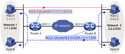

ACL-based IPsec
To implement ACL-based IPsec, configure an ACL to define the data flows to be protected, specify the ACL in an IPsec policy, and then apply the IPsec policy to an interface. When packets sent by the interface match a permit rule of the ACL, the packets are protected by the outbound IPsec SA and encapsulated with IPsec. When the interface receives an IPsec packet destined for the local device, it searches for the inbound IPsec SA according to the SPI in the IPsec packet header for de-encapsulation. If the de-encapsulated packet matches a permit rule of the ACL, the device processes the packet. If the de-encapsulated packet does not match any permit rule of the ACL, the device drops the packet.
The device supports the following data flow protection modes:
·     Standard mode—One IPsec tunnel protects one data flow. The data flow permitted by an ACL rule is protected by one IPsec tunnel that is established solely for it.
·     Aggregation mode—One IPsec tunnel protects all data flows permitted by all the rules of an ACL. This mode is only used to communicate with old-version devices.
·     Per-host mode—One IPsec tunnel protects one host-to-host data flow. One host-to-host data flow is identified by one ACL rule and protected by one IPsec tunnel established solely for it. This mode consumes more system resources when multiple data flows exist between two subnets to be protected.

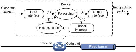

Figure 4 Tunnel interface encapsulation
As shown in Figure 4, a tunnel interface encapsulates an IP packet as follows:
1.     Upon receiving a clear text packet, the input interface sends the packet to the forwarding module for routing.
2.     If the packet requires to be IPsec-protected, the forwarding module sends the packet to the tunnel interface.
3.     The tunnel interface encapsulates the packet into a new IP packet. The source and destination IP addresses in the new IP header are the source and destination IP addresses of the tunnel interface. Then, the tunnel interface sends the packet back to the forwarding module.
4.     The forwarding module looks up the routing table again and sends the packet out of the physical interface of the tunnel interface.

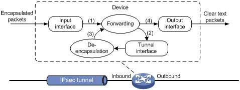

Figure 5 Tunnel interface de-encapsulation
As shown in Figure 5, a tunnel interface de-encapsulates an IP packet as follows:
1.     Upon receiving an encapsulated packet, the inbound interface sends the packet to the forwarding module for routing.
2.     Because the packet is destined for the source IP address of the tunnel interface and the payload protocol is AH or ESP, the forwarding module sends the packet to the tunnel interface.
3.     The tunnel interface de-encapsulates the packet (removes the outer IP header) and sends the de-encapsulated packet back to the forwarding module.
4.     The forwarding module looks up the routing table again and sends the packet out of the output interface.

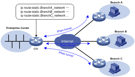

IPsec RRI

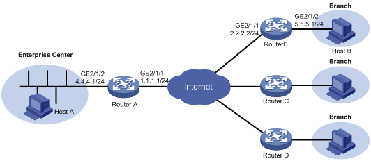

As shown in Figure 6, the traffic between the enterprise center and the branches are protected by IPsec. The gateway at the enterprise center is configured with static routes to route traffic to the IPsec-protected interfaces. It is difficult to add or modify static routes on the gateway at the enterprise center if the IPsec VPN has a large number of branches or if the network structure changes.
Figure 6 IPsec VPN
IPsec Reverse Route Injection (RRI) enables an IPsec tunnel gateway to automatically add static routes destined for protected private networks or static routes destined for peer IPsec tunnel gateways to a routing table. As shown in Figure 6, you can enable IPsec RRI on the gateway at the enterprise center. After an IPsec tunnel is established, the gateway automatically adds a static route to the routing table, which can be looked up. The destination IP address is the protected private network. The next hop IP address can be the remote IP address of the IPsec tunnel (default) or a user-defined next hop IP address. Traffic destined for the peer end is routed to the IPsec tunnel and thereby protected by IPsec.
You can advertise the static routes created by IPsec RRI in the internal network, and the internal network device can use them to forward traffic in the IPsec VPN.
In an MPLS L3VPN network, IPsec RRI can add static routes to VPN instances' routing tables.
IPsec RRI is applicable to gateways that must provide many IPsec tunnels (for example, a headquarters gateway).

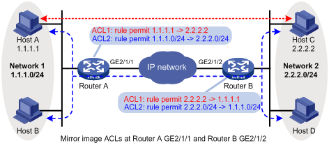

Mirror image ACLs
To make sure SAs can be set up and the traffic protected by IPsec can be processed correctly between two IPsec peers, create mirror image ACLs on the IPsec peers. As shown in Figure 7, ACL rules on Router B are mirror images of the rules on Router A. In this way, SAs can be created successfully for the traffic between Host A and Host C and for the traffic between Network 1 and Network 2.
Figure 7 Mirror image ACLs
If the ACL rules on IPsec peers do not form mirror images of each other, SAs can be set up only when both of the following requirements are met:
·     The range specified by an ACL rule on one peer is covered by its counterpart ACL rule on the other peer. As shown in Figure 8, the range specified by the ACL rule configured on Router A is covered by its counterpart on Router B.
·     The peer with the narrower rule initiates SA negotiation. If a wider ACL rule is used by the SA initiator, the negotiation request might be rejected because the matching traffic is beyond the scope of the responder. As shown in Figure 8, the SA negotiation initiated by Host A to Host C is accepted but the SA negotiations from Host C to Host A, from Host C to Host B, and from Host D to Host A are rejected.
Figure 8 Non-mirror image ACLs

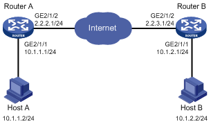

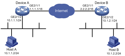

IPsec configuration examples
Configuring a manual mode IPsec tunnel for IPv4 packets
Network requirements
As shown in Figure 10, establish an IPsec tunnel between Router A and Router B to protect data flows between subnet 10.1.1.0/24 and subnet 10.1.2.0/24. Configure the tunnel as follows:
·     Specify the encapsulation mode as tunnel, the security protocol as ESP, the encryption algorithm as 128-bit AES, and the authentication algorithm as HMAC-SHA1.
·     Manually set up IPsec SAs.
Figure 10 Network diagram
Configuration procedure
1.     Configure Router A:
# Configure IP addresses for interfaces. (Details not shown.)
# Configure an IPv4 advanced ACL to identify data flows from subnet 10.1.1.0/24 to subnet 10.1.2.0/24.
<RouterA> system-view
[RouterA] acl advanced 3101
[RouterA-acl-ipv4-adv-3101] rule permit ip source 10.1.1.0 0.0.0.255 destination 10.1.2.0 0.0.0.255
[RouterA-acl-ipv4-adv-3101] quit
# Configure a static route to Host B. The command uses the direct next hop address (2.2.2.3) as an example.
[RouterA] ip route-static 10.1.2.0 255.255.255.0 gigabitethernet 2/1/2 2.2.2.3
# Create an IPsec transform set named tran1.
[RouterA] ipsec transform-set tran1
# Specify the encapsulation mode as tunnel.
[RouterA-ipsec-transform-set-tran1] encapsulation-mode tunnel
# Specify the security protocol as ESP.
[RouterA-ipsec-transform-set-tran1] protocol esp
# Specify the ESP encryption and authentication algorithms.
[RouterA-ipsec-transform-set-tran1] esp encryption-algorithm aes-cbc-128

Configuring an IKE-based IPsec tunnel for IPv4 packets
As shown in Figure 11, establish an IPsec tunnel between Router A and Router B to protect data flows between subnet 10.1.1.0/24 and subnet 10.1.2.0/24. Configure the IPsec tunnel as follows:
·     Set up SAs through IKE negotiation.
Figure 11 Network diagram

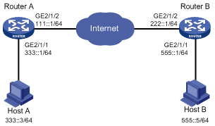

Configuring an IKE-based IPsec tunnel for IPv6 packets
As shown in Figure 12, establish an IPsec tunnel between Router A and Router B to protect data flows between subnet 333::/64 and subnet 555::/64. Configure the IPsec tunnel as follows:
Figure 12 Network diagram
# Configure IPv6 addresses for interfaces. (Details not shown.)
# Configure an IPv6 advanced ACL to identify data flows from subnet 333::/64 to subnet 555::/64.
[RouterA] acl ipv6 advanced 3101
[RouterA-acl-ipv6-adv-3101] rule permit ipv6 source 333::0 64 destination 555::0 64
[RouterA-acl-ipv6-adv-3101] quit
# Configure a static route to Host B. The command uses the direct next hop address (111::2) as an example.
[RouterA] ipv6 route-static 555::0 64 111::2
[RouterA-ipsec-transform-set-tran1] esp authentication-algorithm sha1
[RouterA-ipsec-transform-set-tran1] quit
# Create and configure the IKE keychain named keychain1.
[RouterA] ike keychain keychain1
[RouterA-ike-keychain-keychain1] pre-shared-key address ipv6 222::1 64 key simple 123456TESTplat&!
[RouterA-ike-keychain-keychain1] quit
# Create and configure the IKE profile named profile1.
[RouterA] ike profile profile1
[RouterA-ike-profile-profile1] keychain keychain1
[RouterA-ike-profile-profile1] match remote identity address ipv6 222::1 64
[RouterA-ike-profile-profile1] quit
# Create an IKE-based IPsec policy entry. Specify the policy name as map1 and set the sequence number to 10.
[RouterA] ipsec ipv6-policy map1 10 isakmp
# Apply IPv6 ACL 3101.
[RouterA-ipsec-ipv6-policy-isakmp-map1-10] security acl ipv6 3101
# Apply the IPsec transform set tran1.
[RouterA-ipsec-ipv6-policy-isakmp-map1-10] transform-set tran1
# Specify the local and remote IPv6 addresses of the IPsec tunnel as 111::1 and 222::1.
[RouterA-ipsec-ipv6-policy-isakmp-map1-10] local-address ipv6 111::1
[RouterA-ipsec-ipv6-policy-isakmp-map1-10] remote-address ipv6 222::1
# Apply the IKE profile profile1.
[RouterA-ipsec-ipv6-policy-isakmp-map1-10] ike-profile profile1
[RouterA-ipsec-ipv6-policy-isakmp-map1-10] quit
# Apply the IPsec policy map1 to interface GigabitEthernet 2/1/2.
[RouterA] interface gigabitethernet 2/1/2
[RouterA-GigabitEthernet2/1/2] ipv6 address 111::1/64
[RouterA-GigabitEthernet2/1/2] ipsec apply ipv6-policy map1
[RouterA-GigabitEthernet2/1/2] quit
2.     Configure Router B:
# Configure an IPv6 advanced ACL to identify data flows from subnet 555::/64 to subnet 333::/64.
<RouterB> system-view
[RouterB] acl ipv6 advanced 3101
[RouterB-acl-ipv6-adv-3101] rule permit ipv6 source 555::/64 destination 333::/64
[RouterB-acl-ipv6-adv-3101] quit
# Configure a static route to Host A. The command uses the direct next hop address (222::2) as an example.
[RouterB] ipv6 route-static 333::0 64 222::2
[RouterB] ipsec transform-set tran1
[RouterB-ipsec-transform-set-tran1] encapsulation-mode tunnel
[RouterB-ipsec-transform-set-tran1] protocol esp
[RouterB-ipsec-transform-set-tran1] esp encryption-algorithm aes-cbc-128
[RouterB-ipsec-transform-set-tran1] esp authentication-algorithm sha1
[RouterB-ipsec-transform-set-tran1] quit
[RouterB] ike keychain keychain1
[RouterB-ike-keychain-keychain1] pre-shared-key address ipv6 111::1 64 key simple 123456TESTplat&!
[RouterB-ike-keychain-keychain1] quit
[RouterB] ike profile profile1
[RouterB-ike-profile-profile1] keychain keychain1
[RouterB-ike-profile-profile1] match remote identity address ipv6 111::1 64
[RouterB-ike-profile-profile1] quit
# Create an IKE-based IPsec policy entry. Specify the policy name as use1 and set the sequence number to 10.
[RouterB] ipsec ipv6-policy use1 10 isakmp
# Apply ACL 3101.
[RouterB-ipsec-ipv6-policy-isakmp-use1-10] security acl ipv6 3101
[RouterB-ipsec-ipv6-policy-isakmp-use1-10] transform-set tran1
# Specify the local and remote IPv6 addresses of the IPsec tunnel as 222::1 and 111::1.
[RouterB-ipsec-ipv6-policy-isakmp-use1-10] local-address ipv6 222::1
[RouterB-ipsec-ipv6-policy-isakmp-use1-10] remote-address ipv6 111::1
[RouterB-ipsec-ipv6-policy-isakmp-use1-10] ike-profile profile1
[RouterB-ipsec-ipv6-policy-isakmp-use1-10] quit
# Apply the IPsec policy use1 to interface GigabitEthernet 2/1/2.
[RouterB] interface gigabitethernet 2/1/2
[RouterB-GigabitEthernet2/1/2] ipv6 address 222::1/64
[RouterB-GigabitEthernet2/1/2] ipsec apply ipv6-policy use1
[RouterB-GigabitEthernet2/1/2] quit
# Initiate a connection from subnet 333::/64 to subnet 555::/64 to trigger IKE negotiation. After IPsec SAs are successfully negotiated by IKE, the traffic between the two subnets is IPsec-protected.
# Use the display ipsec sa command to display IPsec SAs on Router A and Router B. This example uses Router A to verify the configuration.
[RouterA] display ipsec sa
Interface: GigabitEthernet2/1/2
  IPsec policy: map1
  Sequence number: 10
  Mode: ISAKMP
    Tunnel id: 0
    Encapsulation mode: tunnel
    Perfect Forward Secrecy:
    Inside VPN:
    Extended Sequence Numbers enable: N
    Traffic Flow Confidentiality enable: N
    Path MTU: 1423
    Tunnel:
        local  address: 111::1
        remote address: 222::1
    Flow:
    sour addr: 111::1/0      port: 0  protocol: ipv6
    dest addr: 222::1/0      port: 0  protocol: ipv6
    [Inbound ESP SAs]
      SPI: 3769702703 (0xe0b1192f)
      Connection ID: 1
      Transform set: ESP-ENCRYPT-AES-CBC-128 ESP-AUTH-SHA1
      SA duration (kilobytes/sec): 3000/28800
      SA remaining duration (kilobytes/sec): 2300/797
      Max received sequence-number: 1
      Anti-replay check enable: N
      Anti-replay window size:
      UDP encapsulation used for NAT traversal: N
      Status: Active
    [Outbound ESP SAs]
      SPI: 3840956402 (0xe4f057f2)
      Connection ID: 2
      SA remaining duration (kilobytes/sec): 2312/797
      Max sent sequence-number: 1
      Status: Active

Configuring IPsec RRI
As shown in Figure 14, branches access the enterprise center through an IPsec VPN.
Configure the IPsec VPN as follows:
·     Configure an IPsec tunnel between Router A and each branch gateway (Router B, Router C, and Router D) to protect traffic between subnets 4.4.4.0/24 and 5.5.5.0/24.
·     Configure the tunnels to use the security protocol ESP, the encryption algorithm DES, and the authentication algorithm SHA1-HMAC-96. Use IKE for IPsec SA negotiation.
·     Configure IKE proposal to use pre-shared key authentication method, the encryption algorithm 3DES, and the authentication algorithm HMAC-SHA1.
·     Configure IPsec RRI on Router A to automatically create static routes to the branches based on the established IPsec SAs.
Figure 14 Network diagram
1.     Assign IPv4 addresses to the interfaces on the routers according to Figure 14. (Details not shown.)
2.     Configure Router A:
# Create an IPsec transform set named tran1, and specify ESP as the security protocol, DES as the encryption algorithm, and HMAC-SHA-1-96 as the authentication algorithm.
[RouterA-ipsec-transform-set-tran1] esp encryption-algorithm des
# Create and configure an IKE profile named profile1.
[RouterA-ike-profile-profile1] match remote identity address 2.2.2.2 255.255.255.0
# Create an IPsec policy template named temp1. Specify IPsec transform set tran1 and IKE profile profile1 for the IPsec policy template.
[RouterA] ipsec policy-template temp1 1
[RouterA-ipsec-policy-template-temp1-1] transform-set tran1
[RouterA-ipsec-policy-template-temp1-1] ike-profile profile1
# Enable IPsec RRI, and set the preference to 100 and the tag to 1000 for the static routes created by IPsec RRI.
[RouterA-ipsec-policy-template-temp1-1] reverse-route dynamic
[RouterA-ipsec-policy-template-temp1-1] reverse-route preference 100
[RouterA-ipsec-policy-template-temp1-1] reverse-route tag 1000
[RouterA-ipsec-policy-template-temp1-1] quit
# Create an IKE-based IPsec policy entry by using IPsec policy template temp1. Specify the policy name as map1 and set the sequence number to 10.
[RouterA] ipsec policy map1 10 isakmp template temp1

3.     Configure Router B:
[RouterB-ipsec-transform-set-tran1] esp encryption-algorithm des
# Configure IPv4 advanced ACL 3000 to identify traffic from subnet 5.5.5.0/24 to subnet 4.4.4.0/24.
[RouterB] acl advanced 3000
[RouterB-acl-ipv4-adv-3000] rule permit ip source 5.5.5.0 0.0.0.255 destination 4.4.4.0 0.0.0.255
[RouterB-acl-ipv4-adv-3000] quit
[RouterB-ike-profile-profile1] match remote identity address 2.2.2.2 255.255.255.0
# Create an IKE-based IPsec policy entry and configure it as follows:
¡     Specify the policy name as map1.
¡     Set the sequence number to 10.
¡     Specify transform set tran1 for the policy.
¡     Specify ACL 3000 for the policy.
¡     Specify the remote IP address for the tunnel as 1.1.1.1.
¡     Specify IKE profile profile1 for the policy.
[RouterB] ipsec policy map1 10 isakmp
[RouterB-ipsec-policy-isakmp-map1-10] transform-set tran1
[RouterB-ipsec-policy-isakmp-map1-10] security acl 3000
[RouterB-ipsec-policy-isakmp-map1-10] remote-address 1.1.1.1
[RouterB-ipsec-policy-isakmp-map1-10] ike-profile profile1
[RouterB-ipsec-policy-isakmp-map1-10] quit
# Create an IKE proposal named 1, and specify 3DES as the encryption algorithm, HMAC-SHA1 as the authentication algorithm, and pre-share as the authentication method.
[RouterB] ike proposal 1
[RouterB-ike-proposal-1] encryption-algorithm 3des-cbc
[RouterB-ike-proposal-1] authentication-algorithm sha
[RouterB-ike-proposal-1] authentication-method pre-share
[RouterB-ike-proposal-1] quit
# Create an IKE keychain named key1 and specify 123 in plain text as the pre-shared key to be used with the remote peer at 1.1.1.1.
[RouterB] ike keychain key1
[RouterB-ike-keychain-key1] pre-shared-key address 1.1.1.1 key simple 123
[RouterB-ike-keychain-key1] quit
# Apply the IPsec policy map1 to interface GigabitEthernet2/1/1.
[RouterB] interface gigabitethernet 2/1/1
[RouterB-GigabitEthernet2/1/1] ipsec apply policy map1
[RouterB-GigabitEthernet2/1/1] quit
Make sure Router B has a route to the peer private network, with the outgoing interface as GigabitEthernet2/1/1.
4.     Configure Router C and Router D in the same way Router B is configured.
1.     Verify that IPsec RRI can automatically create a static route from Router A to Router B:
# Initiate a connection from subnet 5.5.5.0/24 to subnet 4.4.4.0/24. IKE negotiation is triggered to establish IPsec SAs between Router A and Router B. (Details not shown.)
# Verify that IPsec SAs are established on Router A.
Interface: GigabitEthernet2/1/1
  IPsec policy: map1
  Sequence number: 10
  Mode: Template
    Tunnel id: 0
    Inside VPN:
    Path MTU: 1463
    Tunnel:
        local  address: 1.1.1.1
        remote address: 2.2.2.2
    Flow:
    sour addr: 4.4.4.0/255.255.255.0  port: 0  protocol: ip
    dest addr: 5.5.5.0/255.255.255.0  port: 0  protocol: ip
    [Inbound ESP SAs]
      SPI: 1014286405 (0x3c74c845)
      Connection ID: 1
      Transform set: ESP-ENCRYPT-DES-CBC ESP-AUTH-SHA1
      SA duration (kilobytes/sec): 1843200/3600
      SA remaining duration (kilobytes/sec): 1843199/3590
      Max received sequence-number: 4
      Anti-replay check enable: Y
      Anti-replay window size: 64
      UDP encapsulation used for nat traversal: N
      Status: Active
    [Outbound ESP SAs]
      SPI: 4011716027 (0xef1dedbb)
      Connection ID: 2
      Max sent sequence-number: 4
      Status: Active
# Verify that IPsec RRI has created a static route to reach Router B.
[RouterA] display ip routing-table verbose

As shown in Figure 15, IKE negotiates SAs for IPsec and transfers the SAs to IPsec, and IPsec uses the SAs to protect IP packets.
Figure 15 Relationship between IKE and IPsec
IKE negotiation process

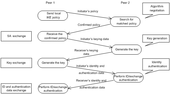

IKE exchange process in main mode
As shown in Figure 16, the main mode of IKE negotiation in phase 1 involves three pairs of messages:
·     SA exchange—Used for negotiating the IKE security policy.
·     Key exchange—Used for exchanging the DH public value and other values, such as the random number. The two peers use the exchanged data to generate key data and use the encryption key and authentication key to ensure the security of IP packets.
·     ID and authentication data exchange—Used for identity authentication.
Figure 16 IKE exchange process in main mode

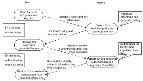

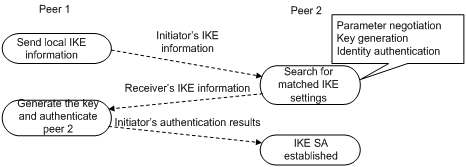

IKE exchange process in aggressive mode
As shown in Figure 17, the process of phase 1 IKE negotiation in aggressive mode is as follows:
1.     The initiator (peer 1) sends a message containing the local IKE information to peer 2. The message includes parameters used for IKE SA establishment, keying data, and peer 1's identity information.
2.     Peer 2 chooses the IKE establishment parameters to use, generate the key, and authenticate peer 1's identity. Then it sends the IKE data to peer 1.
3.     Peer 1 generates the key, authenticates peer 2's identity, and sends the results to peer 1.
After the preceding process, an IKE SA is established between peer 1 and peer 2.
The aggressive mode is faster than the main mode but it does not provide identity information protection. The main mode provides identity information protection but is slower. Choose the appropriate negotiation mode according to your requirements.
Figure 17 IKE exchange process in aggressive mode

Configuring an IKE proposal
An IKE proposal defines a set of attributes describing how IKE negotiation in phase 1 should take place. You can create multiple IKE proposals with different priorities. The priority of an IKE proposal is represented by its sequence number. The lower the sequence number, the higher the priority.
Two peers must have at least one matching IKE proposal for successful IKE negotiation. During IKE negotiation:
·     The initiator sends its IKE proposals to the peer.
¡     If the initiator is using an IPsec policy with an IKE profile, the initiator sends all IKE proposals specified in the IKE profile to the peer. An IKE proposal specified earlier for the IKE profile has a higher priority.
¡     If the initiator is using an IPsec policy with no IKE profile, the initiator sends all its IKE proposals to the peer. An IKE proposal with a smaller number has a higher priority.
·     The peer searches its own IKE proposals for a match. The search starts from the IKE proposal with the highest priority and proceeds in descending order of priority until a match is found. The matching IKE proposals are used to establish the IKE SA. If all user-defined IKE proposals are found mismatching, the two peers use their default IKE proposals to establish the IKE SA.
Two matching IKE proposals have the same encryption algorithm, authentication method, authentication algorithm, and DH group. The SA lifetime takes the smaller one of the two proposals' SA lifetime settings.

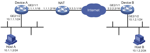

Main mode IKE with pre-shared key authentication configuration example
As shown in Figure 18, configure an IKE-based IPsec tunnel between Device A and Device B to secure the communication between subnet 10.1.1.0/24 and subnet 10.1.2.0/24.
·     Configure Device A and Device B to use the default IKE proposal for the IKE negotiation to set up the IPsec SAs.
·     Configure the two devices to use the pre-shared key authentication method for the IKE negotiation phase 1.
Figure 18 Network diagram
1.     Configure Device A:
# Assign an IP address to each interface. (Details not shown.)
# Configure IPv4 advanced ACL 3101 to identify traffic from subnet 10.1.1.0/24 to subnet 10.1.2.0/24.
<DeviceA> system-view
[DeviceA] acl advanced 3101
[DeviceA-acl-ipv4-adv-3101] rule permit ip source 10.1.1.0 0.0.0.255 destination 10.1.2.0 0.0.0.255
[DeviceA-acl-ipv4-adv-3101] quit
[DeviceA] ipsec transform-set tran1
# Set the packet encapsulation mode to tunnel.
[DeviceA-ipsec-transform-set-tran1] encapsulation-mode tunnel
# Use the ESP protocol for the IPsec transform set.
[DeviceA-ipsec-transform-set-tran1] protocol esp
# Specify the encryption and authentication algorithms.
[DeviceA-ipsec-transform-set-tran1] esp encryption-algorithm aes-cbc-128
[DeviceA-ipsec-transform-set-tran1] esp authentication-algorithm sha1
[DeviceA-ipsec-transform-set-tran1] quit
# Create an IKE keychain named keychain1.
[DeviceA] ike keychain keychain1
# Specify 123456TESTplat&! in plain text as the pre-shared key to be used with the remote peer at 2.2.2.2.
[DeviceA-ike-keychain-keychain1] pre-shared-key address 2.2.2.2 255.255.0.0 key simple 123456TESTplat&!
[DeviceA-ike-keychain-keychain1] quit
# Create an IKE profile named profile1.
[DeviceA] ike profile profile1
# Specify IKE keychain keychain1.
[DeviceA-ike-profile-profile1] keychain keychain1

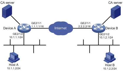

As shown in Figure 19, configure an IKE-based IPsec tunnel between Device A and Device B to secure the communication between subnet 10.1.1.0/24 and subnet 10.1.2.0/24.
Configure Device A and Device B to use aggressive mode for IKE negotiation phase 1 and to use RSA signature authentication. Device A acts as the initiator, and the subnet where Device A resides uses IP addresses dynamically allocated.
Figure 19 Network diagram

# Display the IKE proposal configuration on Device A and Device B.
[DeviceA] display ike proposal
 Priority Authentication Authentication Encryption  Diffie-Hellman Duration
              method       algorithm    algorithm       group      (seconds)
 10       RSA-SIG            MD5        AES-CBC-128     Group 1        86400
 default  PRE-SHARED-KEY     SHA1       AES-CBC-128     Group 1        86400
[DeviceB] display ike proposal
# Display the IKE SA on Device A.
[DeviceA] display ike sa
    Connection-ID   Remote                Flag         DOI
    1               2.2.2.2               RD           IPsec
Flags:
RD--READY RL--REPLACED FD-FADING RK-REKEY
# Display information about the CA certificate on Device A.
[DeviceA] display pki certificate domain domain1 ca
Certificate:
    Data:
        Version: 1 (0x0)
        Serial Number:
            b9:14:fb:25:c9:08:2c:9d:f6:94:20:30:37:4e:00:00
        Signature Algorithm: sha1WithRSAEncryption
        Issuer: C=cn, O=rnd, OU=sec, CN=8088
        Validity
            Not Before: Sep  6 01:53:58 2012 GMT
            Not After : Sep  8 01:50:58 2015 GMT
        Subject: C=cn, O=rnd, OU=sec, CN=8088
        Subject Public Key Info:
            Public Key Algorithm: rsaEncryption
                Public-Key: (1024 bit)
                Modulus:
                    00:de:81:f4:42:c6:9f:c2:37:7b:21:84:57:d6:42:
                    00:69:1c:4c:34:a4:5e:bb:30:97:45:2b:5e:52:43:
                    c0:49:1f:e1:d8:0f:5c:48:c2:39:69:d1:84:e4:14:
                    70:3d:98:41:28:1c:20:a1:9a:3f:91:67:78:77:27:
                    d9:08:5f:7a:c4:36:45:8b:f9:7b:e7:7d:6a:98:bb:
                    4e:a1:cb:2c:3d:92:66:bd:fb:80:35:16:c6:35:f0:
                    ff:0b:b9:3c:f3:09:94:b7:d3:6f:50:8d:83:f1:66:
                    2f:91:0b:77:a5:98:22:b4:77:ac:84:1d:03:8e:33:
                    1b:31:03:78:4f:77:a0:db:af
                Exponent: 65537 (0x10001)
        9a:6d:8c:46:d3:18:8a:00:ce:12:ee:2b:b0:aa:39:5d:3f:90:
        08:49:b9:a9:8f:0d:6e:7b:e1:00:fb:41:f5:d4:0c:e4:56:d8:
        7a:a7:61:1d:2b:b6:72:e3:09:0b:13:9d:fa:c8:fc:c4:65:a7:
        f9:45:21:05:75:2c:bf:36:7b:48:b4:4a:b9:fe:87:b9:d8:cf:
        55:16:87:ec:07:1d:55:5a:89:74:73:68:5e:f9:1d:30:55:d9:
        8a:8f:c5:d4:20:7e:41:a9:37:57:ed:8e:83:a7:80:2f:b8:31:
        57:3a:f2:1a:28:32:ea:ea:c5:9a:55:61:6a:bc:e5:6b:59:0d:
        82:16
# Display the local certificate on Device A.
[DeviceA] display pki certificate domain domain1 local
Certificate:
    Data:
        Version: 3 (0x2)
        Serial Number:
            a1:f4:d4:fd:cc:54:c3:07:c4:9e:15:2d:5f:64:57:77
        Validity
            Not Before: Sep 26 02:06:43 2012 GMT
            Not After : Sep 26 02:06:43 2013 GMT
        Subject: CN=devicea
                Modulus:
                    00:b0:a1:cd:24:6e:1a:1d:51:79:f0:2a:3e:9f:e9:
                    84:07:16:78:49:1b:7d:0b:22:f0:0a:ed:75:91:a4:
                    17:fd:c7:ef:d0:66:5c:aa:e3:2a:d9:71:12:e4:c6:
                    25:77:f0:1d:97:bb:92:a8:bd:66:f8:f8:e8:d5:0d:
                    d2:c8:01:dd:ea:e6:e0:80:ad:db:9d:c8:d9:5f:03:
                    2d:22:07:e3:ed:cc:88:1e:3f:0c:5e:b3:d8:0e:2d:
                    ea:d6:c6:47:23:6a:11:ef:3c:0f:6b:61:f0:ca:a1:
                    79:a0:b1:02:1a:ae:8c:c9:44:e0:cf:d1:30:de:4c:
                    f0:e5:62:e7:d0:81:5d:de:d3
        X509v3 extensions:
            X509v3 CRL Distribution Points:
                Full Name:
                  URI:http://xx.rsa.com:447/8088.crl
        73:ac:66:f9:b8:b5:39:e1:6a:17:e4:d0:72:3e:26:9e:12:61:
        9e:c9:7a:86:6f:27:b0:b9:a3:5d:02:d9:5a:cb:79:0a:12:2e:
        cb:e7:24:57:e6:d9:77:12:6b:7a:cf:ee:d6:17:c5:5f:d2:98:
        30:e0:ef:00:39:4a:da:ff:1c:29:bb:2a:5b:60:e9:33:8f:78:
        f9:15:dc:a5:a3:09:66:32:ce:36:cd:f0:fe:2f:67:e5:72:e5:
        21:62:85:c4:07:92:c8:f1:d3:13:9c:2e:42:c1:5f:0e:8f:ff:
        65:fb:de:7c:ed:53:ab:14:7a:cf:69:f2:42:a4:44:7c:6e:90:
        7e:cd
# Display the IPsec SA information on Device A.
[DeviceA] display ipsec sa
  IPsec policy: map1
  Sequence number: 10
  Mode: ISAKMP
    Tunnel id: 0
    Inside VPN:
    Path MTU: 1456
    Tunnel:
    Flow:
        sour addr: 10.1.1.0/255.255.255.0  port: 0  protocol: ip
        dest addr: 10.1.2.0/255.255.255.0  port: 0  protocol: ip
    [Inbound ESP SAs]
      SPI: 3264152513 (0xc28f03c1)
      Connection ID: 90194313219
      SA remaining duration (kilobytes/sec): 1843200/3484
      Status: Active
    [Outbound ESP SAs]
      SPI: 738451674 (0x2c03e0da)
      Connection ID: 64424509441
      Status: Active
# Display the information about the CA certificate, local certificate, IKE SA, and IPsec SA on Device B.
[DeviceB] display ike sa
[DeviceB] display pki certificate domain domain2 ca
[DeviceB] display pki certificate domain domain2 local
[DeviceB] display ipsec sa
Aggressive mode with NAT traversal configuration example
This configuration example is not available when the device is operating in FIPS mode.
Device A is behind the NAT device. Hosts behind Device A use public IP address 3.3.3.1 to access the external network.
Configure an IKE-based IPsec tunnel between Device A and Device B to secure the communication between subnet 10.1.1.0/24 and subnet 10.1.2.0/24.
·     Configure Device A and Device B to use the default IKE proposal for the aggressive IKE negotiation to set up the IPsec SAs.
Figure 20 Network diagram
# Configure IPv4 advanced ACL 3000 to identify traffic from subnet 10.1.1.0/24 to subnet 10.1.2.0/24.
[DeviceA] acl advanced 3000
[DeviceA-acl-ipv4-adv-3000] rule 0 permit ip source 10.1.1.0 0.0.0.255 destination 10.1.2.0 0.0.0.255
[DeviceA-acl-ipv4-adv-3000] quit
# Create an IPsec transform set named transform1.
[DeviceA] ipsec transform-set transform1
[DeviceA-ipsec-transform-set-transform1] protocol esp
[DeviceA-ipsec-transform-set-transform1] esp encryption-algorithm 3des-cbc
[DeviceA-ipsec-transform-set-transform1] esp authentication-algorithm md5
[DeviceA-ipsec-transform-set-transform1] quit
# Specify 12345zxcvb!@#$%ZXCVB in plain text as the pre-shared key to be used with the remote peer at 2.2.2.2.
[DeviceA-ike-keychain-keychain1] pre-shared-key address 2.2.2.2 255.255.0.0 key simple 12345zxcvb!@#$%ZXCVB
# Specify that IKE negotiation operates in aggressive mode.
[DeviceA-ike-profile-profile1] exchange-mode aggressive
# Set the local identity to the FQDN name www.devicea.com.
[DeviceA-ike-profile-profile1] local-identity fqdn www.devicea.com
# Configure a peer ID with the identity type as IP address and the value as 2.2.2.2/16.
[DeviceA-ike-profile-profile1] match remote identity address 2.2.2.2 255.255.0.0
[DeviceA-ike-profile-profile1] quit
# Create an IKE-based IPsec policy entry. Specify the policy name as policy1 and set the sequence number to 1.
[DeviceA] ipsec policy policy1 1 isakmp
# Specify the remote IP address 2.2.2.2 for the IPsec tunnel.
[DeviceA-ipsec-policy-isakmp-policy1-1] remote-address 2.2.2.2
# Specify the IPsec transform set transform1 for the IPsec policy.
[DeviceA-ipsec-policy-isakmp-policy1-1] transform-set transform1
# Specify ACL 3000 to identify the traffic to be protected.
[DeviceA-ipsec-policy-isakmp-policy1-1] security acl 3000
# Specify IKE profile profile1 for the IPsec policy.
[DeviceA-ipsec-policy-isakmp-policy1-1] ike-profile profile1
[DeviceA-ipsec-policy-isakmp-policy1-1] quit
# Apply IPsec policy policy1 to interface GigabitEthernet 2/1/1.
[DeviceA] interface gigabitethernet 2/1/1
[DeviceA-GigabitEthernet2/1/1] ipsec apply policy policy1
[DeviceA-GigabitEthernet2/1/1] quit
# Configure a static route to the subnet where Host B resides. This example uses 1.1.1.2 as the next hop IP address.
[DeviceA] ip route-static 10.1.2.0 255.255.255.0 1.1.1.2
2.     Configure Device B:
# Create IPsec transform set transform1.
<DeviceB> system-view
[DeviceB] ipsec transform-set transform1
[DeviceB-ipsec-transform-set-transform1] protocol esp
[DeviceB-ipsec-transform-set-transform1] esp encryption-algorithm 3des-cbc
[DeviceB-ipsec-transform-set-transform1] esp authentication-algorithm md5
[DeviceB-ipsec-transform-set-transform1] quit
# Create IKE keychain keychain1.
[DeviceB]ike keychain keychain1
# Specify 12345zxcvb!@#$%ZXCVB in plain text as the pre-shared key to be used with the remote peer at 1.1.1.1. The source address of packets from 1.1.1.1 is translated into 3.3.3.1 by the NAT device, so specify the IP address of the remote peer as 3.3.3.1.
[DeviceB-ike-keychain-keychain1] pre-shared-key address 3.3.3.1 255.255.255.0 key simple 12345zxcvb!@#$%ZXCVB
[DeviceB-ike-keychain-keychain1] quit
[DeviceB] ike profile profile1
# Specify the IKE keychain keychain1.
[DeviceB-ike-profile-profile1] keychain keychain1
[DeviceB-ike-profile-profile1] exchange-mode aggressive
# Configure a peer ID with the identity type of FQDN name and the value of www.devicea.com.
[DeviceB-ike-profile-profile1] match remote identity fqdn www.devicea.com
[DeviceB-ike-profile-profile1] quit
# Create an IPsec policy template entry. Specify the template name as template1 and set the sequence number to 1.
[DeviceB] ipsec policy-template template1 1
# Specify the IPsec transform set transform1 for the IPsec policy template.
[DeviceB-ipsec-policy-template-template1-1] transform-set transform1
# Specify 2.2.2.2 as the local address of the IPsec tunnel.
[DeviceB-ipsec-policy-template-template1-1] local-address 2.2.2.2
[DeviceB-ipsec-policy-template-template1-1] ike-profile profile1
[DeviceB-ipsec-policy-template-template1-1] quit
# Create an IKE-based IPsec policy entry by using IPsec policy template template1. Specify the policy name as policy1 and set the sequence number to 1.
[DeviceB] ipsec policy policy1 1 isakmp template template1
[DeviceB] interface gigabitethernet 2/1/1
[DeviceB-GigabitEthernet2/1/1] ipsec apply policy policy1
[DeviceB-GigabitEthernet2/1/1] quit
# Configure a static route to the subnet where Host A resides. This example uses 2.2.2.1 as the next hop IP address.
[DeviceB] ip route-static 10.1.1.0 255.255.255.0 2.2.2.1
# Initiate a connection from subnet 10.1.1.0/24 to subnet 10.1.2.0/24 to trigger IKE negotiation. After IPsec SAs are successfully negotiated by IKE, traffic between the two subnets is IPsec-protected.

[DeviceA] display ike sa verbose
   Connection ID: 13
   Outside VPN:
   Inside VPN:
   Profile: profile1
   Transmitting entity: Initiator
   Local IP: 1.1.1.1
   Local ID type: FQDN
   Local ID: www.devicea.com
   Remote IP: 2.2.2.2
   Remote ID type: IPV4_ADDR
   Remote ID: 2.2.2.2
   Authentication-method: PRE-SHARED-KEY
   Authentication-algorithm: SHA1
   Encryption-algorithm: DES-CBC
   Life duration(sec): 86400
   Remaining key duration(sec): 84565
   Exchange-mode: Aggressive
   Diffie-Hellman group: Group 1
   NAT traversal: Detected
   Extend authentication: Disabled
   Assigned IP address:
# Display the IPsec SAs generated on Device A.
  IPsec policy: policy1
  Sequence number: 1
  Mode: ISAKMP
    Tunnel id: 0
Inside VPN:
    Path MTU: 1435
    Tunnel:
    Flow:
    [Inbound ESP SAs]
      SPI: 830667426 (0x3182faa2)
      Transform set: ESP-ENCRYPT-3DES-CBC ESP-AUTH-MD5
      SA remaining duration (kilobytes/sec): 1843200/2313
      UDP encapsulation used for NAT traversal: Y
      Status: Active
    [Outbound ESP SAs]
      SPI: 3516214669 (0xd1952d8d)
      Status: Active

IKEv2 configuration examples
IKEv2 with pre-shared key authentication configuration example
As shown in Figure 24, configure an IKE-based IPsec tunnel between Device A and Device B to secure the communication between subnet 10.1.1.0/24 and subnet 10.1.2.0/24.
·     Configure Device A and Device B to use the default IKEv2 proposal and the default IKEv2 policy in IKEv2 negotiation to set up IPsec SAs.
·     Configure the two devices to use the pre-shared key authentication method in IKEv2 negotiation.
Figure 24 Network diagram
Configuration procedures
[DeviceA-ipsec-transform-set-tran1] esp encryption-algorithm des-cbc
# Create an IKEv2 keychain named keychain1.
[DeviceA] ikev2 keychain keychain1
# Create an IKEv2 peer named peer1.
[DeviceA-ikev2-keychain-keychain1] peer peer1
# Specify the peer IP address 2.2.2.2/16.
[DeviceA-ikev2-keychain-keychain1-peer-peer1] address 2.2.2.2 16
# Specify the peer ID, which is the IP address 2.2.2.2.
[DeviceA-ikev2-keychain-keychain1-peer-peer1] identity address 2.2.2.2
# Specify abcde in plain text as the pre-shared key to be used with the peer at 2.2.2.2.
[DeviceA-ikev2-keychain-keychain1-peer-peer1] pre-shared-key plaintext abcde
[DeviceA-ikev2-keychain-keychain1-peer-peer1] quit
[DeviceA-ikev2-keychain-keychain1] quit
# Create an IKEv2 profile named profile1.
[DeviceA] ikev2 profile profile1
# Specify the local authentication method as pre-shared key.
[DeviceA-ikev2-profile-profile1] authentication-method local pre-share
# Specify the remote authentication method as pre-shared key.
[DeviceA-ikev2-profile-profile1] authentication-method remote pre-share
# Specify the IKEv2 keychain keychain1.
[DeviceA-ikev2-profile-profile1] keychain keychain1
# Specify the peer ID that the IKEv2 profile matches. The peer ID is the IP address 2.2.2.2/16.
[DeviceA-ikev2-profile-profile1] match remote identity address 2.2.2.2 255.255.0.0

IKEv2 with RSA signature authentication configuration example
As shown in Figure 25, configure an IKE-based IPsec tunnel between Device A and Device B to secure the communication between subnet 10.1.1.0/24 and subnet 10.1.2.0/24.
Configure Device A and Device B to use IKEv2 negotiation and RSA signature authentication. Device A acts as the initiator, and the subnet where Device A resides uses IP addresses dynamically allocated.
Figure 25 Network diagram
