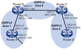

OSPFv3 stub area configuration example
Network requirements
As shown in Figure 2:
·     Enable OSPFv3 on all routers.
·     Split the AS into three areas.
·     Configure Router B and Router C as ABRs to forward routing information between areas.
·     Configure Area 2 as a stub area to reduce LSAs in the area without affecting route reachability.
Figure 2 Network diagram
Configuration procedure
1.     Configure IPv6 addresses for interfaces. (Details not shown.)
2.     Configure basic OSPFv3:
# On Router A, enable OSPFv3 and specify the router ID as 1.1.1.1.
<RouterA> system-view
[RouterA] ospfv3 1
[RouterA-ospfv3-1] router-id 1.1.1.1
[RouterA-ospfv3-1] quit
[RouterA] interface gigabitethernet 2/1/1
[RouterA-GigabitEthernet2/1/1] ospfv3 1 area 1
[RouterA-GigabitEthernet2/1/1] quit
[RouterA] interface gigabitethernet 2/1/2
[RouterA-GigabitEthernet2/1/2] ospfv3 1 area 1
[RouterA-GigabitEthernet2/1/2] quit
# On Router B, enable OSPFv3 and specify the router ID as 2.2.2.2.
<RouterB> system-view
[RouterB] ospfv3 1
[RouterB-ospfv3-1] router-id 2.2.2.2
[RouterB-ospfv3-1] quit
[RouterB] interface gigabitethernet 2/1/1
[RouterB-GigabitEthernet2/1/1] ospfv3 1 area 0
[RouterB-GigabitEthernet2/1/1] quit
[RouterB] interface gigabitethernet 2/1/2
[RouterB-GigabitEthernet2/1/2] ospfv3 1 area 1
[RouterB-GigabitEthernet2/1/2] quit
# On Router C, enable OSPFv3 and specify the router ID as 3.3.3.3.
<RouterC> system-view
[RouterC] ospfv3 1
[RouterC-ospfv3-1] router-id 3.3.3.3
[RouterC-ospfv3-1] quit
[RouterC] interface gigabitethernet 2/1/1
[RouterC-GigabitEthernet2/1/1] ospfv3 1 area 0
[RouterC-GigabitEthernet2/1/1] quit
[RouterC] interface gigabitethernet 2/1/2
[RouterC-GigabitEthernet2/1/2] ospfv3 1 area 2
[RouterC-GigabitEthernet2/1/2] quit
# On Router D, enable OSPFv3 and specify the router ID as 4.4.4.4.
<RouterD> system-view
[RouterD] ospfv3 1
[RouterD-ospfv3-1] router-id 4.4.4.4
[RouterD-ospfv3-1] quit
[RouterD] interface gigabitethernet 2/1/2
[RouterD-GigabitEthernet2/1/2] ospfv3 1 area 2
[RouterD-GigabitEthernet2/1/2] quit
# Display OSPFv3 neighbors on Router B.
[RouterB] display ospfv3 peer
               OSPFv3 Process 1 with Router ID 2.2.2.2
 Area: 0.0.0.0
 Router ID       Pri State             Dead-Time InstID Interface
 3.3.3.3         1   Full/BDR          00:00:40  0      GE2/1/1
 Area: 0.0.0.1
 1.1.1.1         1   Full/DR           00:00:40  0      GE2/1/2
# Display OSPFv3 neighbors on Router C.
[RouterC] display ospfv3 peer
               OSPFv3 Process 1 with Router ID 3.3.3.3
 Area: 0.0.0.0
 2.2.2.2         1   Full/DR           00:00:40  0      GE2/1/1
 Area: 0.0.0.2
 4.4.4.4         1   Full/BDR          00:00:40  0      GE2/1/2
# Display OSPFv3 neighbors on Router D.
[RouterD] display ospfv3 routing
               OSPFv3 Process 1 with Router ID 4.4.4.4
 I  - Intra area route,  E1 - Type 1 external route,  N1 - Type 1 NSSA route
 IA - Inter area route,  E2 - Type 2 external route,  N2 - Type 2 NSSA route
 *  - Selected route
 *Destination: 2001::/64
  Type       : IA                                        Cost     : 2
  NextHop    : FE80::F40D:0:93D0:1                       Interface: GE2/1/2
  AdvRouter  : 3.3.3.3                                   Area     : 0.0.0.2
  Preference : 10
 *Destination: 2001:1::/64
  Type       : IA                                        Cost     : 3
  Preference : 10
 *Destination: 2001:2::/64
  Type       : I                                         Cost     : 1
  Nexthop    : ::                                        Interface: GE2/1/2
  AdvRouter  : 4.4.4.4                                   Area     : 0.0.0.2
  Preference : 10
 *Destination: 2001:3::/64
  Type       : IA                                        Cost     : 4
  Preference : 10
 Total: 4
 Intra area: 1         Inter area: 3         ASE: 0         NSSA: 0
3.     Configure Area 2 as a stub area:
# Configure Router D.
[RouterD] ospfv3
[RouterD-ospfv3-1] area 2
[RouterD-ospfv3-1-area-0.0.0.2] stub
[RouterD-ospfv3-1-area-0.0.0.2] quit
# Configure Router C, and specify the cost of the default route sent to the stub area as 10.
[RouterC] ospfv3
[RouterC-ospfv3-1] area 2
[RouterC-ospfv3-1-area-0.0.0.2] stub
[RouterC-ospfv3-1-area-0.0.0.2] default-cost 10
# Display OSPFv3 routing table on Router D.
 *  - Selected route
 *Destination: ::/0
  Type       : IA                                        Cost     : 11
  Preference : 10
  Type       : IA                                        Cost     : 2
  Preference : 10
  Type       : IA                                        Cost     : 3
  Preference : 10
  Type       : I                                         Cost     : 1
  Preference : 10
  Type       : IA                                        Cost     : 4
  Preference : 10
 Total: 5
 Intra area: 1         Inter area: 4         ASE: 0         NSSA: 0
The output shows that a default route is added and its cost is the cost of a direct route plus the configured cost.
4.     Configure Area 2 as a totally stub area to further reduce the stub area routing table size:
# Configure Area 2 as a totally stub area on Router C.
[RouterC-ospfv3-1-area-0.0.0.2] stub no-summary
 *  - Selected route
 *Destination: ::/0
  Type       : IA                                        Cost     : 11
  Preference : 10
  Type       : I                                         Cost     : 1
  Preference : 10
 Total: 2
 Intra area: 1         Inter area: 1         ASE: 0         NSSA: 0
The output shows that route entries are reduced. All indirect routes are removed, except the default route.

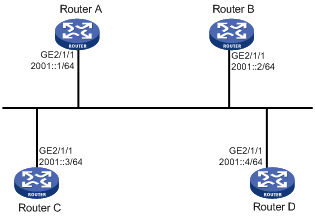

OSPFv3 DR election configuration example
As shown in Figure 4:
·     Configure router priority 100 for Router A, the highest priority on the network, so it will become the DR.
·     Configure router priority 2 for Router C, the second highest priority on the network, so it will become the BDR.
·     Configure router priority 0 for Router B, so it cannot become a DR or BDR.
·     Router D uses the default router priority 1.
Figure 4 Network diagram
# On Router A, enable OSPFv3, and specify the router ID as 1.1.1.1.
[RouterA] ospfv3
[RouterA-GigabitEthernet2/1/1] ospfv3 1 area 0
# On Router B, enable OSPFv3, and specify the router ID as 2.2.2.2.
[RouterB] ospfv3
# On Router C, enable OSPFv3, and specify the router ID as 3.3.3.3.
[RouterC] ospfv3
# On Router D, enable OSPFv3, and specify the router ID as 4.4.4.4.
[RouterD] ospfv3
[RouterD] interface gigabitethernet 2/1/1
[RouterD-GigabitEthernet2/1/1] ospfv3 1 area 0
[RouterD-GigabitEthernet2/1/1] quit
# Display neighbors on Router A. The routers have the same default router priority 1, so Router D (the router with the highest router ID) is elected as the DR, and Router C is the BDR.
[RouterA] display ospfv3 peer
               OSPFv3 Process 1 with Router ID 1.1.1.1
 Area: 0.0.0.0
 2.2.2.2         0   2-Way/DROther     00:00:36  0      GE2/1/1
 3.3.3.3         2   Full/BDR          00:00:35  0      GE2/1/1
 4.4.4.4         1   Full/DR           00:00:33  0      GE2/1/1
# Display neighbors on Router D. The neighbor states are all full.
[RouterD] display ospfv3 peer
 Area: 0.0.0.0
 1.1.1.1         100 Full/DROther      00:00:30  0      GE2/1/1
 2.2.2.2         0   Full/DROther      00:00:37  0      GE2/1/1
 3.3.3.3         2   Full/BDR          00:00:31  0      GE2/1/1
3.     Configure router priorities for interfaces:
# Set the router priority to 100 for the interface GigabitEthernet 2/1/1 of Router A.
[RouterA-GigabitEthernet2/1/1] ospfv3 dr-priority 100
# Set the router priority to 0 for the interface GigabitEthernet 2/1/1 of Router B.
[RouterB-GigabitEthernet2/1/1] ospfv3 dr-priority 0
# Set the router priority to 2 for the interface GigabitEthernet 2/1/1 of Router C.
[RouterC-GigabitEthernet2/1/1] ospfv3 dr-priority 2
# Display neighbors on Router A. The output shows that the router priorities have been changed, but the DR and BDR are not changed.
 Area: 0.0.0.0
 2.2.2.2         1   2-Way/DROther     00:00:36  0      GE2/1/1
 3.3.3.3         1   Full/BDR          00:00:35  0      GE2/1/1
 Area: 0.0.0.0
 1.1.1.1         1   Full/DROther      00:00:30  0      GE2/1/1
 2.2.2.2         1   Full/DROther      00:00:37  0      GE2/1/1
 3.3.3.3         1   Full/BDR          00:00:31  0      GE2/1/1
The output shows that the DR is still Router D.
4.     Enable DR/BDR election:
# Perform the shutdown and undo shutdown commands on each interface to enable a new DR/BD election. (Details not shown.)
# Display neighbors on Router A. The output shows that Router C becomes the BDR.
 Area: 0.0.0.0
 2.2.2.2         0   Full/DROther      00:00:36  0      GE2/1/1
 4.4.4.4         1   Full/DROther      00:00:33  0      GE2/1/1
 Area: 0.0.0.0
 1.1.1.1         100 Full/DR           00:00:30  0      GE2/1/1
 2.2.2.2         0   2-Way/DROther     00:00:37  0      GE2/1/1
The output shows that Router A becomes the DR.

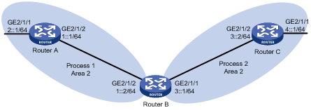

OSPFv3 route redistribution configuration example
As shown in Figure 5:
·     Router A, Router B, and Router C are in Area 2.
·     OSPFv3 process 1 and OSPFv3 process 2 run on Router B. Router B communicates with Router A and Router C through OSPFv3 process 1 and OSPFv3 process 2.
·     Configure OSPFv3 process 2 to redistribute direct routes and the routes from OSPFv3 process 1 on Router B, and set the default metric for redistributed routes to 3. Router C can then learn the routes destined for 1::0/64 and 2::0/64, and Router A cannot learn the routes destined for 3::0/64 or 4::0/64.
Figure 5 Network diagram
# Enable OSPFv3 process 1 on Router A.
[RouterA] ospfv3 1
[RouterA-GigabitEthernet2/1/2] ospfv3 1 area 2
[RouterA-GigabitEthernet2/1/1] ospfv3 1 area 2
# Enable OSPFv3 process 1 and OSPFv3 process 2 on Router B.
[RouterB] ospfv3 1
[RouterB-GigabitEthernet2/1/2] ospfv3 1 area 2
[RouterB] ospfv3 2
[RouterB-ospfv3-2] router-id 3.3.3.3
[RouterB-ospfv3-2] quit
[RouterB-GigabitEthernet2/1/1] ospfv3 2 area 2
# Enable OSPFv3 process 2 on Router C.
[RouterC] ospfv3 2
[RouterC-ospfv3-2] router-id 4.4.4.4
[RouterC-ospfv3-2] quit
[RouterC-GigabitEthernet2/1/2] ospfv3 2 area 2
[RouterC-GigabitEthernet2/1/1] ospfv3 2 area 2
# Display the routing table on Router C.
[RouterC] display ipv6 routing-table
Destinations : 7 Routes : 7
Destination: ::1/128                                     Protocol  : Direct
NextHop    : ::1                                         Preference: 0
Interface  : InLoop0                                     Cost      : 0
Destination: 3::/64                                      Protocol  : Direct
NextHop    : ::                                          Preference: 0
Interface  : GE2/1/2                                     Cost      : 0
Destination: 3::2/128                                    Protocol  : Direct
Destination: 4::/64                                      Protocol  : Direct
Interface  : GE2/1/1                                     Cost      : 0
Destination: 4::1/128                                    Protocol  : Direct
Destination: FE80::/10                                   Protocol  : Direct
Interface  : NULL0                                       Cost      : 0
Destination: FF00::/8                                    Protocol  : Direct
Interface  : NULL0
3.     Configure OSPFv3 route redistribution:
# Configure OSPFv3 process 2 to redistribute direct routes and the routes from OSPFv3 process 1 on Router B.
[RouterB] ospfv3 2
[RouterB-ospfv3-2] default cost 3
[RouterB-ospfv3-2] import-route ospfv3 1
[RouterB-ospfv3-2] import-route direct
Destinations : 9 Routes : 9
Destination: 1::/64                                      Protocol  : O_ASE2
NextHop    : FE80::200:CFF:FE01:1C03                     Preference: 150
Interface  : GE2/1/2                                     Cost      : 3
Destination: 2::/64                                      Protocol  : O_ASE2
Interface  : NULL0
[RouterC] ospfv3 2
[RouterB] ospfv3 2
Destinations : 12 Routes : 12
Interface  : GE2/1/2                                     Cost      : 1
Destination: 2:1:1::/64                                  Protocol  : O_ASE2
Destination: 2:1:2::/64                                  Protocol  : O_ASE2
Destination: 2:1:3::/64                                  Protocol  : O_ASE2
NextHop    : 3::2                                        Preference: 0
NextHop    : 4::1                                        Preference: 0
Interface  : NULL0
4.     Configure ASBR route summarization:
# On Router B, configure OSPFv3 process 2 to advertise a summary route 2::/16.
[RouterB] ospfv3 2
[RouterB-ospfv3-2] asbr-summary 2:: 16
Destination: 2::/16                                      Protocol  : O_ASE2
Interface  : NULL0

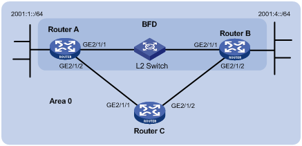

BFD for OSPFv3 configuration example
As shown in Figure 9:
·     Configure OSPFv3 on Router A, Router B and Router C and configure BFD over the link Router A<—>L2 Switch<—>Router B.
·     After the link Router A<—>L2 Switch<—>Router B fails, BFD can quickly detect the failure and notify OSPFv3 of the failure. Then Router A and Router B communicate through Router C.
Figure 9 Network diagram
Device
Interface
IPv6 address
Router A
GE2/1/1
2001::1/64
Router A
GE2/1/2
2001:2::1/64
Router B
GE2/1/1
2001::2/64
Router B
GE2/1/2
2001:3::2/64
Router C
GE2/1/1
2001:2::2/64
Router C
GE2/1/2
2001:3::1/64
# Enable OSPFv3 and set the router ID to 1.1.1.1 on Router A.
[RouterA] ospfv3 1
[RouterA-GigabitEthernet2/1/2] ospfv3 1 area 0
# Enable OSPFv3 and set the router ID to 2.2.2.2 on Router B.
[RouterB] ospfv3 1
[RouterB-GigabitEthernet2/1/2] ospfv3 1 area 0
# Enable OSPFv3 and set the router ID to 3.3.3.3 on Router C.
[RouterC] ospfv3 1
[RouterC-GigabitEthernet2/1/2] ospfv3 1 area 0
3.     Configure BFD:
# Enable BFD and configure BFD parameters on Router A.
[RouterA] bfd session init-mode active
[RouterA-GigabitEthernet2/1/1] ospfv3 bfd enable
[RouterA-GigabitEthernet2/1/1] bfd min-transmit-interval 500
[RouterA-GigabitEthernet2/1/1] bfd min-receive-interval 500
[RouterA-GigabitEthernet2/1/1] bfd detect-multiplier 7
[RouterA-GigabitEthernet2/1/1] return
# Enable BFD and configure BFD parameters on Router B.
[RouterB] bfd session init-mode active
[RouterB-GigabitEthernet2/1/1] ospfv3 bfd enable
[RouterB-GigabitEthernet2/1/1] bfd min-transmit-interval 500
[RouterB-GigabitEthernet2/1/1] bfd min-receive-interval 500
[RouterB-GigabitEthernet2/1/1] bfd detect-multiplier 6
# Display the BFD information on Router A.
<RouterA> display bfd session
 Total Session Num: 1     Up Session Num: 1     Init Mode: Active
 IPv6 Session Working Under Ctrl Mode:
       Local Discr: 1441                 Remote Discr: 1450
         Source IP: FE80::20F:FF:FE00:1202 (link-local address of GigabitEthernet2/1/1 on Router A)
    Destination IP: FE80::20F:FF:FE00:1200 (link-local address of GigabitEthernet2/1/1 on Router B)
     Session State: Up                      Interface: GE2/1/1
         Hold Time: 2319ms
# Display routes destined for 2001:4::0/64 on Router A.
<RouterA> display ipv6 routing-table 2001:4::0 64
Summary Count : 1
Destination: 2001:4::/64                                 Protocol  : O_INTRA
NextHop    : FE80::20F:FF:FE00:1200                      Preference: 10
Interface  : GE2/1/1                                     Cost      : 1
The output shows that Router A communicates with Router B through GigabitEthernet 2/1/1. Then the link over GigabitEthernet 2/1/1 fails.
Summary Count : 1
NextHop    : FE80::BAAF:67FF:FE27:DCD0                   Preference: 10
Interface  : GE2/1/2                                     Cost      : 2
