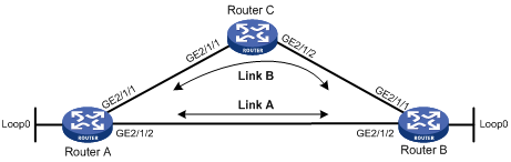

Configuring RIPng FRR
A link or router failure on a path can cause packet loss and even routing loop until RIPng completes routing convergence based on the new network topology. FRR enables fast rerouting to minimize the impact of link or node failures.
Figure 1 Network diagram for RIPng FRR
As shown in Figure 1, configure FRR on Router B by using a routing policy to specify a backup next hop. When the primary link fails, RIPng directs packets to the backup next hop. At the same time, RIPng calculates the shortest path based on the new network topology. Then, the device forwards packets over that path after network convergence.
·     RIPng FRR is available only when the state of the primary link (with Layer 3 interfaces staying up) changes from bidirectional to unidirectional or down.
·     RIPng FRR is only effective for RIPng routes that are learned from directly connected neighbors.
·     Equal-cost routes do not support RIPng FRR.

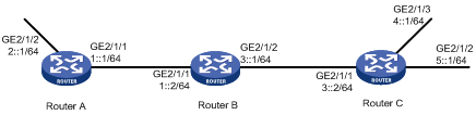

As shown in Figure 2, Router A, Router B, and Router C learn IPv6 routing information through RIPng.
Configure Router B to filter the route (2::/64) learned from Router A. The route will not be added to the routing table of Router B, and Router B forwards only the route 4::/64 to Router A.
Figure 2 Network diagram

1.     Configure IPv6 addresses for interfaces. (Details not shown.)
2.     Configure basic RIPng:
# Configure Router A.
<RouterA> system-view
[RouterA] ripng 1
[RouterA-ripng-1] quit
[RouterA] interface gigabitethernet 2/1/1
[RouterA-GigabitEthernet2/1/1] ripng 1 enable
[RouterA-GigabitEthernet2/1/1] quit
[RouterA] interface gigabitethernet 2/1/2
[RouterA-GigabitEthernet2/1/2] ripng 1 enable
[RouterA-GigabitEthernet2/1/2] quit
# Configure Router B.
<RouterB> system-view
[RouterB] ripng 1
[RouterB-ripng-1] quit
[RouterB] interface gigabitethernet 2/1/1
[RouterB-GigabitEthernet2/1/1] ripng 1 enable
[RouterB-GigabitEthernet2/1/1] quit
[RouterB] interface gigabitethernet 2/1/2
[RouterB-GigabitEthernet2/1/2] ripng 1 enable
[RouterB-GigabitEthernet2/1/2] quit
# Configure Router C.
<RouterC> system-view
[RouterC] ripng 1
[RouterC-ripng-1] quit
[RouterC] interface gigabitethernet 2/1/1
[RouterC-GigabitEthernet2/1/1] ripng 1 enable
[RouterC-GigabitEthernet2/1/1] quit
[RouterC] interface gigabitethernet 2/1/2
[RouterC-GigabitEthernet2/1/2] ripng 1 enable
[RouterC-GigabitEthernet2/1/2] quit
[RouterC] interface gigabitethernet 2/1/3
[RouterC-GigabitEthernet2/1/3] ripng 1 enable
[RouterC-GigabitEthernet2/1/3] quit
# Display the RIPng routing table on Router B.
[RouterB] display ripng 1 route
   Route Flags: A - Aging, S - Suppressed, G - Garbage-collect, D – Direct
                O - Optimal, F - Flush to RIB
 Peer FE80::20F:E2FF:FE23:82F5 on GigabitEthernet2/1/1
 Destination 2::/64,
     via FE80::20F:E2FF:FE23:82F5, cost 1, tag 0, AOF, 6 secs
 Peer FE80::20F:E2FF:FE00:100  on GigabitEthernet2/1/2
 Destination 4::/64,
     via FE80::20F:E2FF:FE00:100, cost 1, tag 0, AOF, 11 secs
 Destination 5::/64,
 Local route
 Destination 1::/64,
     via ::, cost 0, tag 0, DOF
 Destination 3::/64,
# Display the RIPng routing table on Router A.
[RouterA] display ripng 1 route
 Peer FE80::200:2FF:FE64:8904 on GigabitEthernet2/1/1
 Destination 3::/64,
     via FE80::200:2FF:FE64:8904, cost 1, tag 0, AOF, 31 secs
 Destination 4::/64,
     via FE80::200:2FF:FE64:8904, cost 2, tag 0, AOF, 31 secs
 Destination 5::/64,
 Local route
 Destination 2::/64,
 Destination 1::/64,
3.     Configure route filtering:
# Use IPv6 prefix lists on Router B to filter received and redistributed routes.
[RouterB] ipv6 prefix-list aaa permit 4:: 64
[RouterB] ipv6 prefix-list bbb deny 2:: 64
[RouterB] ipv6 prefix-list bbb permit :: 0 less-equal 128
[RouterB] ripng 1
[RouterB-ripng-1] filter-policy prefix-list aaa export
[RouterB-ripng-1] filter-policy prefix-list bbb import
# Display the RIPng routing tables on Router B and Router A.
 Peer FE80::1:1 on GigabitEthernet2/1/1
 Peer FE80::3:1 on GigabitEthernet2/1/2
 Destination 4::/64,
     via FE80::2:2, cost 1, tag 0, AOF, 11 secs
 Destination 5::/64,
 Local route
 Destination 1::/64,
 Destination 3::/64,
 Peer FE80::2:1 on GigabitEthernet2/1/1
 Destination 4::/64,
     via FE80::1:1, cost 2, tag 0, AOF, 2 secs

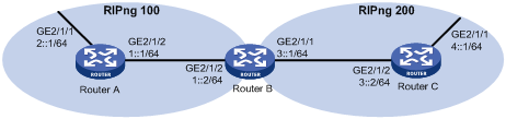

As shown in Figure 3, Router B communicates with Router A through RIPng 100 and with Router C through RIPng 200.
Configure route redistribution on Router B, so the two RIPng processes can redistribute routes from each other.
Figure 3 Network diagram
# Enable RIPng 100 on Router A.
[RouterA] ripng 100
[RouterA-ripng-100] quit
[RouterA-GigabitEthernet2/1/1] ripng 100 enable
[RouterA-GigabitEthernet2/1/2] ripng 100 enable
# Enable RIPng 100 and RIPng 200 on Router B.
[RouterB] ripng 100
[RouterB-ripng-100] quit
[RouterB-GigabitEthernet2/1/2] ripng 100 enable
[RouterB] ripng 200
[RouterB-ripng-200] quit
[RouterB-GigabitEthernet2/1/1] ripng 200 enable
#  Enable RIPng 200 on Router C.
[RouterC] ripng 200
[RouterC-GigabitEthernet2/1/1] ripng 200 enable
[RouterC-GigabitEthernet2/1/2] ripng 200 enable
# Display the routing table on Router A.
[RouterA] display ipv6 routing-table
Destinations : 7 Routes : 7
Destination: ::1/128                                     Protocol  : Direct
NextHop    : ::1                                         Preference: 0
Interface  : InLoop0                                     Cost      : 0
Destination: 1::/64                                      Protocol  : Direct
NextHop    : 1::1                                        Preference: 0
Interface  : GE2/1/2                                     Cost      : 0
Destination: 1::1/128                                    Protocol  : Direct
Destination: 2::/64                                      Protocol  : Direct
NextHop    : 2::1                                        Preference: 0
Interface  : GE2/1/1                                     Cost      : 0
Destination: 2::1/128                                    Protocol  : Direct
Destination: FE80::/10                                   Protocol  : Direct
NextHop    : ::                                          Preference: 0
Interface  : NULL0                                       Cost      : 0
Destination: FF00::/8                                    Protocol  : Direct
3.     Configure RIPng route redistribution:
# Configure route redistribution between the two RIPng processes on Router B.
[RouterB] ripng 100
[RouterB-ripng-100] import-route ripng 200
[RouterB] ripng 200
[RouterB-ripng-200] import-route ripng 100

[RouterC] ipsec transform-set protrf1
# Specify the ESP encryption and authentication algorithms.
[RouterC-ipsec-transform-set-protrf1] esp encryption-algorithm 3des-cbc
[RouterC-ipsec-transform-set-protrf1] esp authentication-algorithm md5
# Specify the encapsulation mode as transport.
[RouterC-ipsec-transform-set-protrf1] encapsulation-mode transport
[RouterC-ipsec-transform-set-protrf1] quit
# Create a manual IPsec profile named profile001.
[RouterC] ipsec profile profile001 manual
# Reference IPsec transform set protrf1.
[RouterC-ipsec-profile-profile001-manual] transform-set protrf1
# Configure the inbound and outbound SPIs for ESP.
[RouterC-ipsec-profile-profile001-manual] sa spi inbound esp 256
[RouterC-ipsec-profile-profile001-manual] sa spi outbound esp 256
# Configure the inbound and outbound SA keys for ESP.
[RouterC-ipsec-profile-profile001-manual] sa string-key inbound esp simple abc
[RouterC-ipsec-profile-profile001-manual] sa string-key outbound esp simple abc
[RouterC-ipsec-profile-profile001-manual] quit
4.     Apply the IPsec profiles to the RIPng process:
[RouterA] ripng 1
[RouterA-ripng-1] enable ipsec-profile profile001
[RouterB] ripng 1
[RouterB-ripng-1] enable ipsec-profile profile001
[RouterC] ripng 1
[RouterC-ripng-1] enable ipsec-profile profile001
# Verify that RIPng packets between Routers A, B, and C are protected by IPsec. (Details not shown.)
