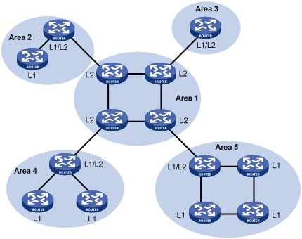

Level-1 and Level-2
·     Level-1 router—A Level-1 router establishes neighbor relationships with Level-1 and Level-1-2 routers in the same area. It maintains an LSDB comprising intra-area routing information. A Level-1 router forwards packets destined for external areas to the nearest Level-1-2 router. Level-1 routers in different areas cannot establish neighbor relationships.
·     Level-2 router—A Level-2 router establishes neighbor relationships with Level-2 and Level-1-2 routers in the same area or in different areas. It maintains a Level-2 LSDB containing inter-area routing information. All the Level-2 and Level-1-2 routers must be contiguous to form the backbone of the IS-IS routing domain. Level-2 routers can establish neighbor relationships even if they are in different areas.
·     Level-1-2 router—A router with both Level-1 and Level-2 router functions is a Level-1-2 router. It can establish Level-1 neighbor relationships with Level-1 and Level-1-2 routers in the same area. It can establish Level-2 neighbor relationships with Level-2 and Level-1-2 routers in different areas. A Level-1 router can reach other areas only through a Level-1-2 router. The Level-1-2 router maintains two LSDBs, a Level-1 LSDB for intra-area routing and a Level-2 LSDB for inter-area routing.

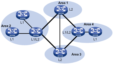

Figure 2 shows one IS-IS network topology. Area 1 is the backbone that comprises a set of Level-2 routers. The other four areas are non-backbone areas connected to the backbone through Level-1-2 routers.
Figure 2 IS-IS topology 1

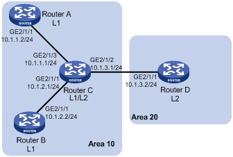

Figure 3 shows another IS-IS topology. The Level-1-2 routers connect to the Level-1 and Level-2 routers, and form the IS-IS backbone together with the Level-2 routers. No area is defined as the backbone in this topology. The backbone comprises all contiguous Level-2 and Level-1-2 routers in different areas. The IS-IS backbone does not need to be a specific area.
Figure 3 IS-IS topology 2
Both the Level-1 and Level-2 routers use the SPF algorithm to generate the shortest path tree.

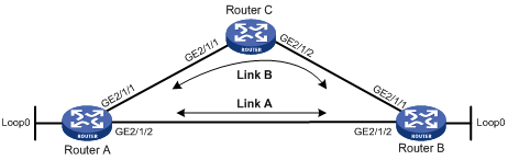

Configuring IS-IS FRR
A link or router failure on a path can cause packet loss and routing loop. IS-IS FRR enables fast rerouting to minimize the failover time.
Figure 8 Network diagram for IS-IS FRR
In Figure 8, after you enable FRR on Router B, IS-IS automatically calculates or designates a backup next hop when a link failure is detected. In this way, packets are directed to the backup next hop to reduce traffic recovery time. Meanwhile, IS-IS calculates the shortest path based on the new network topology, and forwards packets over the path after network convergence.
You can assign a backup next hop for IS-IS FRR through the following ways:
·     Enable IS-IS FRR to calculate a backup next hop through Loop Free Alternate (LFA) calculation.
·     Designate a backup next hop with a routing policy for routes matching specific criteria.

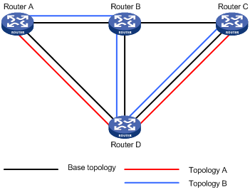

Configuring IS-IS MTR
Typically, service packets with the same destination are forwarded over the same link. To forward them over different links, you can use one of the following methods:
·     Policy-based routing (PBR). Use PBR to change the next hop.
·     Traffic engineering (TE).
·     Multi-Topology Routing (MTR).
MTR is based on topology and is easier to deploy than TE. MTR splits the topology of a specific address family (for example, IPv4) into multiple topologies, and forwards traffic on a per-topology basis.
For more information about IPv6 IS-IS MTR, see "Configuring IPv6 IS-IS."
Figure 9 Network diagram
As shown in Figure 9, the base topology is split into two topologies, topology A and topology B. You can forward voice traffic through topology A and video traffic through topology B.
Router B does not belong to topology A. In topology B, the links between Router A and Router D and the links between Router B and Router C do not exist. Route calculation and traffic forwarding are performed in each topology independently.

IS-IS configuration examples
Basic IS-IS configuration example
Network requirements
As shown in Figure 10, Router A, Router B, Router C, and Router D reside in an AS.
Router A and Router B are Level-1 routers, Router D is a Level-2 router, and Router C is a Level-1-2 router connecting two areas. Router A, Router B, and Router C are in area 10, and Router D is in area 20.
Figure 10 Network diagram
Configuration procedure
1.     Configure IP addresses for interfaces. (Details not shown.)
2.     Configure IS-IS:
# Configure Router A
<RouterA> system-view
[RouterA] isis 1
[RouterA-isis-1] is-level level-1
[RouterA-isis-1] network-entity 10.0000.0000.0001.00
[RouterA-isis-1] quit
[RouterA] interface gigabitethernet 2/1/1
[RouterA-GigabitEthernet2/1/1] isis enable 1
[RouterA-GigabitEthernet2/1/1] quit
# Configure Router B.
<RouterB> system-view
[RouterB] isis 1
[RouterB-isis-1] is-level level-1
[RouterB-isis-1] network-entity 10.0000.0000.0002.00
[RouterB-isis-1] quit
[RouterB] interface gigabitethernet 2/1/1
[RouterB-GigabitEthernet2/1/1] isis enable 1
[RouterB-GigabitEthernet2/1/1] quit
# Configure Router C.
<RouterC> system-view
[RouterC] isis 1
[RouterC-isis-1] network-entity 10.0000.0000.0003.00
[RouterC-isis-1] quit
[RouterC] interface gigabitethernet 2/1/3
[RouterC-GigabitEthernet2/1/3] isis enable 1
[RouterC-GigabitEthernet2/1/3] quit
[RouterC] interface gigabitethernet 2/1/1
[RouterC-GigabitEthernet2/1/1] isis enable 1
[RouterC-GigabitEthernet2/1/1] quit
[RouterC] interface gigabitethernet 2/1/2
[RouterC-GigabitEthernet2/1/2] isis enable 1
[RouterC-GigabitEthernet2/1/2] quit
# Configure Router D
<RouterD> system-view
[RouterD] isis 1
[RouterD-isis-1] is-level level-2
[RouterD-isis-1] network-entity 20.0000.0000.0004.00
[RouterD-isis-1] quit
[RouterD] interface gigabitethernet 2/1/1
[RouterD-GigabitEthernet2/1/1] isis enable 1
[RouterD-GigabitEthernet2/1/1] quit
[RouterD] interface gigabitethernet 2/1/2
[RouterD-GigabitEthernet2/1/2] isis enable 1
[RouterD-GigabitEthernet2/1/2] quit

# Display the IS-IS routing information on each router.
[RouterA] display isis route
                         Route information for IS-IS(1)
                         Level-1 IPv4 Forwarding Table
 IPv4 Destination     IntCost    ExtCost ExitInterface   NextHop         Flags
 10.1.1.0/24          10         NULL    GE2/1/1         Direct          D/L/-
 10.1.2.0/24          20         NULL    GE2/1/1         10.1.1.1        R/-/-
 192.168.0.0/24       20         NULL    GE2/1/1         10.1.1.1        R/-/-
 0.0.0.0/0            10         NULL    GE2/1/1         10.1.1.1        R/-/-
      Flags: D-Direct, R-Added to Rib, L-Advertised in LSPs, U-Up/Down Bit Set
[RouterC] display isis route
 10.1.2.0/24          10         NULL    GE2/1/3         Direct          D/L/-
 192.168.0.0/24       10         NULL    GE2/1/2         Direct          D/L/-
                         Level-2 IPv4 Forwarding Table
 10.1.1.0/24          10         NULL                                    D/L/-
 10.1.2.0/24          10         NULL                                    D/L/-
 192.168.0.0/24       10         NULL                                    D/L/-
 172.16.0.0/16        20         NULL    GE2/1/2         192.168.0.2     R/-/-
[RouterD] display isis route
 10.1.1.0/24          20         NULL    GE2/1/2         192.168.0.1     R/-/-
 10.1.2.0/24          20         NULL    GE2/1/2         192.168.0.1     R/-/-
 172.16.0.0/16        10         NULL    GE2/1/1         Direct          D/L/-
The output shows that the routing table of Level-1 routers contains a default route with the next hop as the Level-1-2 router. The routing table of Level-2 router contains all Level-1 and Level-2 routes.

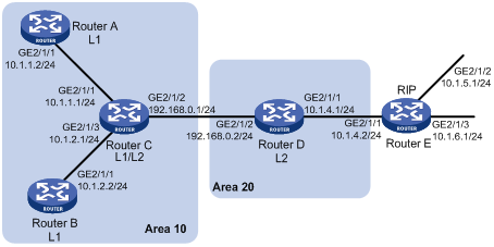

IS-IS route redistribution configuration example
As shown in Figure 12, Router A, Router B, Router C, and Router D reside in the same AS. They use IS-IS to interconnect. Router A and Router B are Level-1 routers, Router D is a Level-2 router, and Router C is a Level-1-2 router.
Redistribute RIP routes into IS-IS on Router D.
Figure 12 Network diagram
2.     Configure basic IS-IS:
# Configure Router A.
[RouterA] isis 1
[RouterB] isis 1
[RouterC] isis 1
# Configure Router D.
[RouterD] isis 1

IS-IS authentication configuration example
As shown in Figure 13, Router A, Router B, Router C, and Router D reside in the same IS-IS routing domain.
Router A, Router B, and Router C belong to Area 10, and Router D belongs to Area 20.
·     Configure neighbor relationship authentication between neighbors.
·     Configure area authentication in Area 10 to prevent untrusted routes from entering into the area.
·     Configure routing domain authentication on Router C and Router D to prevent untrusted routes from entering the routing domain.
Figure 13 Network diagram
[RouterA] isis 1
[RouterB] isis 1
[RouterC] isis 1
[RouterD] isis 1
[RouterD-isis-1] network-entity 20.0000.0000.0001.00
3.     Configure neighbor relationship authentication between neighbors:
# Set the authentication mode to MD5 and set the plaintext key to eRq on GigabitEthernet 2/1/1 of Router A and on GigabitEthernet 2/1/3 of Router C.
[RouterA-GigabitEthernet2/1/1] isis authentication-mode md5 plain eRg
[RouterC-GigabitEthernet2/1/3] isis authentication-mode md5 plain eRg
# Set the authentication mode to MD5 and set the plaintext key to t5Hr on GigabitEthernet 2/1/1 of Router B and on GigabitEthernet 2/1/1 of Router C.
[RouterB-GigabitEthernet2/1/1] isis authentication-mode md5 plain t5Hr
[RouterC-GigabitEthernet2/1/1] isis authentication-mode md5 plain t5Hr
# Set the authentication mode to MD5 and set the plaintext key to hSec on GigabitEthernet 2/1/1 of Router D and on GigabitEthernet 2/1/2 of Router C.
[RouterC-GigabitEthernet2/1/2] isis authentication-mode md5 plain hSec
[RouterD-GigabitEthernet2/1/1] isis authentication-mode md5 plain hSec
4.     Set the area authentication mode to MD5 and set the plaintext key to 10Sec on Router A, Router B, and Router C.
[RouterA] isis 1
[RouterA-isis-1] area-authentication-mode md5 plain 10Sec
[RouterB] isis 1
[RouterB-isis-1] area-authentication-mode md5 plain 10Sec
[RouterC] isis 1
[RouterC-isis-1] area-authentication-mode md5 plain 10Sec
5.     Set routing domain authentication mode to MD5 and set the plaintext key to 1020Sec on Router C and Router D.
[RouterC] isis 1
[RouterC-isis-1] domain-authentication-mode md5 plain 1020Sec
[RouterD] isis 1
[RouterD-isis-1] domain-authentication-mode md5 plain 1020Sec

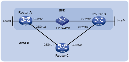

BFD for IS-IS configuration example
·     As shown in Figure 16, run IS-IS on Router A, Router B and Router C so that they can reach each other at the network layer.
·     After the link over which Router A and Router B communicate through the Layer 2 switch fails, BFD can quickly detect the failure and notify IS-IS of the failure. Router A and Router B then communicate through Router C.
Figure 16 Network diagram
Device
Interface
IP address
Device
Interface
IP address
Router A
GE2/1/1
192.168.0.102/24
Router B
GE2/1/1
192.168.0.100/24
GE2/1/2
10.1.1.102/24
GE2/1/2
13.1.1.1/24
Loop0
121.1.1.1/32
Loop0
120.1.1.1/32
Router C
GE2/1/1
10.1.1.100/24
GE2/1/2
13.1.1.2/24
[RouterA] isis
[RouterA] interface loopback 0
[RouterA-LoopBack0] isis enable
[RouterA-LoopBack0] quit
[RouterA] interface gigabitethernet 2/1/2
[RouterA-GigabitEthernet2/1/2] isis enable
[RouterA-GigabitEthernet2/1/2] quit
[RouterB] isis
[RouterB] interface loopback 0
[RouterB-LoopBack0] isis enable
[RouterB-LoopBack0] quit
[RouterB] interface gigabitethernet 2/1/2
[RouterB-GigabitEthernet2/1/2] isis enable
[RouterB-GigabitEthernet2/1/2] quit
[RouterC] isis
3.     Configure BFD functions:
# Enable BFD and configure BFD parameters on Router A.
[RouterA] bfd session init-mode active
[RouterA-GigabitEthernet2/1/1] isis bfd enable
[RouterA-GigabitEthernet2/1/1] bfd min-receive-interval 500
[RouterA-GigabitEthernet2/1/1] bfd min-transmit-interval 500
[RouterA-GigabitEthernet2/1/1] bfd detect-multiplier 7
# Enable BFD and configure BFD parameters on Router B.
[RouterB] bfd session init-mode active
[RouterB-GigabitEthernet2/1/1] isis bfd enable
[RouterB-GigabitEthernet2/1/1] bfd min-receive-interval 500
[RouterB-GigabitEthernet2/1/1] bfd min-transmit-interval 500
[RouterB-GigabitEthernet2/1/1] bfd detect-multiplier 8
# Display the BFD session information on Router A.
<RouterA> display bfd session
 Total Session Num: 1     Up Session Num: 1     Init Mode: Active
 IPv4 Session Working Under Ctrl Mode:
 LD/RD          SourceAddr      DestAddr        State    Holdtime    Interface
 3/1            192.168.0.102   192.168.0.100   Up       1700ms      GE2/1/1
# Display routes destined for 120.1.1.1/32 on Router A.
<RouterA> display ip routing-table 120.1.1.1 verbose
Summary Count : 1
Destination: 120.1.1.1/32
   Protocol: IS_L1
 Process ID: 1
  SubProtID: 0x1                     Age: 04h20m37s
       Cost: 10               Preference: 10
      IpPre: N/A              QosLocalID: N/A
        Tag: 0                     State: Active Adv
  OrigTblID: 0x0                 OrigVrf: default-vrf
    TableID: 0x2                  OrigAs: 0
      NibID: 0x26000002           LastAs: 0
     AttrID: 0xffffffff         Neighbor: 0.0.0.0
      Flags: 0x1008c         OrigNextHop: 192.168.0.100
      Label: NULL            RealNextHop: 192.168.0.100
    BkLabel: NULL              BkNextHop: N/A
  Tunnel ID: Invalid           Interface: GigabitEthernet2/1/1
BkTunnel ID: Invalid         BkInterface: N/A
   FtnIndex: 0x0            TrafficIndex: N/A
  Connector: N/A
The output shows that Router A and Router B communicate through Ethernet 1/1. Then the link over Ethernet 1/1 fails.
Summary Count : 1
   Protocol: IS_L1
 Process ID: 1
       Cost: 20               Preference: 10
      Flags: 0x1008c         OrigNextHop: 10.1.1.100
      Label: NULL            RealNextHop: 10.1.1.100
  Tunnel ID: Invalid           Interface: GigabitEthernet2/1/2
  Connector: N/A
The output shows that Router A and Router B communicate through Ethernet 1/2.
IS-IS FRR configuration example
As shown in Figure 17, Router A, Router B, and Router C reside in the same IS-IS routing domain.
·     Run IS-IS on all the routers to interconnect them with each other.
·     Configure IS-IS FRR so that when Link A fails, traffic can be switched to Link B immediately.
Figure 17 Network diagram
Device
Interface
IP address
Device
Interface
IP address
Router A
GE2/1/1
12.12.12.1/24
Router B
GE2/1/1
24.24.24.4/24
GE2/1/2
13.13.13.1/24
GE2/1/2
13.13.13.2/24
Loop0
1.1.1.1/32
Loop0
4.4.4.4/32
Router C
GE2/1/1
12.12.12.2/24
GE2/1/2
24.24.24.2/24
1.     Configure IP addresses and subnet masks for interfaces on the routers. (Details not shown.)
2.     Configure IS-IS on the routers to make sure Router A, Router B, and Router C can communicate with each other at the network layer. (Details not shown.)
3.     Configure IS-IS FRR:
Enable IS-IS FRR to calculate a backup next hop through LFA calculation, or designate a backup next hop by using a routing policy.
¡     (Method 1.) Enable IS-IS FRR to calculate a backup next hop through LFA calculation:
[RouterA] isis 1
[RouterA-isis-1] address-family ipv4
[RouterA-isis-1-ipv4] fast-reroute lfa
[RouterA-isis-1-ipv4] quit
[RouterB] isis 1
[RouterB-isis-1] address-family ipv4
[RouterB-isis-1-ipv4] fast-reroute lfa
[RouterB-isis-1-ipv4] quit
¡     (Method 2.) Enable IS-IS FRR to designate a backup next hop by using a routing policy:
[RouterA] ip prefix-list abc index 10 permit 4.4.4.4 32
[RouterA] route-policy frr permit node 10
[RouterA-route-policy-frr-10] if-match ip address prefix-list abc
[RouterA-route-policy-frr-10] apply fast-reroute backup-interface gigabitethernet 2/1/1 backup-nexthop 12.12.12.2
[RouterA-route-policy-frr-10] quit
[RouterA] isis 1
[RouterA-isis-1-ipv4] fast-reroute route-policy frr
[RouterB] ip prefix-list abc index 10 permit 1.1.1.1 32
[RouterB] route-policy frr permit node 10
[RouterB-route-policy-frr-10] if-match ip address prefix-list abc
[RouterB-route-policy-frr-10] apply fast-reroute backup-interface gigabitethernet 2/1/1 backup-nexthop 24.24.24.2
[RouterB-route-policy-frr-10] quit
[RouterB] isis 1
[RouterB-isis-1-ipv4] fast-reroute route-policy frr
# Display route 4.4.4.4/32 on Router A to view the backup next hop information.
[RouterA] display ip routing-table 4.4.4.4 verbose
Summary Count : 1
Destination: 4.4.4.4/32
   Protocol: IS_L1
 Process ID: 1
      Flags: 0x1008c         OrigNextHop: 13.13.13.2
      Label: NULL            RealNextHop: 13.13.13.2
    BkLabel: NULL              BkNextHop: 12.12.12.2
BkTunnel ID: Invalid         BkInterface: GigabitEthernet2/1/1
  Connector: N/A
# Display route 1.1.1.1/32 on Router B to view the backup next hop information.
[RouterB] display ip routing-table 1.1.1.1 verbose
Summary Count : 1
Destination: 1.1.1.1/32
   Protocol: IS_L1
 Process ID: 1
      Flags: 0x1008c         OrigNextHop: 13.13.13.1
      Label: NULL            RealNextHop: 13.13.13.1
    BkLabel: NULL              BkNextHop: 24.24.24.2
  Connector: N/A
