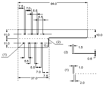

I. Label for signal cables
The label for signal cables is L-shaped with fixed dimensions, as shown in Figure B-1 (expressed in mm).
(1) Dividing line
(2) Cut dotted line
Figure B-1 Label for signal cables
The dividing lines on the label help to specify more clearly the position of a cable. For example, there is one between the cabinet number and the frame number and another one between the frame number and the slot number. The dividing line is 1.5mm´0.6mm in size with the color of PONTONE 656c (light blue).
The cut dotted line helps to fold the label when affixing it to the cable, and its size is 1.0mm´2.0mm.
There is a mark “TO:” (upside down in the figure) at the lower right corner of the label. The mark is used to identify the opposite end of the cable on which the label is affixed.

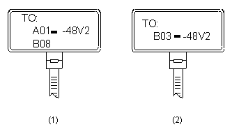

II. Label for power cables
The label for power cables should be attached to the identification plate on the cable ties that are bundled to the cable. The identification plate has an embossment of 0.2mm´0.6mm around (symmetric on both sides), and the area in the middle is for affixing the label, as shown in Figure B-2 (expressed in mm):
(1) Cable tie
(2) Label
(3) Dividing line on the label
Figure B-2 Label for power cables

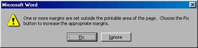

3)         If the warning prompt as shown in Figure B-3 appears before printing, click <Ignore> to continue the printing.
Figure B-3 Warning prompt before printing
If the printout conforms to the requirement, print it to label paper. If the printout does not conform, adjust the page setup and try the printing again, until the correct printout is produced. The method of adjusting the page setup is as follows:

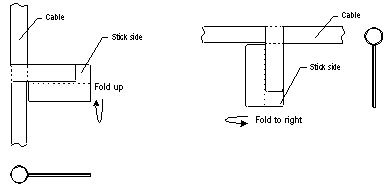

B.1.5  Affixing Labels
After printing or writing the label, remove the label from the bottom page and affix it to the signal cable, or the identification plate of the power cable.

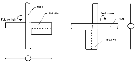

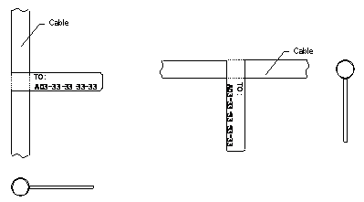

I. Affixing the label to the signal cable
The steps to affix the label to the cable are shown in Figure B-5, Figure B-6 and Figure B-7. The finished labels should be on the right or top of the cables, according to different cabling methods. The left part of the figures shows the method to affix the label when the cable is laid vertically, while the right part of the figures shows the method to affix the label when the cable is laid horizontally.
The label is affixed 2cm from the connector on the signal cable. In special cases, for example, to avoid cable bent or affecting other cables, other positions are allowed to affix the labels.
1)         Stick the label to the proper position on the cable, fold the narrow part of the label according to the directions shown in Figure B-5.
Figure B-5 Stick the label onto proper position of the signal cable
The length of the narrow part is based on an external cable diameter of 2.6mm, after this part has been stuck to the back of the label, it may not overlap the entire printed part.
2)         Fold the printed part along the dotted line according to the directions shown in Figure B-6.
Figure B-6 Fold up the label
3)         After the printed part of the label has been folded up, the narrow part of the label should be covered completely, as shown in Figure B-7.
Figure B-7 Appearance of affixed labels on signal cables

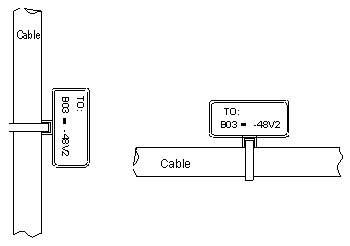

II. Affixing the label to the power cable
Remove the label from the bottom page, then affix it to the identification plate on the cable tie. The label should be stuck to the rectangular flute, and should be stuck to only one side of the identification plate. Make sure to affix the labels on the same side of the identification plates. The cable ties are bundled at 2cm from the connectors, and other positions are allowed in special circumstances.
Cable ties should be bundled on both ends of a cable. After the bundling, the finished identification plate should be on top of the cable in horizontal cabling, or on the right side of the cable in vertical cabling. Make sure the label is facing out, as shown in Figure B-8.
Figure B-8 Appearance of affixed labels on power cables

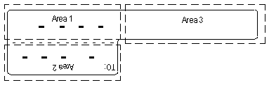

II. For signal cables
The two sides of the label affixed on the signal cable carry information about the location of the ports connected to both ends of the cable, as shown in Figure B-9.
The information is given like this:
l           Area 1 contains the location information of local end of the cable.
l           Area 2 (with the mark "TO:") contains the location information of the opposite end of the cable.
l           Area 3 has been folded up inside the label.
Figure B-9 Printed parts on the label for signal cables
Seen from the cabling end of the equipment, the text part of the label is on the right side of the cable. The side with “TO:” that is facing outside carries the location information of the opposite end; and the other side carries the location information of the local end. Therefore, the information in Area 1 at one end is the same as the information in Area 2 at the other end of the cable, and vice versa. In other words, the local information at one end is called the opposite information at the other end.

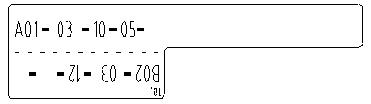

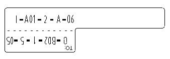

II. Example of the Label
Figure B-10 shows the label on the Ethernet cable:
Figure B-10 Example of the label on the Ethernet cable
“A01-03-10-05” indicates that on the local end of the Ethernet cable is connected with Ethernet Port 05, Slot 10, Frame 03 of the cabinet on Row A, Column 01 in the machine room.
“B02-03-12” indicates that the opposite end of the Ethernet cable is connected with Ethernet Port 12, Frame 03 of the cabinet on Row B, Column 02 in the machine room.

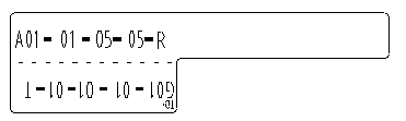

II. Example of the label
Figure B-11 shows the label on the optical fiber between two devices:
Figure B-11 Example of the label on the optical fiber between two devices
“A01-01-05-05-R” indicates that the local end of the optical fiber is connected with Optical Receiving Interface 05 on Slot 5, Frame 01 in the cabinet on Row A, Column 01 in the machine room.
“G01-01-01-01-T” indicates that the opposite end of the optical fiber is connected with Optical Transmitting Interface 01 on Slot 01, Frame 01 in the cabinet on Row G, Column 01 in the machine room

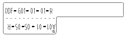

B.3.2  Labels for the Fiber that Connects the Device and the ODF
I. Meaning of the label
Table B-4 shows the information on both sides of the labels affixed to the optical fiber that connects the device and the ODF.
Table B-4 Information on labels affixed to the fiber between the device and the ODF
Figure B-12 shows the label on the optical fiber between the device and the ODF.
Figure B-12 Example of the label on the optical fiber between the device and the ODF
“ODF-G01-01-01-R” indicates that the local end of the optical fiber is connected with the optical receiving terminal on Row 01, Column 01 of the ODF in Row G Column 01 in the machine room.
“A01-01-05-05-R” indicates that the opposite end of the optical fiber is connected with Optical Receiving Interface 5 on Slot 05, frame 01 in the cabinet on Row A, Column 01 in the machine room.
Make sure that labels are affixed in correction direction. That is, after the cable ties are bundled onto the cable, the identification plates with the labels should face up, and the text on the labels in the same cabinet should be in the same direction, as shown in Figure B-13.
Figure B-13 Example of the labels on the DC power cable
In Figure B-13, (1) indicates the label on the loaded cabinet side, which carries the information about the position of the cable on the power distribution box. (2) indicates the label on the distribution box side, which carries the information about the position of the cable on the loaded cabinet side.
On the loaded cabinet side, the label marked with “A01/B08--48V2” on the cable indicates that the cable is -48V2 DC supply, which is from the 8th connecter on the second row of -48V bus bar in the cabinet on Row A, and Column 1 in the machine room.
On the distribution box side, the label marked with “B03--48V2” indicates that the cable is -48V2 DC supply, which is from the loaded cabinet on Row B, Column 03 in the machine room.
