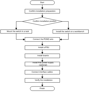

3.1  Installation Flow
Figure 3-1 Installation flow

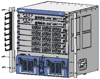

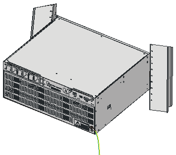

3.3.2  Installing the Cable Management Bracket and Rack-Mounting Ears
For your convenience, a cable management bracket is shipped with the S9500 series. Take the following steps to install the cable management bracket.
1)         Facing the LPU slots of the switch, insert the shipped cable management bracket into the left rack-mounting ear on which there is a recessed hole for installing the cable management bracket, and fix it with screws. (One cable management bracket for the S9502/S9505/S9508/S9508V and two for the S9512).
2)         Install the rack-mounting ears onto the both sides of the switch, as shown in Figure 3-2.
Figure 3-2 Install the cable management bracket and rack-mounting ears
3.3.3  Mounting the Switch
&  Note:

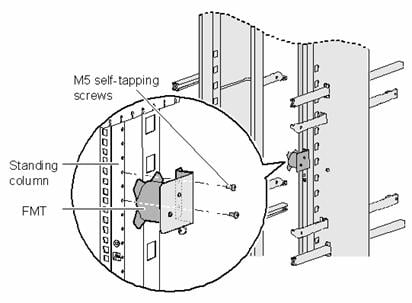

Make sure that supports have been installed in corresponding positions and the supports can bear the switch weight.

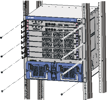

1)         Two people are required to lift the switch. Put the switch on the supports and slide it into the cabinet until the rack-mounting ears touch against the front square-holed columns.
2)         Fix the rack mounting ears onto the square-holed columns with screws.
Figure 3-3 Install the switch into a standard 19-inch rack

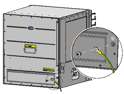

3.5  Connecting the PGND Wire
  Caution:
For the safety of operators and equipment, the switch must be well grounded. The resistance reading between switch chassis and the ground must be less than 1 ohm.
3.5.1  In a common grounding environment
Follow these steps to connect the PGND wire in a common grounding environment:
1)         Remove the screw from the grounding hole in the switch chassis.
2)         Wear the connector of the PGND wire accompanied with the switch on the grounding screw.
3)         Insert the grounding screw into the grounding hole and screw it down.
4)         Connect the other end of the PGND wire to the ground bar of the switch, as shown in Figure 3-4.
Figure 3-4 Connect the PGND wire

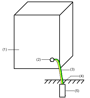

l           If there is no ground bar but earth nearby and the grounding body is allowed to be buried, you can simply hammer an angle iron or steel pipe no shorter than 0.5 m into the earth.
  Caution:
The yellow-green PGND wire should be welded with the angle iron (steel pipe) and the joint should be processed against eroding. (For the S9500 series, the grounding screw is on the rear panel. Connect it as illustrated in Figure 3-5).
(1) Rear panel of the switch
(2) Grounding screw
(3) PGND wire
(4) Ground
(5) Angle steel (steel pipe)
Figure 3-6 Ground the switch when allowed to bury grounding body nearby

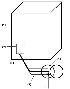

Make sure that the PE wire of the AC power supply has been well grounded at the side of the power distribution room or AC power supply transformer.
(1) Front panel of the switch
(2) AC power input
(3) 3-core AC power cord
(4) Transformer
(5) Protection earth (PE) wire
Figure 3-7 Ground the switch through the AC PE wire

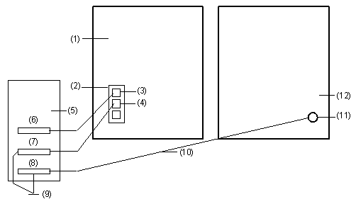

l           If no ground bar or condition for burying the grounding body is available, a DC-powered Ethernet switch can be grounded through the PGND strip of the power distribution frame (PDF).
  Caution:
Make sure the RTN wire is well connected to the ground at the DC output of the PDF.
(2) DC power input
(3) NEG terminal
(4) RTN terminal
(5) PDF
(6) -48V strip
(7) RTN strip
(8) PGND strip
(9) Earth ground
(10) PGND wire
(11) Grounding screw
(12) Rear panel of the switch
Figure 3-8 Ground the switch through the PGND strip of the PDF

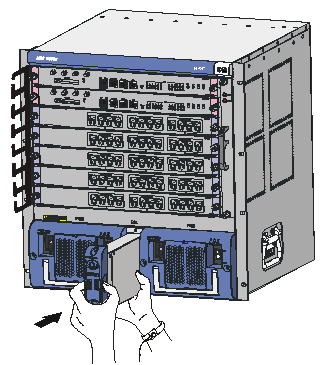

3.6.2  Installation Procedure
I. Removing a PSU other than NEPS3500-A
The following procedure applies to all NEPS PSUs except NEPS3500-A.

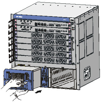

1)         Clutch the air filter cover by the upper and lower edges with your index finger and the thumb, and gently remove the air filter cover from a PSU.
&  Note:
You can pull out the PSU handle only after removing the air filter cover.
2)         Slide the PSU smoothly along the guide rails, until it snaps into the backplane.
Figure 3-9 Install an AC PSU
3)         Fasten the captive screws on both sides of the PSU with a Philips screwdriver and install the removed air filter cover onto the PSU.
4)         Check that the power switch on the PSU is in the OFF position.

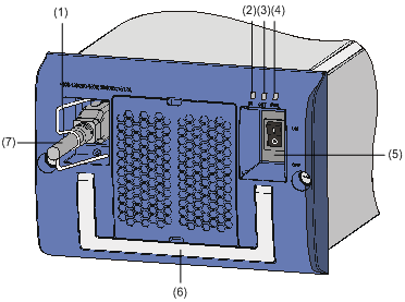

I. Connecting the AC power cord
  Caution:
l      For lightning protection, the AC power supply should be led through an external lightning device into the switch.
l      Make sure the power switch on the PSU is in the OFF position before connecting the AC power cord.

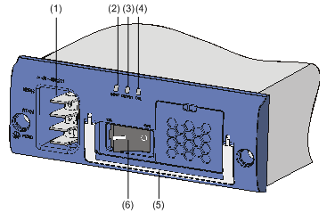

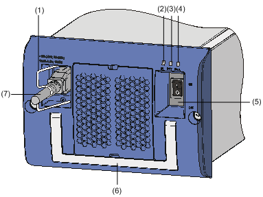

Take the following steps to connect the AC power cord to NEPS600-A, NEPS1200-A, or NEPS2000-A:
1)         Turn the clamp at the left of the PSU front panel rightwards.
2)         Insert the plug at one end of the AC power cord into the socket of the PSU.
3)         Turn the clamp leftwards until it grips the plug.
4)         Insert the other end of the power cord into an external power socket.
(1) Connector-retention clamp
(2) Input LED
(3) Output LED
(4) Fail LED
(5) Power switch
(6) Power handle
(7) AC power cord
Figure 3-11  NEPS600-A appearance
(2) Input LED
(3) Output LED
(4) Fail LED
(5) Power switch
(6) PSU handle
(7) AC power cord
Figure 3-12 NEPS1200-A appearance

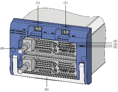

Take the following steps to connect the AC power cord to NEPS3500-A:
1)         Insert the plug at one end of the AC power cord into the socket on the PSU.
2)         Install the clamp to the socket of the PSU until it grips the plug.
3)         Insert the other end of the power cord into an external power socket.
(1) Power switch
(2) Input LED
(3) Output LED
(4) Fail LED
(5) PSU handle
(6) AC power cord
Figure 3-14 NEPS3500-A appearance

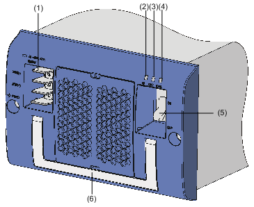

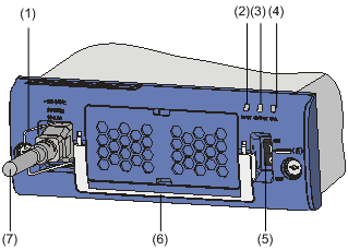

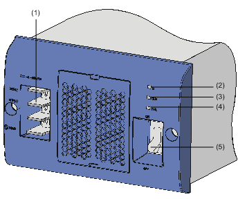

II. Connecting DC Power Cables
The DC power cables are connected to the terminal block, and are fixed with screws. A plastic cover plate is installed in front of the terminal block for the sake of connection reliability.
  Caution:
l      Completely power off the switch before connecting the DC power cord.
l      Before removing or installing the DC power cables, you need to remove the plastic cover plate. Install it after installing/removing the DC power cables.
Take the following steps to connect the DC power cables:
1)         Remove the plastic cover plate and loosen the fixing screws on the terminal block of the DC PSU with a Philips screwdriver.
2)         Connect one end of the cable with –48V OT terminals (blue) to the NEG(–) terminal on the PSU and fasten the corresponding fixing screw. Connect the other end to the NEG (–) terminal of the source power supply.
3)         Connect one end of the cable with GND OT terminals (black) to the RTN (+) terminal on the PSU and fasten the corresponding fixing screw. Connect the other end to the RTN (+) terminal of the power source.
4)         Connect one end of the cable with PGND OT terminals (yellow-green) to the PGND terminal on the PSU and fasten the corresponding fixing screw. Connect the other end to the ground bar of the switch.
5)         Install the plastic cover plate.
(1) Terminal block
(2) Input LED
(3) Output LED
(4) Fail LED
(5) PSU handle
(6) Power switch
Figure 3-15 NEPS600-D appearance

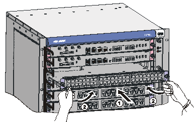

3.7  Installing a Board
The installation procedures of SRPUs, LPUs, and service boards are almost the same. The following section describes the installation procedure of LPUs.
3.7.1  Installation Preparations
l           Wear the ESD-preventive wrist strap, making sure that it is properly grounded.
l           Loosen the mounting screws on the blank filler panel where the SRPU is to be installed using a Phillips screwdriver and remove the blank filler panel.

Follow the procedure below to install an LPU:
1)         Turn the ejector levers on the LPU outward simultaneously with both hands, insert the LPU straight into the chassis along the guide rails until it stops sliding (that is, the positioning pins on the ejector levers touch the positioning holes on the chassis).
2)         Turn the ejector levers towards the front panel to drive the positioning pins into the positioning holes..
Figure 3-18 Install an LPU
3)         Fix the LPU by fastening the mounting screws on the LPU with a Phillips screwdriver.

3.8.2  Installing the PoE Power Entry Module
The PoE power entry module is hot-swappable.
Follow the steps below to install the PoE power entry module:
1)         Unpack the PoE power entry module, which is shown in Figure 3-19.
Figure 3-19 PoE power entry module
2)         Keep the PoE power entry module in the correct letter direction. (Do not turn it upside down. Otherwise, you will not be able to fully insert it into the chassis due to mis-plug prevention design of the module, nor can you fasten the chassis fixing screw.) Hold the bottom with one hand and the front panel with the other, and then slide it smoothly along the guide rails into the slot, until it snaps into the chassis. Make sure the plug of the PoE power entry module is fully connected with the socket inside the chassis. See Figure 3-20.
Figure 3-20 Install the PoE power entry module
3)         Fasten the screws on the top of the PoE entry module with a Philips screwdriver.

I. Grounding the PoE chassis
Follow these steps to ground the PoE chassis:
1)         Connect the wiring terminal (with one M6 hole) of the 6 AWG cable to the grounding screw on the rear panel of the switch, as shown in Figure 3-21.
2)         Connect the other end of the cable to the grounding bar or other grounding terminals.
(1) Chassis grounding screw
Figure 3-21 Ground the PoE chassis

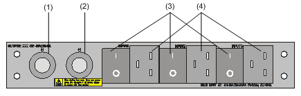

II. Connecting PoE power cables
1)         Loosen the mounting screws on the PoE power entry module with a Phillips screwdriver.
2)         Connect one –48V OT terminal of the blue DC power cable to the NEG (–) terminal of the PoE power entry module and fasten the mounting screw; connect the other end to the NEG (–) terminal of the external PoE power supply.
3)         Connect the PGND OT terminal of the black DC power cable to the RTN (+) terminal of the PoE power entry module and fasten the mounting screw; connect the other end to the RTN (+) terminal of the external PoE power supply.
  Caution:
l      Observe the polarity signs on devices and connect the cables correctly.
l      Choose right cables based on the load.
(1) NEG(–) terminal of DC output
(2) RTN(+) terminal of DC output
(3) AC input switch
(4) AC input socket
Figure 3-22 Input/output of external PoE power supply

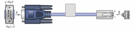

3.9.2  Connecting Console Cable
I. Introduction
Console cable is an 8-core shielded cable. At one end of the cable is a crimped RJ-45 connector that is to be plugged into the console port of the switch. At the other end of the cable is a DB-9 (female) connector. You can plug it into the 9-pin (male) serial port on the console terminal. The following figure illustrates the console cable.
Figure 3-23 Console cable
Table 3-3 Console cable pinouts
RJ-45
Signal
DB-9
Signal
1
RTS
8
CTS
2
DTR
6
DSR
3
TXD
2
RXD
4
CD
5
SG
5
GND
5
SG
6
RXD
3
TXD
7
DSR
4
DTR
8
CTS
7
RTS

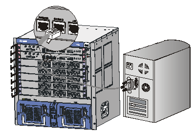

II. Connecting the console cable
Take the following steps to connect the console cable, when configuring the switch on the terminal.
1)         Plug the DB-9 female connector of the console cable into the serial port of the PC/terminal where the switch is to be configured.
2)         Connect the RJ-45 connector of the console cable to the console port of the switch.
Figure 3-24 Connect the console cable
&  Note:
The PC serial port is not hot-swappable, so you are not allowed to insert or remove the console cable into or from the PC serial port.
When connecting the console cable, first connect the DB9 end to the PC serial port and then the RJ45 end to the console port of the switch. And removing the console cable is just in inverse order.
When removing the console cable, first remove the RJ-45 end and then the DB9 end.

2)         Installation Procedure
To install the fiber management tray, proceed as shown in Figure 3-26.
l           Align the fiber management tray and the installation holes on the column of the cabinet.
l           Use a Phillips screwdriver to fix each fiber management tray with two M5×10 self-tapping screws.
Figure 3-26 Install FMTs
