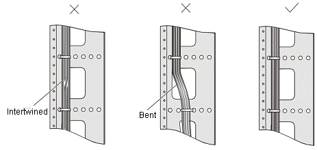

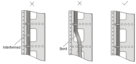

l           Bind and put the cables inside the cabinet in a straight and neat way. No intertwinement or bending is allowed.
Figure A-1 Cable binding example I

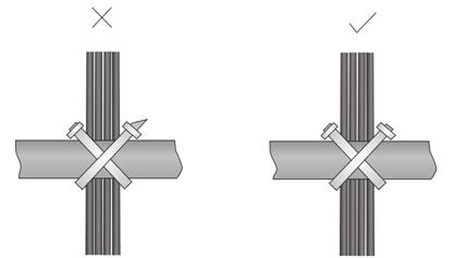

l           Use the right type of ties to bind the cables. Do not bind cables with joined ties. The following types of ties are available currently: 100 × 2.5 mm (3.9 in × 0.1 in), 150 × 3.6 mm (5.9 × 0.1 in), 300 ×3.6 mm (11.8 × 0.1 in), 530 × 9 mm (20.9 × 0.4 in), and 580 × 13 mm (22.8 × 0.5 in);
l           Cut the extra parts of the ties neatly after binding the cables, leaving no sharp or angular tips. See the following figure:
Figure A-2 Cable binding example II

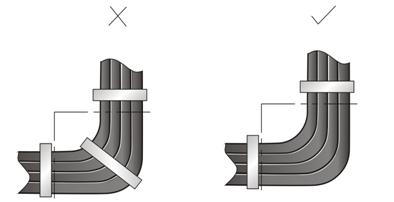

l           Bind the cables wherever cable bending cannot be avoided. However, the cable ties cannot be placed inside the bending area in case of the likelihood of cable core break due to excessive stress. See the following figure.
Figure A-3 Cable binding example III
