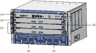

I. S9502
(1) SRPU slot
(2) SRPU/LPU slot
(3) LPU slots
(4) PSUs
(5) Fan tray
Figure 1-1 Front view of the S9502
l           The S9502 chassis provides four slots in its board area: from up to down, the first one accommodates an SRPU, the second one accommodates an SRPU or a line processing unit (LPU), and the remaining two slots accommodate LPUs or service boards.
l           At the bottom of the chassis is the power area that contains two power supply units (PSUs). The switch supports both AC and DC power inputs. So you can select AC or DC PSUs as needed. A PoE filter at the rear of the chassis is used to receive power from an external PoE power supply.
l           On the right of the chassis is the fan area that contains a vertical fan tray. The fans draw air in from the left and exhausts air from the right.

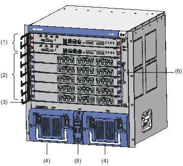

III. S9508
(1) LPU slots
(2) SRPU slots
(3) PSUs
(4) PoE power entry module
(5) Fan tray
Figure 1-3 Front view of the S9508
l           The S9508 chassis provides ten slots in its board area: The middle two accommodate SRPU modules; the remaining eight accommodate LPUs/service boards.
l           At the bottom of the chassis is the power area that contains one PoE power entry module and two PSUs. The switch supports both AC and DC power inputs. So you can select AC or DC PSUs as needed.
l           On the right of the chassis is the fan area that contains one vertical fan tray. The fans draw air in from the left and exhausts air from the right.

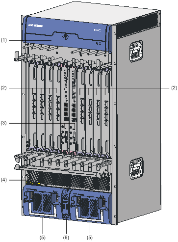

IV. S9508V
(1) Fan tray
(2) LPU slots
(3) SRPU slots
(4) Air filter
(5) PSUs
(6) PoE power entry module
Figure 1-4 Front view of the S9508V
l           The S9508V chassis provides ten vertical slots in its board area: The middle two accommodate SRPU modules; the remaining eight accommodate LPU/service boards.
l           Above the power area is the air filter, which can be removed from the chassis  in the case of replacement or regular cleaning.
l           On the top of the chassis is the fan area that contains one horizontal fan tray. The fans draw air in from the bottom and exhaust air from the top.

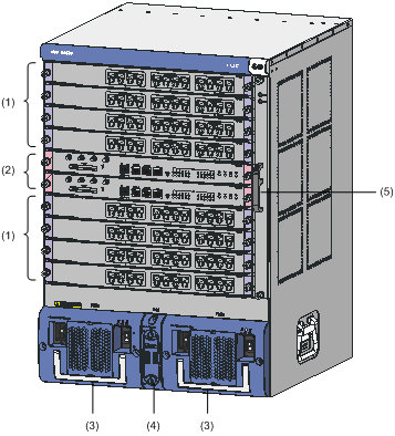

V. S9512
(1) LPU slots
(2) SRPU slots
(3) PSUs
(5) Fan trays

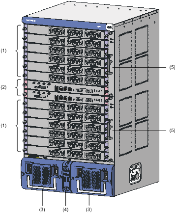

Figure 1-5 Front view of the S9512
l           The S9512 chassis provides fourteen slots in its board area: The middle two accommodate SRPU modules and the remaining twelve accommodate LPUs/service boards.
l           At the bottom of the chassis is the power area that contains one PoE entry module and two PSUs. The switch supports both AC and DC power inputs. So you can select AC or DC PSUs as needed.
l           On the right of the chassis is the fan area that contains two vertical fan trays. The fans draw air in from the left and exhaust air from the right.
