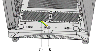

III. Grounding requirements
You must provide a good grounding system for the switch. The cabinet must be equipped with a grounding terminal, as shown in Figure 2-1.
(1) Grounding cable
(2) Grounding terminal
Figure 2-1 Ground the cabinet

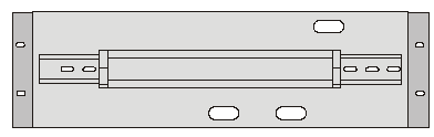

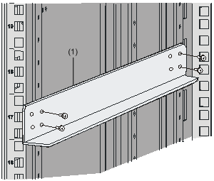

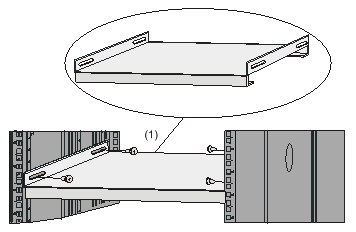

2.3.2  Requirements of Supports
1)         The length of supports depends on the cabinet depth.
2)         You can use supports such as shelf or angles to install the switch into the cabinet. The supports must be able to bear the weight of the switch and its accessories.
Figure 2-2 shows a shelf.
(1) Shelf
Figure 2-2 Shelf
Figure 2-3 shows an angle support.
(1) Angle support
Figure 2-3 Angle support

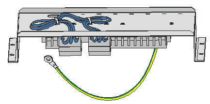

2.4  Requirements of Power Distribution Box
You can install a power distribution box in the cabinet as required.
2.4.1  Installing the AC Power Distribution Box

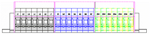

I. Terminal Block
The terminal block is set on the bottom of a power distribution box.
Figure 2-4 Terminal block structure diagram
The terminal block has 21 terminals to connect power cords: seven gray terminals, seven blue terminals and seven yellow-green terminals.
l           The gray terminals from L1 to L7 are output ports for live wire. These ports are connected to each other.
l           The blue terminals from N1 to N7 are output ports for neutral wire. These ports are connected to each other.
l           The yellow-green terminals from PE1 to PE7 are output ports for earth wire. These ports are connected to each other and connected to the cabinet.
Table 2-7 Electrical specifications of the terminal block
Item
Specification
Input
Rated current
76A
Rated voltage
1000V
Rated cross-sectional area
16 mm2
Maximum current/maximum crimping area
101A/25 mm2
Output
seven loop outputs
II. Power Distribution Box Appearance

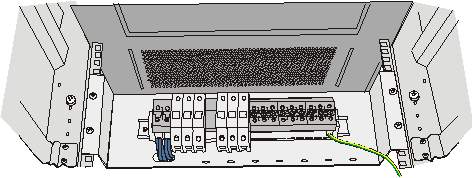

Figure 2-5 Front view of the power distribution box

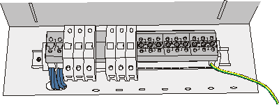

Figure 2-6 Top view of the power distribution box
  Caution:
Make sure the power cord ports are covered with protection tube such that no wire tailpiece is exposed at any joint.
III. Connect power cords to the power distribution box
  Caution:
The power distribution box takes AC high voltage. Do not operate it before breaking its power.
1)         Use three cables to connect the client power distribution box to the terminal block of the cabinet power distribution box. You are recommended to use the cables with 16 mm2 cross-sectional area (the colors of the cables differ depending on the cable specifications in different countries). Connect the power cords according to the following relations:
l           Live wire L in the client power distribution box — Live wire L in the cabinet power distribution box
l           Neutral wire N in the client power distribution box — Neutral wire N in the cabinet power distribution box
l           Earth wire G in the client power distribution box — Earth wire PE in the cabinet power distribution box
2)         Use 3.5 m (11.5 ft) long cables to connect the cabinet power distribution box to the system power supply and PoE power supply. The three wires of each cable should be respectively connected to the ports L, N and PE of the power distribution box. Make sure the protection tubes are used and no wire tailpiece is exposed during the connection. You should connect power cord 1 to L1, N1 and PE1, power cord 2 to L2, N2 and PE2, and so on. The number of power cords depends on the cabinet configuration. Note that you should connect the brown wire to L (live wire), the blue wire to N (neutral wire), and yellow-green wire to PE (earth wire).
3)         After finishing the connection of the cables, bind these cables in order with cable strap, wire them along the right side of the cabinet down, and connect them to the input ports of the system power supply and PoE power supply. You should make sure the cables are not loose.

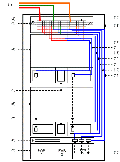

Figure 2-7  describes the cable connections on the cabinet power distribution box.
(1) User-supplied power distribution box
(2) Guide rail
(3) Power distribution box of the cabinet
(4) S9505 chassis
(5) PoE power entry module
(6) S9505 chassis
(7) System power input
(8) Interface area on external PoE power supply panel
(9) External PoE power supply
(10) PoE AC socket
(11)~(17) No.1 to No.7 power cable
(18) N68 cabinet
(19) Terminal block
Figure 2-7 Cable connections on the power distribution box
&  Note:
If NEPS600-A is applied, you must use the four spare 10A cables.

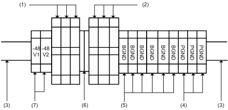

I. Terminal Block
1)         Terminal block structure diagram
(1) Air switch 1
(2) Air switch 2
(3) Guide rails
(4) PGND wiring terminal block
(5) BGND wiring terminal block
(6) Isolater
(7) Input terminal block
Figure 2-8 Terminal block structure

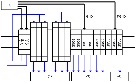

As illustrated in Figure 2-8, the two leftmost input terminal blocks are DC input terminal blocks. Next to them are two air switches, each of which has a through-current capacity of 63A. On the rightmost side are 9 terminal blocks, 6 of which are BGND terminal blocks and the rest are PGND terminal blocks.
2)         Diagram for connecting terminal blocks
(1) Connected to user-supplied DC power
(2) Connected to the negative terminal of –48 V DC power
(3) Connected to the positive terminal of  –48 V DC power
(4) Grounded and connected to the cabinet
Figure 2-9  Diagram for connecting DC input terminal blocks

4)         Terminal block components
Table 2-7 illustrates terminal block components.
Table 2-9 Terminal block components
NO
Name
Quantity
1
End bracket
2
2
Cross connector
3
3
Marker
6
4
Terminal
11
5
Clapboard
7
6
Rail
1
7
Circuit breaker
6
II. Installing DC Power Distribution Box
To install power distribution box, take the following steps:
1)         Install the DC input terminal blocks and air switches to the cabinet via the rail, as illustrated in Figure 2-10.
Figure 2-10 Install the DC input terminal blocks and air switches
2)         Connect the DC input terminal blocks and the air switches with 6 mm2 cables and fix the cable properly. Also use a 6 mm2 cable for grounding, as illustrated in Figure 2-11.
Figure 2-11 Backplane diagram for connecting DC input terminal blocks and air switches
3)         Fix the DC power distribution box onto the back of the cabinet.
Figure 2-12 Diagram for fixing the power distribution box to the rear of the N68 cabinet
4)         You can make the air switches to supply power to DC power modules by connecting the lower terminals of the air switches to DC power input terminals and supply voltages to DC power. (Refer to Figure 2-9 for detail. Note that the diameters of the cables need to be 6 mm2 or 10 mm2.)
5)         You can use the BGND and PGND terminal blocks as needed. The rightmost PGND terminals must be connected to the cabinet using 6 mm2 cables, as illustrated in Figure 2-12.
6)         Fasten the connected power cables with a wire and secure them onto the power distribution box.
7)         Use two 16 mm2 cables to connect the cabinet and the DC power distribution box. You need to connect the two cables to the leftmost terminal blocks of the cabinet, as illustrated in Figure 2-9.
