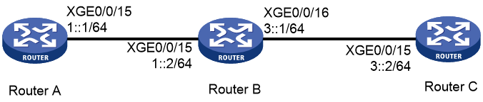

Example: Configuring basic RIPng
As shown in Figure 2, Router A, Router B, and Router C learn IPv6 routing information through RIPng. Configure route filtering on Router B to accept all received routes except the route 2::/64 and to advertise only the route 4::/64.
Figure 2 Network diagram
1.     Configure IPv6 addresses for the interfaces. (Details not shown.)
2.     Configure basic RIPng settings:
# Configure Router A.
<RouterA> system-view
[RouterA] ripng 1
[RouterA-ripng-1] quit
[RouterA] interface ten-gigabitethernet 0/0/15
[RouterA-Ten-GigabitEthernet0/0/15] ripng 1 enable
[RouterA-Ten-GigabitEthernet0/0/15] quit
[RouterA] interface ten-gigabitethernet 0/0/16
[RouterA-Ten-GigabitEthernet0/0/16] ripng 1 enable
[RouterA-Ten-GigabitEthernet0/0/16] quit
# Configure Router B.
<RouterB> system-view
[RouterB] ripng 1
[RouterB-ripng-1] quit
[RouterB] interface ten-gigabitethernet 0/0/15
[RouterB-Ten-GigabitEthernet0/0/15] ripng 1 enable
[RouterB-Ten-GigabitEthernet0/0/15] quit
[RouterB] interface ten-gigabitethernet 0/0/16
[RouterB-Ten-GigabitEthernet0/0/16] ripng 1 enable
[RouterB-Ten-GigabitEthernet0/0/16] quit
# Configure Router C.
<RouterC> system-view
[RouterC] ripng 1
[RouterC-ripng-1] quit
[RouterC] interface ten-gigabitethernet 0/0/15
[RouterC-Ten-GigabitEthernet0/0/15] ripng 1 enable
[RouterC-Ten-GigabitEthernet0/0/15] quit
[RouterC] interface ten-gigabitethernet 0/0/16
[RouterC-Ten-GigabitEthernet0/0/16] ripng 1 enable
[RouterC-Ten-GigabitEthernet0/0/16] quit
[RouterC] interface ten-gigabitethernet 0/0/17
[RouterC-Ten-GigabitEthernet0/0/17] ripng 1 enable
[RouterC-Ten-GigabitEthernet0/0/17] quit
# Display the RIPng routing table on Router B.
[RouterB] display ripng 1 route
   Route Flags: A - Aging, S - Suppressed, G - Garbage-collect, D – Direct
                O - Optimal, F - Flush to RIB
 Peer FE80::20F:E2FF:FE23:82F5 on Ten-GigabitEthernet0/0/15
 Destination 2::/64,
     via FE80::20F:E2FF:FE23:82F5, cost 1, tag 0, AOF, 6 secs
 Peer FE80::20F:E2FF:FE00:100  on Ten-GigabitEthernet0/0/16
 Destination 4::/64,
     via FE80::20F:E2FF:FE00:100, cost 1, tag 0, AOF, 11 secs
 Destination 5::/64,
 Local route
 Destination 1::/64,
     via ::, cost 0, tag 0, DOF
 Destination 3::/64,
# Display the RIPng routing table on Router A.
[RouterA] display ripng 1 route
 Peer FE80::200:2FF:FE64:8904 on Ten-GigabitEthernet0/0/15
 Destination 3::/64,
     via FE80::200:2FF:FE64:8904, cost 1, tag 0, AOF, 31 secs
 Destination 4::/64,
     via FE80::200:2FF:FE64:8904, cost 2, tag 0, AOF, 31 secs
 Destination 5::/64,
 Local route
 Destination 2::/64,
 Destination 1::/64,

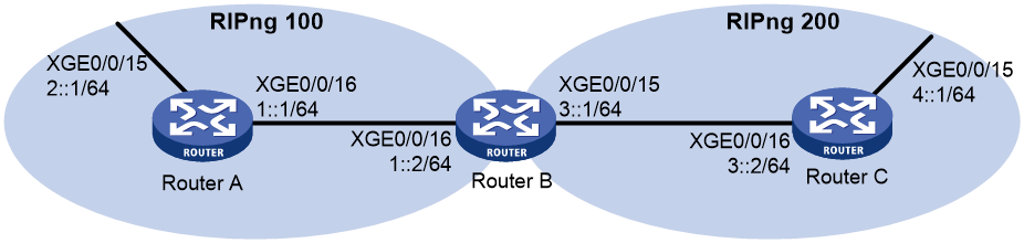

Example: Configuring RIPng route redistribution
As shown in Figure 3, Router B communicates with Router A through RIPng 100 and with Router C through RIPng 200.
Configure route redistribution on Router B, so the two RIPng processes can redistribute routes from each other.
Figure 3 Network diagram
# Enable RIPng 100 on Router A.
[RouterA] ripng 100
[RouterA-ripng-100] quit
[RouterA-Ten-GigabitEthernet0/0/15] ripng 100 enable
[RouterA-Ten-GigabitEthernet0/0/16] ripng 100 enable
# Enable RIPng 100 and RIPng 200 on Router B.
[RouterB] ripng 100
[RouterB-ripng-100] quit
[RouterB-Ten-GigabitEthernet0/0/16] ripng 100 enable
[RouterB] ripng 200
[RouterB-ripng-200] quit
[RouterB-Ten-GigabitEthernet0/0/15] ripng 200 enable
#  Enable RIPng 200 on Router C.
[RouterC] ripng 200
[RouterC-Ten-GigabitEthernet0/0/15] ripng 200 enable
[RouterC-Ten-GigabitEthernet0/0/16] ripng 200 enable
# Display the routing table on Router A.
[RouterA] display ipv6 routing-table
Destinations : 6 Routes : 6
Destination: ::1/128                                     Protocol  : Direct
NextHop    : ::1                                         Preference: 0
Interface  : InLoop0                                     Cost      : 0
Destination: 1::/64                                      Protocol  : Direct
NextHop    : ::                                          Preference: 0
Interface  : XGE0/0/16                                   Cost      : 0
Destination: 1::1/128                                    Protocol  : Direct
Destination: 2::/64                                      Protocol  : Direct
Interface  : XGE0/0/15                                   Cost      : 0
Destination: 2::1/128                                    Protocol  : Direct
Destination: FE80::/10                                   Protocol  : Direct
Interface  : NULL0                                       Cost      : 0
3.     Configure RIPng route redistribution:
# Configure route redistribution between the two RIPng processes on Router B.
[RouterB] ripng 100
[RouterB-ripng-100] import-route ripng 200
[RouterB] ripng 200
[RouterB-ripng-200] import-route ripng 100
Destinations : 7 Routes : 7
Destination: 4::/64                                      Protocol  : RIPng
NextHop    : FE80::200:BFF:FE01:1C02                     Preference: 100
Interface  : XGE0/0/16                                   Cost      : 1

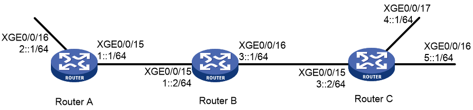

Example: Configuring RIPng GR
As shown in Figure 4, Router A, Router B, and Router C learn IPv6 routing information through RIPng.
Configure Router A as the GR restarter. Configure Router B and Router C as the GR helpers to synchronize their routing tables with Router A by using GR.
Figure 4 Network diagram
2.     Configure RIPng on the routers to ensure the following: (Details not shown.)
¡     Router A, Router B, and Router C can communicate with each other at Layer 3.
¡     Dynamic route update can be implemented among them with RIPng.

Example: Configuring RIPng FRR
As shown in Figure 5, Router A, Router B, and Router C run RIPng. Configure RIPng FRR so that when Link A becomes unidirectional, traffic can be switched to Link B immediately.
Figure 5 Network diagram
Device
Interface
IP address
Router A
Ten-GigabitEthernet 0/0/15
1::1/64
Router A
Ten-GigabitEthernet 0/0/16
2::1/64
Router A
Loopback 0
10::1/128
Router B
3::1/64
Router B
2::2/64
Router B
Loopback 0
20::1/128
Router C
1::2/64
Router C
3::2/64
1.     Configure IPv6 addresses for the interfaces on the routers. (Details not shown.)
2.     Configure RIPng on the routers to make sure Router A, Router B, and Router C can communicate with each other at the network layer. (Details not shown.)
3.     Configure RIPng FRR:

Example: Using an IPsec profile to protect RIPng
As shown in Figure 6, configure RIPng on the routers, and configure IPsec profiles on the routers to authenticate and encrypt protocol packets.
Figure 6 Network diagram
