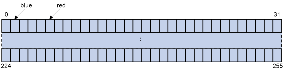

IS-IS PDUs are encapsulated into link layer frames. An IS-IS PDU has two parts, the headers and the variable length fields. The headers comprise the PDU common header and the PDU specific header. All PDUs have the same PDU common header. The specific headers vary by PDU type.
Figure 5 PDU format

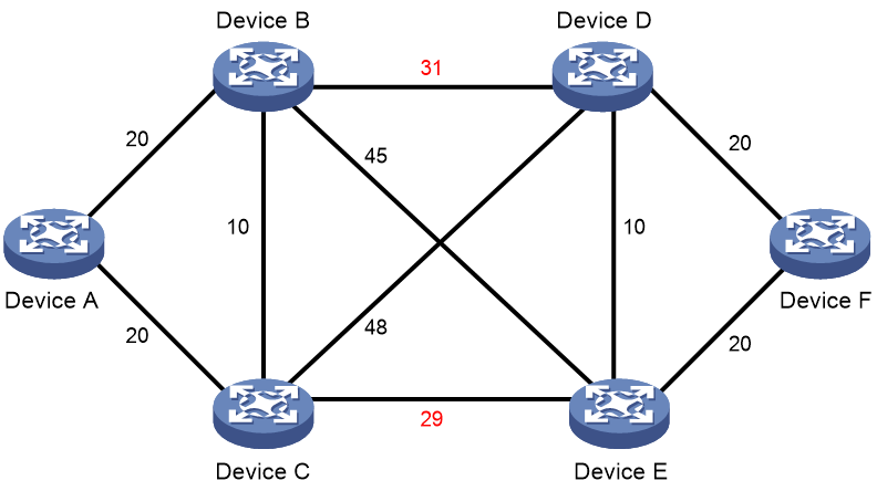

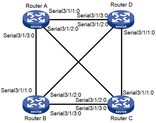

Configuring IPv6 IS-IS MTR
On a network, IPv4 and IPv6 topologies must be consistent so that both IPv6 IS-IS and IPv4 IS-IS can use the SPF algorithm to perform route calculation. If they are different, routers supporting both IPv4 and IPv6 might send IPv6 packets to routers that do not support IPv6, resulting in packet loss.
To resolve this issue, configure IPv6 IS-IS MTR to perform route calculation separately in IPv4 and IPv6 topologies.
Figure 7 Network diagram
As shown in Figure 7, the numbers refer to the link costs. Router A, Router B, and Router D support both IPv4 and IPv6. Router C supports only IPv4 and cannot forward IPv6 packets.
Enable IPv6 IS-IS MTR on Router A, Router B, Router C, and Router D to make them perform route calculation separately in IPv4 and IPv6 topologies. With this configuration, Router A does not forward IPv6 packets destined to Router D through Router B, avoiding packet loss.
As a best practice to avoid route calculation failures, configure this feature when both IPv4 and IPv6 topologies exist in the network.

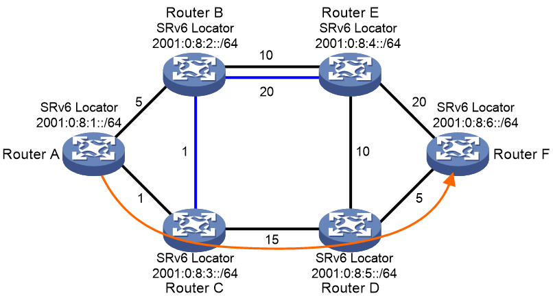

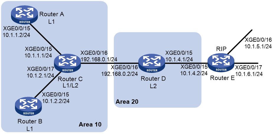

Configuring IS-IS route leaking
By default, the Level-2 router does not advertise the routes of the Level-2 area and other Level-1 areas to a Level-1 area. The Level-1 routers in that Level-1 area sends packets destined for other areas to the nearest Level-1-2 router. As a result, IS-IS cannot use the optimal route to forward these packets. To resolve this issue, perform this task to configure IS-IS route leaking.
After you configure route leaking on a Level-1-2 router, this feature functions as follows:
1.     Filters routes with the specified criteria.
2.     Imports the desired routes from other Level-1 areas and the Level-2 area into the Level-1 area to which the Level-1-2 router belongs.
As shown in Figure 8, the optimal path from Device A to Device F is Device A > Device B > Device D > Device E > Device F and the total cost is 40. By default, the actual path to Device F on Device A is Device A > Device C > Device E > Device F and the total cost is 70. After you configure route leaking on Device C and Device D, IS-IS will use the Device A > Device B > Device D > Device E > Device F path to forward traffic from Device A to Device F.
Figure 8 Route leaking
Perform this task to control route advertisement (route leaking) between Level-1 and Level-2.
You can configure IS-IS to advertise routes from Level-2 to Level-1, and to not advertise routes from Level-1 to Level-2.

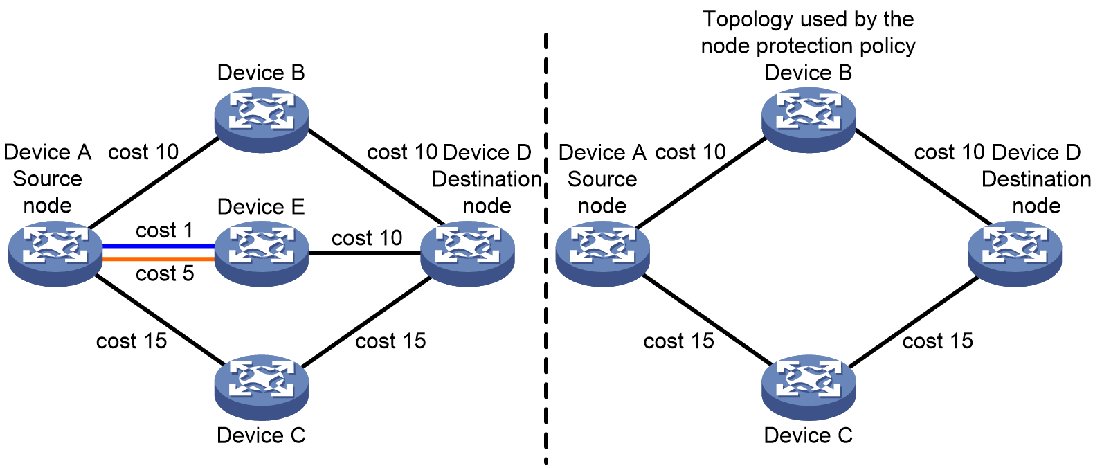

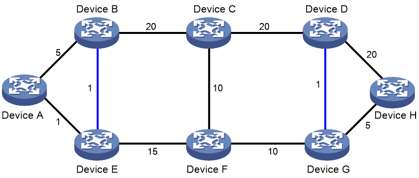

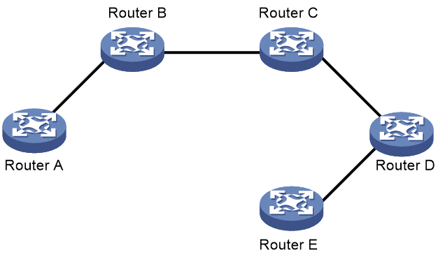

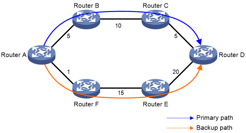

As shown in Figure 9, when no flexible algorithm is configured, all nodes calculate optimal paths by IS-IS link cost.
Figure 9 Topology without flexible algorithm 130

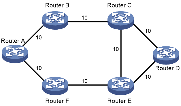

For comparison, you can configure flexible algorithm 130 for all nodes except Router F. The FAD of flexible algorithm 130 is as follows:
·     Calculation type—SPF algorithm.
·     Metric type—IS-IS link cost.
·     Constraint—Exclude affinity attribute red.
In the new topology shown in Figure 10, all nodes calculate optimal paths based on the calculation type and metric type in the FAD.
Figure 10 Topology with flexible algorithm 130

IS-IS supports a maximum of 256 affinity bits. They are numbered from 0 to 255. You can perform this task to map different affinity attribute names to these bits. As shown in Figure 11, affinity attribute name blue is mapped to bit 1, and red to bit 5.
This feature enables you to configure affinity attributes for links or define the flexible algorithm topology by specifying only the affinity attribute names.
Figure 11 Mapping an affinity attribute to an affinity bit

Configuring IS-IS link delay normalization
IS-IS links with small link delay differences might not be used for traffic forwarding when the following conditions exist:
·     IS-IS obtains link delay information in dynamic mode (NQA TWAMP-light).
·     The metric type of an IS-IS flexible algorithm is link delay.
To resolve this issue, perform this task to configure IS-IS link delay normalization.
When IS-IS performs link delay normalization on an interface, it recalculates the link delay reported by the interface, and then advertises the calculation result in LSPs.
During link delay normalization, IS-IS recalculates the link delay reported by an interface as follows:
1.     Calculates a. This value depends on the calculation result of dm ÷ interval-value.
¡     If the calculation result of dm ÷ interval-value is an integer, a equals dm ÷ interval-value.
¡     If the calculation result of dm ÷ interval-value is not an integer, a equals the greatest integer that is smaller than the calculation result.
2.     Calculates b by using the following formula:
b = a × interval-value + offset-value
3.     Calculates nm.
¡     If dm is not greater than b, nm equals b.
¡     If dm is greater than b, nm equals b plus interval-value.
·     The dm argument represents the link delay measured by NQA TWAMP-light.
·     The interval-value argument represents the interval value specified for link delay normalization.
·     The offset value argument represents the offset value specified for link delay normalization.
·     The nm argument represents the normalized link delay. After link delay normalization, IS-IS will advertise the normalized link delay in LSPs.

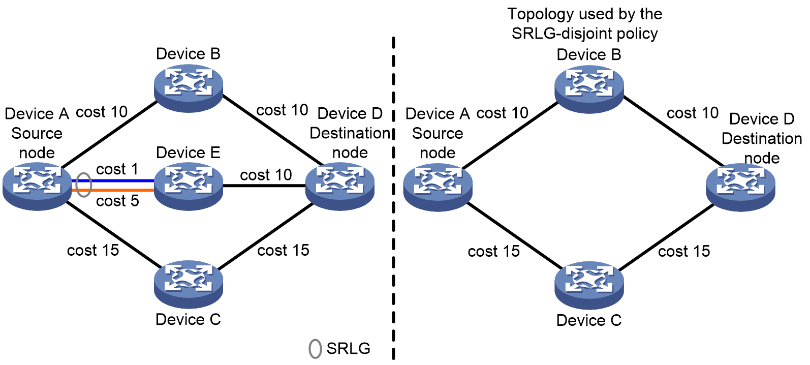

As shown in, IS-IS already obtains the dynamic link delay value of each link and the metric type of the flexible algorithm is link delay, When the flexible algorithm calculates the optimal path between Device A and Device F, the Device B <> Device E link and the Device C <> Device D link are excluded from optimal route calculation. This is because of their high link delay values. The Device B <> Device D link and the Device C <> Device E link have different link delay values, but the difference is small. If you do not configure link delay normalization, the optimal path from Device A to Device F is Device A > Device C > Device E > Device F. The Device B <> Device D link is not used because its link delay value is higher than that of the Device C <> Device E link, which wastes link resources.
Figure 12 Dynamic acquisition of IS-IS link delay information
To make full use of link resources, configure IS-IS link delay normalization. The interval value and the offset value for link delay normalization are 10 milliseconds and 3 milliseconds, respectively. IS-IS then normalizes the link delay value of the Device B <> Device D link as follows:
1.     Calculates a. The value of a equals 3, because 31 divided by 10 equals 3.1.
b = 3 × 10 + 3 = 33
3.     Calculates nm. The value of nm is 33, because the original link delay value (31) is smaller than b (33).
IS-IS normalizes the link delay value of the Device C <> Device E link as follows:
1.     Calculates a. The value of a equals 2, because 29 divided by 10 equals 2.9.
b = 2 × 10 + 3 = 23
3.     Calculates nm. The value of nm is 33 (23 +10), because the original link delay value (31) is greater than b (23).
The normalized link delay value of the Device B <> Device D link is the same as that of the Device C <> Device E link. As a result, the flexible algorithm considers them as equal-cost links. Device A has two optimal paths to reach Device F: path Device A > Device B > Device D > Device F and path Device A > Device C > Device E > Device F.

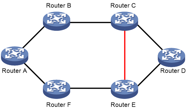

Configuring flexible algorithm FRR
The flexible algorithm FRR is similar to IS-IS LFA FRR, because it uses LFA to calculate a loop-free backup path with the lowest cost based on the topology.
For illustration, flexible algorithm 130 is configured for all nodes in Figure 13. The FAD of flexible algorithm 130 is as follows:
Figure 13 Topology without flexible algorithm 130
In Figure 14, after you enable FRR, flexible algorithm 130 uses LFA to calculate a primary path and a backup path from Router A to Router D.
Figure 14 Topology with flexible algorithm 130
2.     Enter IS-IS view.
isis [ process-id ] [ vpn-instance vpn-instance-name ]
3.     Enter flexible algorithm view.
flex-algo flex-algo-id
4.     Enable flexible algorithm FRR.
fast-reroute enable
By default, flexible algorithm FRR is enabled.
If no backup paths exist in the topology, execute the undo fast-reroute enable command to disable flexible algorithm FRR to save device resources.

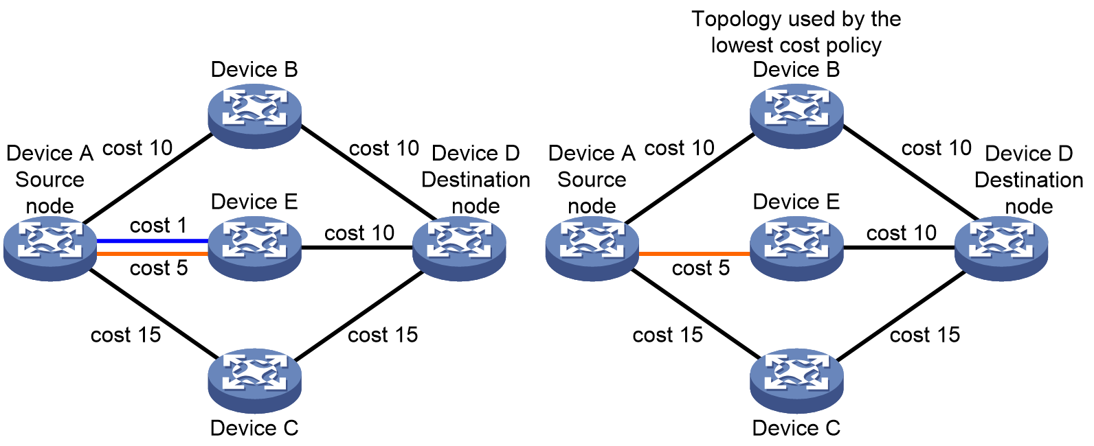

Configuring flexible algorithm TI-LFA FRR
About TI-LFA FRR
Topology-Independent Loop-free Alternate Fast Reroute (TI-LFA FRR) is an enhanced version of LFA FRR. TI-LFA FRR uses the same algorithms to calculate P space and Q space as Remote LFA FRR. This feature can protect a topology without PQ nodes.
For more information about P space and Q space, see "Configuring IS-IS remote LFA FRR."
For more information about TI-LFA FRR path calculation, see SRv6 configuration in Segment Routing Configuration Guide.
TI-LFA FRR protection types
The following TI-LFA traffic protection types are available:
·     Link protection—Protects traffic that traverses a specific link.
·     Node protection—Protects traffic that traverses a specific node.
Node protection takes precedence over link protection.

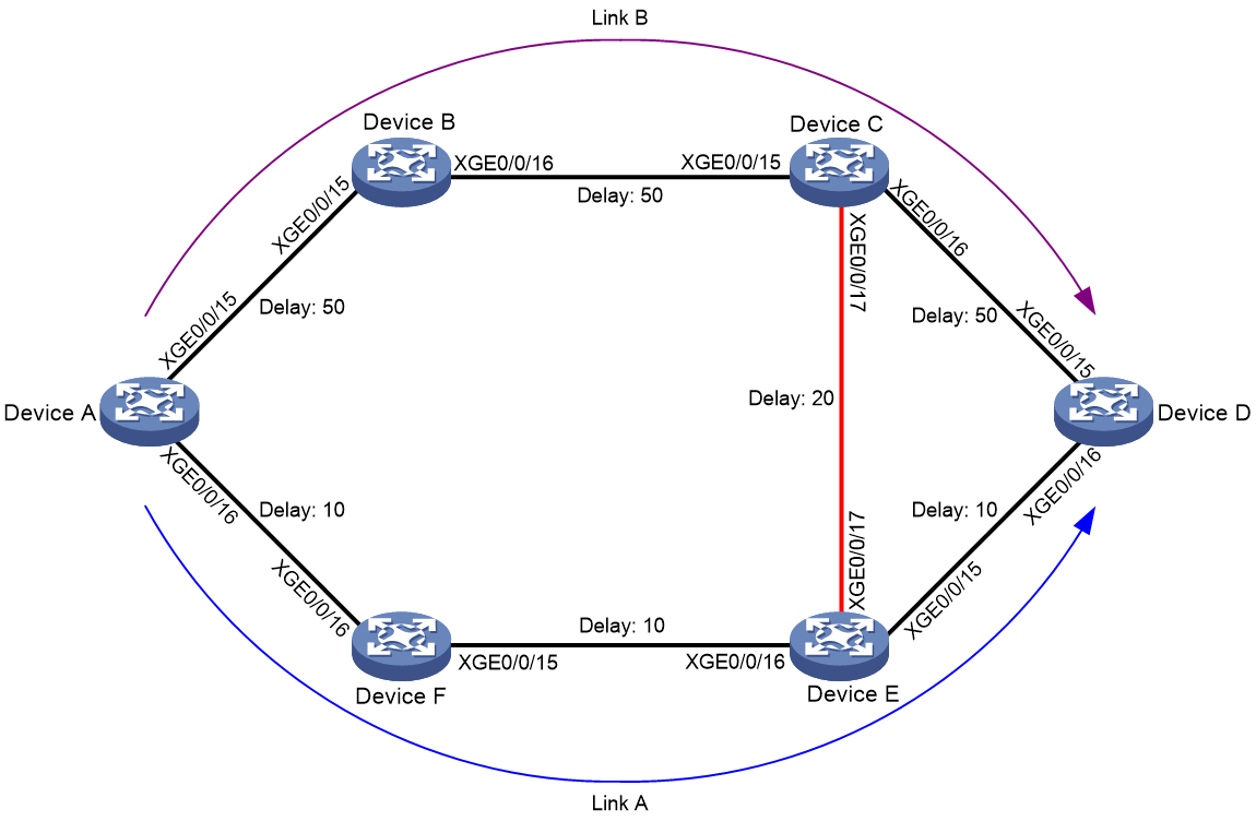

TI-LFA FRR uses the common algorithm to calculate backup paths for a flexible algorithm. The only difference is that TI-LFA FRR calculates backup paths for a flexible algorithm according to the FAD and topology of that flexible algorithm.

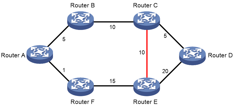

As shown in Figure 15, Router B is the source node and Router A is the destination node.
The number on each link represents the link cost. A data flow traverses from Router B to Router A. To avoid traffic loss against Router B failure, TI-LFA FRR calculates the backup path: Router B > Router C > Router E > Router F > Router A.
Figure 15 TI-LFA FRR backup path calculation without a flexible algorithm
As shown in Figure 16, flexible algorithm 130 is configured for each node. The FAD of flexible algorithm 130 is as follows:
In this case, the backup path calculated by TI-LFA FRR is Router B > Router C > Router D > Router E > Router F > Router A.
Figure 16 TI-LFA FRR backup path calculation with a flexible algorithm

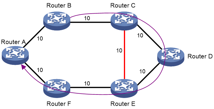

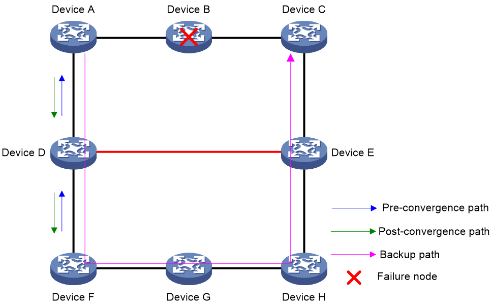

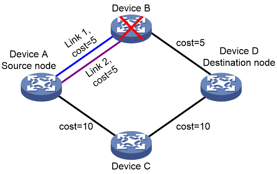

FRR microloop avoidance for a flexible algorithm
When a link or node fails, TI-LFA FRR switches the traffic to the backup path to ensure continuous data forwarding. During the route convergence process, microloops might occur and cause packet loss and disorder if the route convergence on each device is not simultaneous.
As shown in Figure 17, flexible algorithm 128 is configured for all nodes on the network and TI-LFA is enabled for that flexible algorithm. The FAD of flexible algorithm 128 is as follows:
·     Metric type—IS-IS link cost. The link cost of each link in Figure 17 is 10.
If no node failures occur, Device A forwards traffic to Device C along the path: Device A > Device B > Device C. If Device B fails, traffic to Device C will be switched to the backup path calculated by TI-LFA. After Device A finishes route convergence, traffic to Device C will be forwarded along the post-convergence path. If Device D has not finished route convergence and still forward traffic along the pre-convergence path, a loop is formed between Device A and Device D. The loop exists until Device D finishes route convergence.
Figure 17 TI-LFA FRR microloop avoidance after a node failed
FRR microloop avoidance can resolve this issue. After you enable this feature for Device A, Device A first switches traffic to the backup path calculated by TI-LFA when Device B fails. Device A does not start route convergence unless Device D and Device F finish route convergence. After Device A also finishes route convergence, Device A switches the traffic to the post-convergence route.
SR microloop avoidance for a flexible algorithm
FRR microloop avoidance for a flexible algorithm provides microloop avoidance after a network failure. SR microloop avoidance for a flexible algorithm provides microloop avoidance both after a network failure and after a failure recovery.
After a network failure occurs or recovers in a scenario where flexible algorithm is used for path calculation, route convergence occurs on relevant network devices. Because of non-simultaneous convergence on network devices, microloops might be formed. After you configure SR microloop avoidance for a flexible algorithm, the devices will forward traffic along the specified path before route convergence is finished on all the relevant network devices. Because the forwarding path is independent of route convergence, microloops are avoided. To leave sufficient time for IS-IS to finish route convergence, set the SR microloop avoidance delay timer. Before the timer expires, failure relevant devices will forward traffic along the specified path. After the timer expires, IS-IS route convergence should have finished and traffic will traverse along the IS-IS-calculated path.
This section introduces only SR microloop avoidance after a failure recovery.

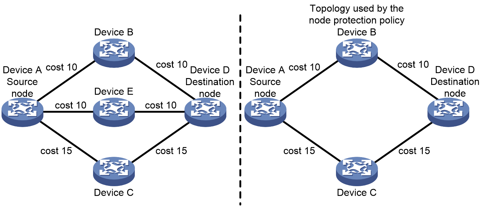

As shown in Figure 18, flexible algorithm TI-LFA is deployed on all network nodes. The FAD is as follows:
·     Use the SPF algorithm.
·     Calculate the smallest cost path based on IS-IS link cost. Assume that the cost is 10 for all links.
·     Exclude links with affinity attribute red.
Before the link between Device B and Device C recovers, traffic traverses along the backup path. After the link recovers, Device A will forward the traffic to Device B if Device A finishes route convergence before Device B. Before Device B also finishes route convergence, Device B still forwards the traffic along the backup path. A loop is formed between Device A and Device B.
SR microloop avoidance can resolve this issue. After the link recovers, SR microloop avoidance automatically calculates the optimal path from Device A to Device C and forwards traffic along the path. To forward a packet along the newly calculated path, Device A adds end-to-end path information, for example, the adjacency SID from Device B to Device C to the packet and then sends the packet to Device B. Then, Device B forwards the packet to Device C based on the path information.
When the SR microloop avoidance delay timer expires, Device B should have finished route convergence. Device A does not add path information to packets anymore, and it forwards packets to Device C as usual.
Figure 18 Network diagram
If you configure both FRR microloop avoidance and SR microloop avoidance for a flexible algorithm, both the FRR microloop avoidance delay timer and the SR microloop avoidance delay timer start. In this scenario, FRR microloop avoidance and SR microloop avoidance take effect as follows:
·     If the FRR microloop avoidance delay time is longer than or equivalent to the SR microloop avoidance delay time, the traffic switches to the post-convergence path immediately after the FRR microloop avoidance delay timer expires.
·     If the FRR microloop avoidance delay time is shorter than the SR microloop avoidance delay time, the traffic switches to the post-convergence path after the SR microloop avoidance delay timer expires.

Set the priority of an FRR backup path selection policy
IS-IS flexible algorithm FRR selects a backup path based on the following policies:
·     Node-protection policy—Selects the path that involves a specific node.
·     Lowest-cost policy—Selects the path that has the lowest cost.
As shown in Figure 19, flexible algorithm 128 is configured for all nodes on the network. The FAD of flexible algorithm 128 is as follows:
·     Constraint—Exclude affinity attribute blue.
Traffic forwarding path Device A->Device E->Device F->Device G->Device H has three backup paths. You can set the priority of each backup path selection policy as follows to control backup path selection:
·     To select path Device A->Device E->Device F->Device C->Device D ->Device H that involves Device E, set a higher priority for the node-protection policy than the lowest-cost policy.
·     To select path Device A->Device B->Device C->Device F->Device G ->Device H that has the lowest cost, set a higher priority for the lowest-cost policy than the node-protection policy.
Figure 19 IS-IS FRR backup path selection
If the node-protection policy has a higher priority but the backup path calculation fails, IS-IS uses the lowest-cost policy for further calculation. If the backup path calculation still fails, IS-IS does not perform further backup path calculation.
If the lowest-cost policy has a higher priority but the backup path calculation fails, IS-IS does not perform further backup path calculation.
4.     Set the priority for a backup path selection policy.
fast-reroute tiebreaker { lowest-cost | node-protecting } preference preference [ level-1 | level-2 ]
By default, the priority values of the node-protection and lowest-cost backup path selection policies are 40 and 20, respectively.
Applying a flexible algorithm to SR-MPLS

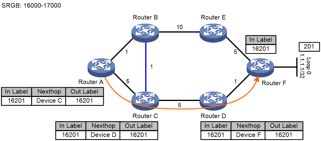

IS-IS advertises a prefix SID together with the algorithm ID associated to that prefix SID. By default, the algorithm ID associated to a prefix SID is 0. In this case, IS-IS uses the SPF algorithm and IS-IS link cost to calculate the optimal path to the prefix of that prefix SID.
After you associate a prefix SID to a flexible algorithm, IS-IS uses the flexible algorithm to calculate the optimal path to the prefix of that prefix SID. For example, you can associate the prefix SID configure on the loopback interface of Router F to flexible algorithm 130. The FAD of flexible algorithm 130 is as follows:
SID index value 201 is assigned to loopback address 1.1.1.1/32 on Router F. The incoming label calculated by Router F is 16201. After using flexible algorithm 130 to calculate the optimal path to 1.1.1.1/32, Router A creates a label forwarding entry. The incoming label is 16201, the outgoing label is 16201, and the next hop is Router C. Figure 20 shows the established SRLSP from Router A to Router F.
Figure 20 SRLSP from Router A to Router F with flexible algorithm 130
2.     Enter loopback interface view.
interface loopback interface-number
3.     Associate an IS-IS prefix SID to a flexible algorithm.
isis [ process-id process-id ] prefix-sid algorithm algorithm-id { absolute absolute-value | index index-value } [ n-flag-clear | { explicit-null | no-php } ] *
By default, an IS-IS prefix SID is not associated to any flexible algorithm.
For more information about this command, see SR-MPLS commands in Segment Routing Command Reference.

Applying a flexible algorithm to SRv6

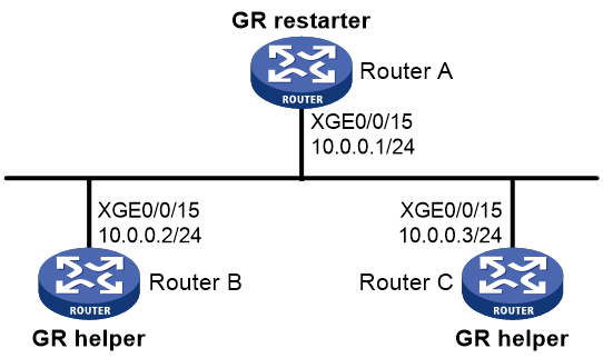

With SRv6 enabled, IS-IS advertises SRv6 locator TLVs in LSPs. You can identify the algorithm associated to the locator by checking the algorithm field in an SRv6 locator TLV. By default, IS-IS uses the SPF algorithm to calculate the shortest path to an SRv6 locator, and the value for the algorithm field is 0.
If you associate an SRv6 locator to a flexible algorithm, IS-IS uses the flexible algorithm to calculate the shortest path to the locator. For example, you can associate the SRv6 locators in Figure 21 to flexible algorithm 130. The FAD of flexible algorithm 130 is as follows:
As shown in Figure 21, Router A uses the SPF algorithm to calculate the optimal path to locator 2001:0:8:6::/64 based on the topology of flexible algorithm 130.
Figure 21 Optimal path calculated by flexible algorithm 130
You must associate an SRv6 locator to a flexible algorithm that already exists, or IS-IS will not advertise the locator.

Configuring the administrative tag value for an interface
This task simplifies route management by allowing IS-IS to control IP address prefixes with the administrative tag.
As shown in Figure 22, Device A needs to communicate with Device B, Device C, and Device D. For security purposes, other devices in areas 2, 3, and 5 should not receive the packets sent by Device A. To resolve this issue, perform the following task:
1.     Configure the same administrative tag value for the IS-IS interfaces on Device B, Device C, and Device D.
2.     Configure route leaking from Level-2 to Level-1 on the Level-1-2 device in Area 4 and specify the same tag value as the route filter.
As shown in Figure 23, the IS-IS network topology on Device A is updated after you perform the above task.
Figure 22 IS-IS network diagram without the administrative tag
Figure 23 IS-IS network diagram with the administrative tag
Configuring the IPv4 IS-IS administrative tag value for an interface
2.     Enter interface view.
3.     Configure the IPv4 IS-IS administrative tag value for the interface.
isis tag tag
By default, the IPv4 IS-IS administrative tag value of the interface is not configured.
IS-IS adds the administrative tag to the network address information in LSPs only if the following conditions exist:
¡     An administrative tag value is specified.
¡     The link cost style is wide, wide-compatible, or compatible.

As shown in Figure 24, both Device A and Device B support LSP fragment extension. With LSP fragment extension enabled, Device A advertises some route information in the LSPs generated by Device A1 and Device A2. On receipt of these LSPs, Device B reads the IS Alias ID TLVs and determines that Device A is the originating system. The route information received from Device A1 and Device A2 is actually generated by Device A. In this situation, virtual systems do not participate in route calculation.
Figure 24 IS-IS LSP fragment extension

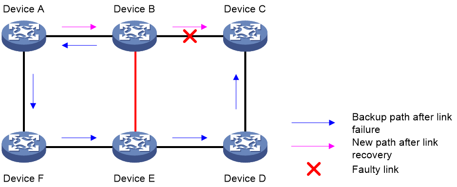

Multiple P2P links might exist on an NBMA network. As shown in Figure 25, Routers A, B, C and D run IS-IS. When Router A generates an LSP, it floods the LSP out of Serial0/0/16:0, Serial0/0/17:0, and Serial2/1/3. After Router D receives the LSP from Serial2/1/3, it floods it out of Serial0/0/16:0 and Serial0/0/17:0 to Router B and Router C. However, Router B and Router C have already received the LSP from Router A. Repeated LSP flooding consumes extra bandwidth.
Figure 25 Network diagram of a fully meshed network
To avoid this issue, you can add interfaces to a mesh group or block some interfaces.
·     An interface in a mesh group floods a received LSP only to interfaces not in the mesh group.
·     A blocked interface sends LSPs only after receiving LSP requests.
Before you configure this task, you must consider redundancy for interfaces in case LSP packets cannot be flooded because of link failures.

By setting the overload bit in sent LSPs, an IS-IS device informs other devices of failures that make it unable to select routes and forward packets. The device is then excluded from the SPF calculation by other devices except its direct routes.
When an IS-IS device cannot record the complete LSDB, for example, because of memory insufficiency, it will calculate routes incorrectly. To locate the faulty device, you can temporarily isolate the suspects from the IS-IS network by setting the overload bit.

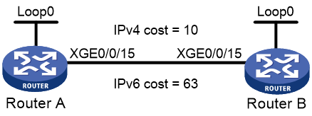

As shown in Figure 26, the path from Device A to the IP network should be Device A > Device D > Device E > IP network. After you set the overload bit in the LSPs sent by Device D, the path from Device A to the IP network becomes Device A > Device B > Device C > Device E > IP network. If the packets from Device A are destined for Device D's directly-connected networks, the forwarding path does not change.
Figure 26 Overload bit

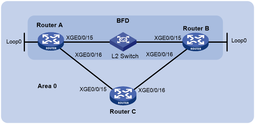

Configuring BFD for IS-IS
Enabling BFD for IS-IS
IS-IS exchanges hello packets at specific intervals with its neighbors to detect neighbor state changes. If IS-IS does not receive any hello packets from a neighbor within the advertised neighbor relationship hold time, it considers the neighbor down and recalculates the routes. The hold time is the hello multiplier multiplied by the hello interval and the default hold time is 30 seconds. This mechanism is not efficient at neighbor state change detection. Serious packet loss might occur when a neighbor goes down.
To resolve this issue, perform this task to enable BFD for IS-IS. BFD provides a single mechanism to quickly detect and monitor the connectivity of links between IS-IS neighbors, reducing network convergence time. For more information about BFD, see High Availability Configuration Guide.
You can use the bfd all-interfaces enable, isis bfd enable, or isis ipv6 bfd enable command to enable IS-IS BFD. These commands are different as follows:
·     The bfd all-interfaces enable command takes effect on all interfaces in an IPv4 or IPv6 IS-IS process. To disable BFD on an interface in the IS-IS process, use the isis bfd exclude or isis ipv6 bfd exclude command on the interface.
·     The isis bfd enable and isis ipv6 bfd enable commands take effect only on one IS-IS interface. To enable BFD on an IS-IS interface, perform the following tasks:
a.     Make sure the IS-IS process to which the interface belongs is not enabled with BFD session state-based interface cost adjustment.
b.     You can use the undo bfd all-interfaces enable command to disable BFD for an IS-IS process.
c.     Use the isis bfd enable or isis ipv6 bfd enable command to enable BFD on the IS-IS interface.
Configuring BFD for an IS-IS process
3.     Enter IPv4 address family view or IPv6 address family view.
¡     Enter IPv4 address family view.
address-family ipv4 [ unicast ]
¡     Enter IPv6 address family view.
4.     Enable BFD for the IS-IS process.
By default, BFD is disabled for an IS-IS process.
5.     (Optional.) Suppress the BFD capacity of an IPv4 IS-IS interface.
a.     Return to IS-IS view.
b.     Return to system view.
c.     Enter interface view.
d.     Suppress the BFD capacity of the IS-IS interface.
IPv4:
isis bfd exclude
IPv6:
By default, the BFD capacity of an IS-IS interface is not suppressed.
Configuring BFD on an IS-IS interface
3.     Enable BFD on an IPv4 IS-IS interface.
IPv4:
isis bfd enable
By default, the IPv4 IS-IS interface inherits the configuration of the bfd all-interfaces enable command in IS-IS IPv4 unicast address family view.
IPv6:
By default, the IPv6 IS-IS interface inherits the configuration of the bfd all-interfaces enable command in IS-IS IPv6 unicast address family view.

Controlling adjacency establishment and maintenance based on BFD session state
When BFD detects a Layer 3 forwarding failure between two routers, the BFD session goes down, which causes the IS-IS adjacency to go down. If Layer 2 forwarding is still available, the routers can exchange IS-IS packets and re-establish the adjacency, which might cause traffic loss.
To avoid the issue, enable this feature on the BFD-enabled interfaces of the local and remote routers, enabling the interfaces to carry BFD-enabled TLVs in hello packets. After the BFD session goes down, the routers do not establish an adjacency if the exchanged BFD-enabled TLVs are identical.
If the IS-IS neighbor relationship goes down because of Layer 2 forwarding failure between the devices, the interface-associated BFD session state is not affected. That is, when the IS-IS neighbor state changes from up to down, the associated BFD session state does not go down.
If two IS-IS routers establish both IPv4 and IPv6 adjacency relationships, the following rules apply:
·     If route calculation is not performed separately for the IPv4 and IPv6 topologies, the IPv4 or IPv6 adjacency relationship is up only when both the IPv4 and IPv6 BFD sessions are up.
·     If route calculation is performed separately for the IPv4 and IPv6 topologies, the IPv4 or IPv6 adjacency relationship is up when the corresponding IPv4 or IPv6 BFD session is up.
If two IS-IS routers establish only an IPv4 or IPv6 adjacency relationship, the adjacency relationship is up when the corresponding IPv4 or IPv6 BFD session is up.
For more information about BFD, see BFD configuration in High Availability Configuration Guide.

A link or router failure on a path can cause packet loss. IS-IS LFA FRR enables fast rerouting to minimize the failover time.
Figure 27 Network diagram for IS-IS LFA FRR
In Figure 27, after you enable LFA FRR on Router B, IS-IS automatically calculates or designates a backup next hop when a link failure is detected. In this way, packets are directed to the backup next hop to reduce traffic recovery time. Meanwhile, IS-IS calculates the shortest path based on the new network topology, and forwards packets over the path after network convergence.
When a primary link failure occurs, BFD can detect and report the link failure to IS-IS for a primary-backup path switchover. This can shorten the duration of service interruption.
You can assign a backup next hop for IS-IS FRR through the following ways:
·     Enable IS-IS LFA FRR to calculate a backup next hop through LFA calculation.
·     Designate a backup next hop with a routing policy for routes matching specific criteria.
IS-IS ECMP FRR
In ECMP scenarios, IS-IS supports using the LFA algorithm to calculating backup next hops independently for multiple ECMP primary paths. That is, it calculates a backup next hop for each ECMP route. In this case, the backup next hops for all ECMP routes might be different.
As shown in Figure 28, traffic is forwarded from source node Device A to destination node Device D, and is load shared among Link 1, Link 2, and Link 3.
·     Without ECMP FRR enabled, the LFA algorithm does not calculate a backup next hop separately for Link 1, Link 2, and Link 3. When Link 1 fails, traffic on Link 1 is randomly switched to Link 2 or Link 3. This does not facilitate service traffic management.
·     With ECMP FRR enabled, the LFA algorithm calculates a backup next hop separately for Link 1, Link 2, and Link 3. For example, if the calculated backup next hop for Link 1 is Device C, when Link 1 fails, traffic is switched to backup next hop Device C. This facilitates service traffic management.
Figure 28 IS-IS ECMP FRR
IS-IS ECMP-shared FRR
In ECMP scenarios, IS-IS supports using the LFA algorithm to calculating a shared backup next hop for multiple ECMP primary paths. All ECMP routes has the same backup next hop.
As shown in Figure 29, traffic is forwarded from source node Device A to destination node Device D, and is load shared between Link 1 and Link 2.
·     Without ECMP-shared FRR enabled, the LFA algorithm does not calculate a backup next hop for Link 1 or Link 2. When Device B fails, Link 1 and Link 2 become unavailable, and traffic is interrupted before route reconvergence is completed.
·     With ECMP-shared FRR enabled, the LFA algorithm calculates a shared backup next hop for Link 1 and Link 2. When Device B fails, traffic is switched to backup next hop Device C. This avoids traffic interruption.
Figure 29 IS-IS ECMP-shared FRR
In a ring topology where IS-IS LFA FRR cannot calculate the backup path, configure remote LFA FRR to ensure network reliability.
Remote LFA uses the following concepts:
·     P space—Use the source node of the protected link as the root to establish a shortest path tree. All nodes that are reachable from the source node without passing the protected link form the P space. Nodes in the P space are called P nodes.
·     Extended P space—Use the source node of the protected link and its neighbors as the roots to establish shortest path trees. All nodes that are reachable from the source node or one of its neighbors without passing the protected link form the extended P space. The P space is a subset of the extended P space.
·     Q space—Use the destination node of the protected link as the root to establish a reverse shortest path tree. All nodes that are reachable from the root node without passing the protected link form the Q space. Nodes in the Q space are called Q nodes.
·     PQ node—A PQ node refers to a node that resides in both the extended P space and the Q space. Remote LFA uses a PQ node as the destination node of a protected link.
As shown in Figure 30, the traffic forwarding path is PE 1—P 1—P 2—PE 2. To avoid traffic loss caused by link failures between P 1 and P 2, the system establishes an LDP tunnel between P 1 and P 4, which is the PQ node. When the link between P 1 and P 2 fails, P 1 encapsulates IP packets in MPLS packets and sends the MPLS packets to P 4 through the LDP tunnel. After receiving the MPLS packets, P 4 removes the MPLS labels of the packets and then forwards the packets to the next hop based on the IP routing table.
The system determines P 4 as the PQ node as follows:
1.     Uses P 1 (source node of the protected link) and its neighbors except P 2 (which passes the protected link) as the roots to establish shortest path trees.
2.     Finds out all nodes that are reachable from P 1 or one of its neighbors without passing the protected link, which are PE 1, P 1, P 3, and P 4.
These nodes form the extended P space.
3.     Uses P 2 (destination node of the protected link) as the root to establish a reverse shortest path tree.
4.     Finds out all nodes that are reachable from P 2 without passing the protected link, which are PE 2 and P 4.
These nodes form the Q space.
5.     Finds out all nodes that reside in both the extended P space and the Q space.
Only P 4 resides in both the extended P space and the Q space, so P 4 is the PQ node of the protected link.
Figure 30 Network diagram for IS-IS remote LFA FRR

IS-IS FRR performs backup path calculation based on different policies as follows:
·     Backup path calculation based on node protection policy
As shown in Figure 31, Device A uses the node protection policy to calculate backup path Device A->Device B->Device D.
Figure 31 Node protection policy
·     Backup path calculation based on lowest cost policy
As shown in Figure 32, Device A uses the lowest cost policy to calculate backup path Device A->Device E->Device D.
Figure 32 Lowest cost policy
·     Backup path calculation based on node protection policy + SRLG-disjoint policy
As shown in Figure 33, Device A uses node protection policy + SRLG-disjoint policy to calculate backup path Device A->Device B->Device D.
Figure 33 SRLG-disjoint policy
·     Backup path calculation based on node protection policy, with non-ECMP primary paths preferred as backup paths
As shown in Figure 34, Device A->Device B->Device D and Device A->Device E->Device D are ECMP paths. By default, Device A uses the node protection policy to calculate backup path Device A->Device B->Device D for Device A->Device E->Device D.
If the non-ECMP policy has higher priority than the node protection policy, Device A excludes Device A->Device B->Device D that forms ECMP paths with Device A->Device E->Device D from the candidate backup paths. Then it selects Device A->Device C->Device D as the backup path for Device A->Device E->Device D.
Figure 34 Node protection policy

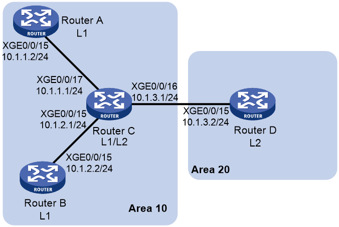

IS-IS configuration examples

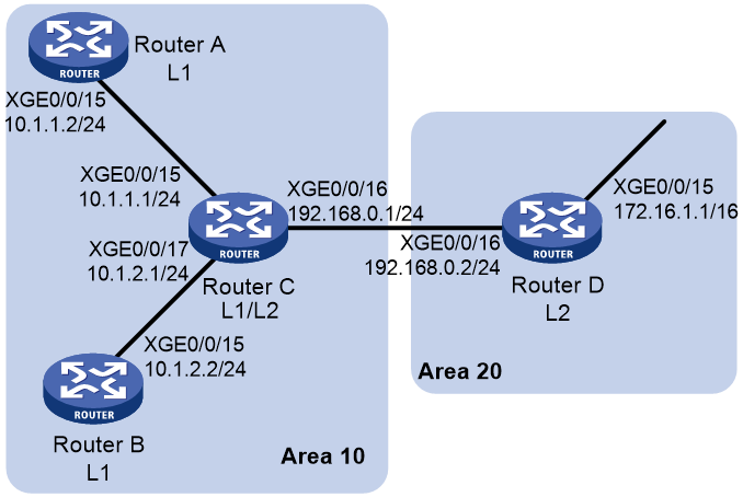

Example: Configuring basic IS-IS
As shown in Figure 35, Router A, Router B, Router C, and Router D reside in an AS.
Router A and Router B are Level-1 routers, Router D is a Level-2 router, and Router C is a Level-1-2 router connecting two areas. Router A, Router B, and Router C are in area 10, and Router D is in area 20.
Figure 35 Network diagram
1.     Configure IP addresses for interfaces. (Details not shown.)
2.     Configure IS-IS:
# Configure Router A
<RouterA> system-view
[RouterA] isis 1
[RouterA-isis-1] is-level level-1
[RouterA-isis-1] network-entity 10.0000.0000.0001.00
[RouterA-isis-1] quit
[RouterA] interface ten-gigabitethernet 0/0/15
[RouterA-Ten-GigabitEthernet0/0/15] isis enable 1
[RouterA-Ten-GigabitEthernet0/0/15] quit
# Configure Router B.
<RouterB> system-view
[RouterB] isis 1
[RouterB-isis-1] is-level level-1
[RouterB-isis-1] network-entity 10.0000.0000.0002.00
[RouterB-isis-1] quit
[RouterB] interface ten-gigabitethernet 0/0/15
[RouterB-Ten-GigabitEthernet0/0/15] isis enable 1
[RouterB-Ten-GigabitEthernet0/0/15] quit
# Configure Router C.
<RouterC> system-view
[RouterC] isis 1
[RouterC-isis-1] network-entity 10.0000.0000.0003.00
[RouterC-isis-1] quit
[RouterC] interface ten-gigabitethernet 0/0/17
[RouterC-Ten-GigabitEthernet0/0/17] isis enable 1
[RouterC-Ten-GigabitEthernet0/0/17] quit
[RouterC] interface ten-gigabitethernet 0/0/15
[RouterC-Ten-GigabitEthernet0/0/15] isis enable 1
[RouterC-Ten-GigabitEthernet0/0/15] quit
[RouterC] interface ten-gigabitethernet 0/0/16
[RouterC-Ten-GigabitEthernet0/0/16] isis enable 1
[RouterC-Ten-GigabitEthernet0/0/16] quit
# Configure Router D
<RouterD> system-view
[RouterD] isis 1
[RouterD-isis-1] is-level level-2
[RouterD-isis-1] network-entity 20.0000.0000.0004.00
[RouterD-isis-1] quit
[RouterD] interface ten-gigabitethernet 0/0/15
[RouterD-Ten-GigabitEthernet0/0/15] isis enable 1
[RouterD-Ten-GigabitEthernet0/0/15] quit
[RouterD] interface ten-gigabitethernet 0/0/16
[RouterD-Ten-GigabitEthernet0/0/16] isis enable 1
[RouterD-Ten-GigabitEthernet0/0/16] quit
# Display the IS-IS LSDB information.
[RouterA] display isis lsdb
                        Database information for ISIS(1)
                          Level-1 Link State Database
LSPID                 Seq Num      Checksum      Holdtime      Length  ATT/P/OL
0000.0000.0001.00-00* 0x00000004   0xdf5e        1096          68      0/0/0
0000.0000.0002.00-00  0x00000004   0xee4d        1102          68      0/0/0
0000.0000.0002.01-00  0x00000001   0xdaaf        1102          55      0/0/0
0000.0000.0003.00-00  0x00000009   0xcaa3        1161          111     1/0/0
0000.0000.0003.01-00  0x00000001   0xadda        1112          55      0/0/0
    *-Self LSP, +-Self LSP(Extended), ATT-Attached, P-Partition, OL-Overload
[RouterB] display isis lsdb
0000.0000.0001.00-00  0x00000006   0xdb60        988           68      0/0/0
0000.0000.0002.00-00* 0x00000008   0xe651        1189          68      0/0/0
0000.0000.0002.01-00* 0x00000005   0xd2b3        1188          55      0/0/0
0000.0000.0003.00-00  0x00000014   0x194a        1190          111     1/0/0
0000.0000.0003.01-00  0x00000002   0xabdb        995           55      0/0/0
[RouterC] display isis lsdb
0000.0000.0001.00-00  0x00000006   0xdb60        847           68      0/0/0
0000.0000.0002.00-00  0x00000008   0xe651        1053          68      0/0/0
0000.0000.0002.01-00  0x00000005   0xd2b3        1052          55      0/0/0
0000.0000.0003.00-00* 0x00000014   0x194a        1051          111     1/0/0
0000.0000.0003.01-00* 0x00000002   0xabdb        854           55      0/0/0
                          Level-2 Link State Database
0000.0000.0003.00-00* 0x00000012   0xc93c        842           100     0/0/0
0000.0000.0004.00-00  0x00000026   0x331         1173          84      0/0/0
0000.0000.0004.01-00  0x00000001   0xee95        668           55      0/0/0
[RouterD] display isis lsdb
0000.0000.0003.00-00  0x00000013   0xc73d        1003          100     0/0/0
0000.0000.0004.00-00* 0x0000003c   0xd647        1194          84      0/0/0
0000.0000.0004.01-00* 0x00000002   0xec96        1007          55      0/0/0
# Display the IS-IS routing information on each router.
[RouterA] display isis route
                         Route information for IS-IS(1)
                         Level-1 IPv4 Forwarding Table
 IPv4 Destination     IntCost    ExtCost ExitInterface   NextHop         Flags
 10.1.1.0/24          10         NULL    XGE0/0/15         Direct          D/L/-
 10.1.2.0/24          20         NULL    XGE0/0/15         10.1.1.1        R/-/-
 192.168.0.0/24       20         NULL    XGE0/0/15         10.1.1.1        R/-/-
 0.0.0.0/0            10         NULL    XGE0/0/15         10.1.1.1        R/-/-
      Flags: D-Direct, R-Added to Rib, L-Advertised in LSPs, U-Up/Down Bit Set
[RouterC] display isis route
 10.1.2.0/24          10         NULL    XGE0/0/17         Direct          D/L/-
 192.168.0.0/24       10         NULL    XGE0/0/16         Direct          D/L/-
                         Level-2 IPv4 Forwarding Table
 10.1.1.0/24          10         NULL                                    D/L/-
 10.1.2.0/24          10         NULL                                    D/L/-
 192.168.0.0/24       10         NULL                                    D/L/-
 172.16.0.0/16        20         NULL    XGE0/0/16         192.168.0.2     R/-/-
[RouterD] display isis route
 10.1.1.0/24          20         NULL    XGE0/0/16         192.168.0.1     R/-/-
 10.1.2.0/24          20         NULL    XGE0/0/16         192.168.0.1     R/-/-
 172.16.0.0/16        10         NULL    XGE0/0/15         Direct          D/L/-
The output shows that the routing table of Level-1 routers contains a default route with the next hop as the Level-1-2 router. The routing table of Level-2 router contains all Level-1 and Level-2 routes.
