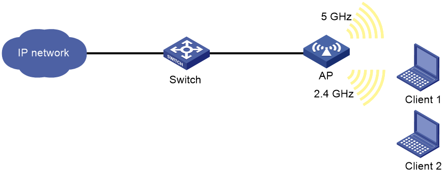

Band navigation enables the AP to direct dual-band clients (2.4 GHz and 5 GHz) to the 5 GHz radio whenever possible to avoid congestion in the 2.4 GHz band. This can load balance the radios and improve network performance.
As shown in Figure 1, band navigation is enabled in the WLAN. Client 1 and Client 2 are associated with the 2.4 GHz radio. When the dual-band client Client 3 requests to associate with the 2.4 GHz radio, the AP rejects Client 3 and directs it to the 5 GHz radio.

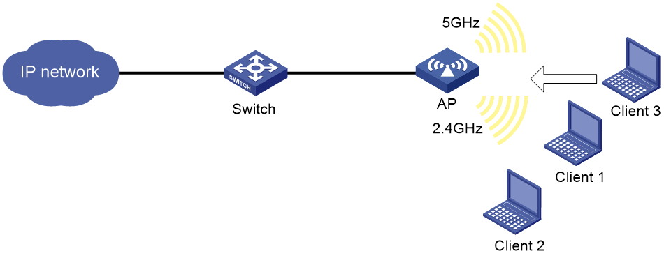

As shown in Figure 2, both the 5 GHz radio and the 2.4 GHz radio are enabled on the fat AP. Configure band navigation and load balancing for band navigation to load balance the radios.

1.     Verify that a dual-band client is associated with the 5 GHz radio when it requests to associate with the AP. (Details not shown.)
2.     Verify that a dual-band client is associated with the 2.4 GHz radio when the following conditions are met:
¡     The number of clients on the 5 GHz radio reaches 5.
¡     The client number gap between the 5 GHz radio and the 2.4 GHz radio reaches 2. (Details not shown.)
