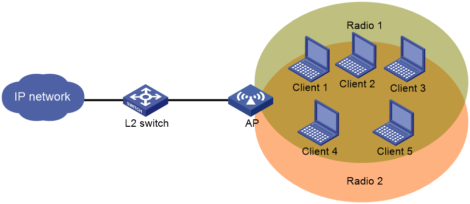

Networking scheme
Load balancing can be performed only among radios that can be detected by the same client. As shown in Figure 1, Radio 1 and Radio 2 of the AP are enabled. Client 1, Client 2, and Client 3 are associated with radio 1, and Client 4 is associated with Radio 2. Load balancing is enabled on the AP. Radio 1 has reached its maximum load. When Client 5 tries to associate with Radio 1, the AP rejects the association request and directs Client 5 to Radio 2.
Figure 1 Network diagram

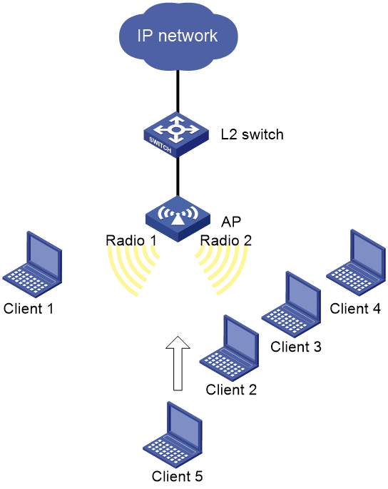

As shown in Figure 2, Radio 1 and Radio 2 are enabled on the AP. Client 1 associates with Radio 1, and Client 2 through Client 4 associate with Radio 2. The session threshold and session gap threshold are set to 3 and 2, respectively. When Client 5 tries to associate with Radio 2, Radio 2 rejects the request because both the session threshold and session gap threshold are reached.
Figure 2 Session-mode load balancing
