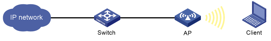

As shown in Figure 1, configure radio resource measurement to meet the following requirements:
·     The client can come online only when all its radio resource measurement capabilities match the AP's.
·     The client can perform all types of measurements.
Figure 1 Network diagram
# Create service template 1.
<FAT AP> system-view
[FAT AP] wlan service-template 1
# Set the SSID to resource-measure, and enable the service template.
[FAT AP-wlan-st-1] ssid resource-measure
[FAT AP-wlan-st-1] service-template enable
[FAT AP-wlan-st-1] quit
# Enter radio interface view of WLAN-Radio 1/0/1.
[FAT AP] interface wlan-radio 1/0/1
# Enable spectrum management.
[FAT AP-WLAN-Radio1/0/1] spectrum-management enable
# Enable radio resource measurement.
[FAT AP-WLAN-Radio1/0/1] resource-measure enable
# Enable all measurement features.
[FAT AP-WLAN-Radio1/0/1] measure all enable
# Set the match mode for client radio resource measurement capabilities to All.
[FAT AP-WLAN-Radio1/0/1] rm-capability mode all
# Bind the service template to radio interface WLAN-Radio 1/0/1.
[FAT AP-WLAN-Radio1/0/1] service-template 1
[FAT AP-WLAN-Radio1/0/1] quit
# Verify that the client has come online.
