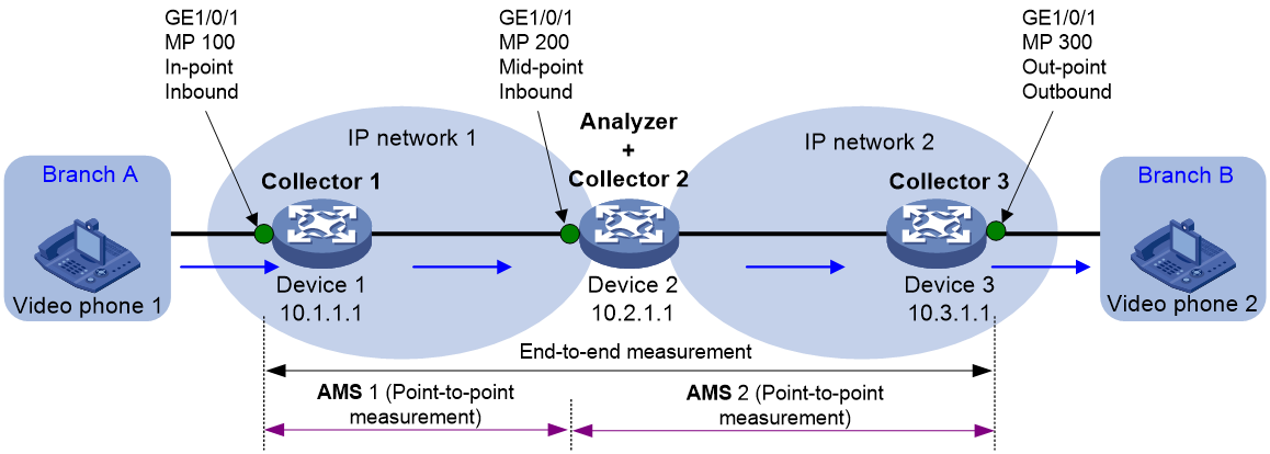

As shown in Figure 7, to configure point-to-point measurement, define AMSs, specify the flow direction in each AMS, and configure the ingress MP group and egress MP group for each AMS.
Figure 7 Point-to-point packet loss measurement

·     In AMS 1: Packet loss = Number of packets at MP 100 – Number of packets at MP 200
·     In AMS 2: Packet loss = Number of packets at MP 200 –  Number of packets at MP 300

Example: Configuring an end-to-end iNQA packet loss measurement
As shown in Figure 9, Video phone 1 sends a video data flow to Video phone 2 through an IP network. The Video phone 2 is experiencing an erratic video display problem.
·     Enable the collector functionality on Device 1 and Device 2 and enable the analyzer functionality on Device 2.
·     Define the flow from Device 1 to Device 2 as the forward flow.
·     Set the packet loss upper limit and packet loss lower limit to 6% and 4%, respectively.
Figure 9 Network diagram
1.     Assign 10.1.1.1 and 10.2.1.1 to Collector 1 and Collector 2, respectively.
2.     Configure OSPF in the IP network to make Collector 1 and the analyzer can reach each other. (Details not shown.)
3.     Configure NTP or PTP on Collector 1 and Collector 2 for clock synchronization. (Details not shown.)

·     Enable the collector functionality on Device 1, Device 2, and Device 3, and enable the analyzer functionality on Device 2.
·     Define the flow from Device 1 to Device 3 as the forward flow.
·     Run the packet loss measurement for 15 minutes.
Figure 10 Network diagram
1.     Assign 10.1.1.1, 10.2.1.1, and 10.3.1.1 to Collector 1, Collector 2, and Collector 3, respectively.
2.     Configure OSPF in the IP network to make sure the analyzer Collector 1, Collector 3, and the analyzer can reach each other. (Details not shown.)
3.     Configure NTP or PTP on Collector 1, Collector 2, and Collector 3 for clock synchronization. (Details not shown.)
