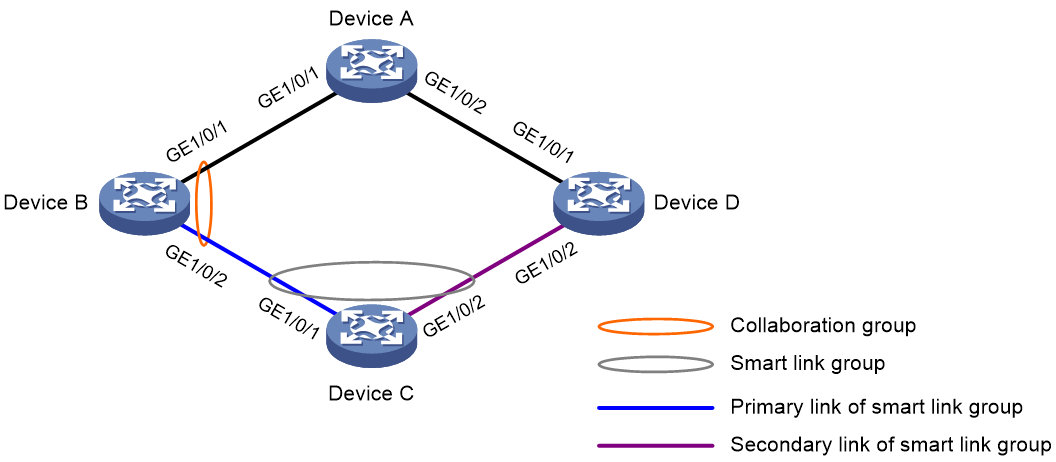

Typical application
As shown in Figure 1, Device C accesses the core network through Device B. When Interface B1 goes down, the switchover of traffic from Device C to Device D is slow because Interface B2 is still up.
If Interface B1 and Interface B2 belong to one collaboration group, Device B brings down Interface B2 when Interface B1 goes down to achieve fast traffic switchover. Similarly, the device brings down Interface B1 when Interface B2 goes down.
Figure 1 Interface collaboration application scenario
How interface collaboration works
The interface collaboration feature works as follows:
·     When any member interface in a collaboration group goes down, the device sets all other member interfaces in the collaboration group to the Collaboration-down state. The state of the collaboration group is down, and no member interfaces in the collaboration group can transmit packets.
·     When any member interface in DOWN or Collaboration-down state comes up, the device attempts to bring up all other member interfaces in the collaboration group.
¡     If all other member interfaces come up in 10 seconds, the collaboration group comes up. All member interfaces in the collaboration group can transmit packets.
¡     If any member interface cannot come up in 10 seconds, the device sets that member interface to DOWN state and sets all other member interfaces to the Collaboration-down state. The collaboration group goes down, and no member interfaces in the collaboration group can transmit packets.

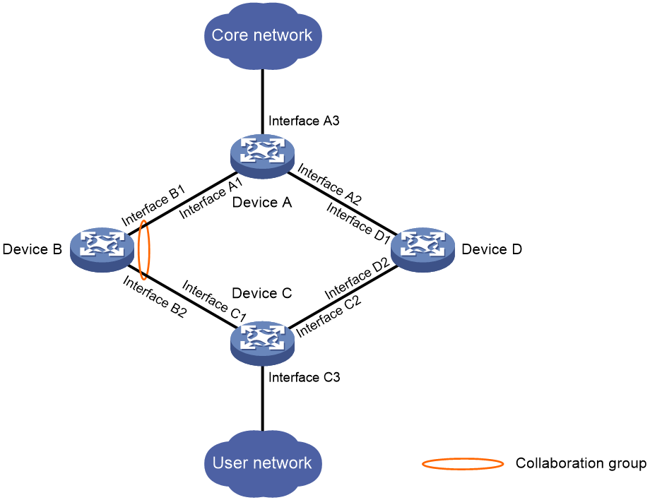

As shown in Figure 2, configure interface collaboration on Device B. When GigabitEthernet 1/0/1 on Device B goes down, Device B brings down GigabitEthernet 1/0/2. When GigabitEthernet 1/0/2 on Device B goes down, Device B brings down GigabitEthernet 1/0/1.
Figure 2 Network diagram
1.     Configure routes to enable Device A and Device C to prefer the route through Device B for forwarding traffic to each other. (This example uses static routes):

1.     Verify that the state of the uplink interface affects the state of the downlink interface.
# Display the static routing information on Device C.
[DeviceC] display ip routing-table protocol static
Summary count : 3
Static Routing table status : <Active>
Summary count : 3
Destination/Mask   Proto   Pre Cost        NextHop         Interface
1.1.2.0/24         Static  60  0           1.1.5.1         GE1/0/1
1.1.3.0/24         Static  60  0           1.1.6.2         GE1/0/2
1.1.4.0/24         Static  50  0           1.1.5.1         GE1/0/1
Static Routing table status : <Inactive>
Summary count : 0
The output shows that the effective route from Device C to Device A goes through Device B.
# Shut down GigabitEthernet 1/0/1 on Device B, and display information about collaboration group 1.
[DeviceB] display collaboration-group 1 verbose
Collaboration group protocol status: Enabled
Collaboration group 1 information:
  Group status     : DOWN
  Member up delay  : 0 seconds
  Last up time     : 16:55:34 2017/04/05
  Last down time   : 16:57:22 2017/04/05
  Member                    Status
  GE1/0/1                   DOWN
  GE1/0/2                   Collaboration-down
The output shows that collaboration group 1 is in DOWN state, GigabitEthernet 1/0/1 is in DOWN state, and GigabitEthernet 1/0/2 is in Collaboration-down state.
Summary count : 2
Summary count : 2
1.1.4.0/24         Static  70  0           1.1.6.2         GE1/0/2
Summary count : 0
The output shows that the effective route from Device C to Device A goes through Device D.
2.     Verify that the state of the downlink interface affects the state of the uplink interface.
# Display the static routing information on Device A.
[DeviceA] display ip routing-table protocol static
Summary count : 3
Summary count : 3
1.1.5.0/24         Static  60  0           1.1.2.2         GE1/0/1
1.1.6.0/24         Static  60  0           1.1.3.2         GE1/0/2
1.1.7.0/24         Static  50  0           1.1.2.2         GE1/0/1
Summary count : 0
The output shows that the effective route from Device A to Device C goes through Device B.
# Shut down GigabitEthernet 1/0/2 on Device B, and display information about collaboration group 1.
  Group status     : DOWN
  Last up time     : 17:11:47 2017/04/05
  Last down time   : 17:14:37 2017/04/05
  Member                    Status
  GE1/0/1                   Collaboration-down
  GE1/0/2                   DOWN
The output shows that collaboration group 1 is in DOWN state, GigabitEthernet 1/0/1 is in Collaboration-down state, and GigabitEthernet 1/0/2 is in DOWN state.
Summary count : 2
Summary count : 2
1.1.7.0/24         Static  70  0           1.1.3.2         GE1/0/2
Summary count : 0
The output shows that the effective route from Device A to Device C goes through Device D.

[DeviceB-collaboration-group1] port gigabitethernet 1/0/1
[DeviceB-collaboration-group1] port gigabitethernet 1/0/2
# Display information about smart link group 1 on Device C.
[DeviceC] display smart-link group 1
Smart link group 1 information:
  Device ID       : 2007-6f03-0700
  Preemption mode : None
  Preemption delay: 1(s)
  Control VLAN    : 1
  Protected VLAN  : Reference Instance 1
  Member                  Role      State   Flush-count     Last-flush-time
  GE1/0/1                 PRIMARY   ACTIVE  2               20:19:28 2017/04/05
  GE1/0/2                 SECONDARY STANDBY 0               NA
The output shows that the primary port of smart link group 1 is GigabitEthernet 1/0/1, and the traffic is sent out of GigabitEthernet 1/0/1.
  Group status     : DOWN
  Last up time     : 20:19:58 2017/04/05
  Last down time   : 20:27:02 2017/04/05
  Member                    Status
  GE1/0/1                   DOWN
  Control VLAN    : 1
  GE1/0/1                 PRIMARY   DOWN    2               20:19:28 2017/04/05
  GE1/0/2                 SECONDARY ACTIVE  1               20:26:35 2017/04/05
The output shows that GigabitEthernet 1/0/2 becomes the primary port of smart link group 1, and the traffic is sent out of GigabitEthernet 1/0/2.
# Display information about GigabitEthernet 1/0/1 on Device A.
[DeviceA] display interface gigabitethernet 1/0/1 brief
Brief information on interfaces in bridge mode:
Link: ADM - administratively down; Stby - standby
Speed: (a) - auto
Duplex: (a)/A - auto; H - half; F - full
Type: A - access; T - trunk; H - hybrid
Interface            Link Speed     Duplex Type PVID Description
GE1/0/1              UP   1G(a)     F(a)   A    1
The output shows that GigabitEthernet 1/0/1 is in UP state.
  Group status     : DOWN
  Member                    Status
  GE1/0/2                   DOWN
Speed: (a) - auto
GE1/0/1              DOWN auto      A      A    1
The output shows that GigabitEthernet 1/0/1 is in DOWN state.
