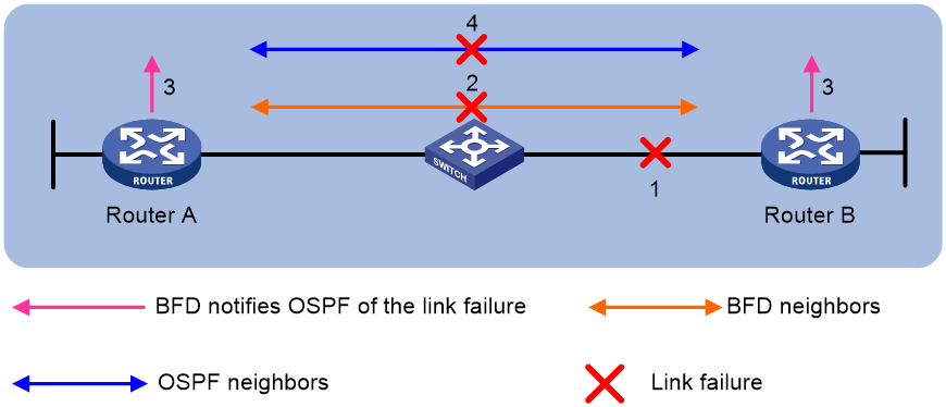

Figure 2 describes the BFD fault detection process.
1.     BFD detects a link failure and tears down the session.
2.     BFD notifies the neighbor unreachability to OSPF.
3.     OSPF terminates the neighbor relationship on the link.
Figure 2 BFD fault detection

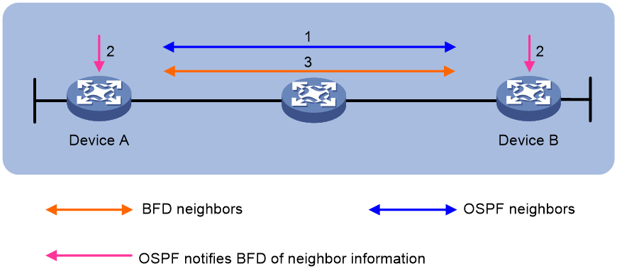

BFD can be used for single-hop and multihop detections.
·     Single-hop detection—Detects the IP connectivity between two directly connected systems, for example, Device A and Device B as shown in Figure 3.
Figure 3 Single-hop detection
·     Multihop detection—Detects any of the paths between two systems, for example, Device A and Device B as shown in Figure 4. These paths have multiple hops, and might overlap.
Figure 4 Multihop detection
